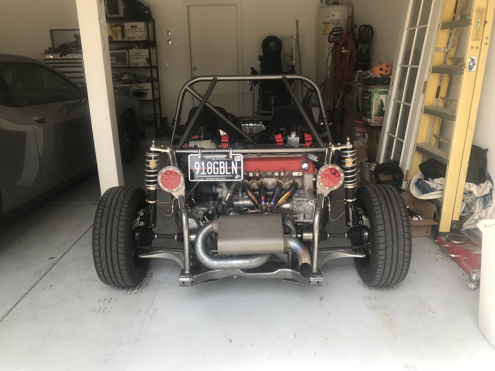

So I had an ’06 SS/SC donor build, and my kit came with a 2.5” exhaust system. I was just helping AMack with his TC/SS build last night, and his exhaust is 3”. Did I get the correct exhaust? Should it be 3”? Thanks!

askiles
Here is the 2 1/2” exhaust that came from DF.
