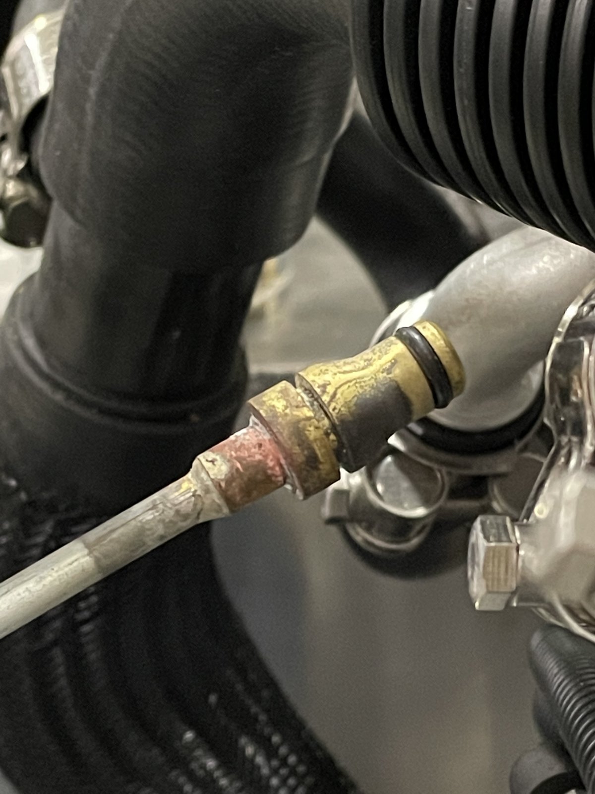

Out of curiosity, is it possible to have an air leak coming from the modified clutch line? Maybe a slight pin hole…
just a dumb thought, but at this point could you pressurize the line with air and listen for a leak? Or use soap on the connections to look for bubbles? I mean since you already have all that air in the lines, it couldn't hurt??....
Towerdog
I think I've got it figured out... elbow was sucking air. Have it bled and have put 30 miles on it.... it is a learning curve having more than an inch of pedal travel...
