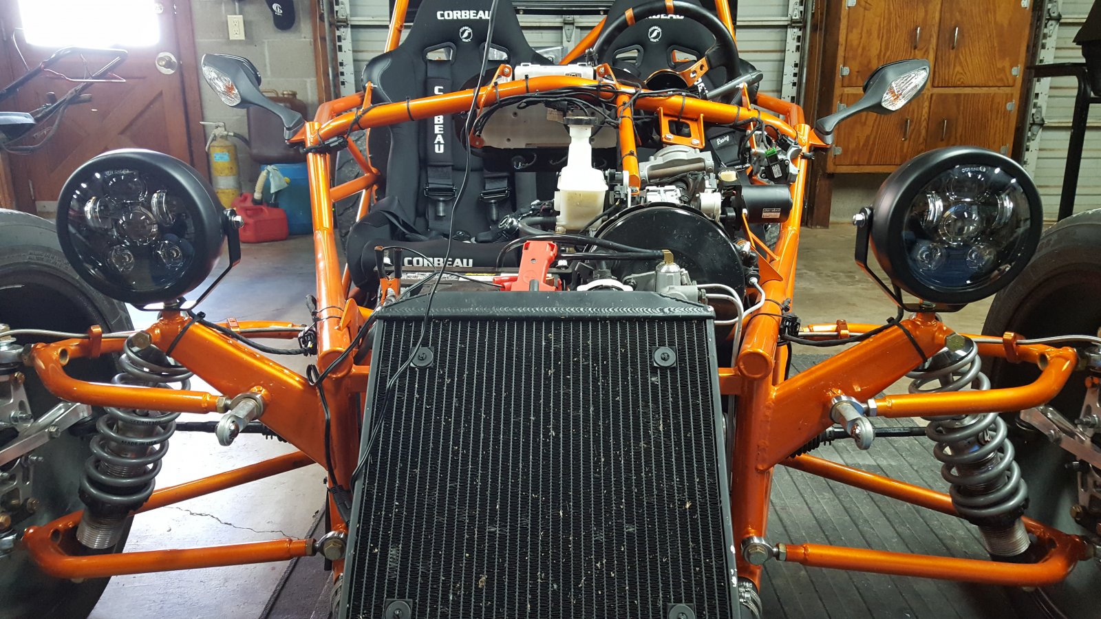

I like those brackets that’s exactly what I was considering A+
I have witnessed deer hits here in MN quality lights are a must have and I’m not into adding fog lights just get the good lights you got!

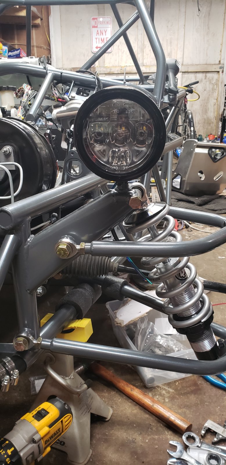

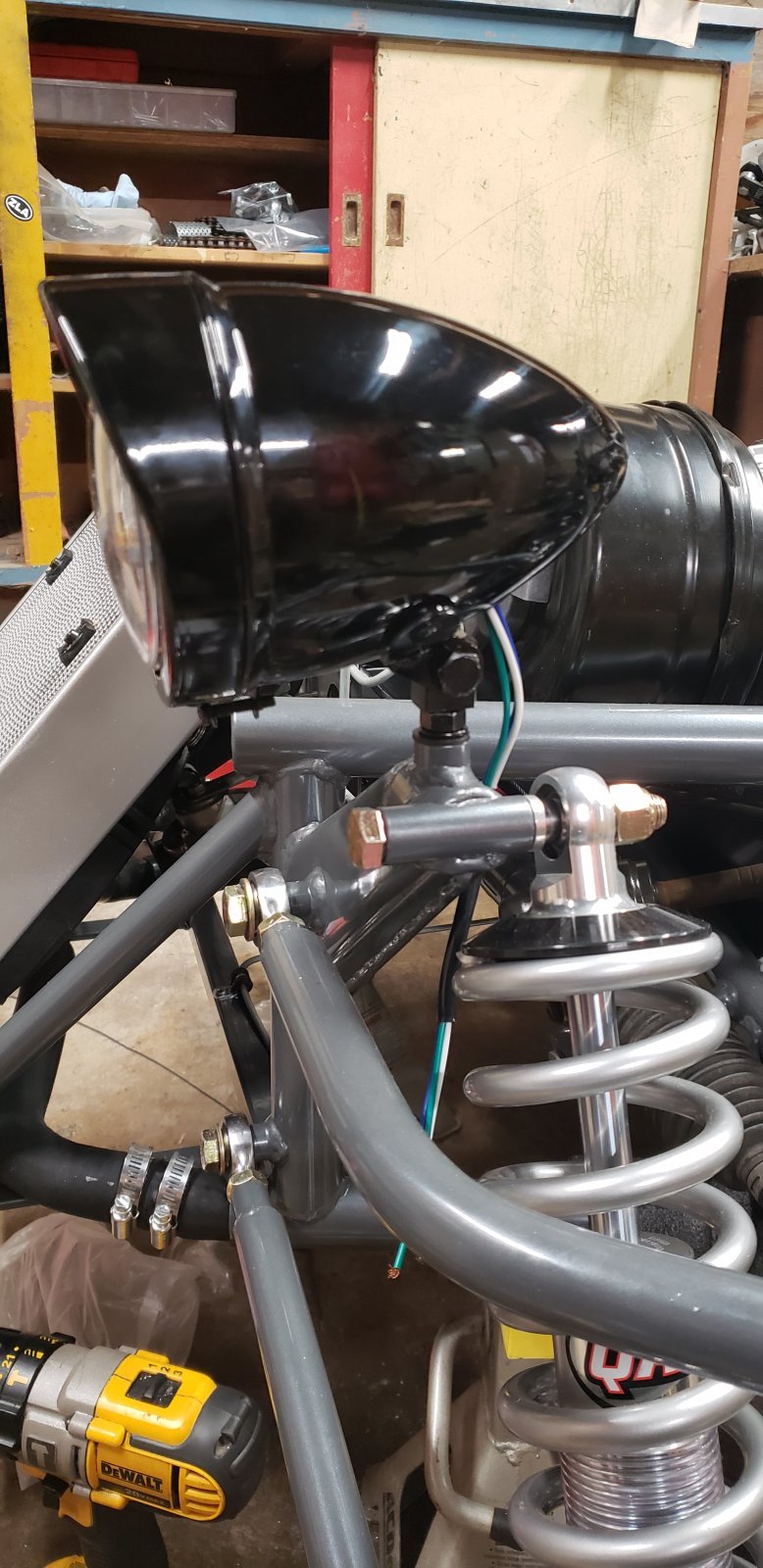

Did you cut a cube of steel or aluminum?and tap it to adapt those Harley buckets.
Nope, I retapped the Goblin headlight bungs to M10-1.25. The headlight bucket is a 4-1/2" bullet; the mounting stud came assembled to the bucket. I like the look, but only have one because I didn't know if they'd work with the lights I have. After doing the fit up, I learned that nobody has another black one for sale, only chrome. Now I'm on the hunt for another housing that isn't a Bates clone, because I don't want chrome and painting chrome is not something I've had much luck with.
