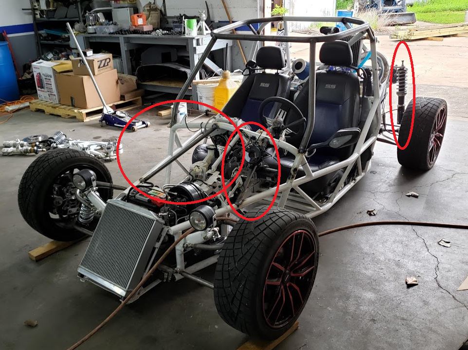

Back in post 108, I mentioned triangulating my frame... Those red circles in the front of my frame is where we welded extra bars to strengthen it.
With just the passenger bar welded in, I noticed the front of my car was braking better. Adding the driver side made it even more stable.
If you were to use a cargo ratchet strap (or a come-a-long), and triangulate your frame, does it make the car more stable when braking?

Thanks for the ideas! I'll double and triple check hardware, joints etc and drop tire pressures a bit and see what happens. Following that I'll see if I can get some ratchet straps in there somewhere if it's still occurring at that point.
