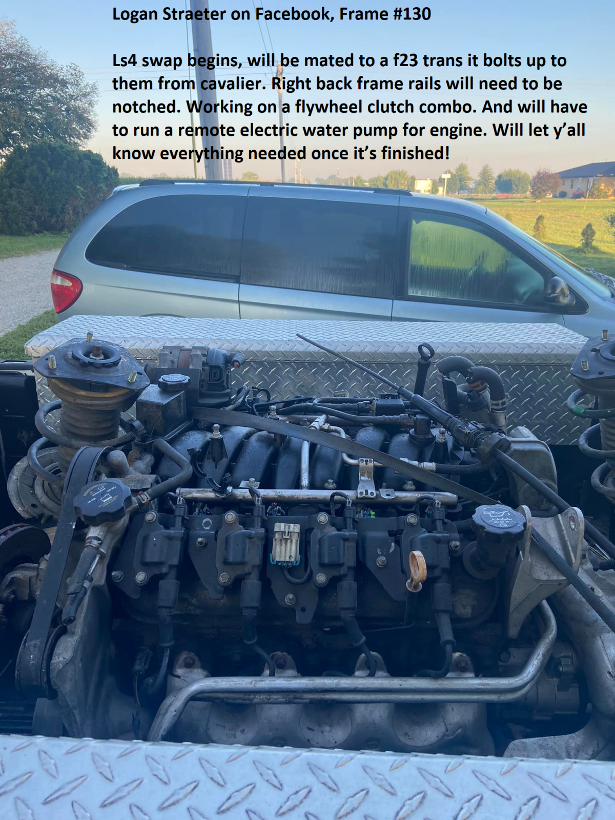

Logan Straeter
Ls4 swap begins, will be mated to a f23 trans it bolts up to them from cavalier. Right back frame rails will need to be notched. Working on a flywheel clutch combo. And will have to run a remote electric water pump for engine. Will let y’all know everything needed once it’s finished!

It was only a matter of time before some 1 did it i cant wait. What Frame # are you?
Logan Straeter
Seven Low 130
Seven Low
Are you doing a build thread on it? really want to watch the progress.
Logan Straeter
Seven Low nah but will post pictures and specs when done will start this winter. Wanna enjoy rest of summer with it
Aaron Michael
This is cool. I’d really like to see how this ends up and what the performance is like
Logan Straeter
Aaron Michael mainly for fun cause a ls is a ls not really gonna race it
Dan Clancy
F23 gonna go boom
Rick Gollwitzer
Dan Clancy that’s what I feel like can a f23 hold that ???
Brandon Sparks
F23 can hold some power. Don't count it out. I launch my cobalt at 5200 rpms on 32lbs of boost
Dan Clancy
Brandon Sparks unless you are 2 stepping you aren’t launching at 32psi but it’s doable.
Logan Straeter
Rick Gollwitzer I’m sure it can handle a simple hci 5.3 shouldn’t be over 450hp
It's not the HP that kills transmissions, it's the torque and where it's made in the RPM band. Based on using an identical transmission; a well boosted 2.0 can make 400+ ft lbs around 4500 RPM. A healthy LS can make that same torque around 2200 RPM. The peak torque occurring at the lower RPM is where gears see the torque for a (relatively) longer time and have a higher chance of failing.

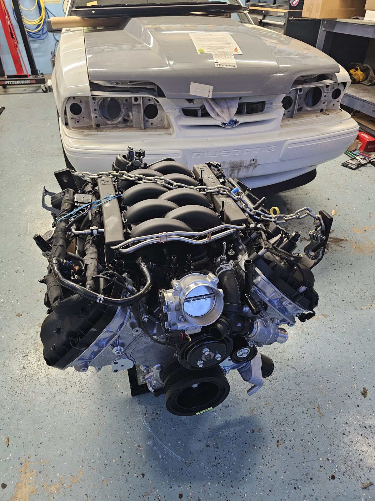

Mirage775
If I were starting from scratch, I would love to make a Ford powered Goblin! My choice would be my new Ford Performance crate Gen III Coyote sitting right here in my garage, LOL!
