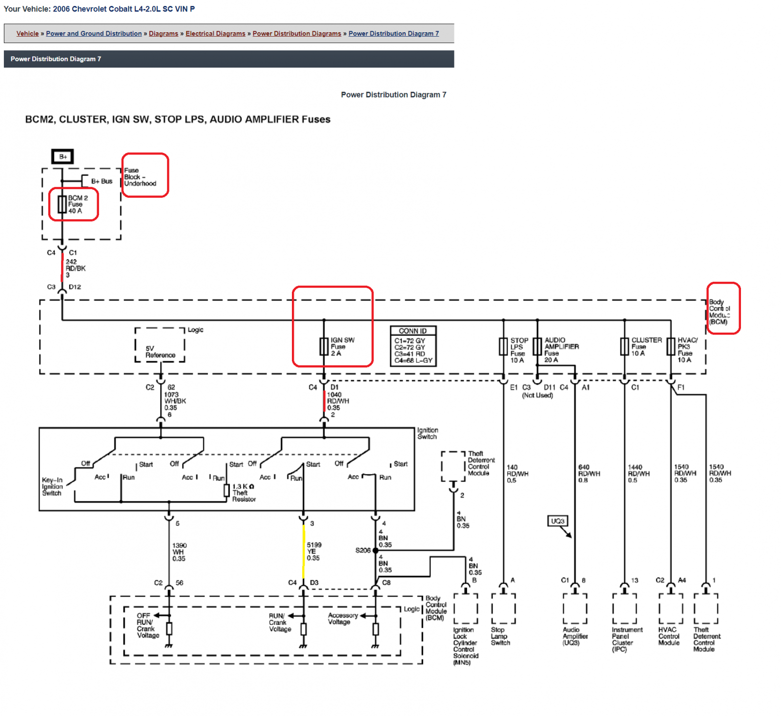

We are so close to finding the issue.
According to this map, the electricity flows from the Run/Crank relay to the IP IGN fuse. Your goblin isn't doing this.
The issue is one of these:
1. the Run/Crank relay is defective.
2. the Run/Crank relay is energizing the coil and the rear fuse box is defective, and isn't passing the 12V+ from the Run/Crank relay to the IP IGN fuse.
3. the Run/Crank relay isn't energizing the coil because it isn't getting power to the coil. (What could cause this coil to not get power?)
When the key is turned on, that relay should get power (both 12V+ and ground) to the coil on pins 85 and 86.
Test:
Does the Run/Crank relay click when the key is turned? If you put your finger on it, and someone turns the key, you should be able to feel it click.

Tested and the relay clicks and I can feel it doing so. So what should I do to the fuse block, is it bad connections or what and would it also explain all of the other pins not getting 12 volts?
K
Just looked over that circuit diagram and it looks like it could affect those other pins. I am assuming then its a loose connection either between the relay going into the fuse block or the fuse block into the fuse.
Great find!
So is the relay defective? The coil works, but maybe the switch is worn out. Have you tried swapping it with another relay? Maybe rear defog relay.
If it is the fuse box, we could try cleaning the contacts at the relay and the fuse. Otherwise it is internal, and would have to take the fuse box apart.

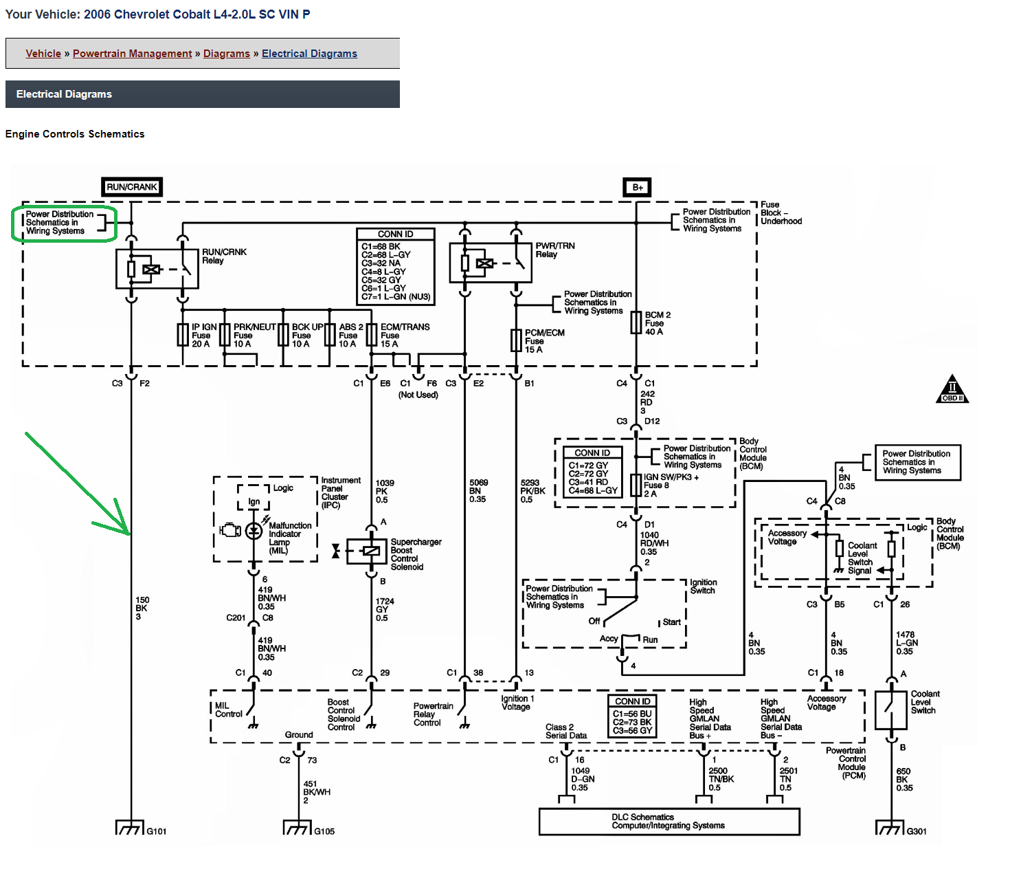

I went down a rabblit hole, and researched issue #3.
Your goblin actually has issue #2, so this doesn't apply to you, but I'm leaving this research here just in case someone else needs it.
Test:
The Run/Crank relay coil gets power from BCM2 40A fuse in the fusebox, then the IGN SW 2A fuse in the BCM, and finally from ignition switch being in the run or start position.
36976
The Run/Crank relay also requires the coil's ground to be working. There is no switching on the ground side of the relay.
36977

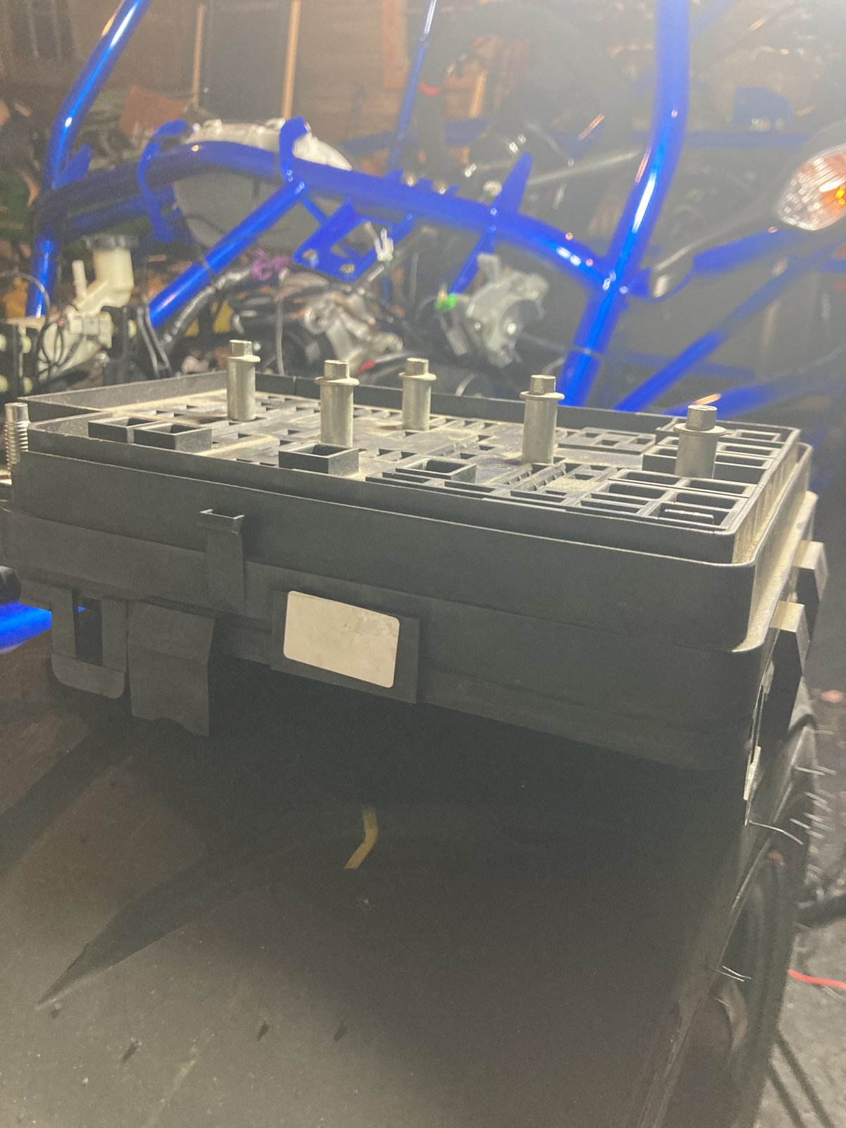

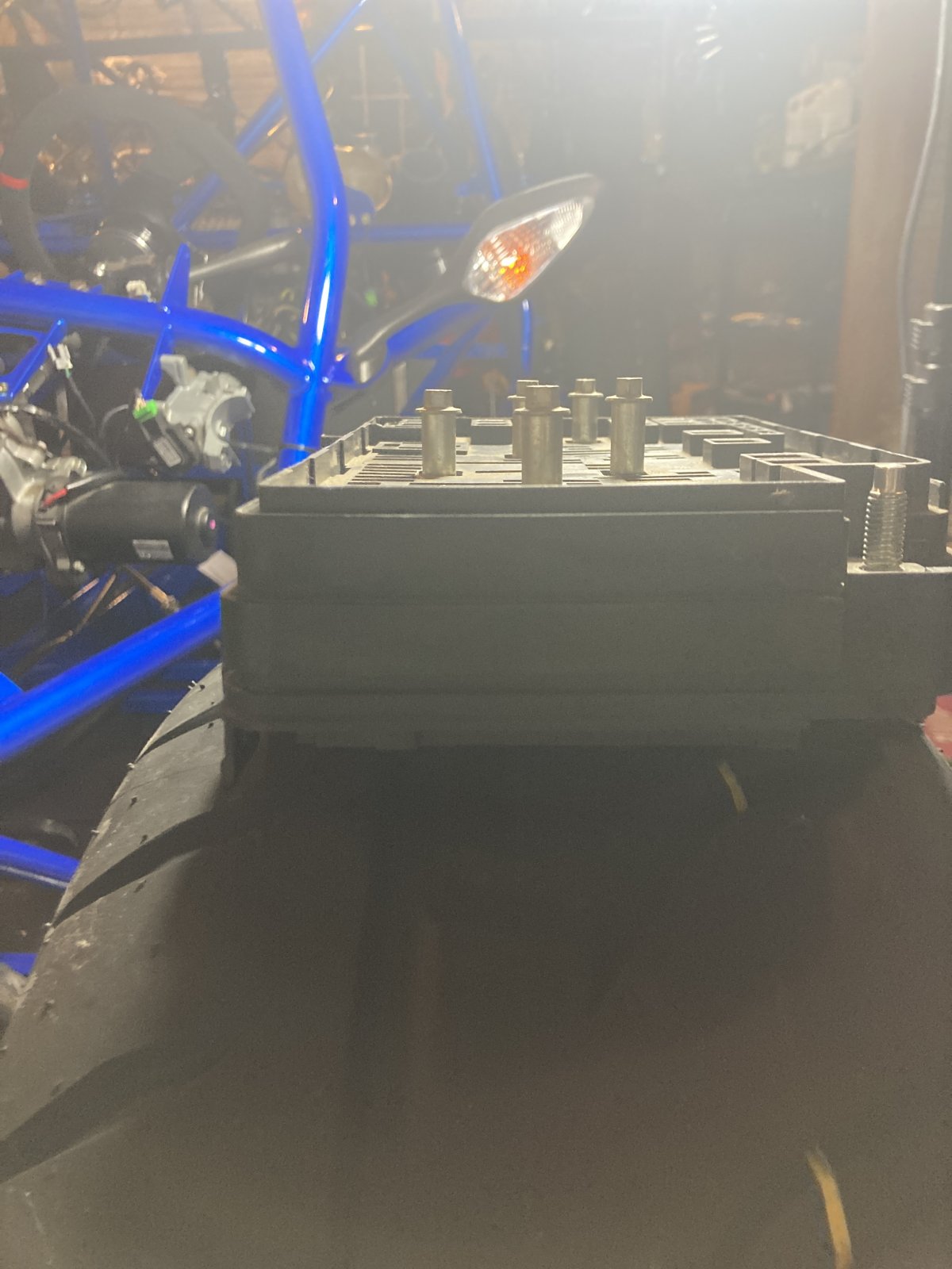

Getting working again right now and I am having a lot of trouble taking the fuse block apart, how do I separate the two halves? Photos are just for reference if anyone has any ideas for how to take it apart. Some of the corners do seem to pry up a little but is it adhered together?
