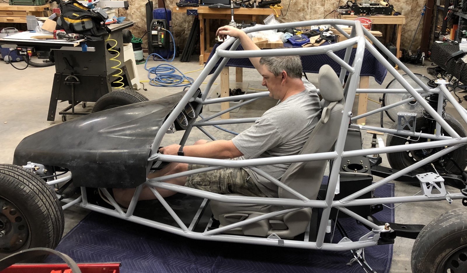

I'm 6' 2" and ~250lbs and I got an extended track frame. I have a donor seat in it right now so I could try it out.
Tim Moland

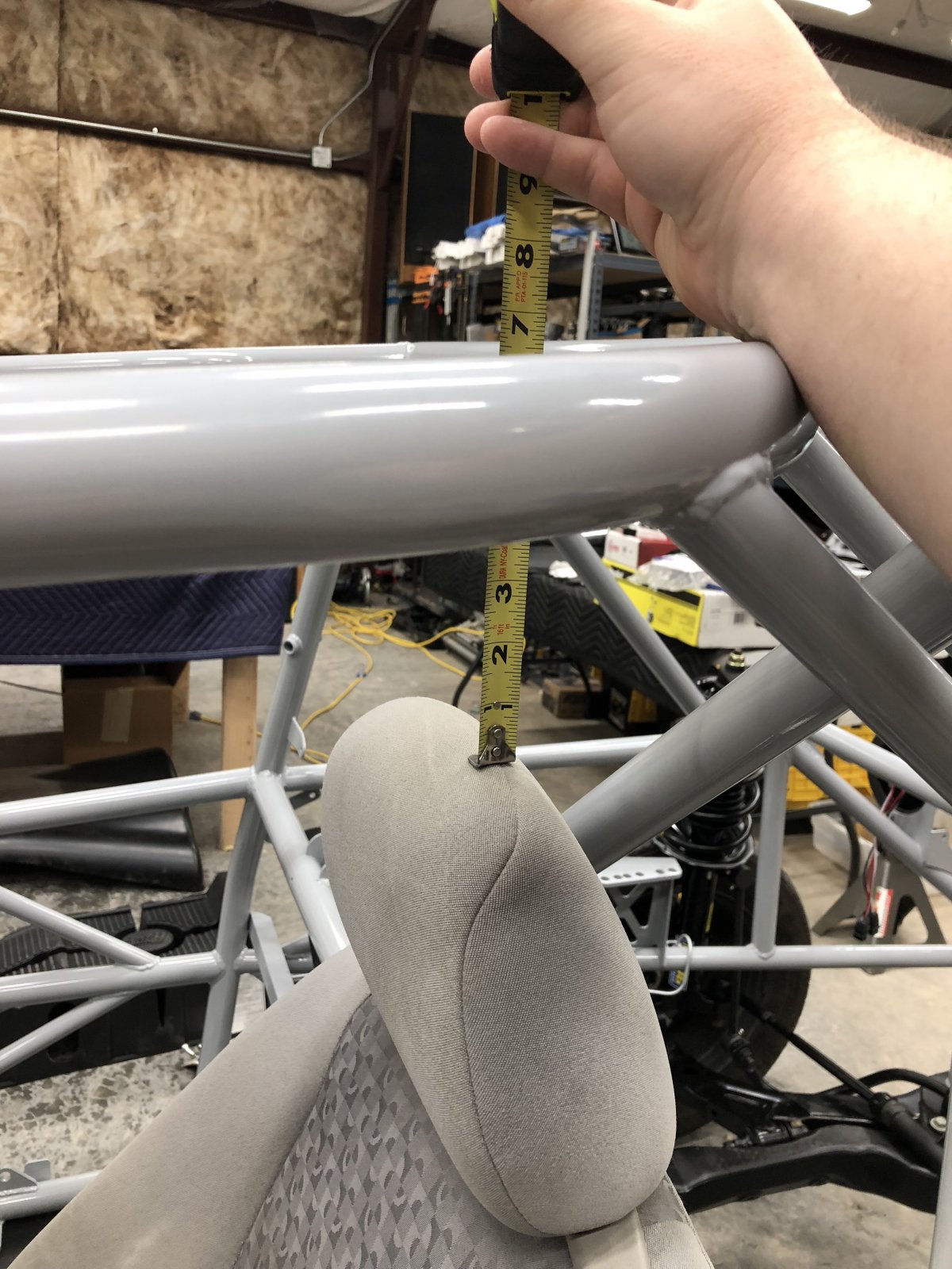

Well that doesn't look bad. Could you possibly get a measurement from the top of the headrest in the full down position to the top of the rollover bar so I can measure were my head is on my stock seat? Do you have the stearing column installed yet? I would like to see where the steering wheel sits with my bigger belly.
jennam
It looks like there's about 6 1/2" from the top of the seat to the top of the bar. I will mention that the seat I have in there isn't bolted down or anything although it's kinda sorta in the right place. I'm planning on running the Corbeau seats like what's in Lonny's car and I think they sit a little lower. Corbeau does make a wide seat that I think fits in the Goblin too.

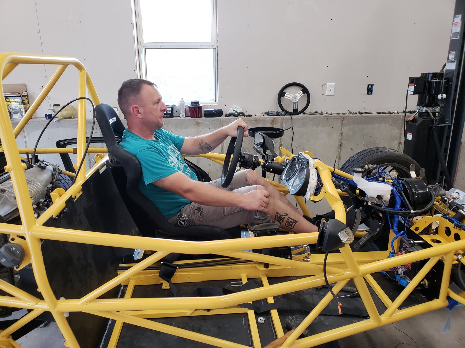

Thanks for the measurement. This is what I look like in a regular length city frame. Does anyone think 4" longer, 2" taller will allow me to fit? I just don't think the stearing wheel will fit. Nevermind the shifter under my knee!!

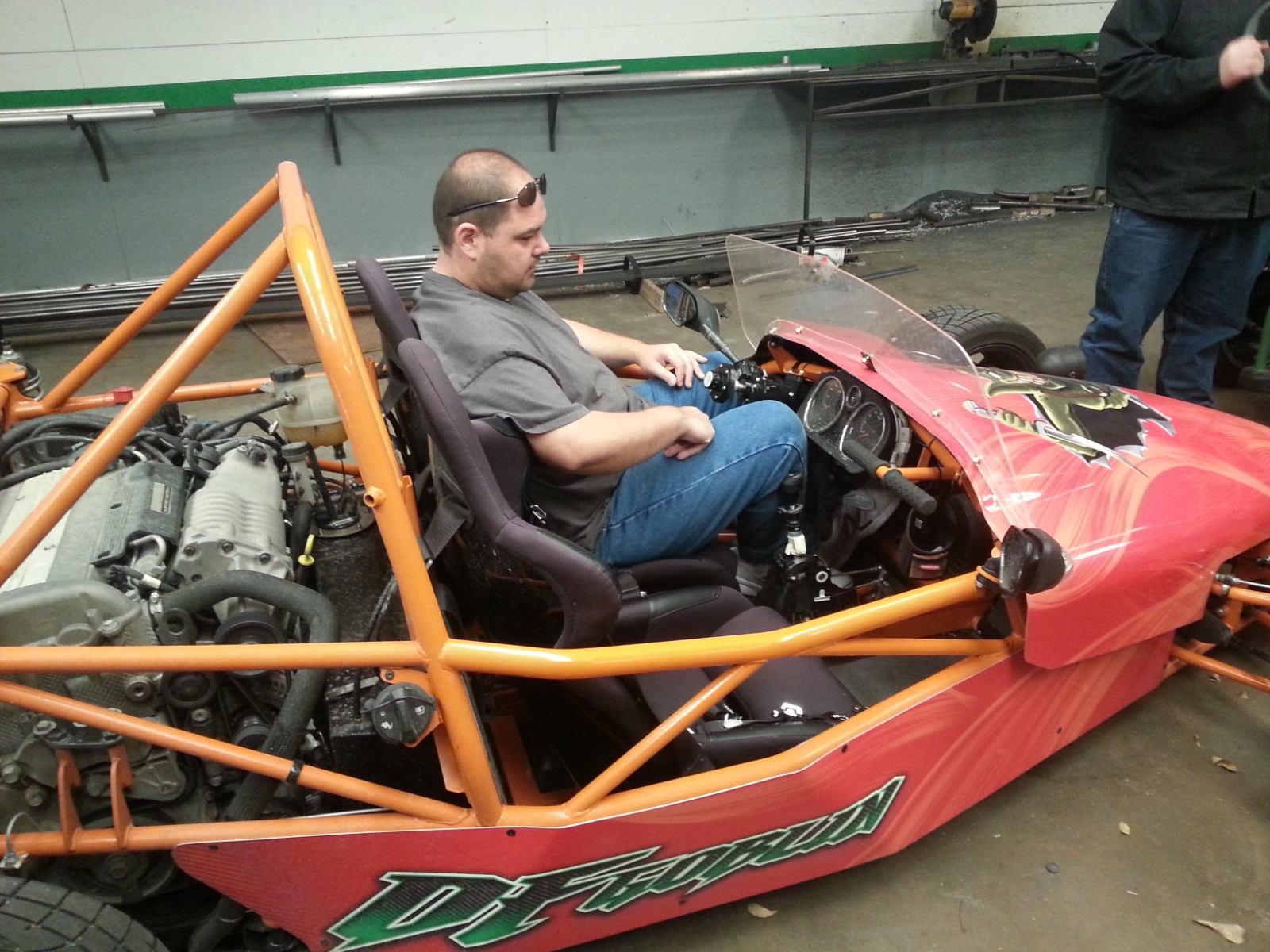

Here is my 6 foot 2 inch tall brother in mine, the seat is in the middle setting also. Height wise you will be fine with the long, I have a 36 inch inseam and this will be my driving position. You will need to figure out something on the seats though.
