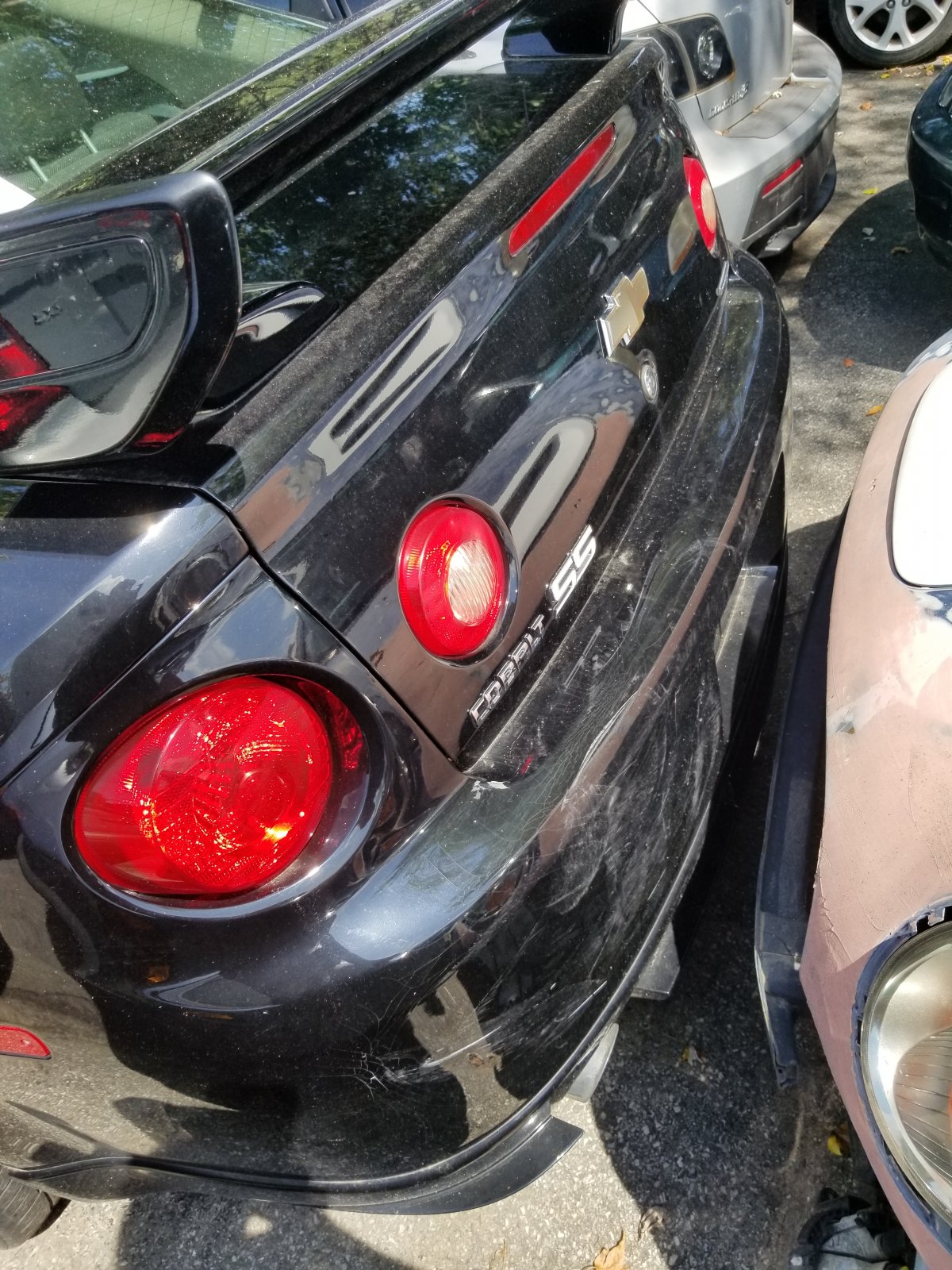

Put a deposit in on another donor this morning. I'll pick it up next weekend, and it's a beauty. It will take the bitter taste of my first donor out of my mouth, real quick.

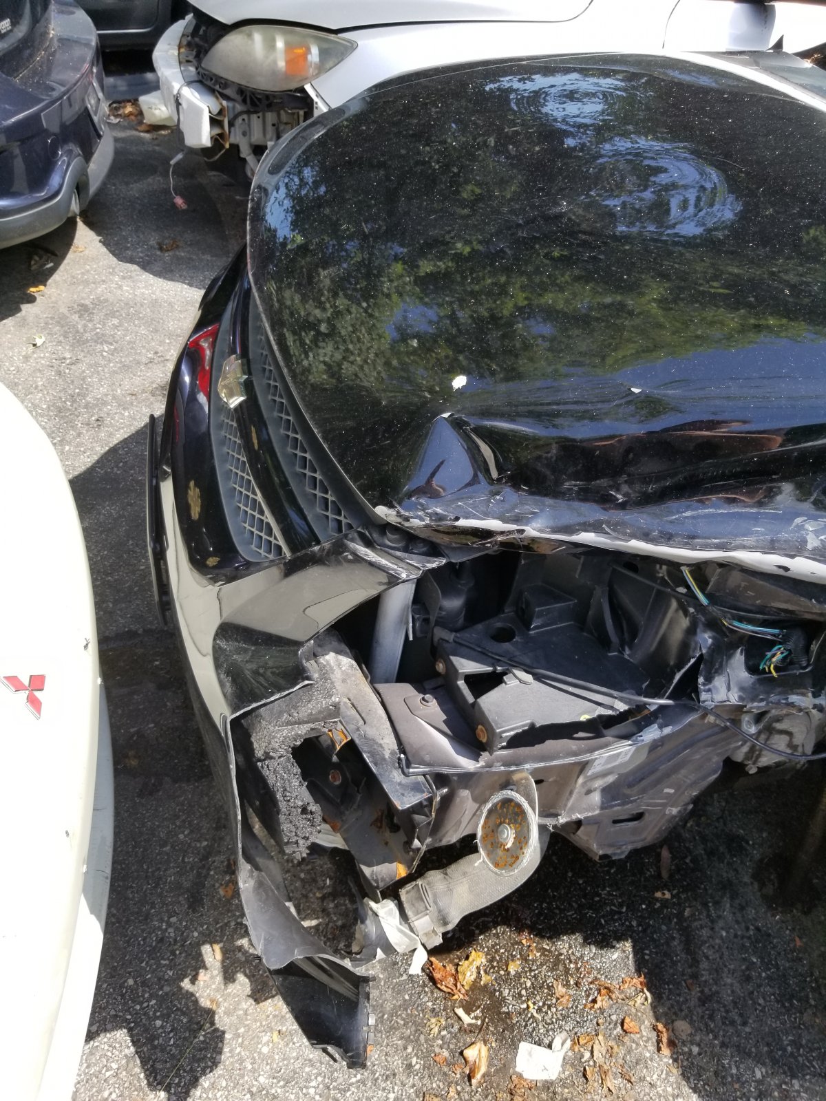

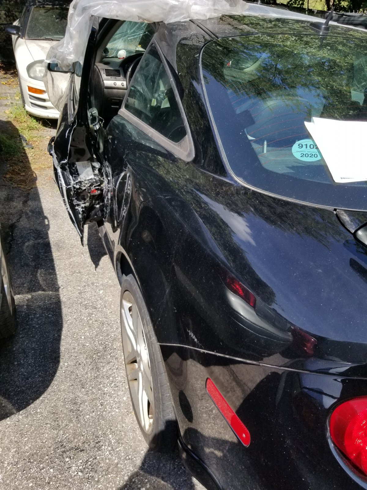

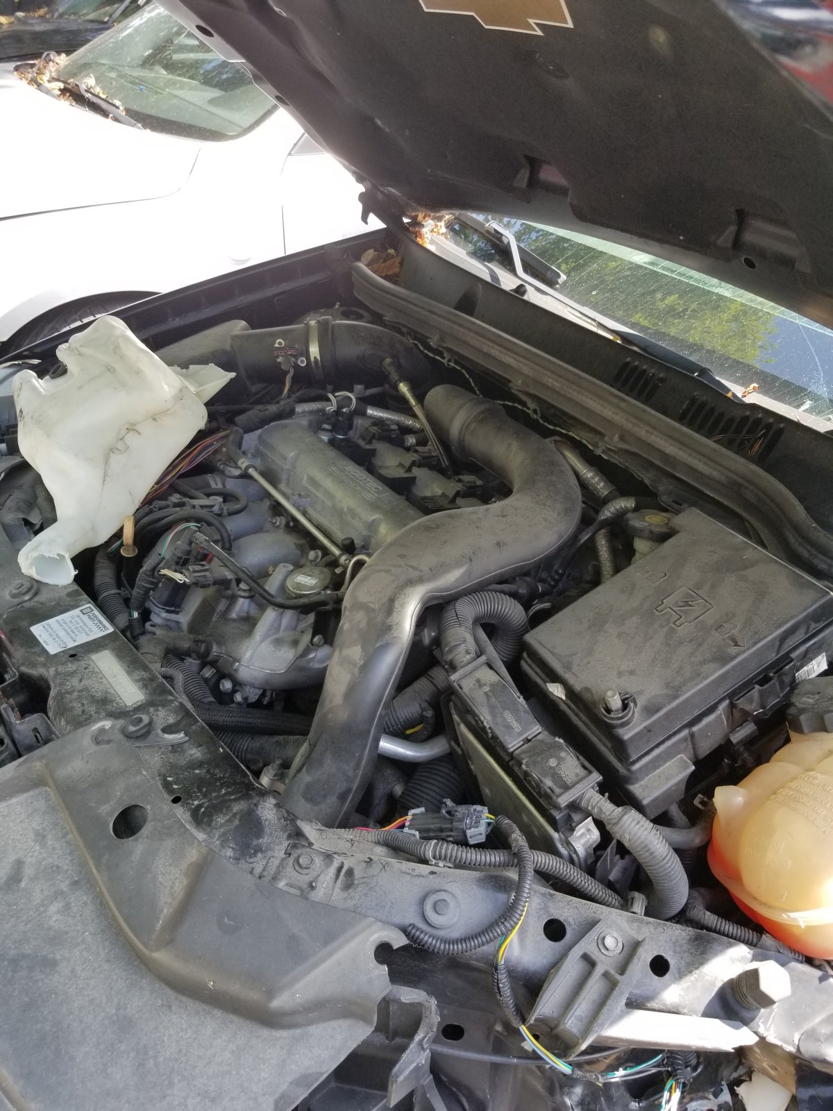

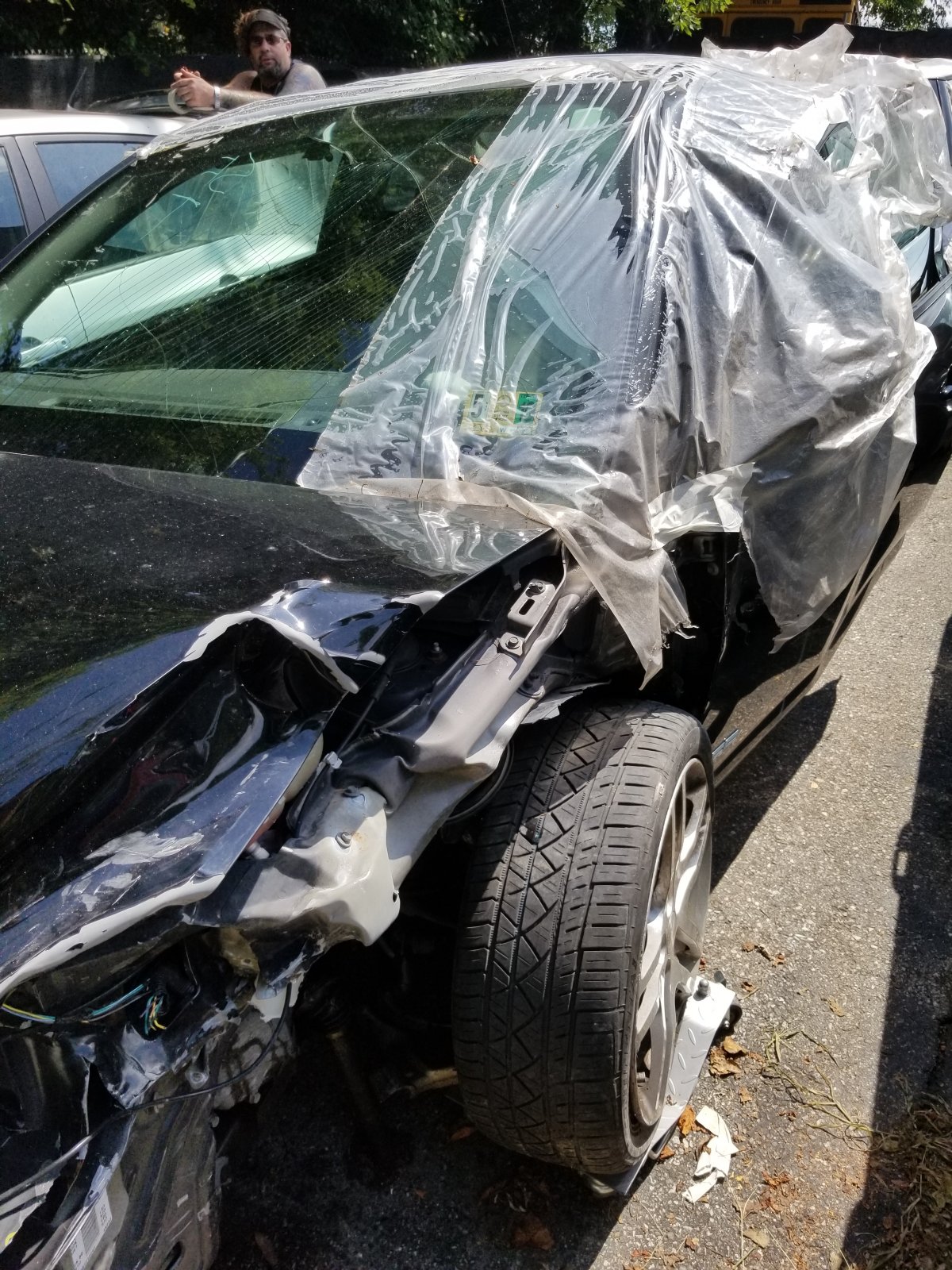

For $1700, I'm getting a 2008 Cobalt SS/TC with 78k on the odometer and (somehow) a clean title. But the accident was bad enough to blow the bags and damage the fuse box, coolant reservoir, turbo intercooler, driver-side CV axle, and driver-side control arm. In spite of that, this donor runs like a champ. The dealer was great to work with; he understood my pain and took the time to loop the intercooler hoses so he could show me a good start. He was also good enough to dig out the title for me and confirm the 78k odometer reading (it was stubborn and didn't want to show on the gauge cluster because of all the warnings present).

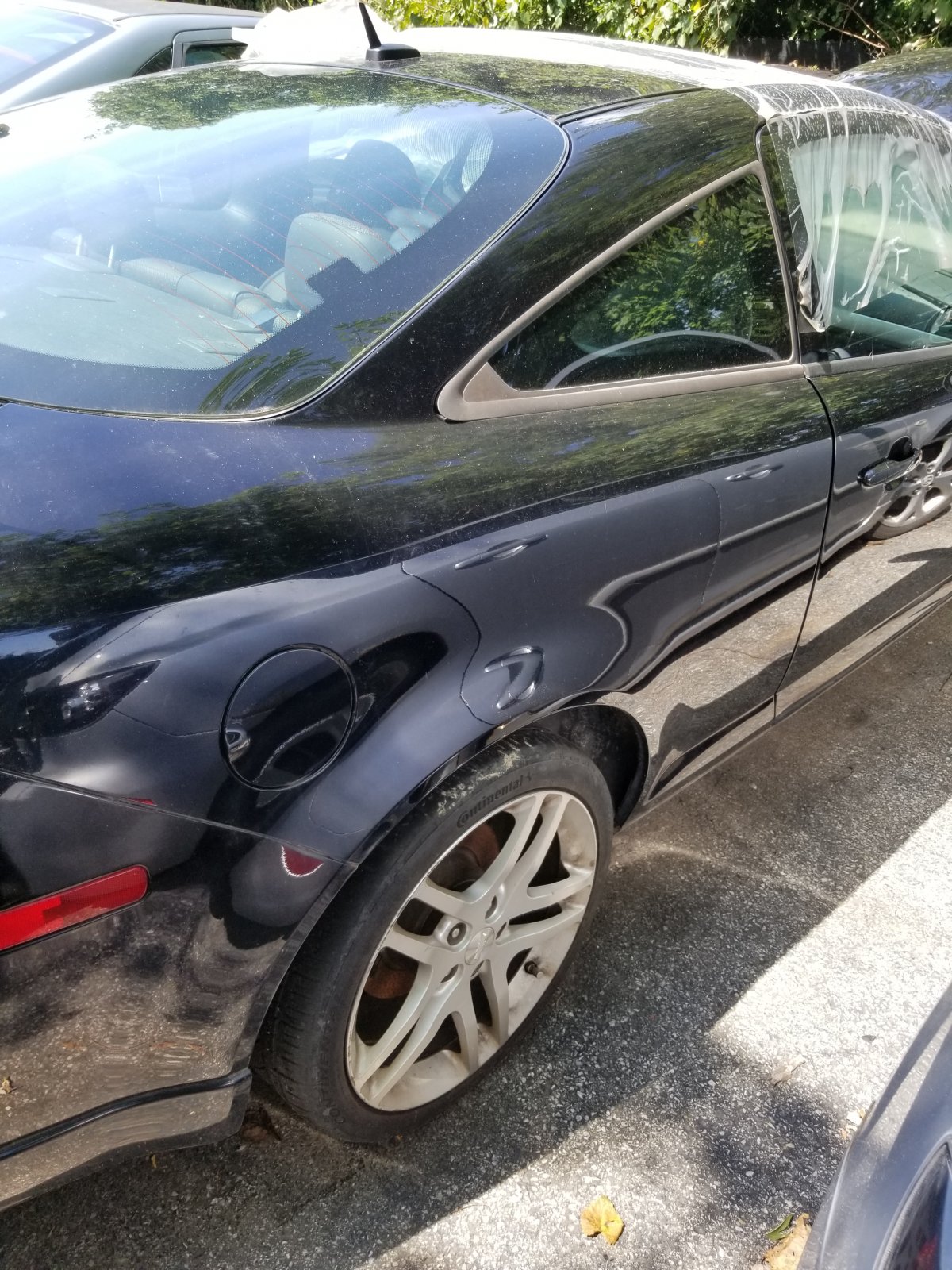

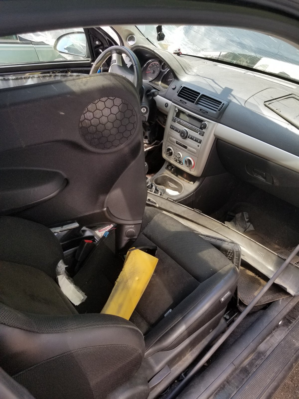

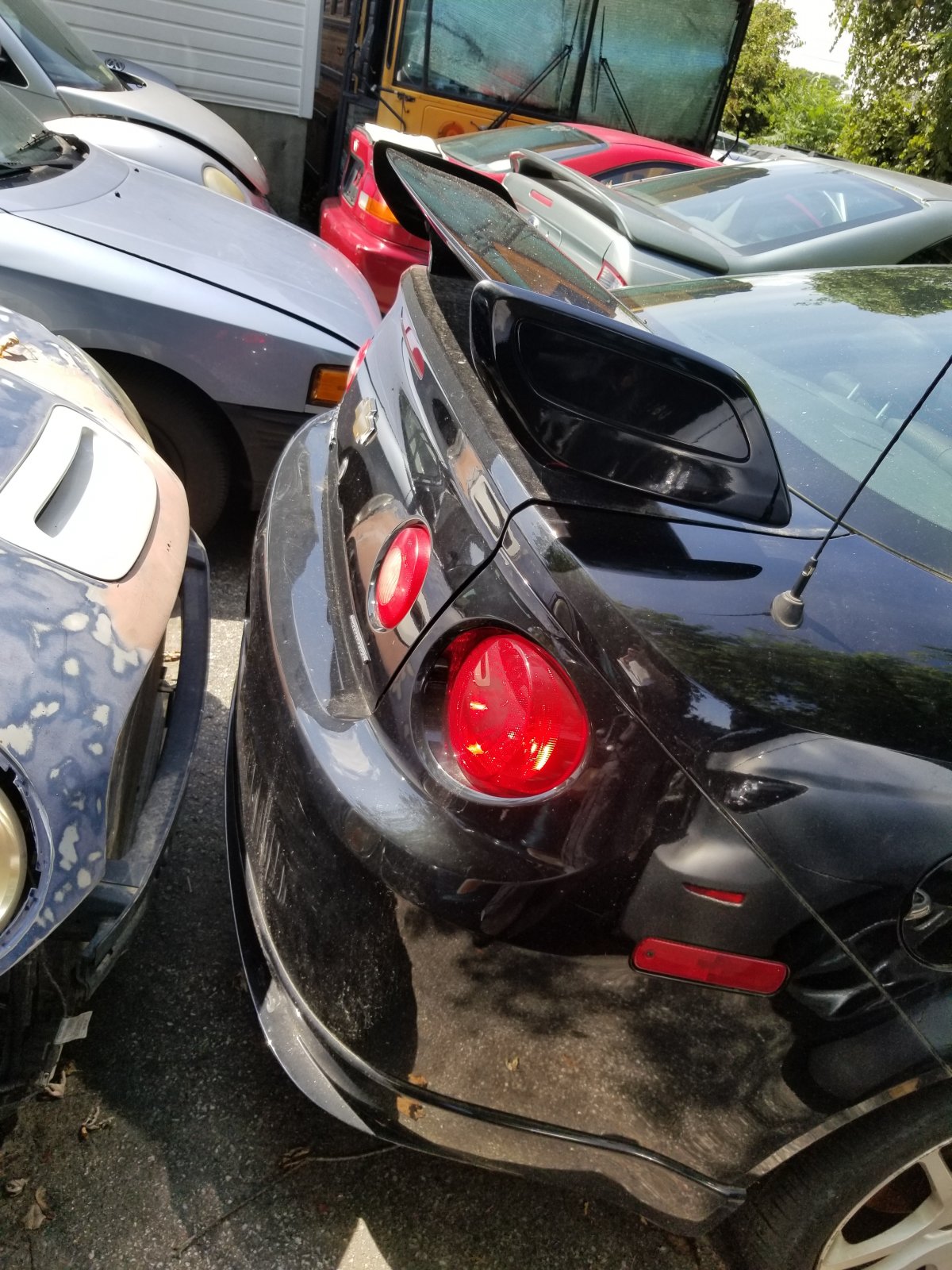

This one also has some pretty decent sellables. Not as much as the original donor, but the trunk lid and spoiler are perfect and should bring in more than the $75 I got for the other one. It's also got the late-model SS seats and Brembo brakes, both of which are probably worth a good bit as resells.
So, here she is:
2008 SS/TC with driver's side damage....hmmm, somehow that seems familiar. :rolleyes: 78,000 mile is a great low mile car, hopefully the person did regular oil changes and other maintenance.
Hope the suspension damage did not bend the front subframe. The LCA can be found easy enough, the axle will be a little harder. Make sure to check the steering rack to make sure it did not get damaged.
Looks good and hope there are no surprises during teardown! :D
I still have my first donor's subframe and coolant reservoir, so I think I'm covered there (unless they're different...). I'm probably going to swap the CV axles for a NA/SS/SC pair for the smaller wheel hub diameter and convert to 4-lug hubs. I was reading about that and there doesn't seem to be a problem doing that, even with the increased horsepower. And finally, I have a control arm on the way already. :)
I will, however, have to buy a fuse box. Apparently they changed between 07 and 08. /eyeroll

Question: can a Cobalt move under its own power with a missing driver-side cv axle? From what I'm finding out there, the car will move but obviously driving it is a terrible, terrible idea. I'm just trying to plan ahead for getting the car into my garage this weekend.

My cobalt sure didn't move like that. My donor had a disconnected driver side axle (accident broke the steering knuckle and strut and disconnected the driveshaft). I had the frame sitting on a dolly under the driver front corner, driver front wheel removed; I could put it in 1st or reverse on my F35 manual transmission with G85 LSD and it didn't go anywhere when just the passenger wheel was on the ground. It just spun the driver side output cup on the transmission. Once I removed the passenger front wheel and put that side on a dolly too I could shift into any gear and both sides spun as expected. I haven't finished building my goblin yet but I'm assuming it'll be fine once reassembled fully.
I think I had a little clutch slip happening but I know the output shafts were spinning so it wasn't just a failed clutch.
Good info. I suspect that's just a side effect of having the LSD. I forgot to check if my new donor has the LSD or not ... I knew I'd forget something. Either way, I think I'll just plan to have a few people on deck to help push this weekend.
Thank you.
baustin - your car should have moved, if the parts are working correctly.
A limited slip differential should limit the amount of torque going to one wheel, and give some torque to the other wheel.
So Ark, If you have a LSD diff, it should move forward, if you have an open diff, it won't.

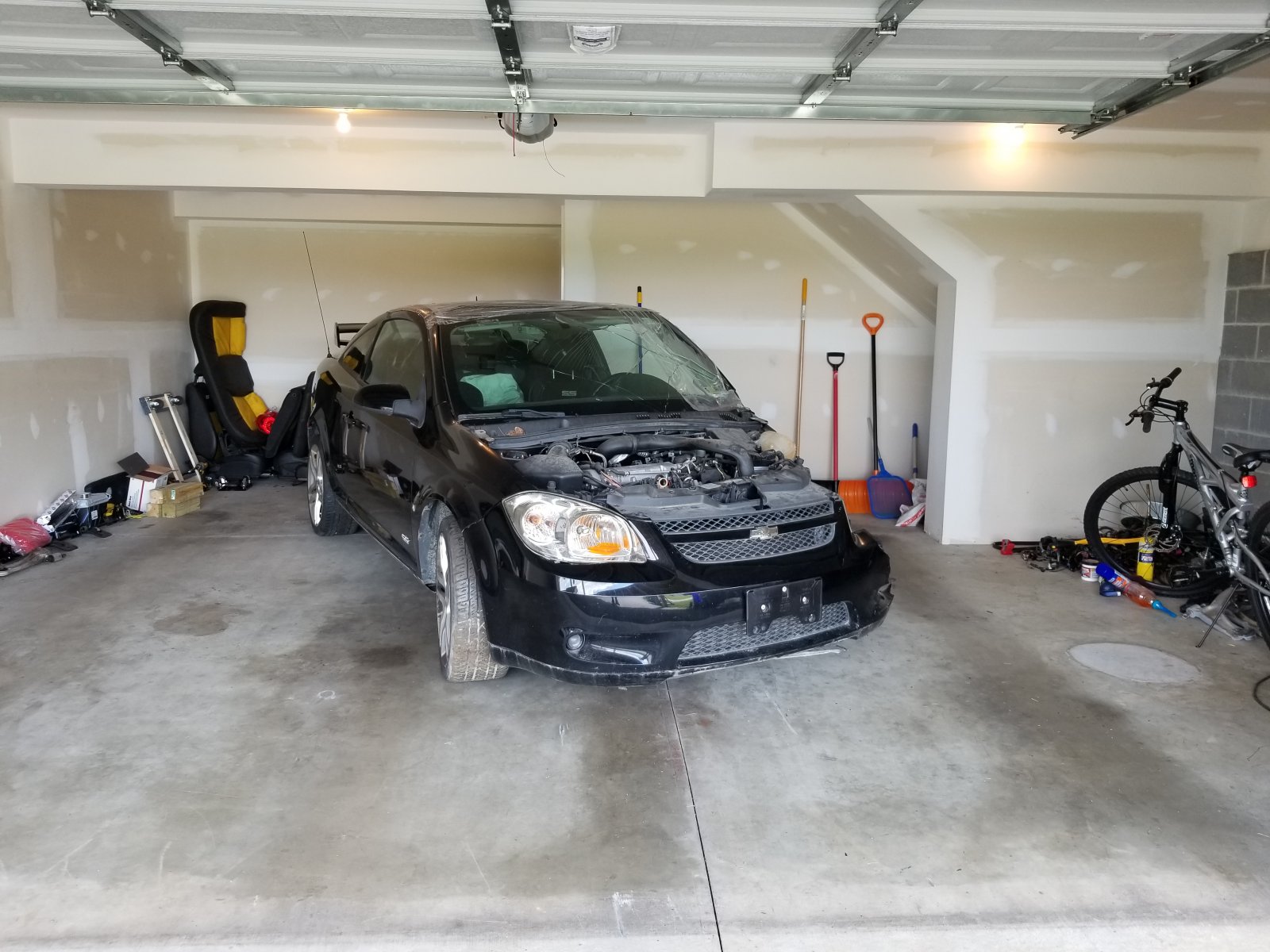

Got her here, safe and sound. The car was 116 miles away, in Owings, MD. I subscribed to AAA Premiere a week ago and had them tow it here, thus avoiding all the fun of I95 in the Annapolis/Baltimore area. Thanx random AAA guy!

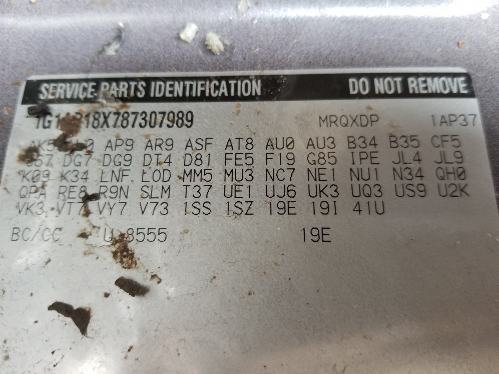

I forgot to look at the trunk plate before I bought it, but I checked it out today and JACKPOT! G85 code, LSD. I am pleased.

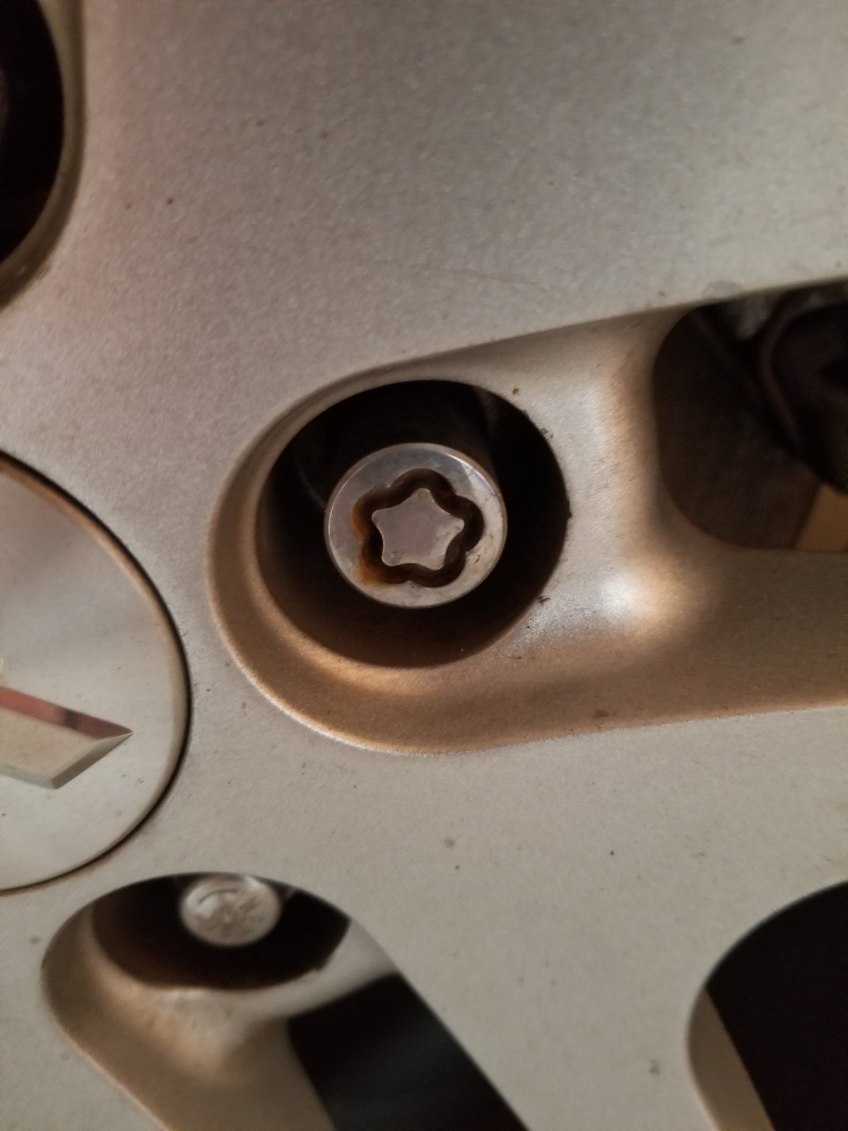

Is this wheel lock, OEM? My old donor didn't have them and I don't have a key... (I know about the 19mm socket trick but I'd rather do it the right way if I can source a key)
Check on-line, like eBay. They list many different keys and you may be able to find one. Otherwise check with Autozone, NAPA, O'Reilly's, etc. and they may be able to source one - rather than going through a Stealership.
