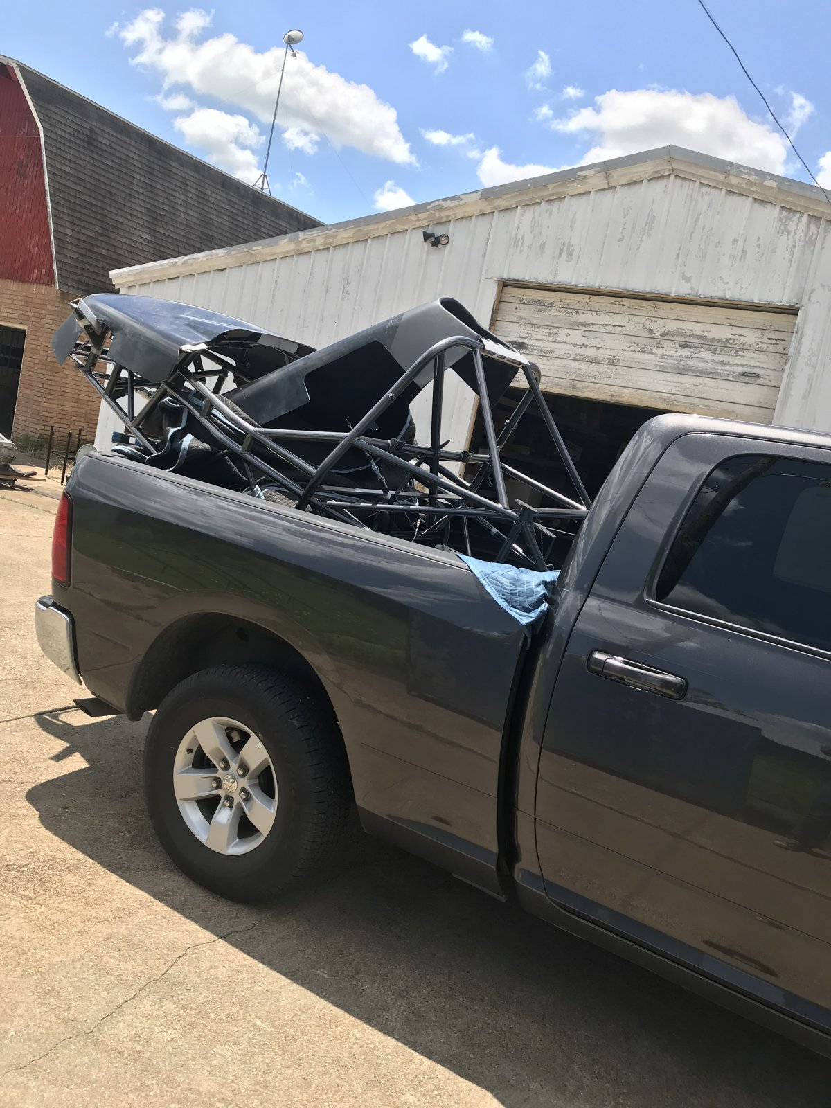

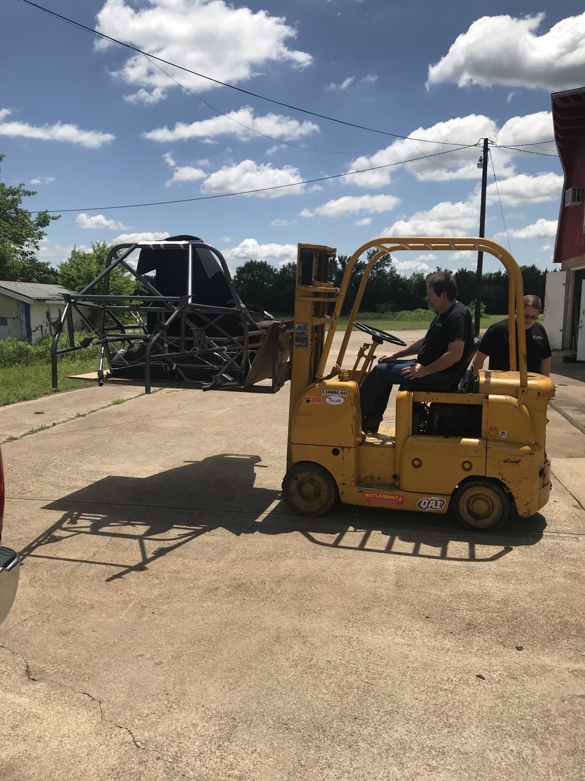

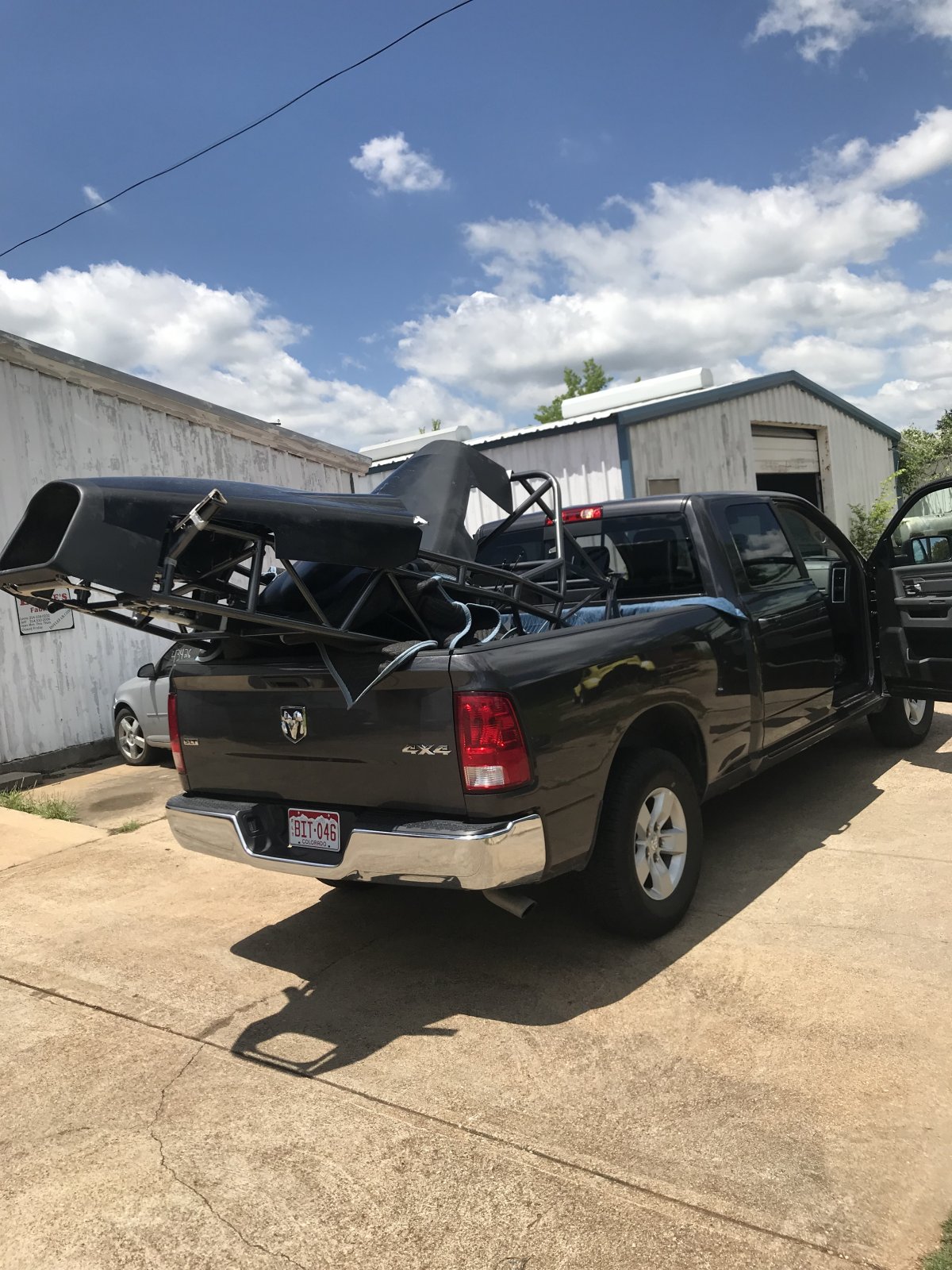

May 4th, 4:30 AM - alarm goes off for me to wake up entirely too early
6:45 AM - flight takes off from Phoenix to Dallas
1:30 PM - arrive at DF to pick up my kit
2:45 PM - I am on the road and headed towards Arizona once again
May 5th, 3:45 AM - my new Goblin kit arrives in its new home!!
Such a long drive. Now the build really begins...

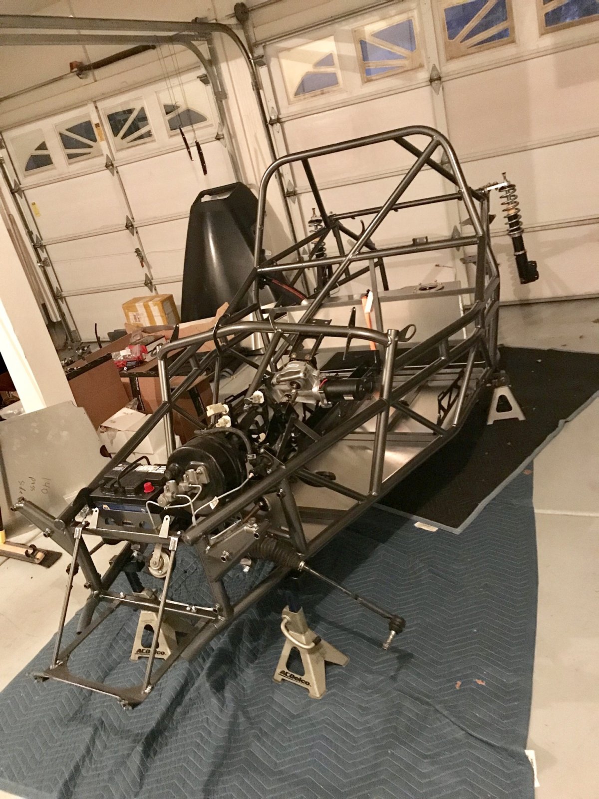

Congrats! That was a long day. The next road trip your Goblin makes, it won't be in pieces. ;)
askiles

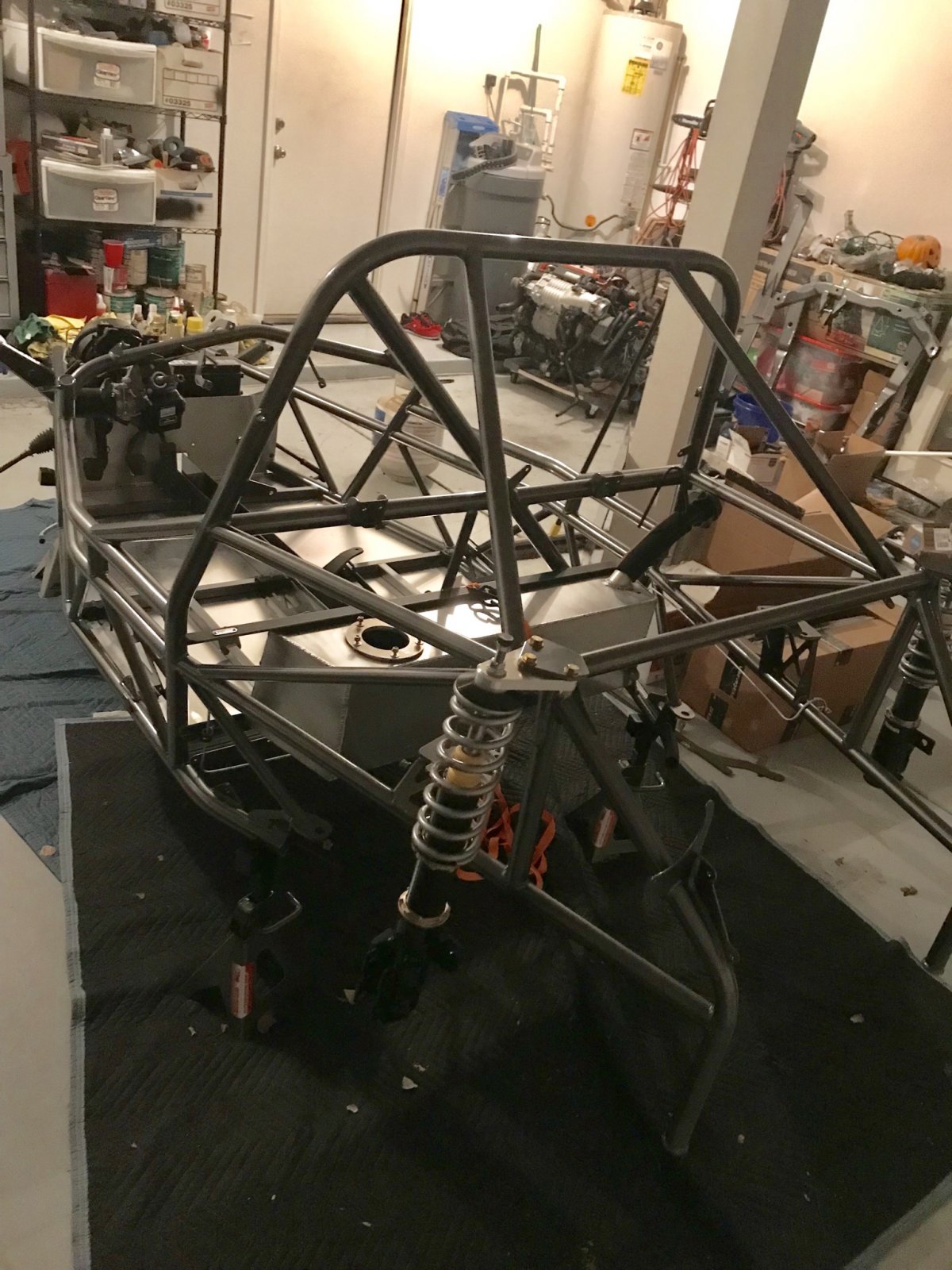

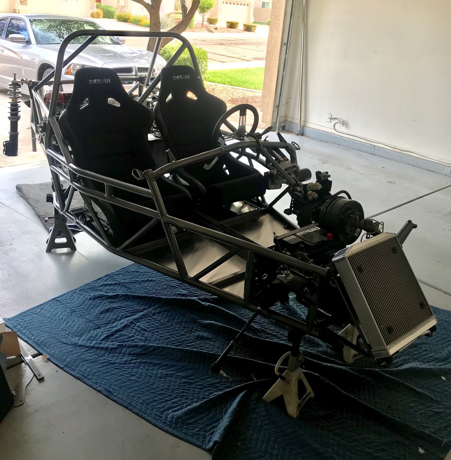

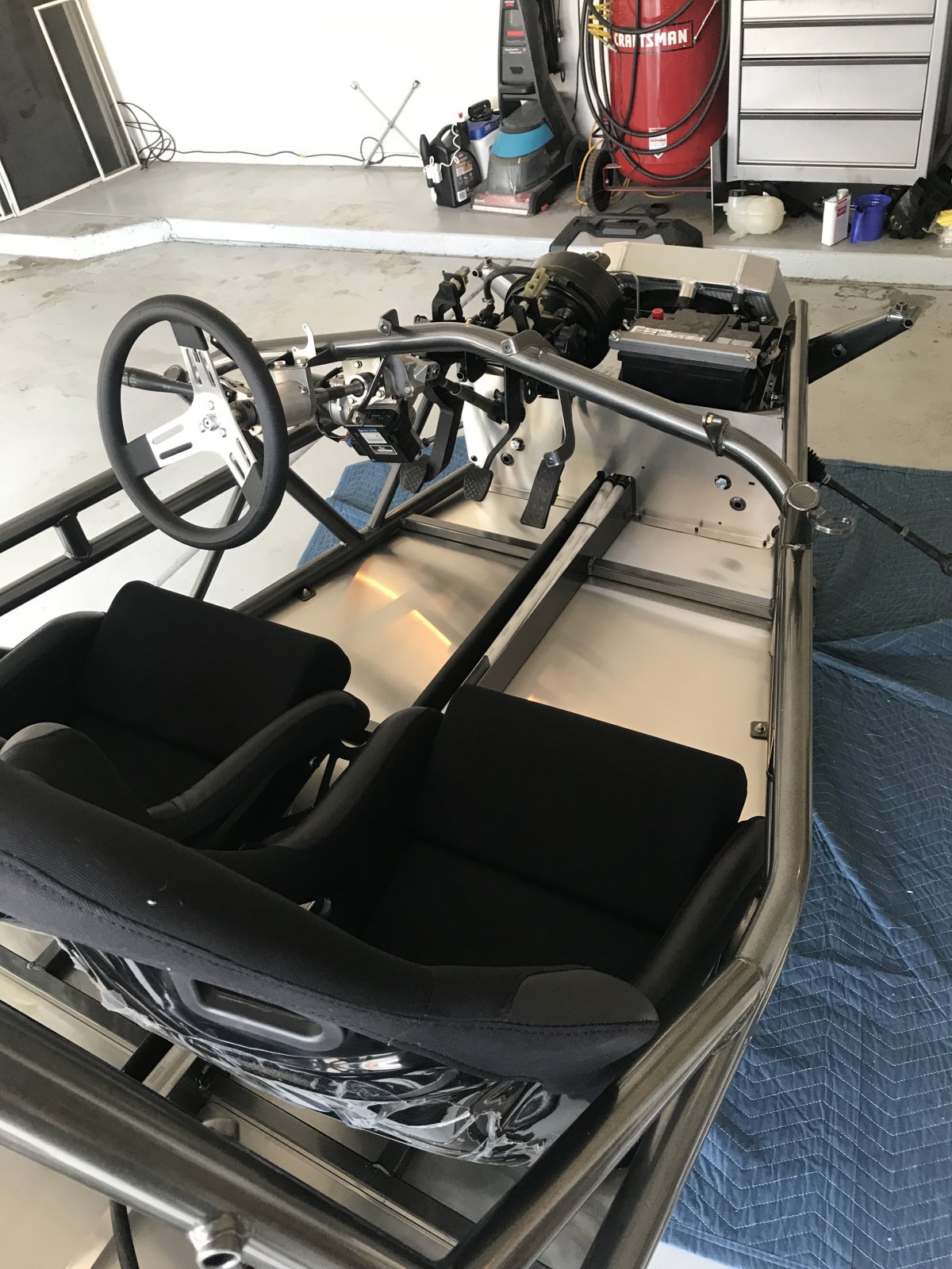

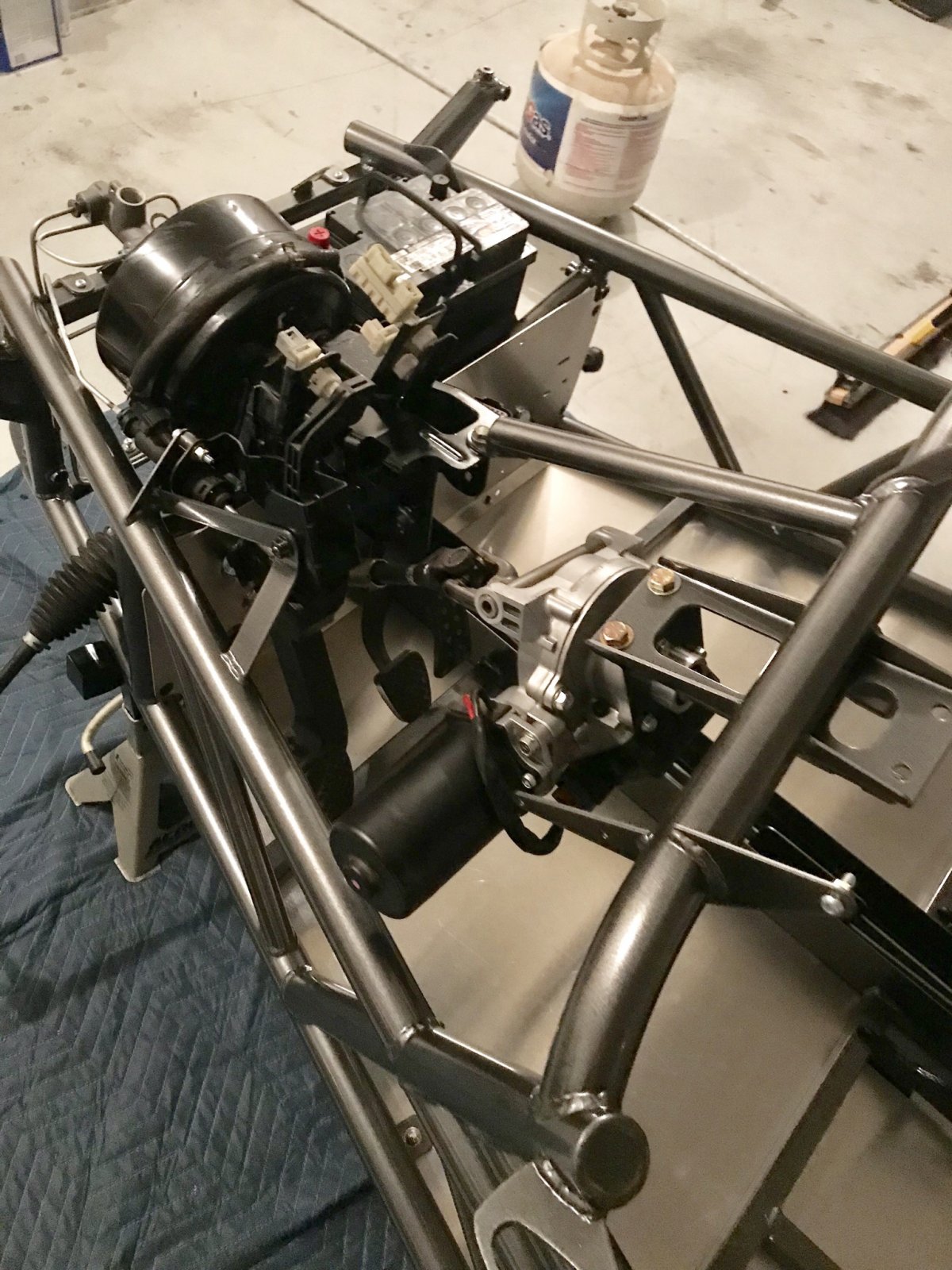

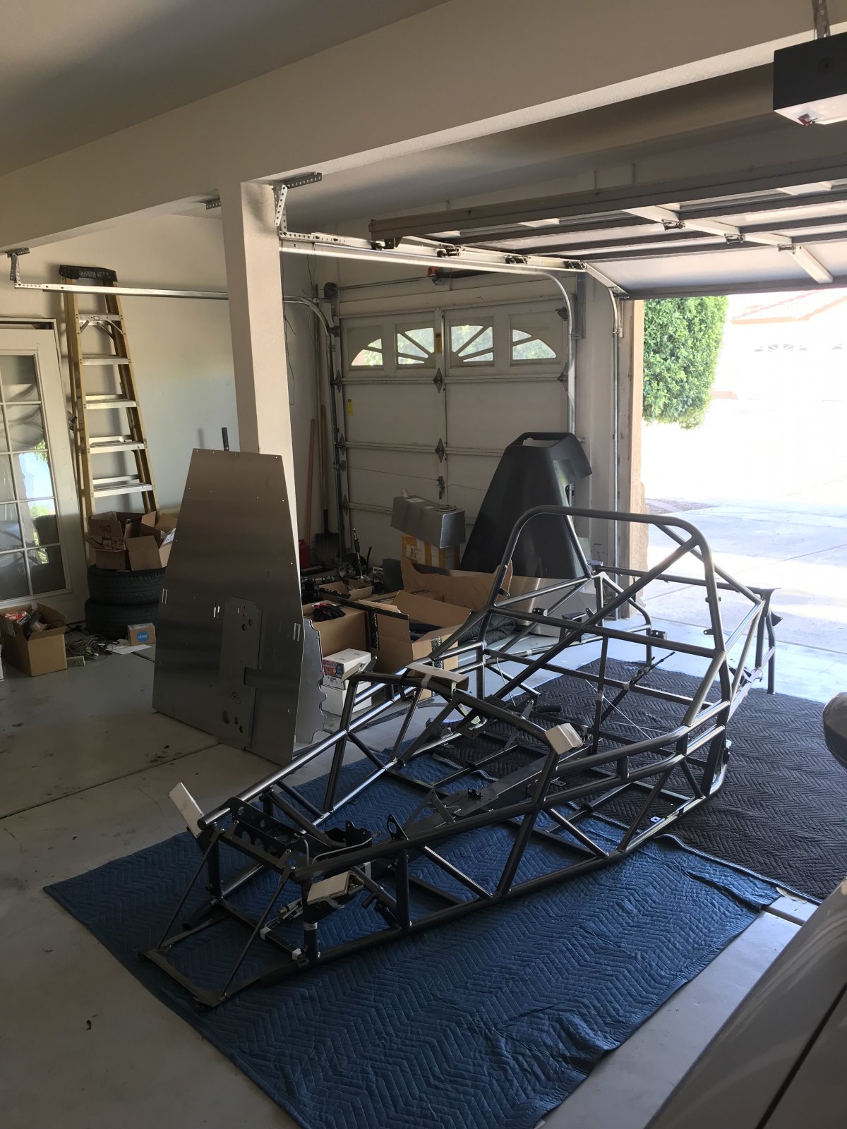

This car is going to be put together entirely too quick...lol Some progress!!

Did you pick up everything (all 3 stages) at once? I'm trying to get my trip semi planned and didnt know if everything would fit in a pick-up.
askiles
I did. I wanted to just make 1 trip, so I paid for and picked up EVERYTHING. On top of just my stuff, I also grabbed stage 3 for another Goblin builder close to me. It was an extended cab pickup so a lot went inside. Boxes and what not. They could have gone in the bed, but with the space inside and it just being me, I didn't need to. It worked well!! Rented the truck from Enterprise for $195. 1 day rental from Texas to Arizona.

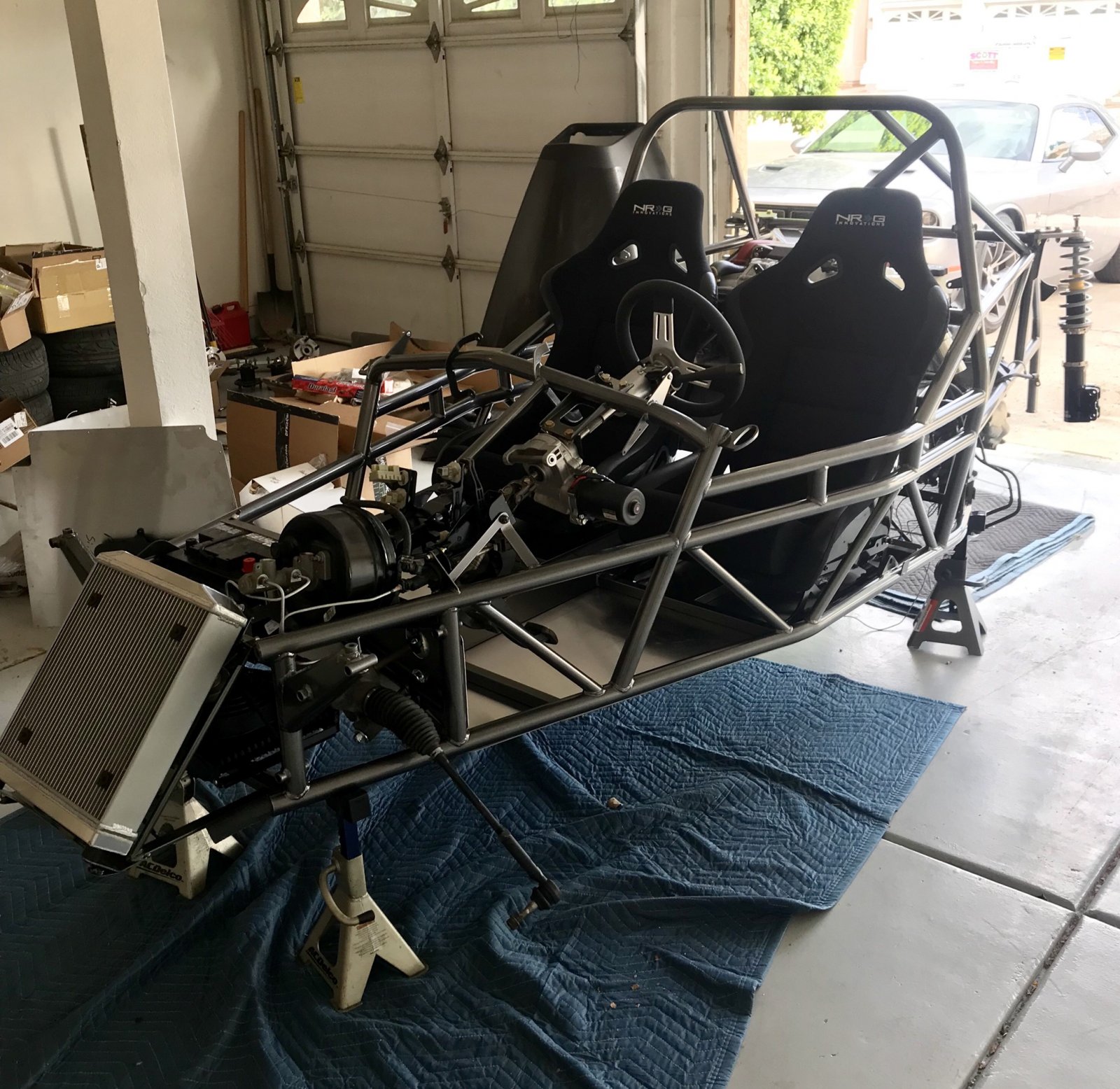

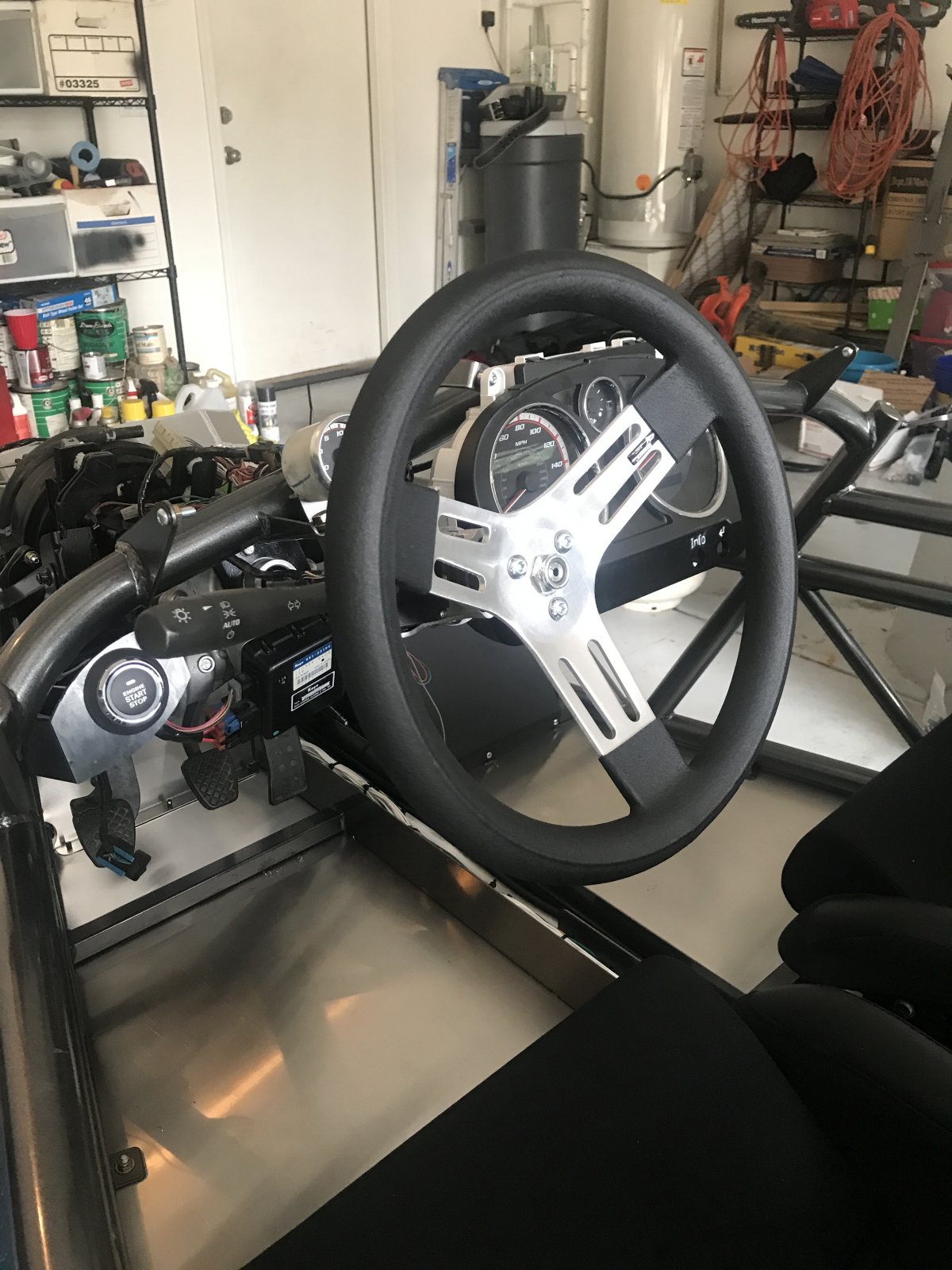

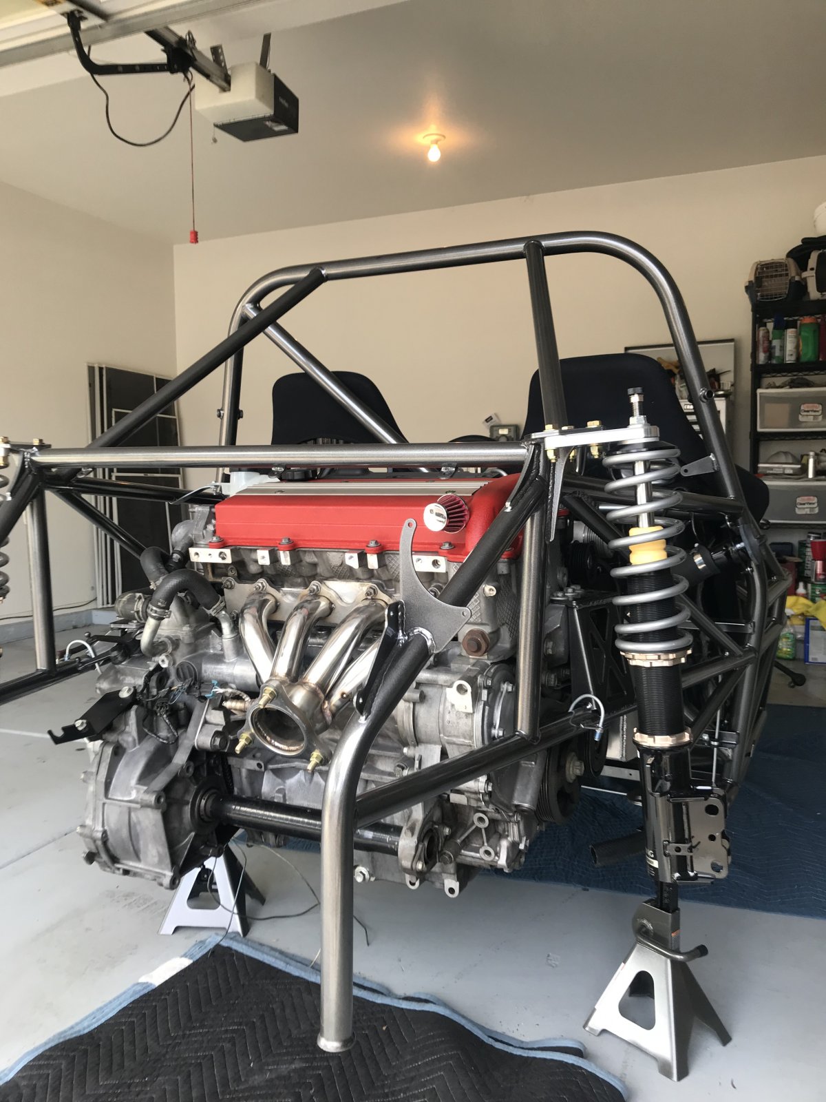

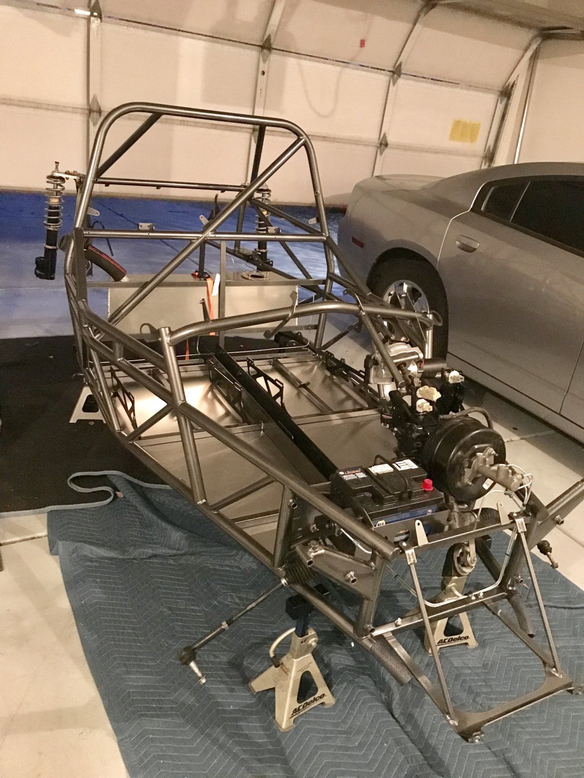

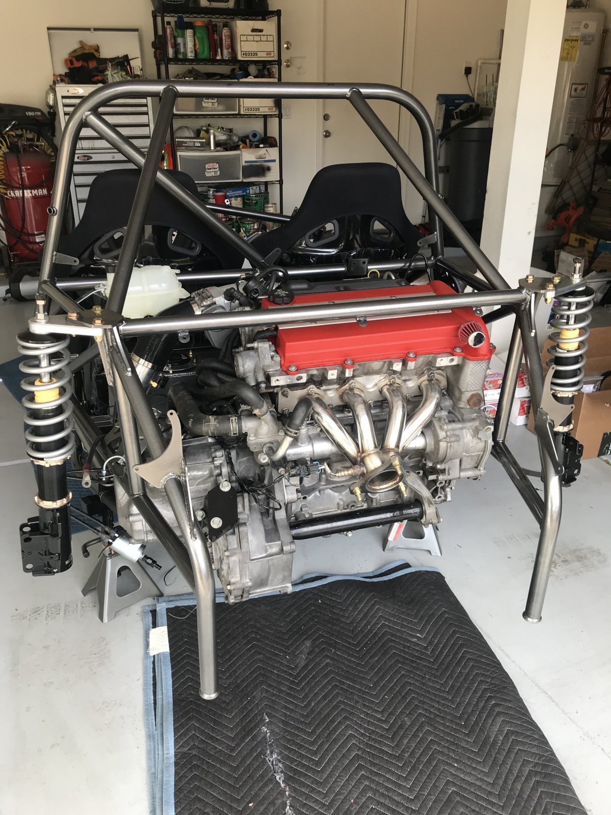

Progress for today. It’s coming together nicely.

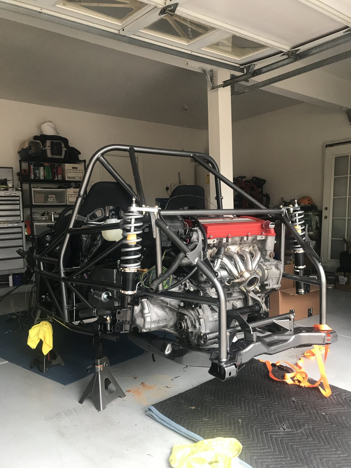

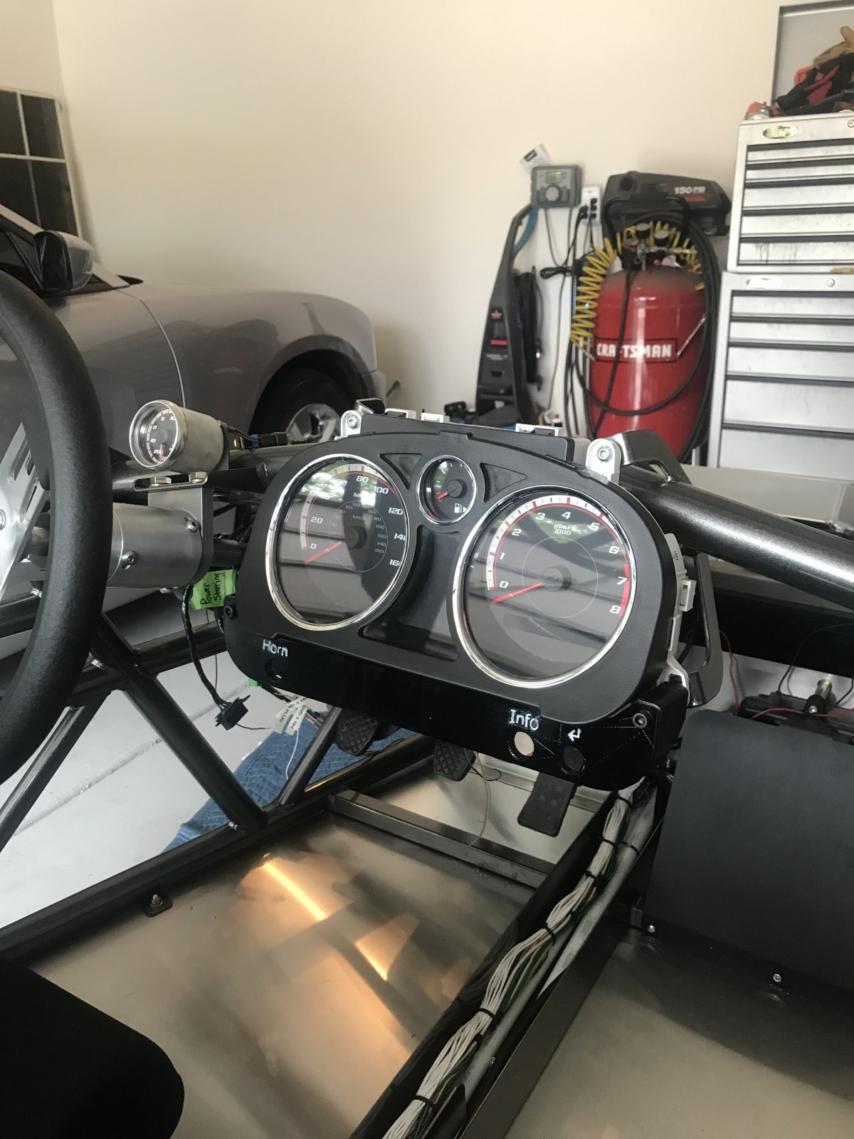

5/16/19 progress...
