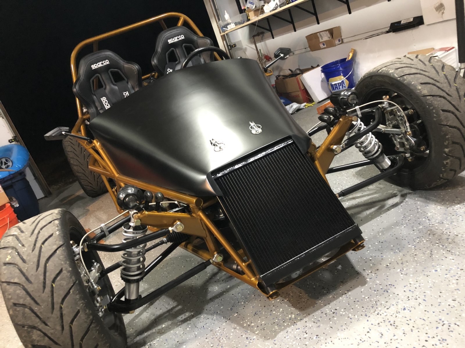

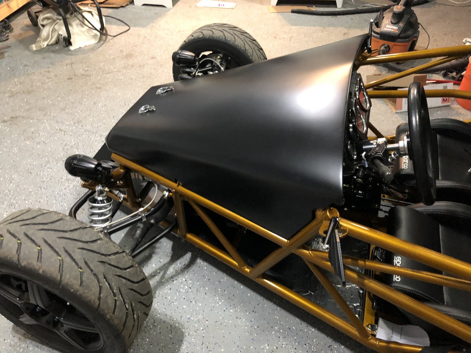

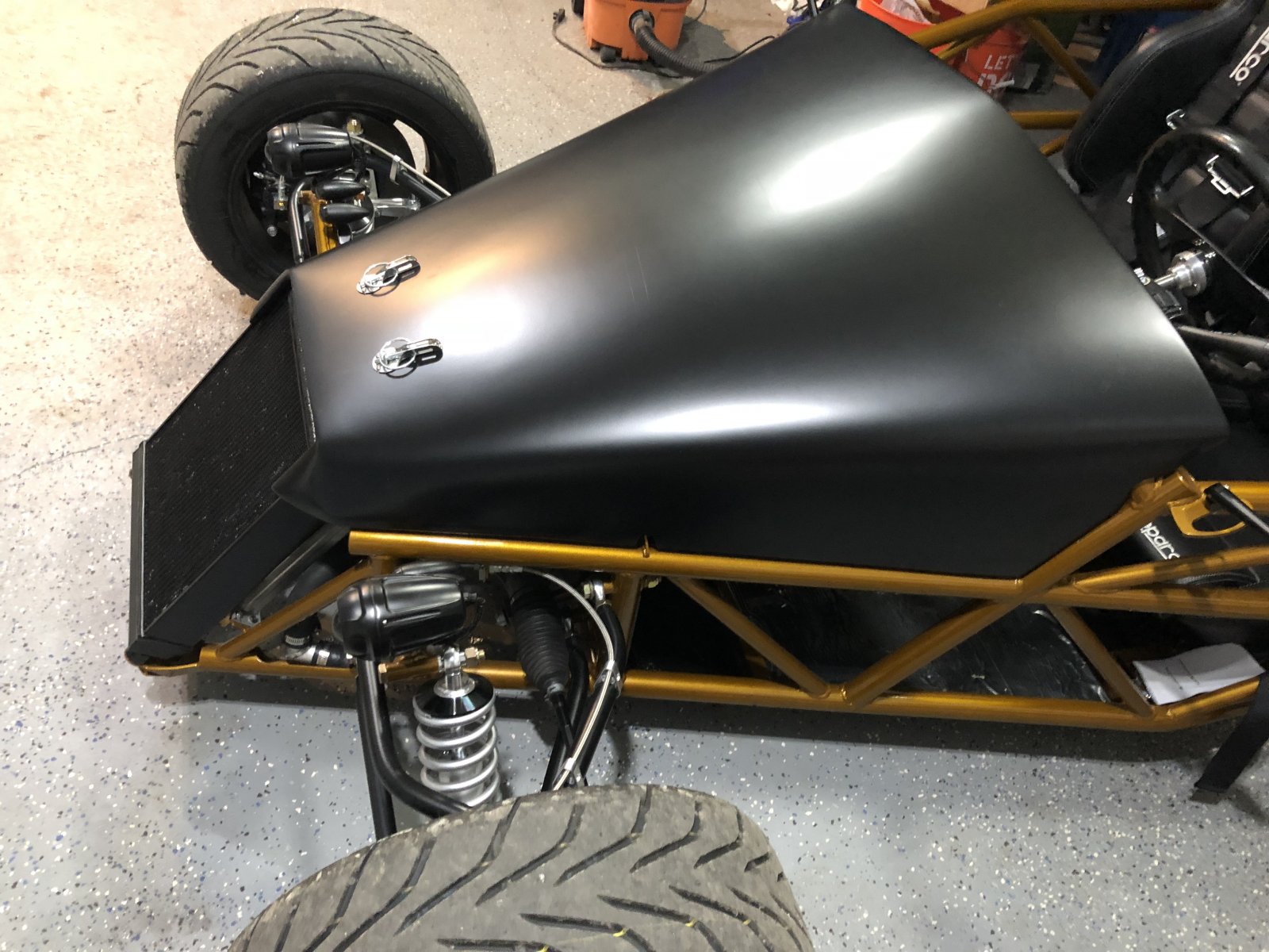

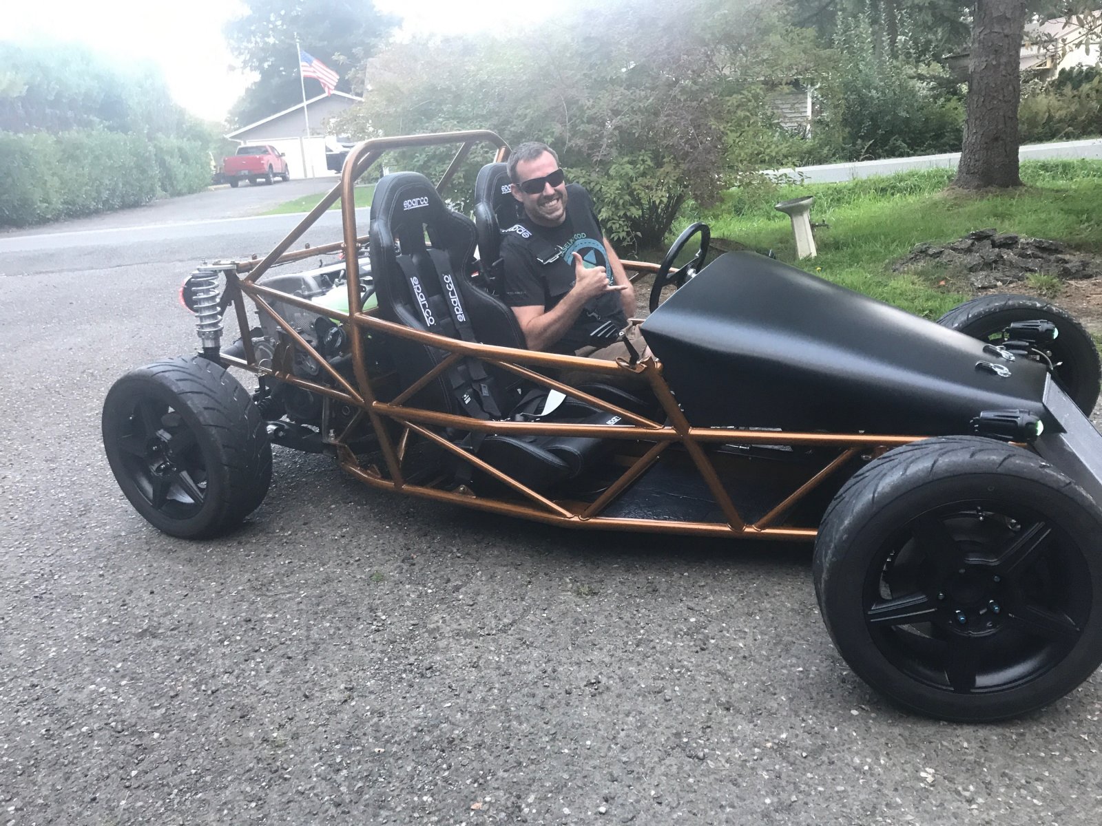

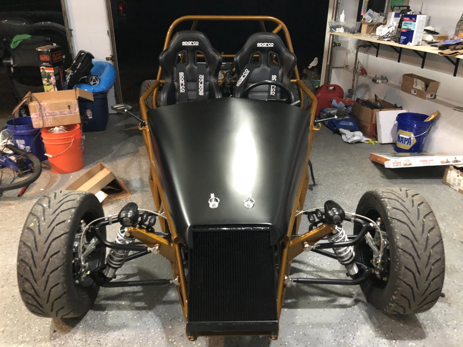

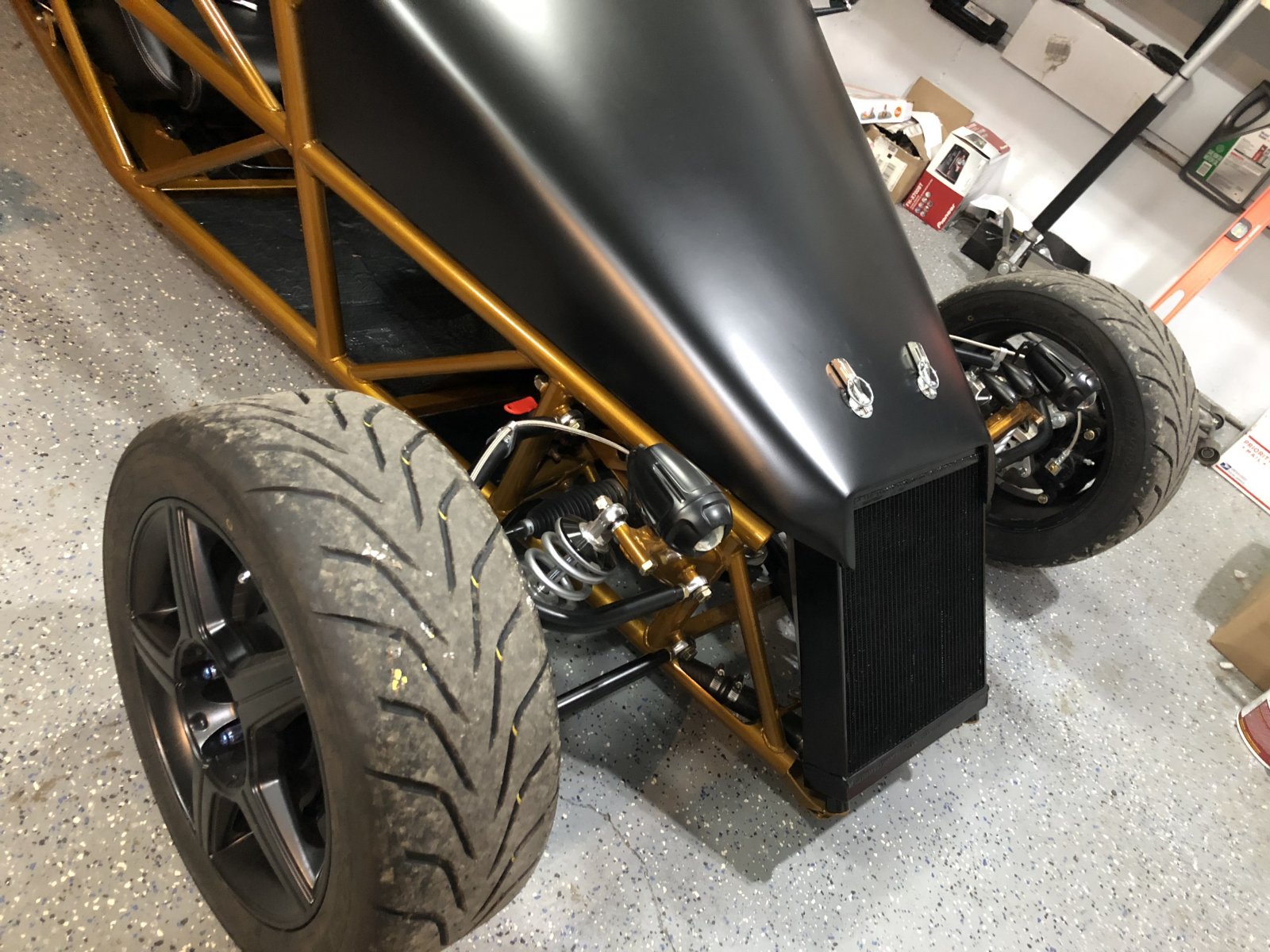

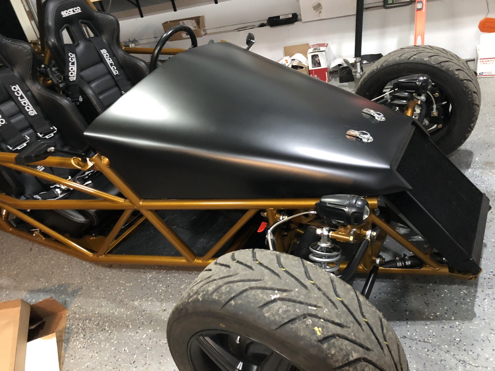

Oh yah here’s the hood I made:
Hopefully it will help you visualize what you want with yours. If I had a do-over I would have lowered the rear edge, making it flatter. I wanted it to shield the gauge cluster and cowl area, but the slope ended up much steeper than I would have liked.
