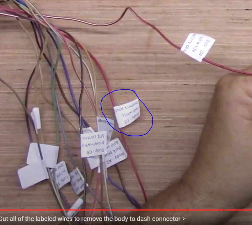

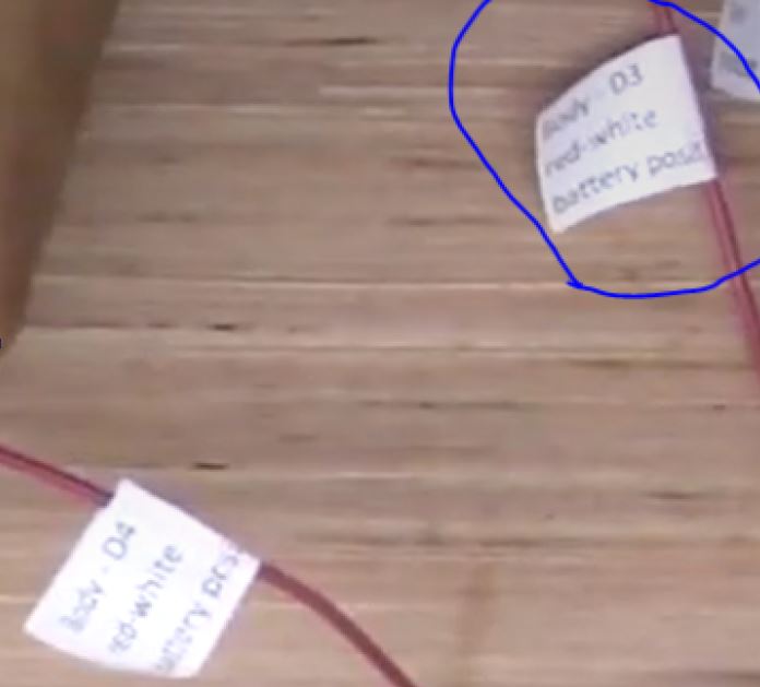

I am working through the end of the Wiring Harness Part 4 video and I noticed at 6:13 there is a Red-White wire labeled 'Battery Po...' this wire at this point in the video has already been cut. You have to look closely to see it but you are unable to see the entire word. Also D4 is labeled the same.
I have a TC harness and D3 Red-White was still connected to the Body to Dash plug at this point. My interest is that none of the label sheets that are linked in the description to this video are described as 'Battery Po...'. The base and SC do get this wire labeled but not with 'Battery Po...'. D3 had 2 power wires connected to it but one was trimmed earlier from an accessory power plug. The remaining wire goes to a fuse block. I am assuming it is ok to remove the remaining wire as there is no label for it on a TC harness? Maybe the linked label sheets got updated later to be called Accessory Power for the base model instead of Battery Power? Is Lonny working on a base model harness in the video series?
