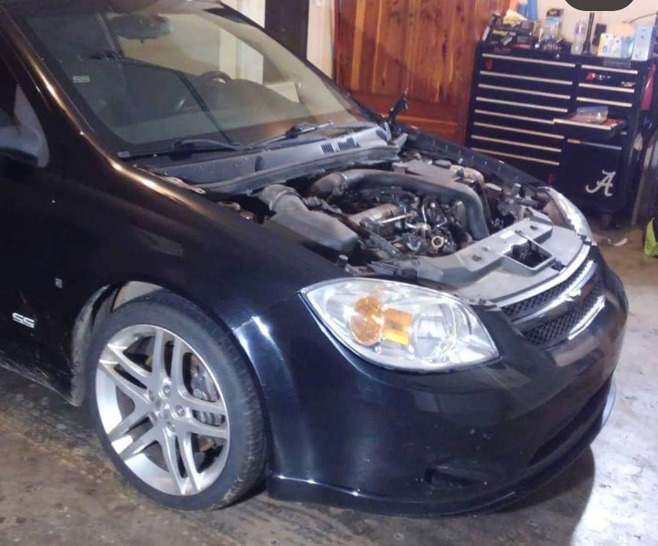

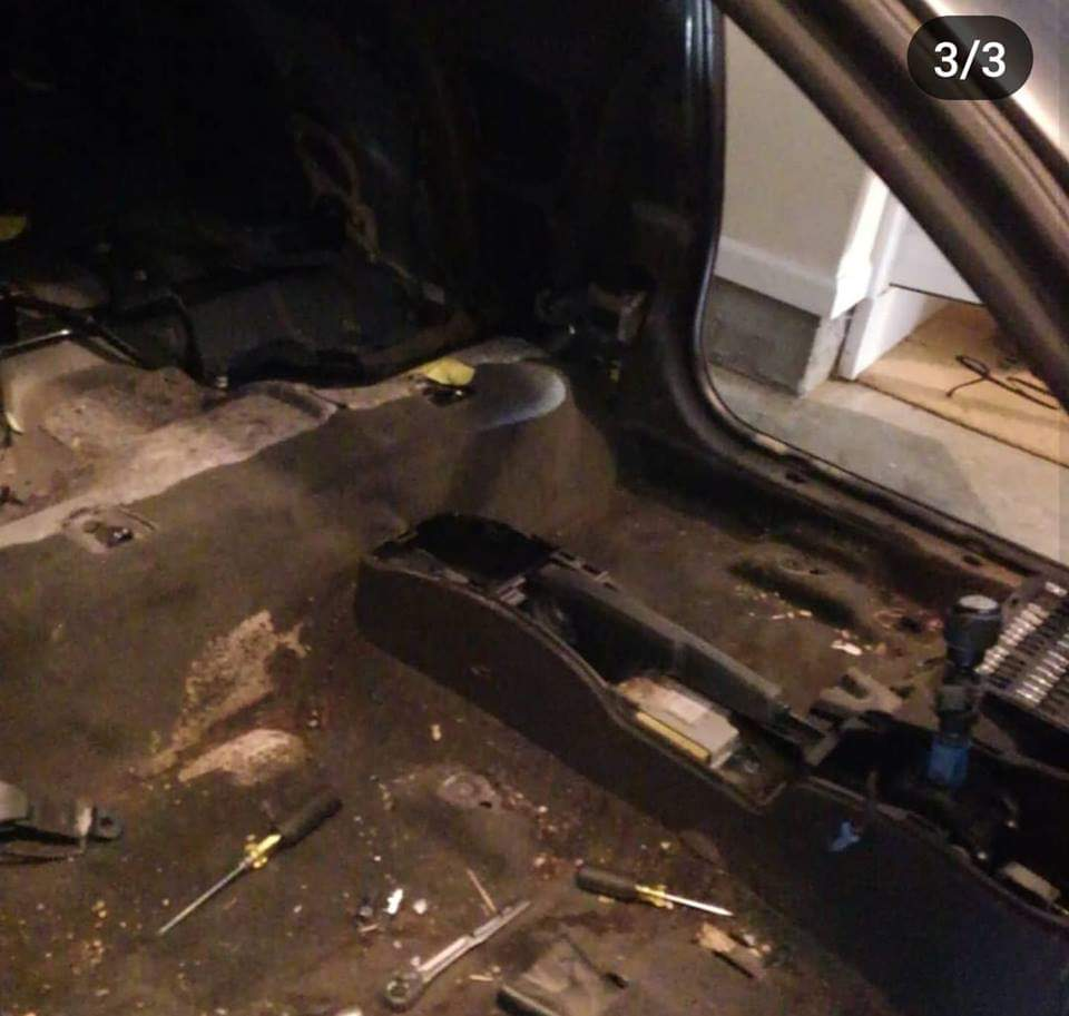

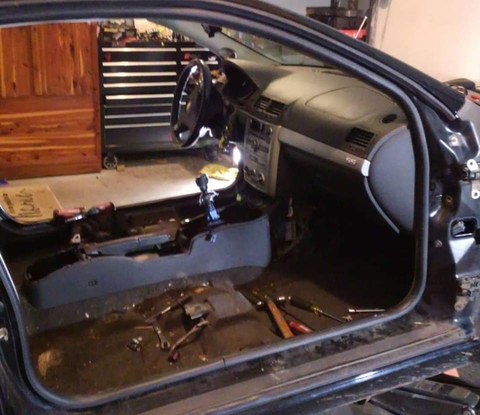

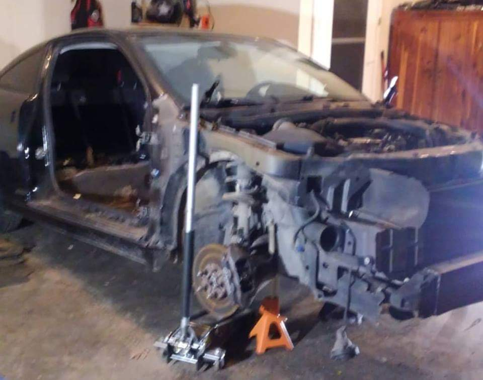

Here are a couple of quick pix, Almost finished with the 2nd video. I had some serious issues with the front lug nuts. they were gone... had to beat a 3/4 6 point on there and use the jack handle as a pry bar. then beat the lug out of the socket. It was a lot of fun. Also located a place to do powder coat and ordered some powdercoat samples. Going to try to get the Cowl off, wiper stuff out, side skirts off and trunk off sometime this week... maybe even hop on the dash.

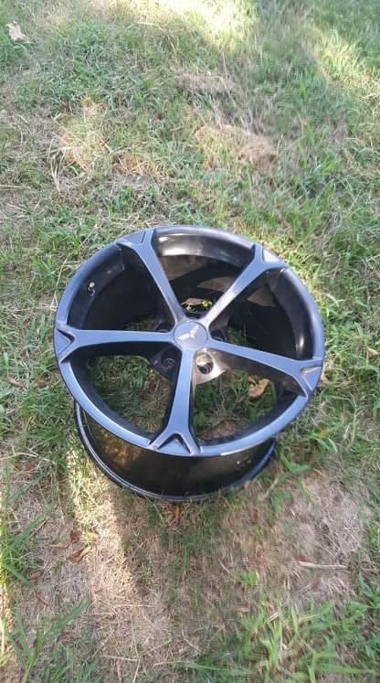

these are what i have. 2012 corvette grandsport wheels, Front 18″ diameter, 9.5″ width; rear 19″ diameter, 12″ width. I think the rears are to wide... and i most likely will have to just buy a set of wheels just for it.... or use the stockers and have them powdercoated
I do really want the wide tire look... i just like the way it looks...

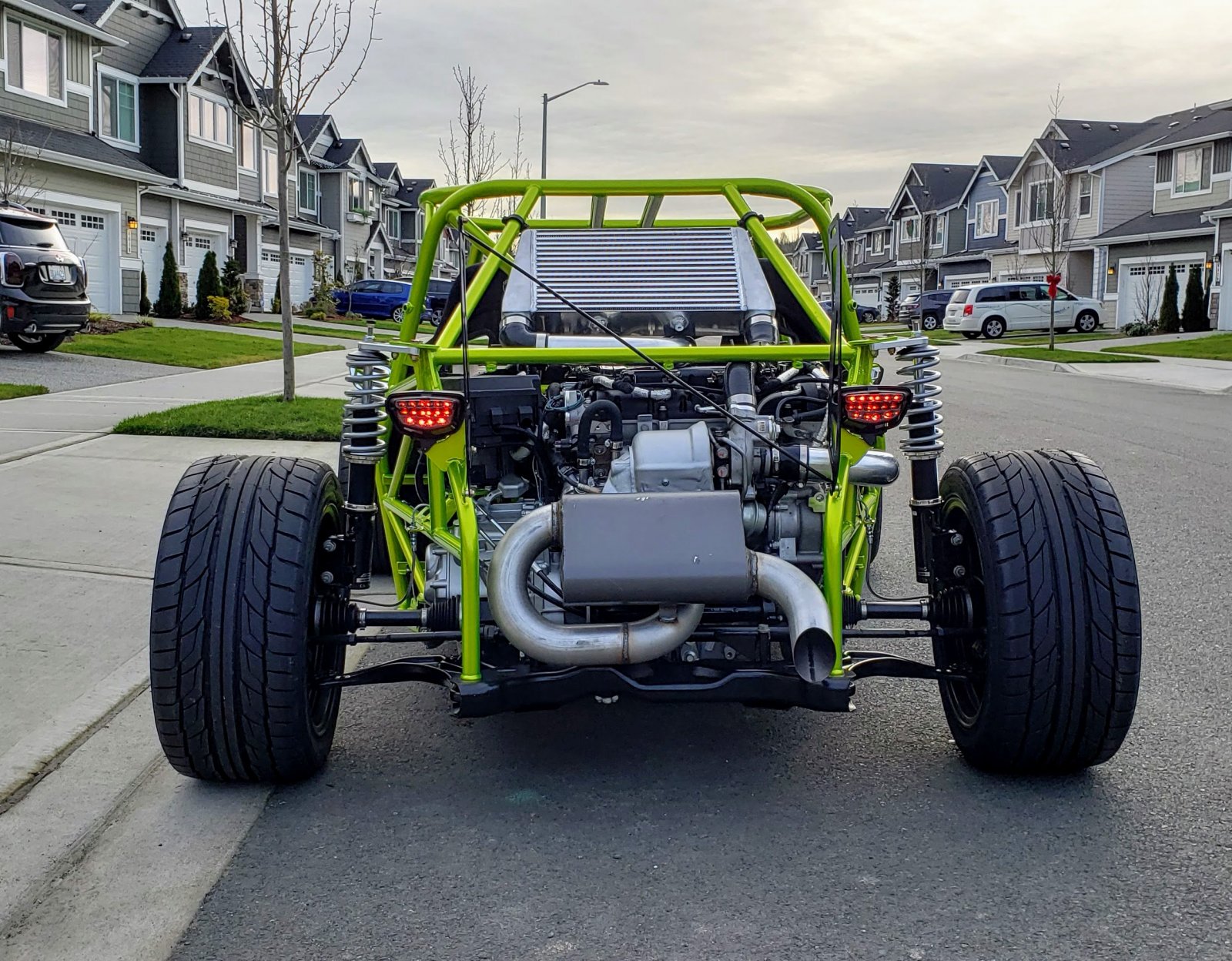

I am running 17x9.5s with a 5mm offset. They do not rub the front on full lock left or right. Offset will be much more important to pay attention to when you are looking for something wider.
275/40/17s on all 4 corners

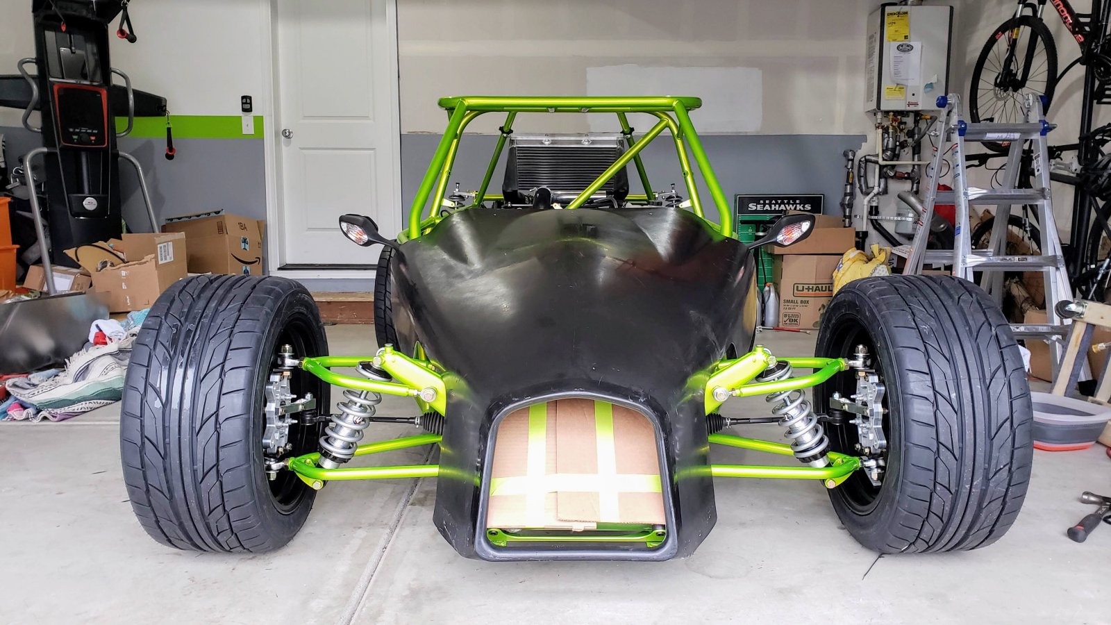

So i stalked your build thread, I noticed you have the wing mounts but not the wing? can you tell me the distance between the two mounts and the height from the chassis to the end of the bracket?
