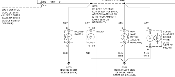

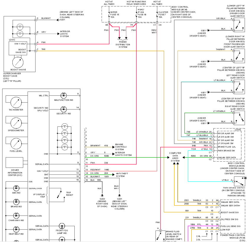

Alldata should have all of those diagrams also. I use Alldata at work and can see basically the same diagrams that Tony posted

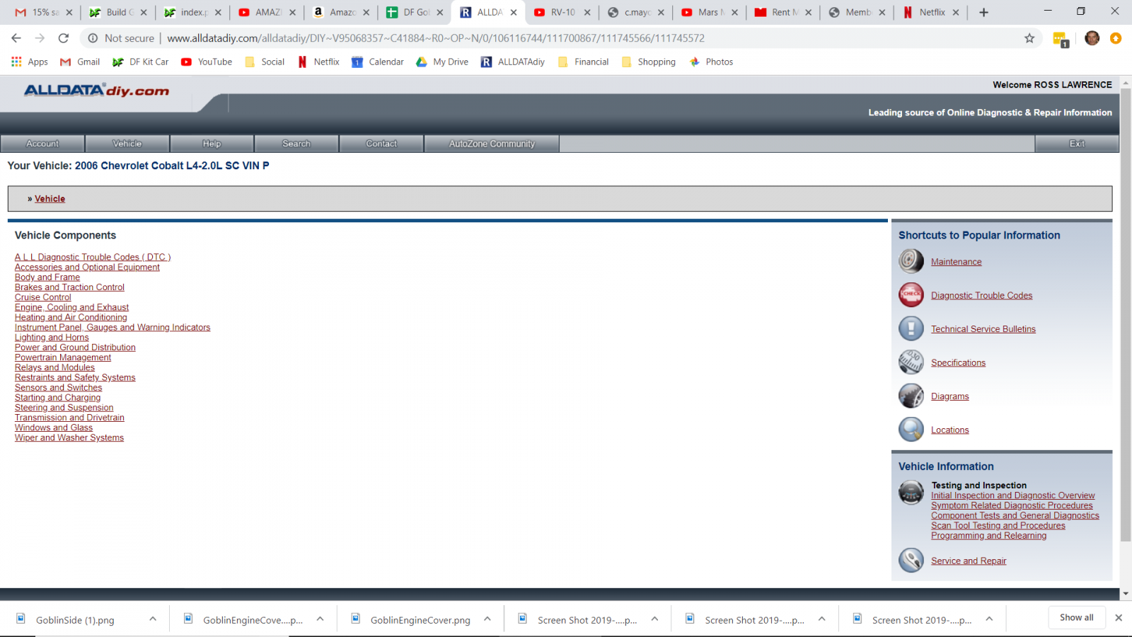

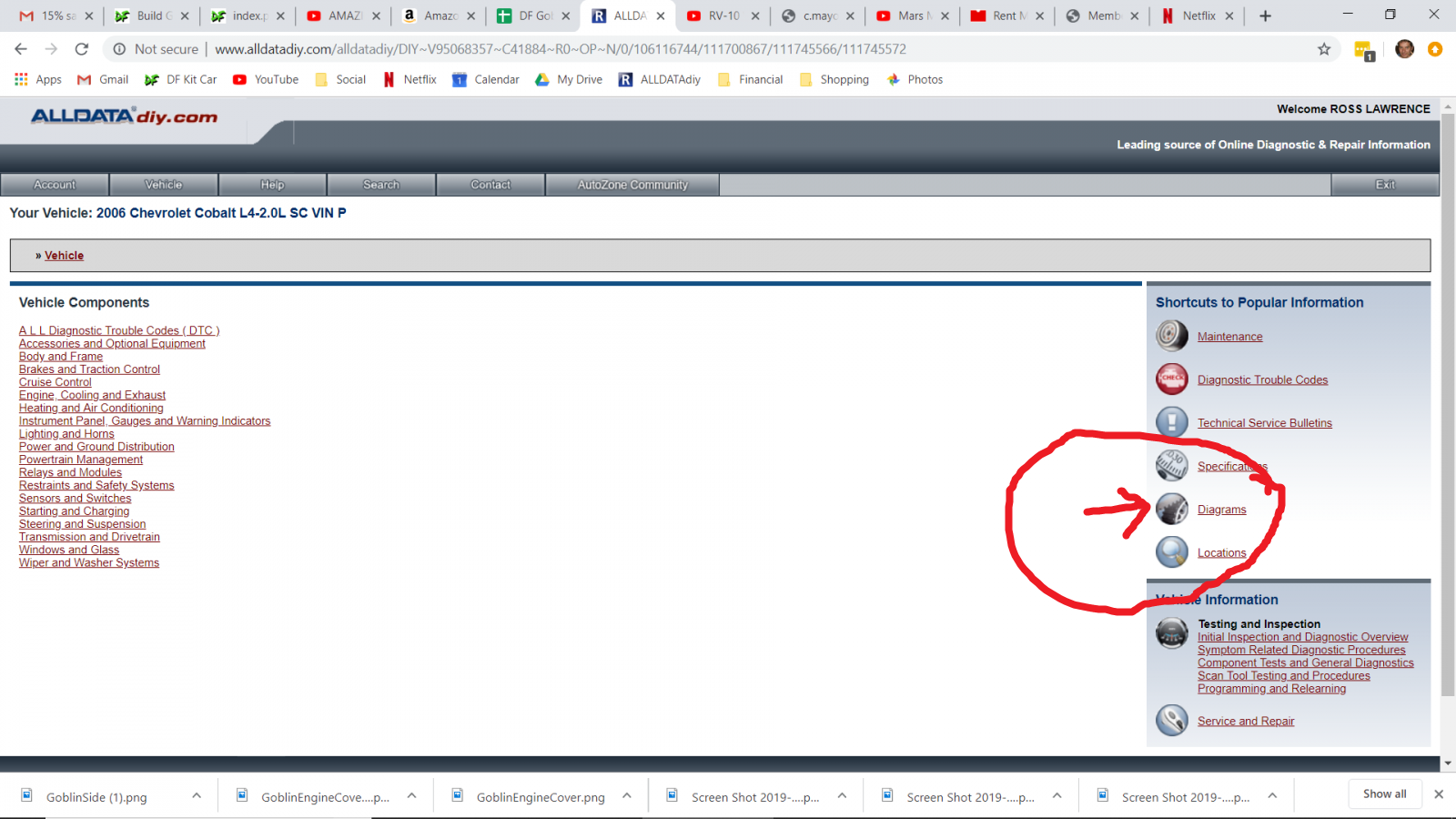

I wish I could find an interactive electrical diagram for the 2006 Cobalt SS. Can you show me where it is? I log into ALLDATAdiy.com, then choose my car, then get this main menu:
8760
I have gone down lots of paths in 'Diagrams' but I haven't found any interactive electrical diagrams.
Edit:
Ron (Karter2026) took a look at my ALLDATAdiy account, and it isn't the same as his work ALLDATA account.
It is a limited diy version, that has pretty useless electrical diagrams.
