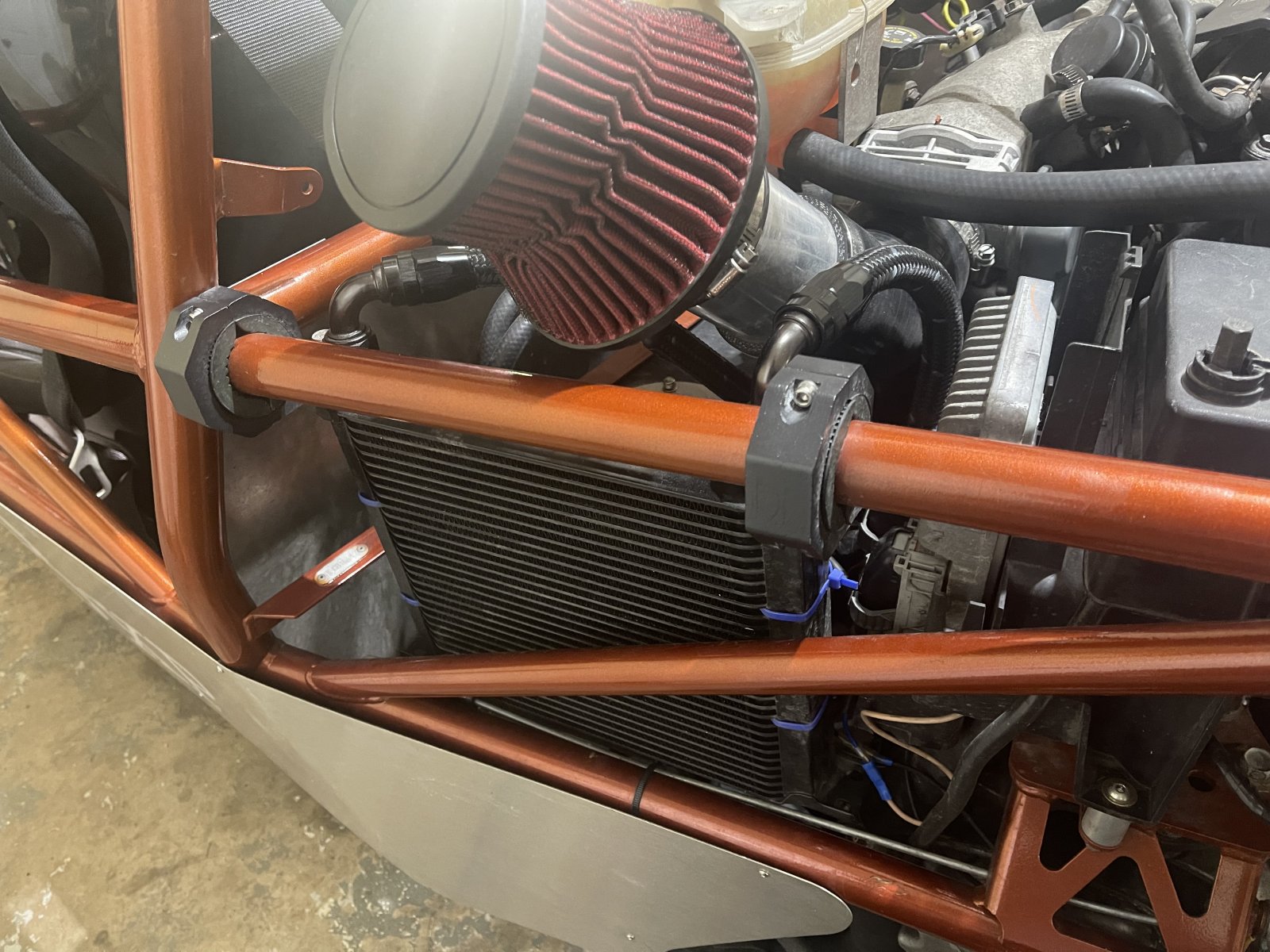

This is my oil cooler setup. Has a fan on the back sucking air in from outside the car. My guess is this is heating my intake pipe. I’ll try swapping the fan direction see if it makes a difference

I doubt that is the problem. I don't think there is that much heat in the oil. I would check the MAF iat sensor first by seeing how close to ambient it is on a cold start up, followed by a resistance check on the sensor. I can supply the sensor values for the later models but I don't know if they are the same.
Put a piece of tin around the intake pipe to deflect the air coming off the HE, if you think the HE air is contributing to the IAT. Reversing the fan will just pull warm air out of the deadspace between the firewall and the engine.

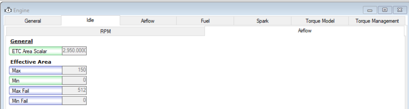

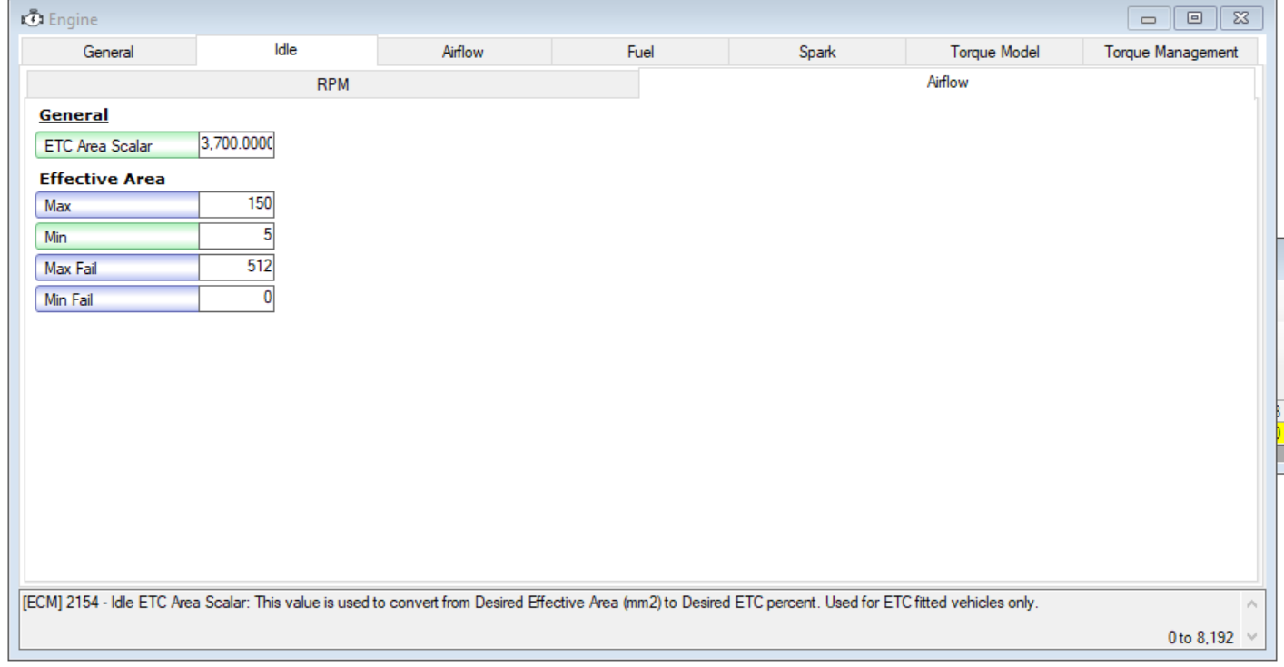

I don't know anything about the Cobalt SC but why have you changed the Idle Airflow settings, especially the min effective area?
And is it currently running MAF only tune and does it work better when running mixed tune or SD only?
Yours
41591
Stock
41592
I have changed the ETC scalar a while back because I had trouble with it pulling timing into the negatives at idle. The p12 ECM on the lsj does not have the base running airflow table unlocked in hp tuners and with the larger cam it struggled at low airflow/efficiency. by boosting the ETC scalar I was able to get the timing at idle to come up from negative. I did try changing the ETC back to stock after replacing the pcv but it made the timing even worse and would barely idle even after getting fuel trims to stabilize.
Yes I had tried both SD and MAF as well as both to see if either was causing the high rpm/negative timing issues. The tune I uploaded is in MAF only currently as that was where I had to leave off before getting ready for work.
What about the min etc area? I would think that would be the same as a vacuum leak since it sounds like that will keep the throttle open more than stock.
Keckster
I'm not sure what the min ETC area does to be honest. I didn't change that setting, had a guy helping me with tuning a while ago but wasn't working out. I'll try changing it back to zero though tomorrow!
