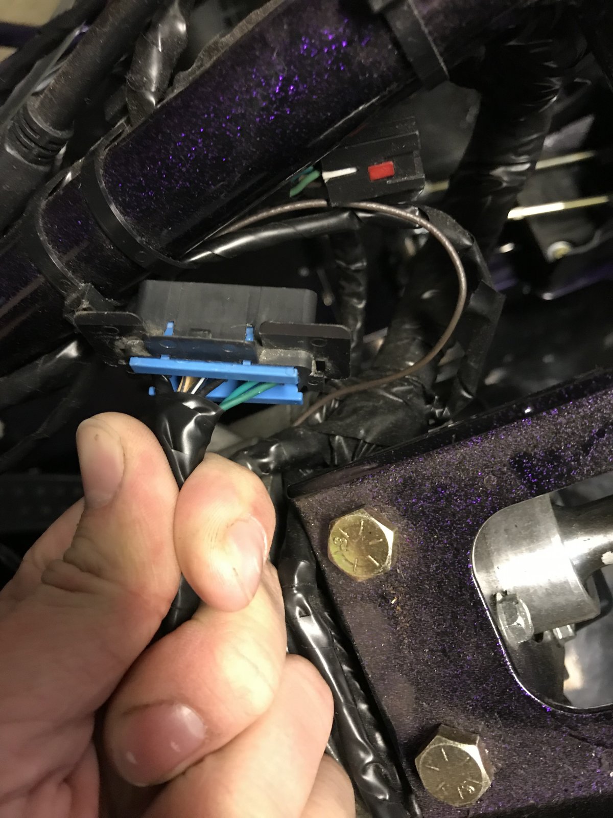

But I was going to test drive it yesterday but once I started it up my afr gauge was reading at 16-18 which is really lean if you don’t know what I’m talking about. Then I talked to the guy who tuned my car before he said it’s cause my maf is in a totally different spot... so with that being said i have to go back to my OBD2 I have power and both grounds are working and I know the data wires are right (because they were wrong the first time) so that leaves the 2 green wires on the top right of the plug I think spots 1 and 2... I just need to know where they go to
canyon bolieu

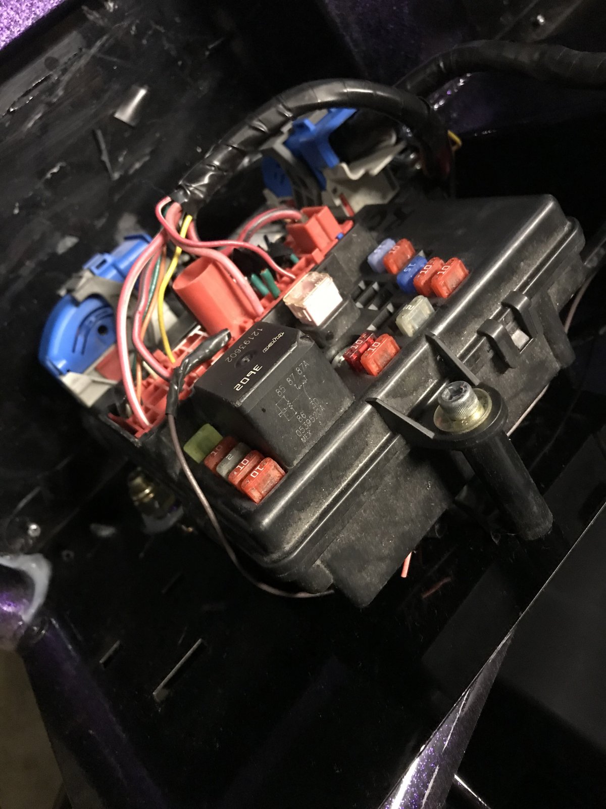

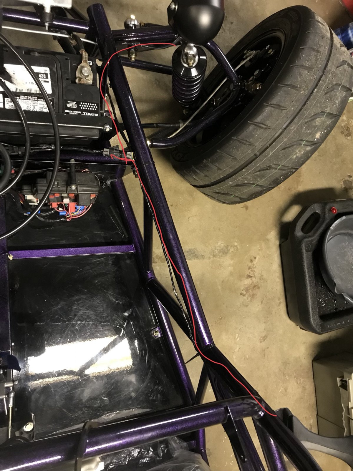

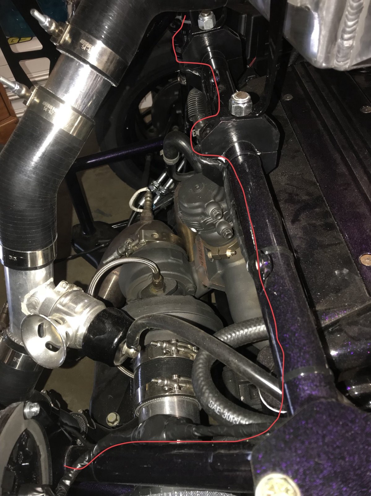

Okay so I have figured out my OBD2 problem whenever I would plug in the scanner one of the relays would click I so I removed all of them one by one with the scanner plugged in to see if it would cut power or do anything but nothing happend so it’s in the fuseblock I’m guessing then I decided to call Lonny and see what he though about running another one of my cut power wires from the bcm so that is what I did and she works just fine now
My OBD2 reader came with directions that said that my Cobalt would need a separate power. Never understood why.

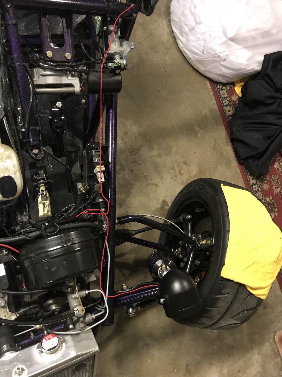

Well I got the rear taillights wired up along with the wing taillight but still bleeding the brakes... I let them sit for 4 days while I was at work and even the new bleeders are leaking and the fittings are leaking on 2 of them I over torqued them and I’m sure they are close to snapping or pulling threads I have no idea why they would still be leaking the surfaces are smooth and filed down to bare metal and both copper washers are there this is just wild and very aggravating I’ve went through 8 bottles of brake fluid just bleeding through the system. I’ve got them close to where I’m holding pedal while the car is off but once I’ve started the car the pedal slowly sinks. But I don’t want to keep bleeding them if I have to pull the lines back off maybe I can put PTFE on the copper washers and maybe it will seal?
You may want to look very closely at the fitting surfaces. There must be a groove or scratch or something in them causing the fluid to leak. The copper washers should seal them up easily but if they are not, it has to be something more than what they can seal. Maybe a crack in the fitting or a bad mating of the tubing to the banjo?

Okay guys my brakes are finally working! Yay!
I also finishing wiring up all the lights last night.
I then took the car for a ride at 11pm when it was 42 outside but it was totally worth it. I wish I had a video for you guys but the go pro was very glitchy so I just deleted it.

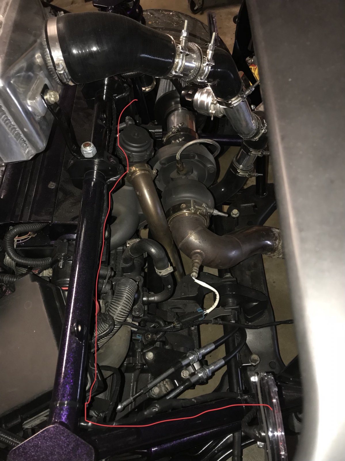

So with that being said I’ve got the first drive out of the way and now I need to tune it. Afr is terrible and if I’m rolling in neutral it will rev up and hold at 3k RPM to stay alive I guess... it’s pretty weird but I’m going to put a base tune on it Sunday then on a warmer day rent a dyno and tune it.

Great job. Make sure your MAF and O2 are connected and functioning properly. Mine goes nuts which either of those things unplugged.
