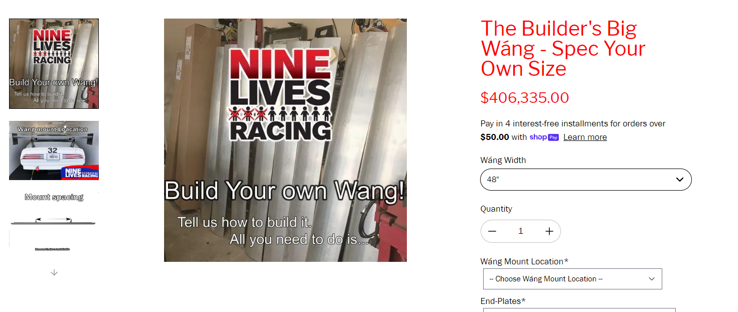

I just got a 48” Big Wang for $185 shipped on 9LR’s “auction” page. I hope I get a sticker too!
Wat, I looked all over their site and couldn't find an auction page. Their 48" build your own was a little out of reach
