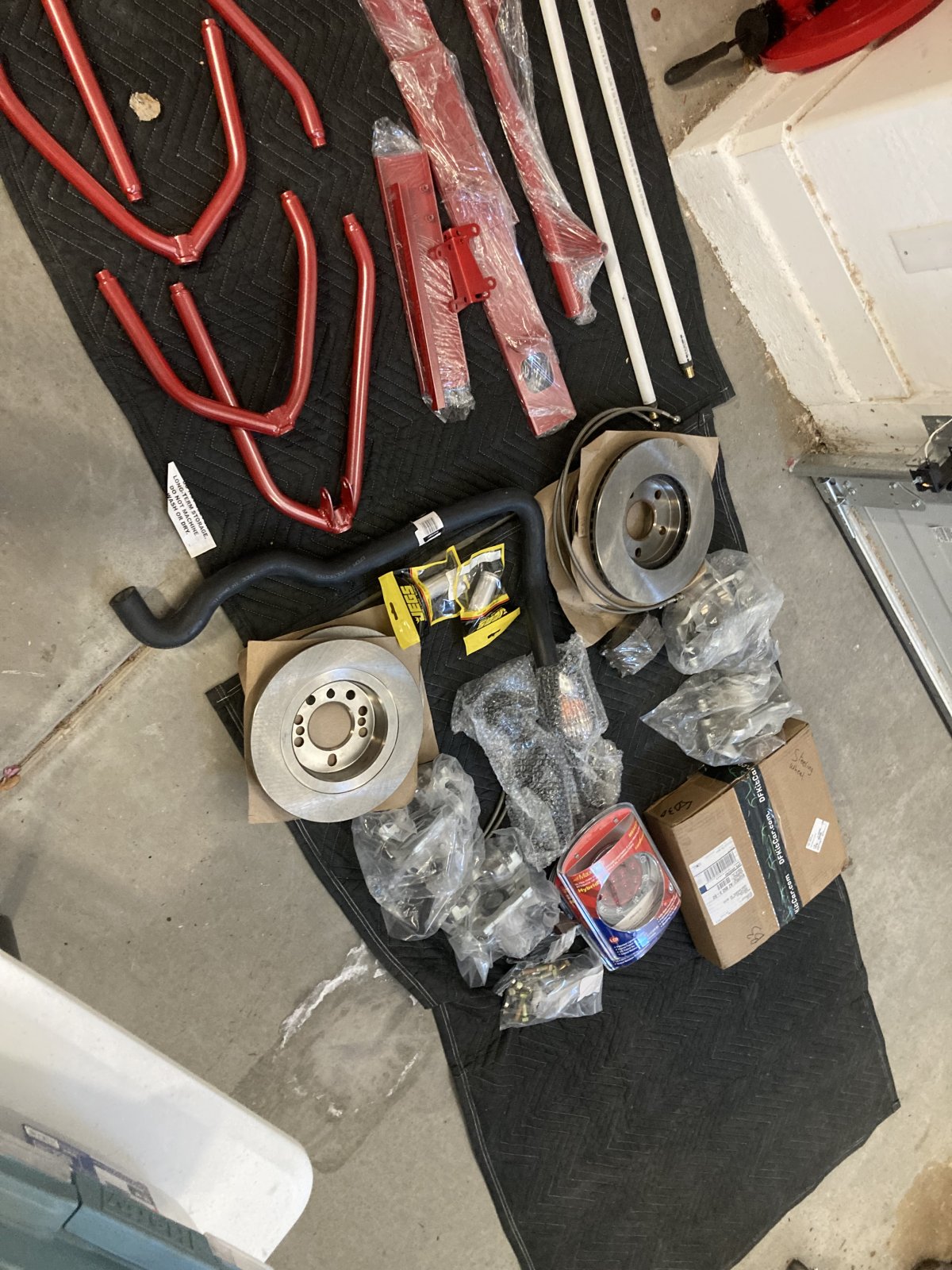

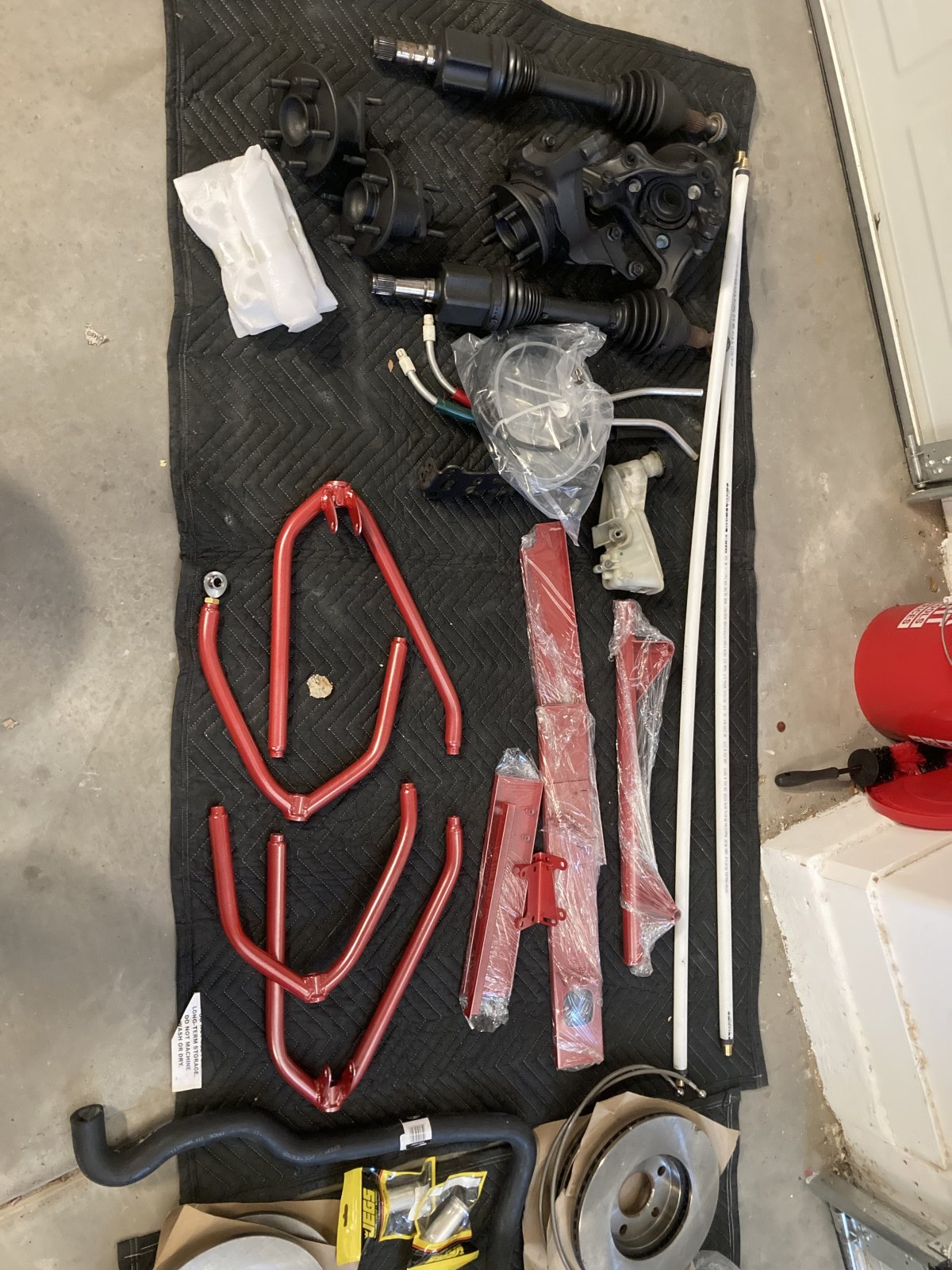

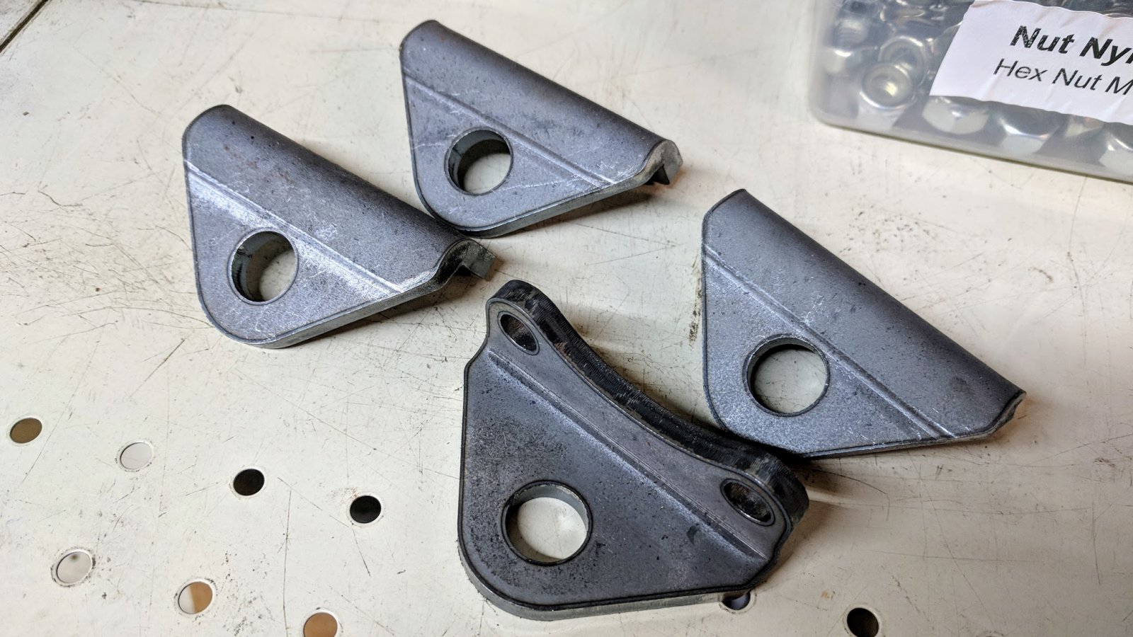

Suspension Question: So I'm starting stage 2 of the goblin and was wondering if anyone remembers what bag contains the steel rod end mounts? I can't seem to find them in the suspension hardware bags. Thanks in advance.

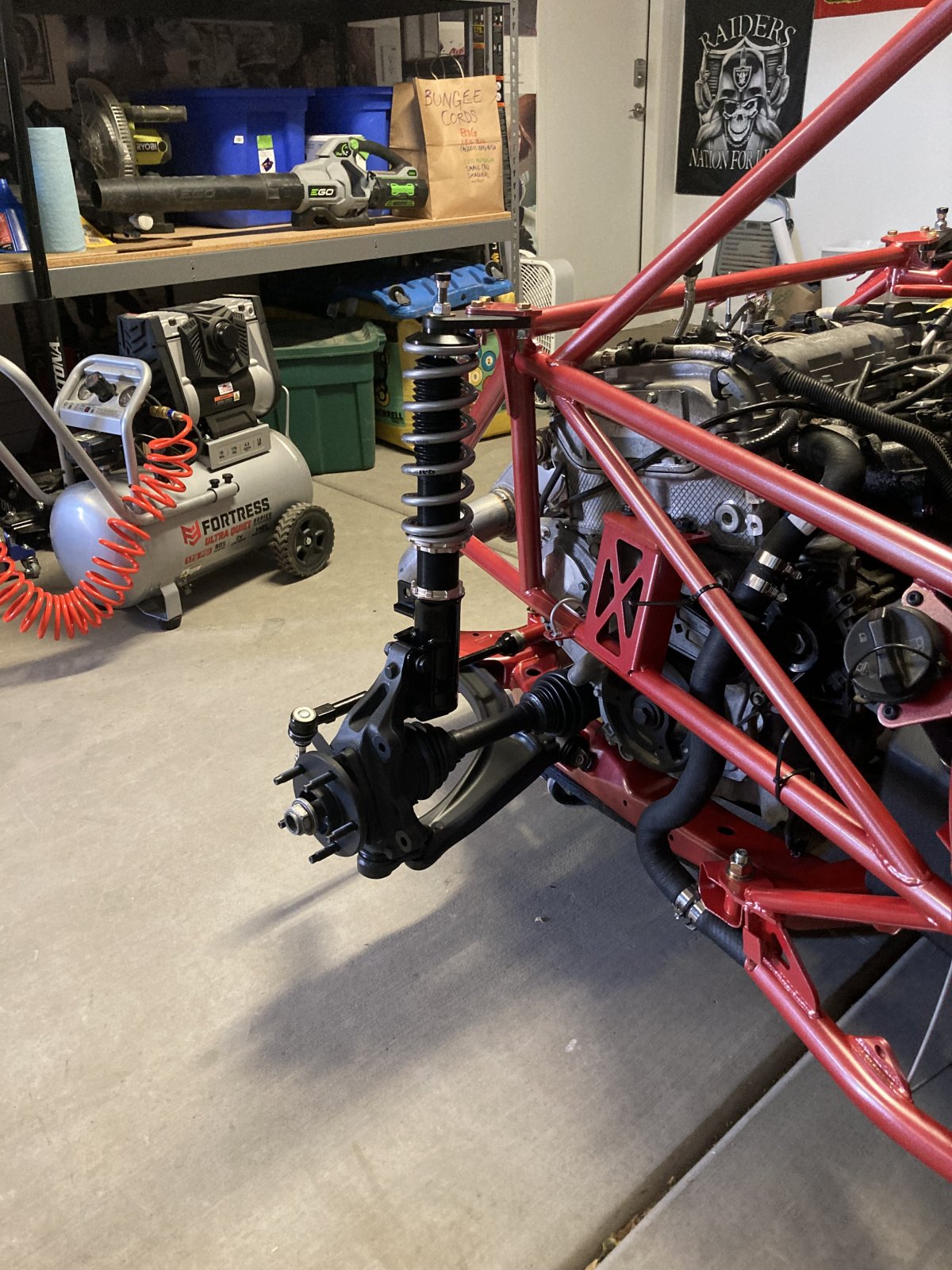

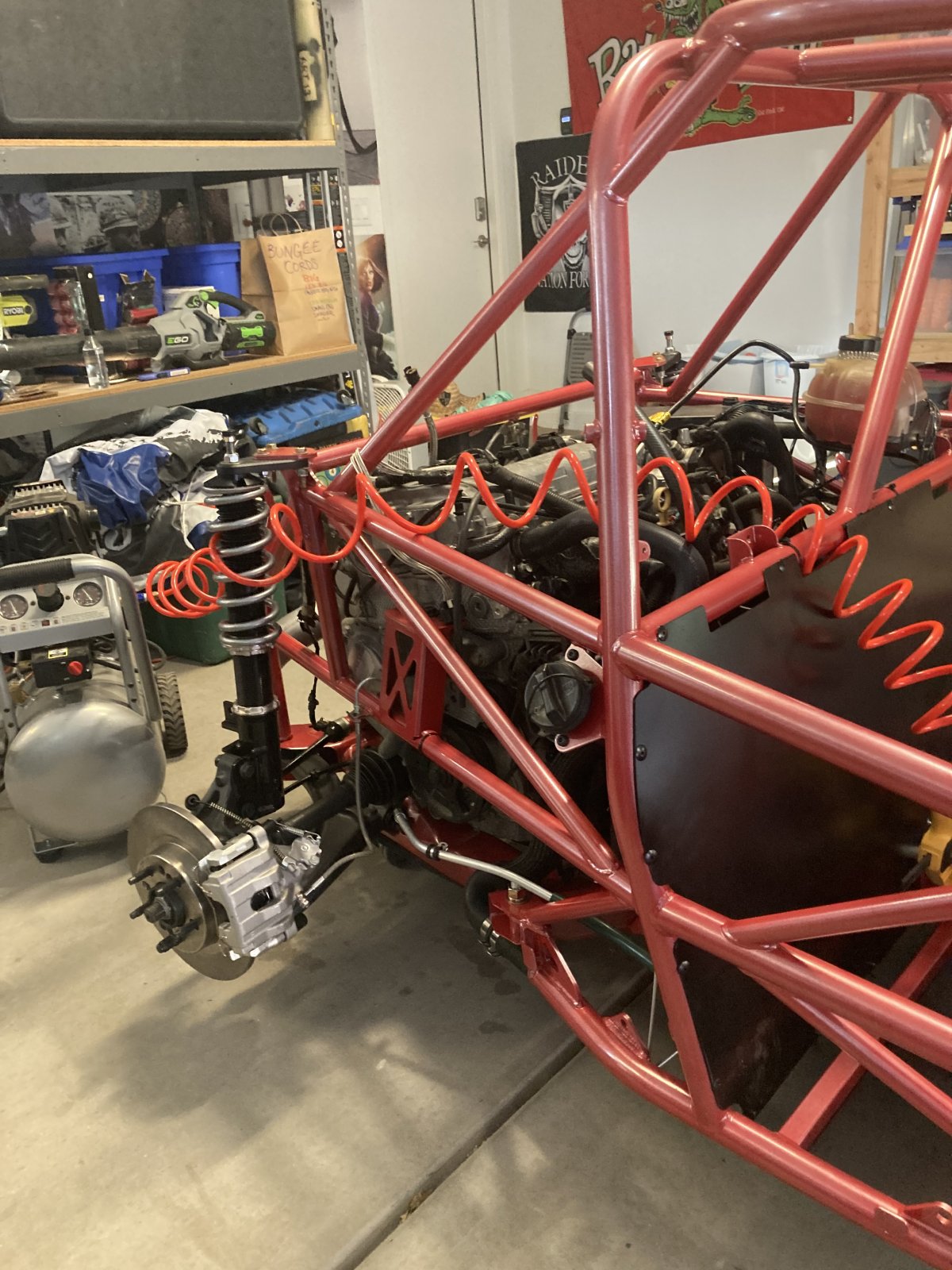

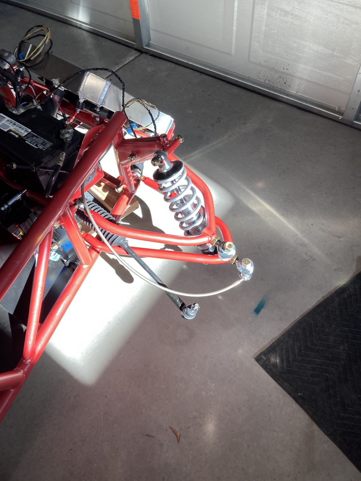

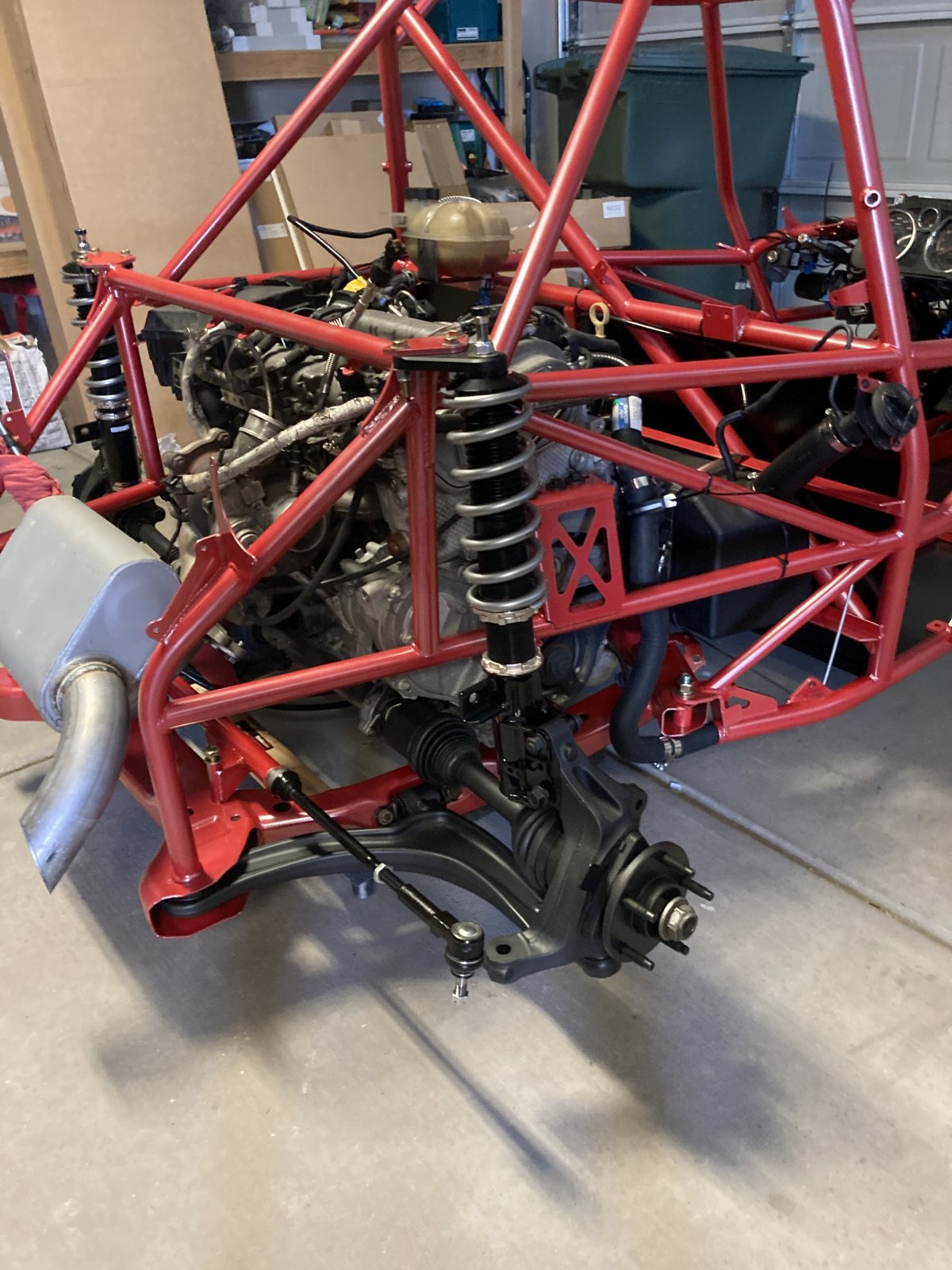

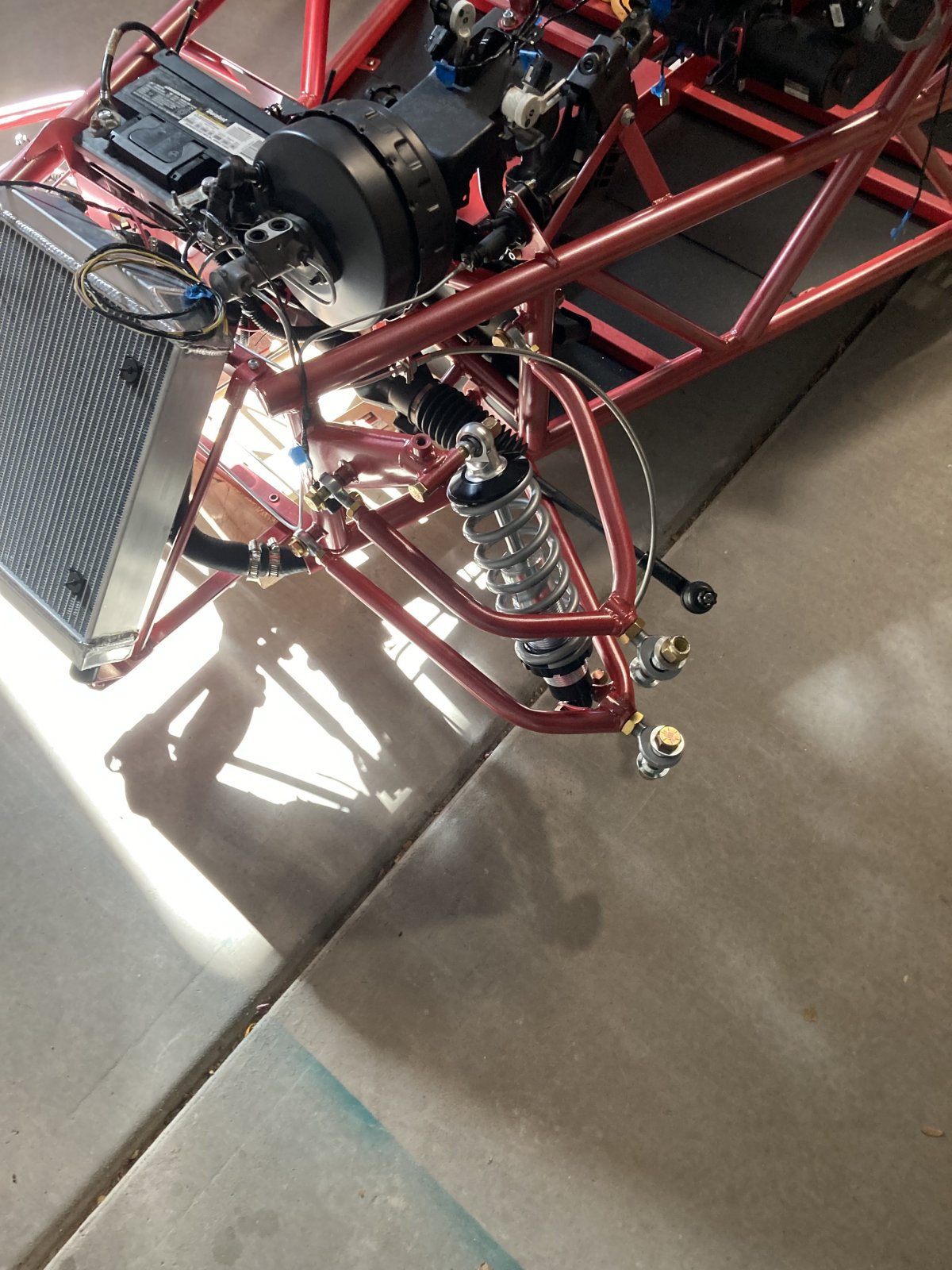

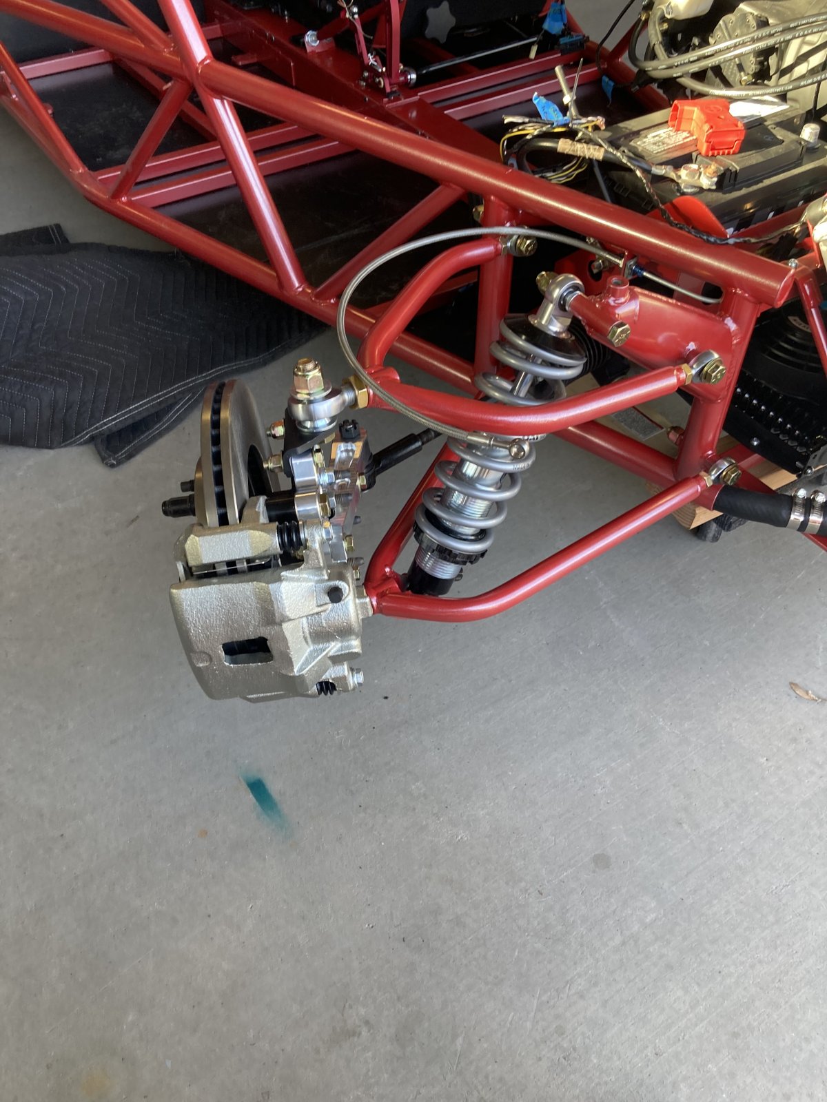

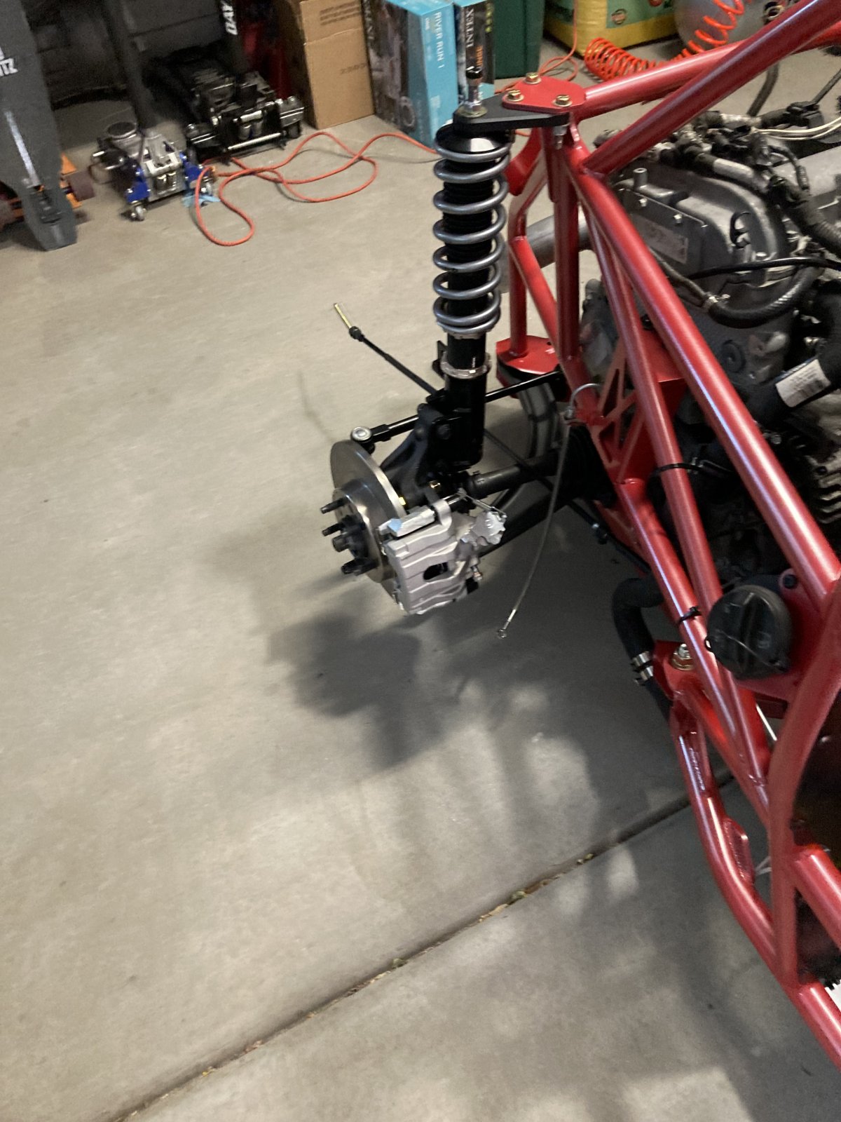

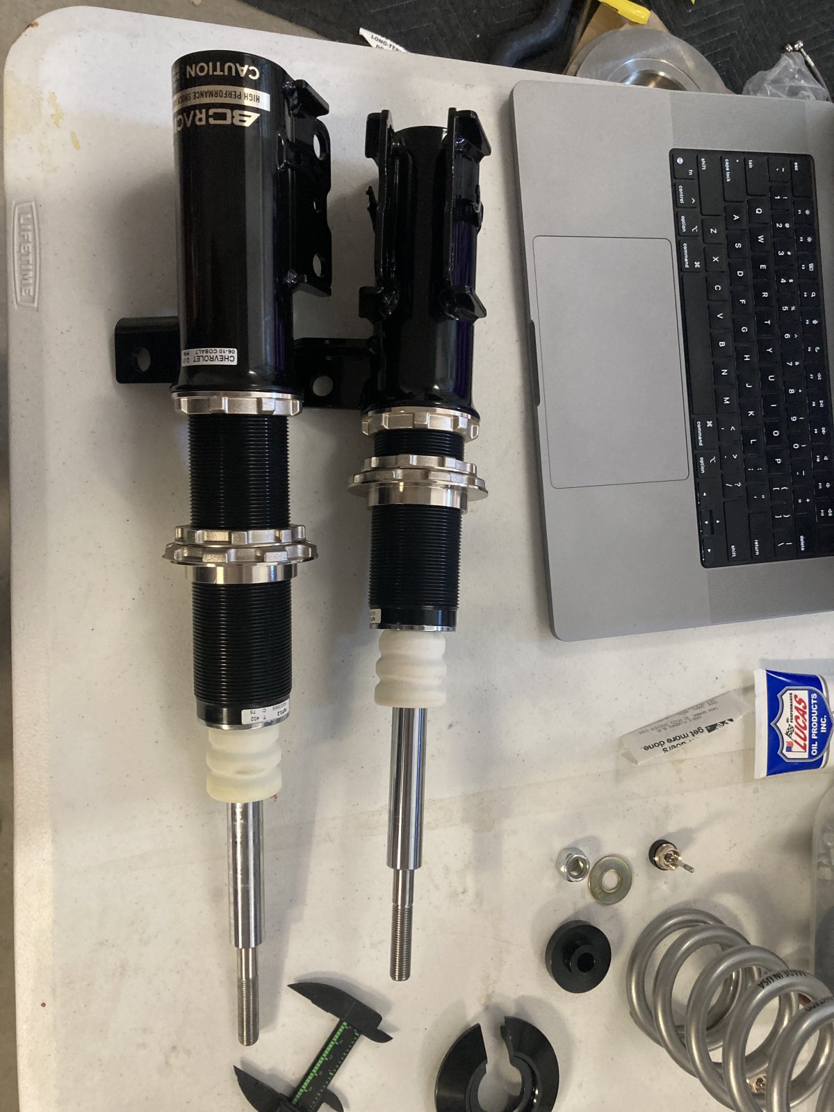

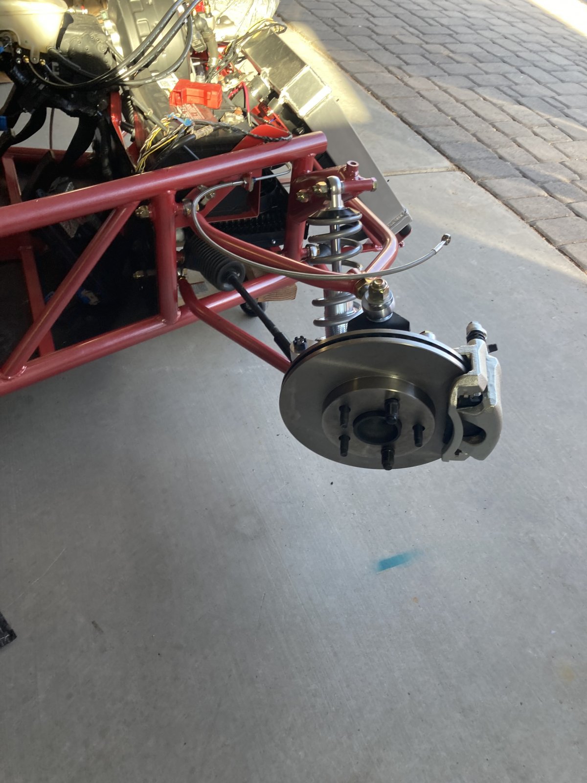

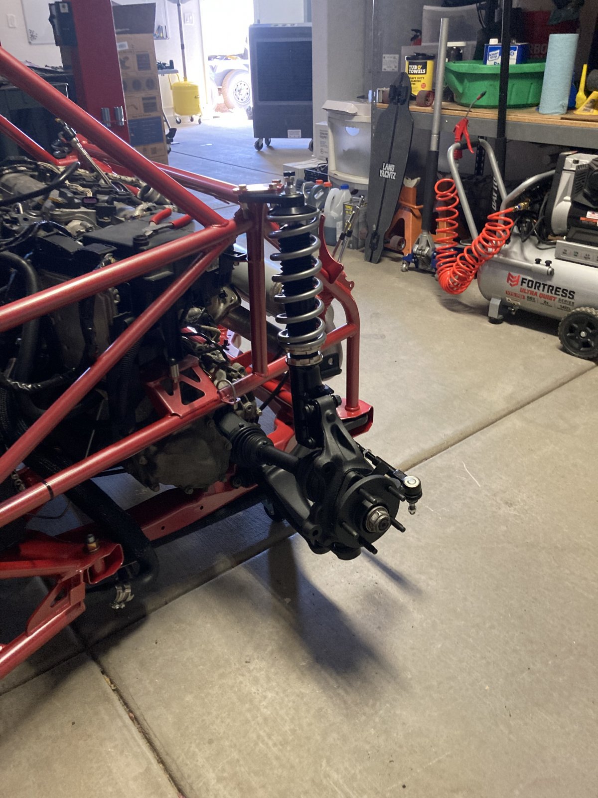

Some more progress today, and another suspension question. The rear coil overs are labeled FR and FL, I assume Front Right and Front Left. The FR coil overs are about two inches longer. What is the reason for this and does it lead to a mis-match in the number of threads left on the shock?
A good starting point is to thread the shock unit into the strut body until you can measure about 3.5" by pushing a tape measure up into the bottom of the strut body. Once on the ground, you can tweek for your desired ride height.
You have a mismatch on the struts, those should be identical in length regardless of side. Did you purchase with your kit or buy separately? If with the kit contact Adam and explain what the problem is.
Were these assembled coilovers or are you saying some of the individual parts are longer on one side than the other side? The overall length of the assembly is adjustable so different lengths can be fixed.
C
Hey Gtstorey, I think you are correct. If I check the bottom of the shock there is space between the barrel and the bottom of the shock are different between the two and matches the difference I see in the threaded barrel. I take it off and adjust the overall length tomorrow. Thanks for the info.

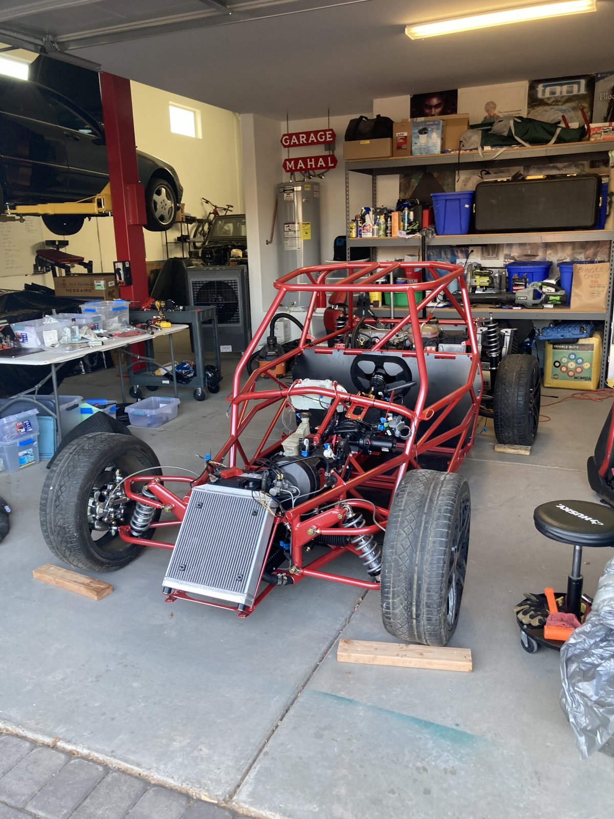

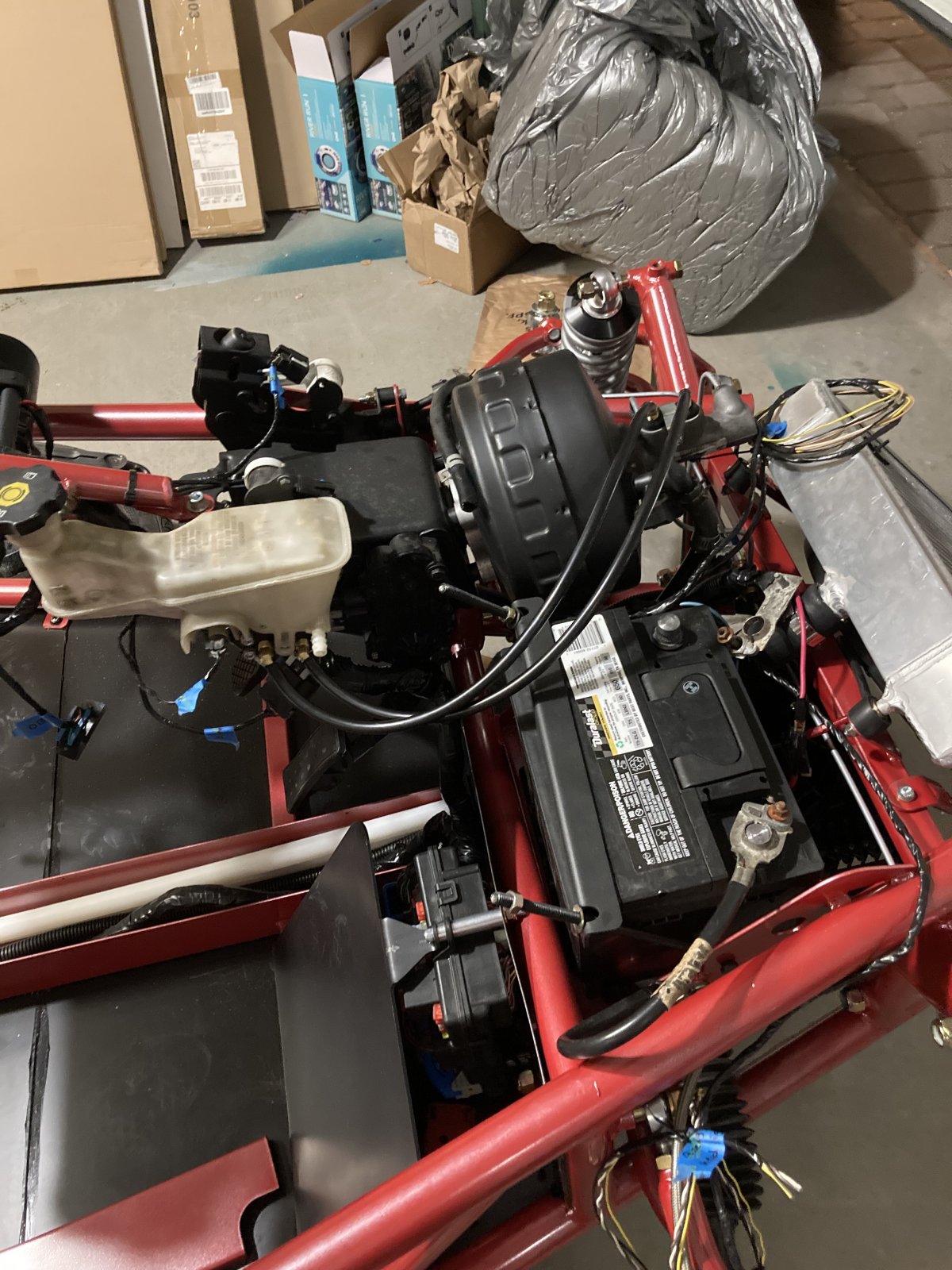

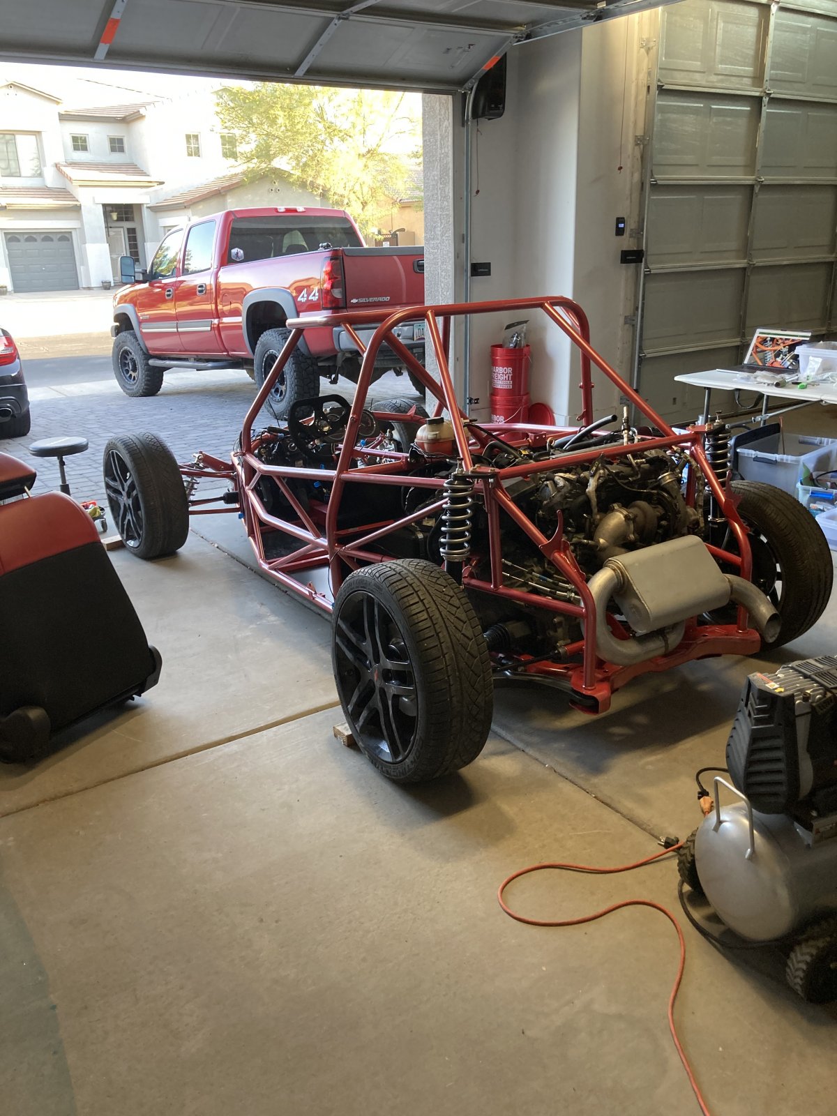

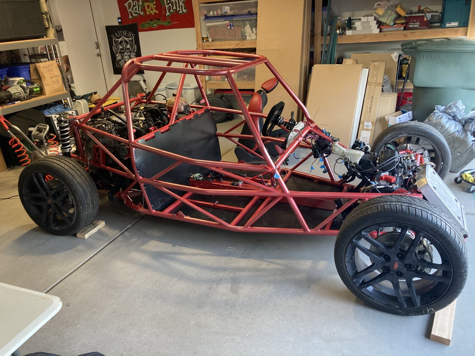

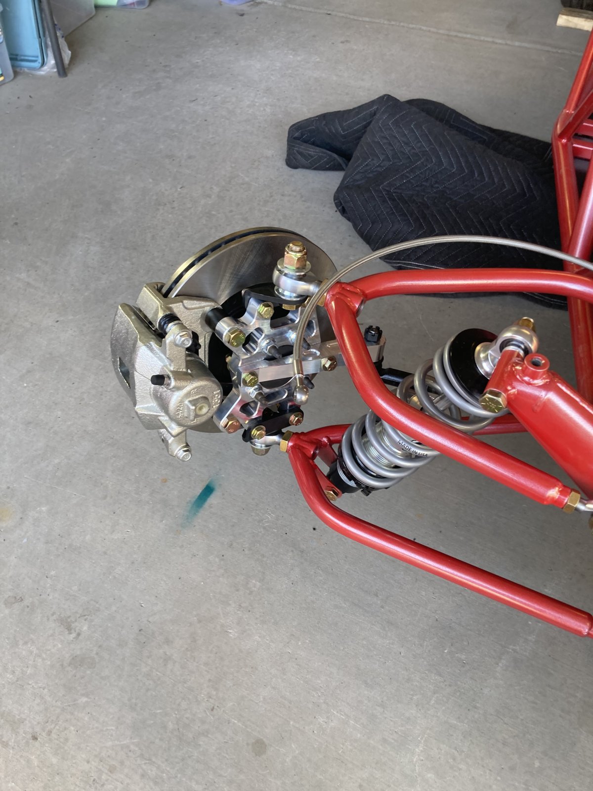

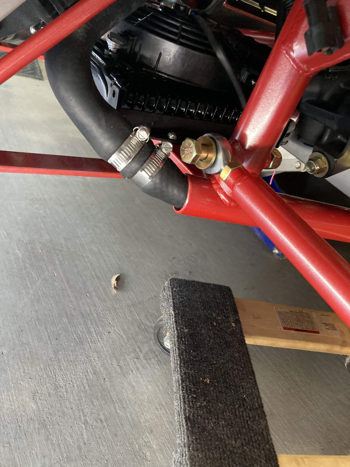

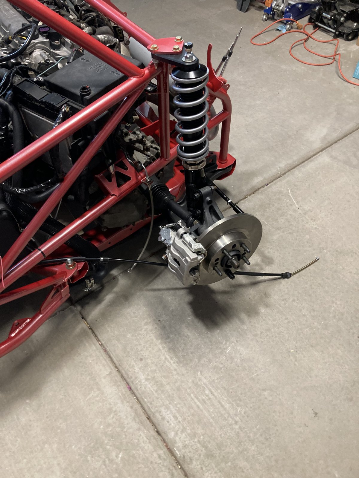

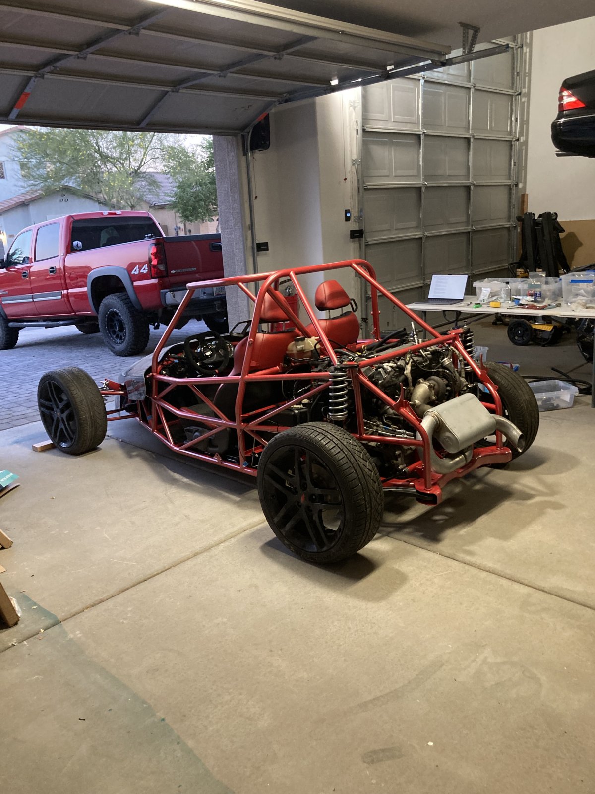

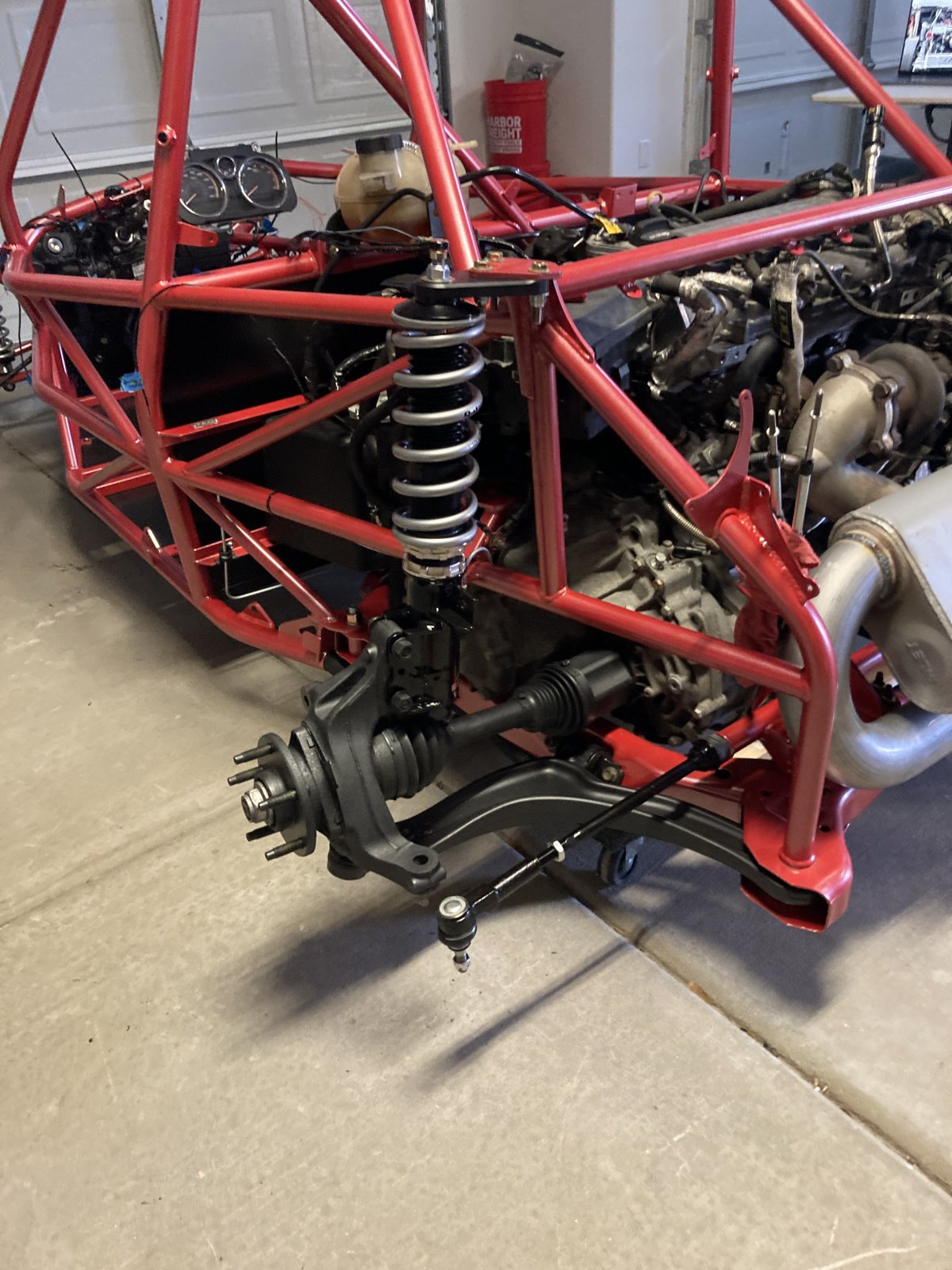

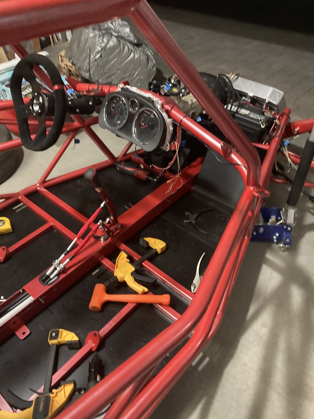

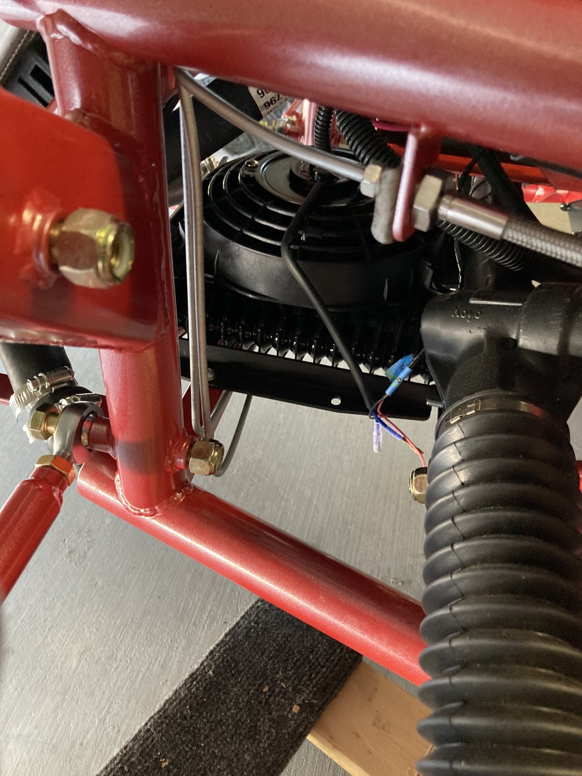

Update on the progress in the last week. I was able to install the axels, shocks(thanks to the advice from the forum), spindles, hubs, brakes, toe link bar, heat exchanger, aluminum shifter, shifter cables, parking brake, DF quick release steering wheel, brake reservoir relocation, tunnel cover, wheels and tires. Things went fairly smoothly, but I do have a few questions for the forum.

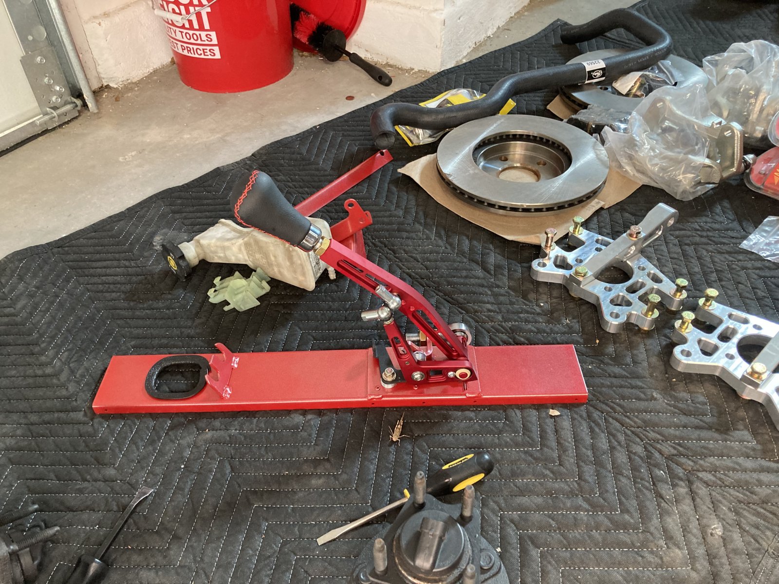

When using the aluminum shifter, do the shifter cables cross or does the the driver side cable on the shifter also attach to the driver's side transmission linkage on an F35 transmission?
For the DF quick release steering wheel, what nut is used to hold the steering shaft adapter? The one I am currently using does not allow the steering shaft adapter and quick release adapter to sit flush with one another.
Lastly, do the stock seat have to be modified to be be installed? It looks like the distance between the mounting holes and the hooks on the seat frame are farther apart on the seat than on the floor panels. Also, it looks like the plastic trim on the stock seats hit the parking brake when in the correct position.
Thanks again for the help and input.

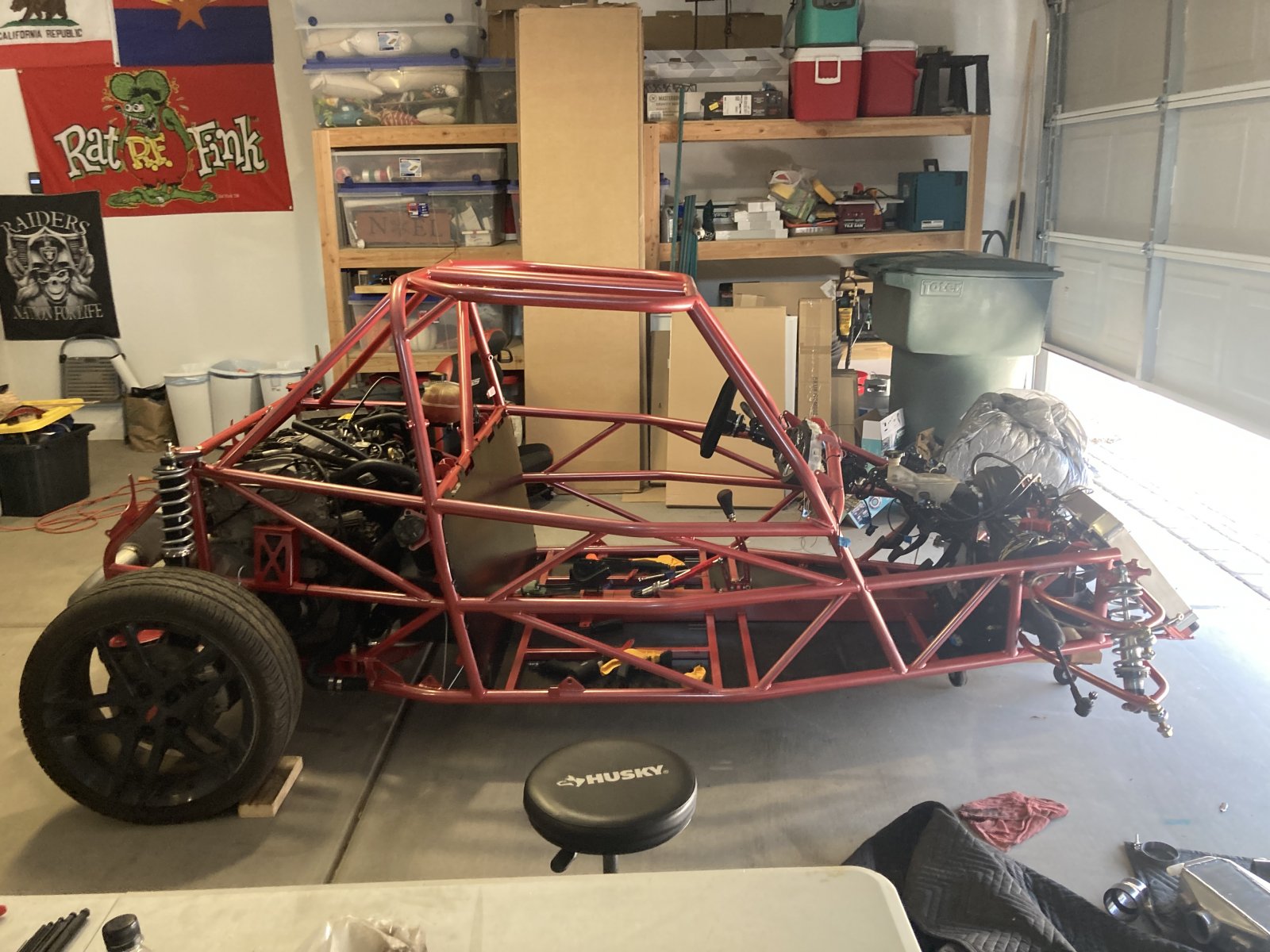

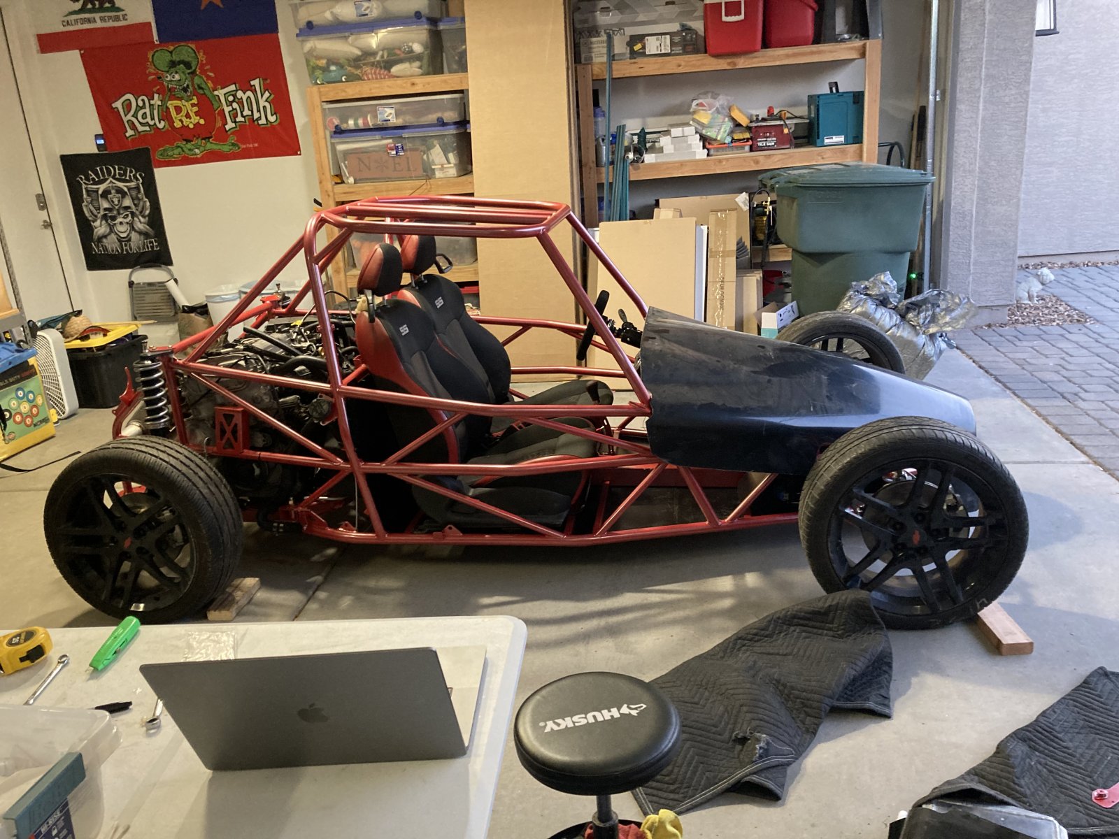

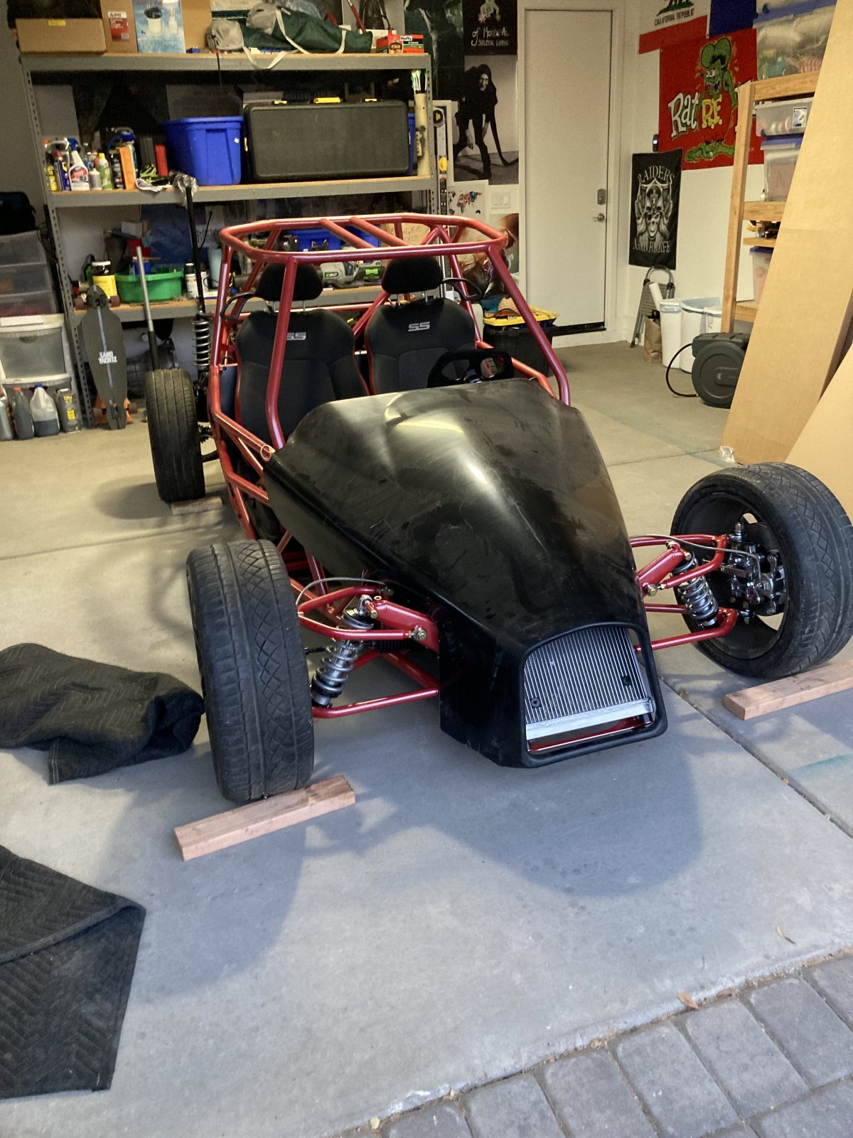

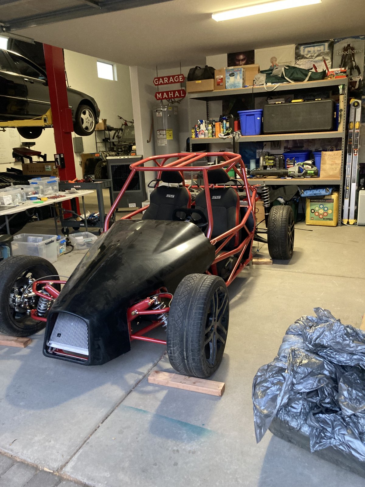

A few more photos with the seats and hood in place but not installed.

You can trim the plastic sides of the seats or just remove the plastic sides.
The front and back mounting points of the seats also need some trimming.
The cable on the driver's side of the billet shifter is the cable that moves when you do a first to second gear shift.
On the F35 transmission, that is passenger side cable.
