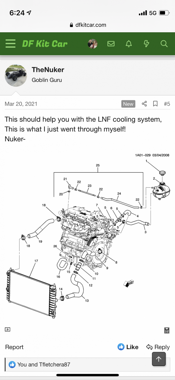

I attached a photo of all the coolant hoses. My question is if I threw out all the hoses on the donor because I am an idiot, which ones do I need to buy? Obviously I didn’t throw out the ones supplied by DF goblin.

Not sure how many you pitched but for the cooling system I only needed the hose from the thermostat housing. The one on the pass side was supplied by DF.

I threw out all of them so I am assuming I will need numbers 3 through 7 and 8 through 16. I cant seem to find a website that has them in stock though.
