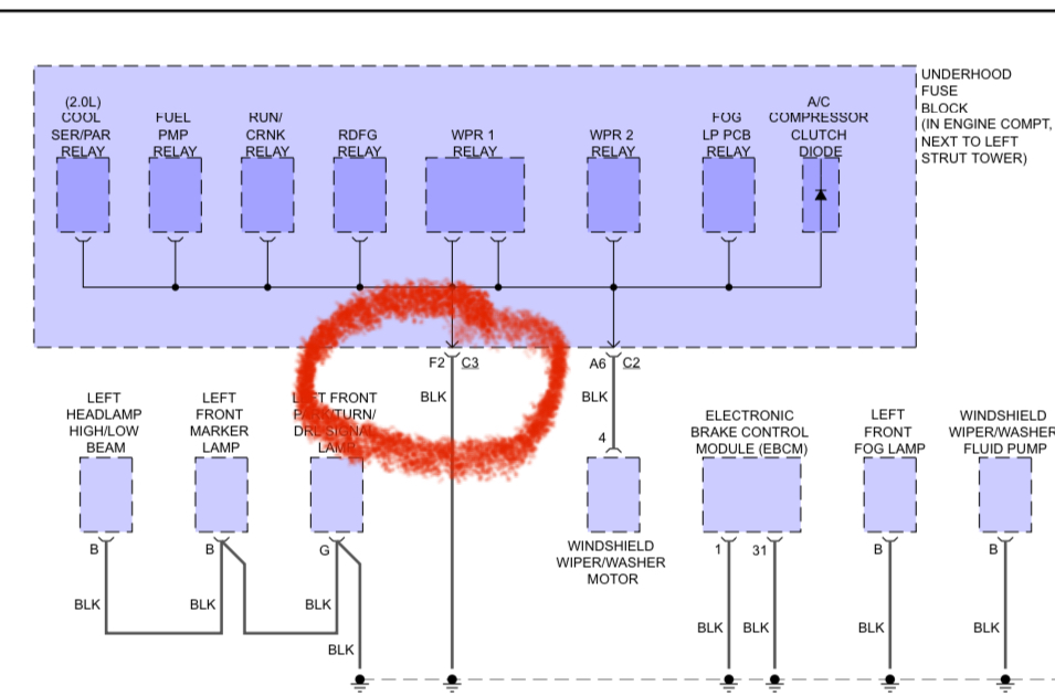

I still think there's a grounding issue in the fuse box. I used my multimeter to trace the ground path for the PCM. It looks like its terminal ground is the lug next to the transmission on the left side of the car. I don't get any continuity between the lug and black wire on the engine-to-harness connector. I stripped the cover off the wire and used a jumper straight to a ground lug, still no change.
I also can't locate the common ground for all these relays. I see the CRANK/START and FUEL PUMP relays which could explain my problem.

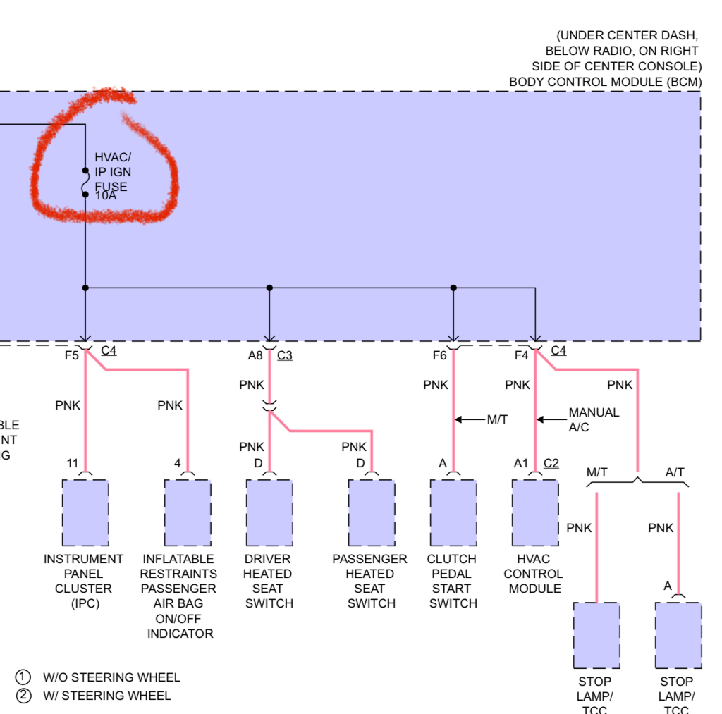

Great news. I solved the starting issue. To recap, I found that all of the solid pink wires that provide voltage to the sensors in the pedals were dead. Thanks to the always sage advice from @Gtstorey i dove into the wiring diagram. Turns out all of those circuits run through a single 10A fuse in the BCM. After banging my head against a wall for 2 months and nearly buying another donor just to harvest a fresh wiring harness, a blown fuse turned out to be the culprit. D'oh!

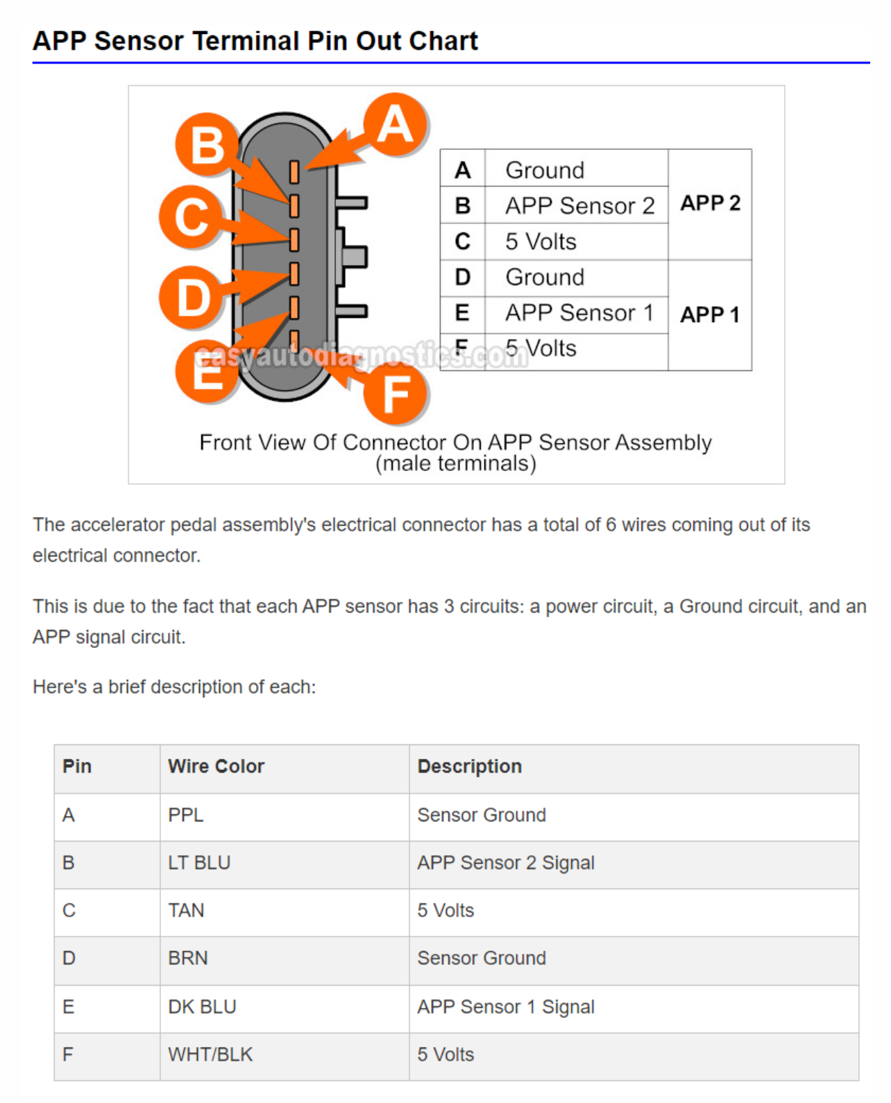

On to the next problem. I'm still getting a reduced engine power warning on the screen. Also still getting a p2128 code (Throttle/Pedal Position Sensor/Switch ‘E’ Circuit High). I used the info from @Robinjo to test the prongs on the accelerator pedal connector. Light blue is giving me 3.6V but I'm pretty sure it's supposed to be 0V. If I'm right, this would be the p2128 culprit. Also, the purple wire doesn't seem to be grounded.
