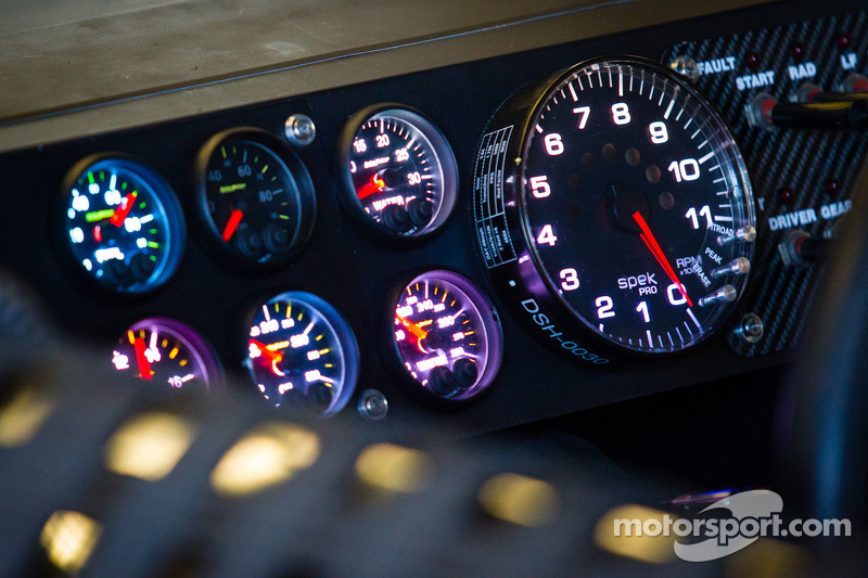

I know it is easier to use the stock dash for gauges etc. but I was wondering how difficult would it be to use stand alone gauges like Auto meter?
I would rather set up a dash like you would see in one of the older cars from NASCAR, with a speedometer of course.

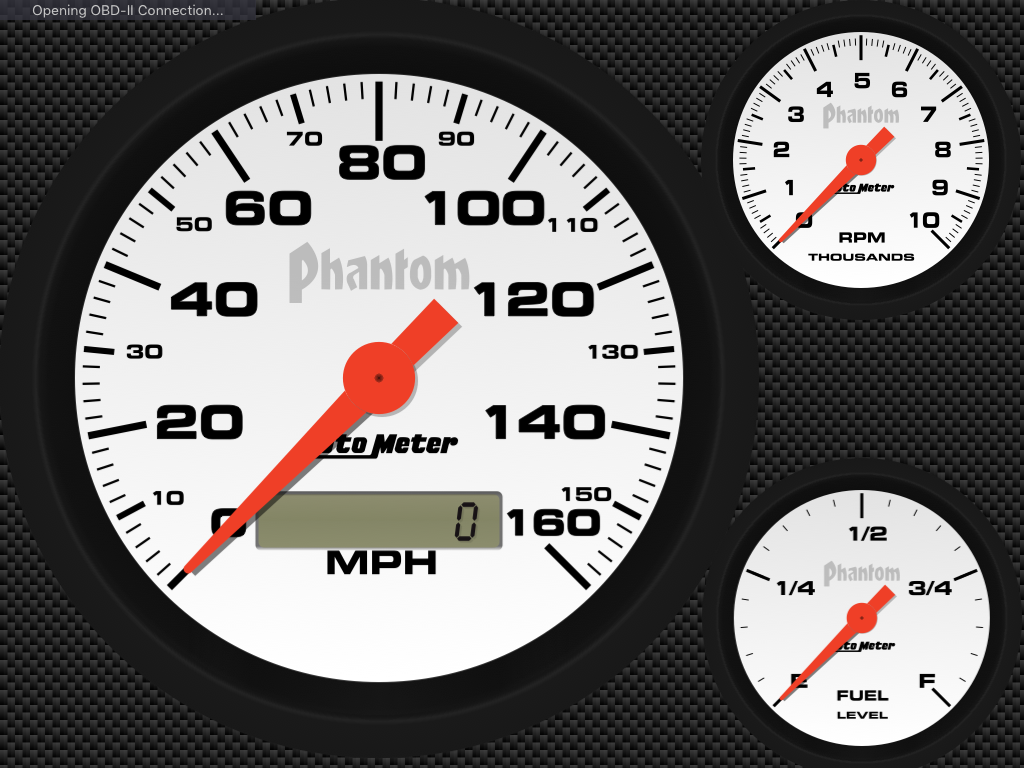

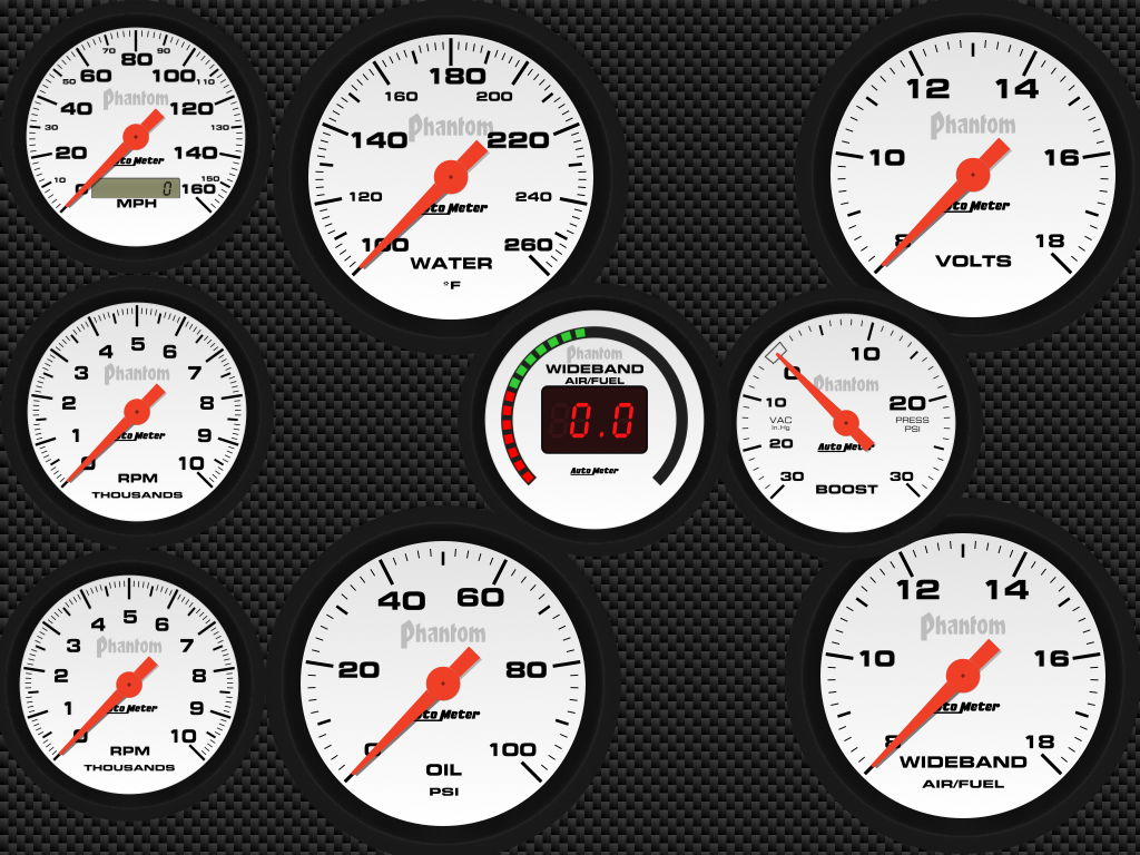

I actually just ordered an AutoMeter Dashlink which works really well. It connects to the OBD2 connector and displays a number of guages that are completely customizable. Pair it with any number of tablets (I purchased an iPad mini) and you have a lot of screen real estate that you can put stuff on. It also allows for telemetry data (like Brian was mentioning above) if you were planning to do autocross events like I intend on doing. It is a pretty cheap alternative around 150 dollars as well as however much you want to spend on a tablet. I have probably another 120 in the tablet plus a waterproof case. Here are some examples of what you can do on the iPad. I like that you can have 2 separate screens so readings you use more often (speedometer, tac, fuel, etc.) can be larger and other guages can be put on a second frame so that they aren't there constantly taking up space but are still easily accessible.
