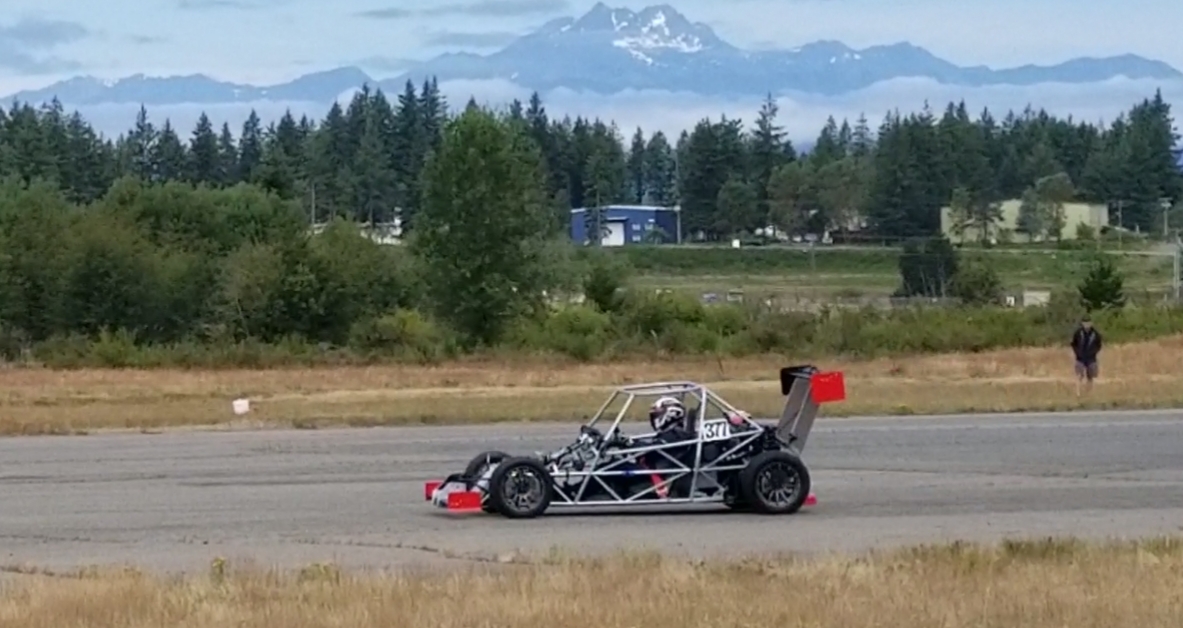

I was told to add the Talon front splitter to keep the down force on the nose, which I can see being functional. Don't really want a roof mounted spoiler though, even though I understand what you're talking about.
You know I'm not installing an intercooler like the DF provided one, correct? I'm installing one like @ctuinstra had on his 1st Orange/Black one, like this:
Oh, I didn't realize that you are using a long intercooler. Well Chad's (ctuinstra) mounting looks like it would give good visibility, as you could see under it, and it is mounted high enough to catch some air. My mounting place gets air because I don't use a windshield.
Waterdriver
Front and rear
I really like the look of the 9LR Big Wang Rear Spoiler, as well as their Front Spoiler! I know these cars really do not benefit from these things, but I just like the look of them. They are both quite expensive, which is one of the reason I'm debating buying them?
I'm planning on mounting my IC on the angled rear bars and am wondering if it'll look strange with the IC mounted there with a spoiler?
I have Talons' Front Splitter currently and honestly, I'm unsure what rear spoiler, if any, I want to install, with my IC mount plans?
Throw yalls opinions at me please!
With the IC mounted high in the back, it ruin any airflow to a rear wing if your wanting to add any rear end cornering grip at speed.
Personally, I'm in the function over looks camp. I do like the look of wing and it works. If it didn't help, it'd be gone.
49684
Just be sure to mount it for minimum drag, as with all the rear weight in a Goblin, you sure don't need any more downforce in the rear.
The front, for sure.
All a rear wing needs is to just be along for the ride....
