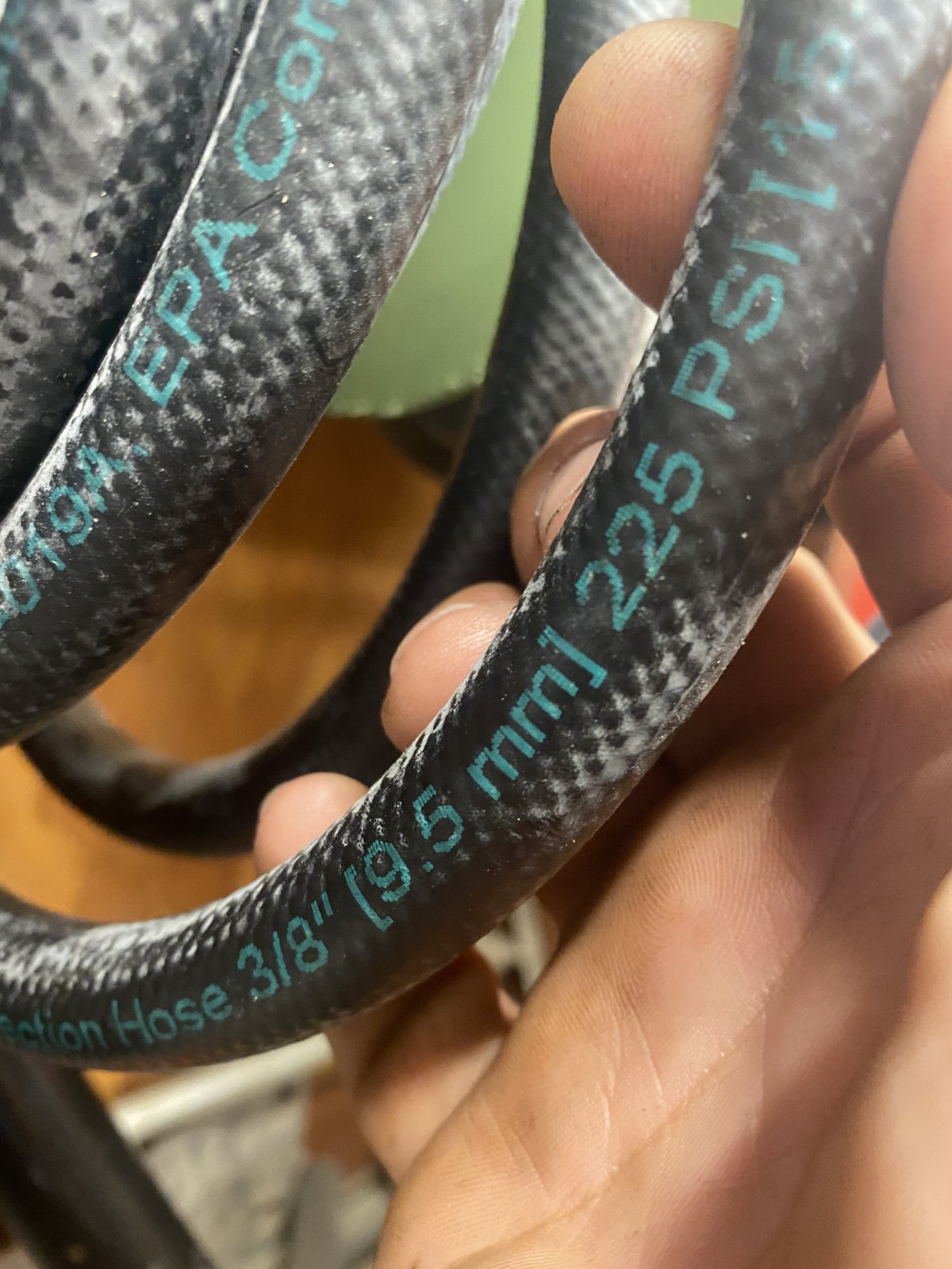

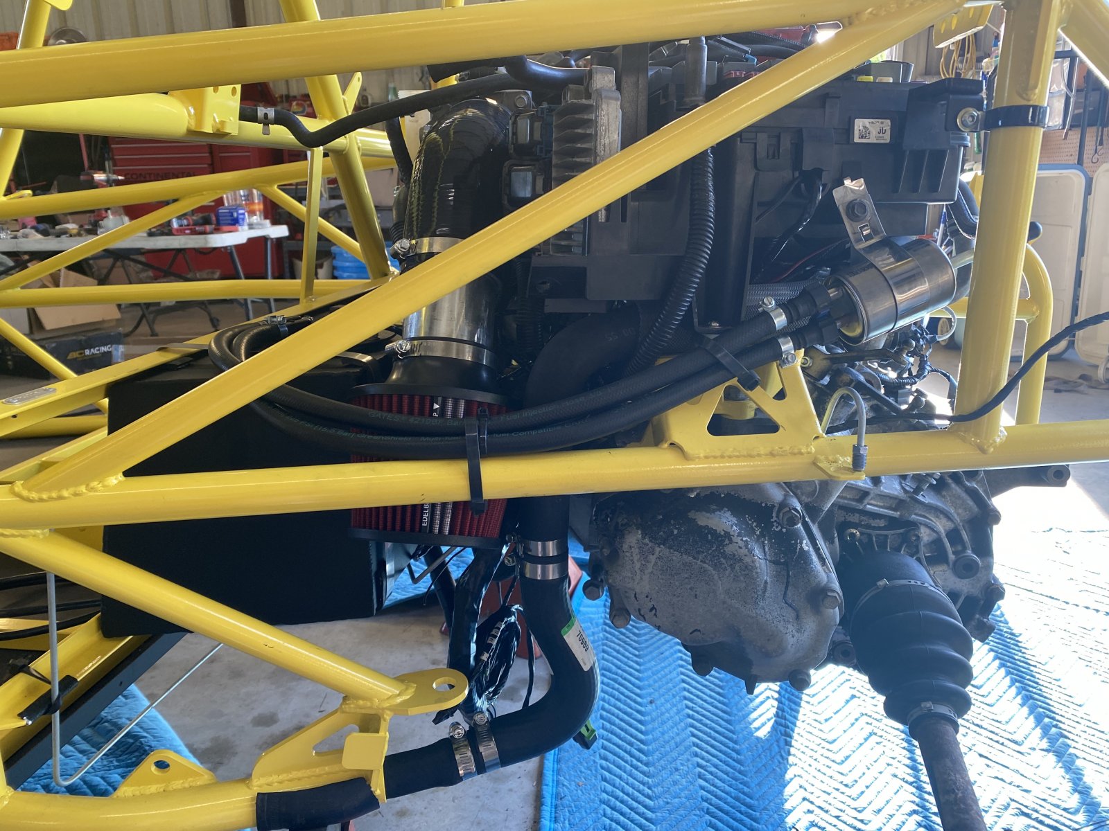

I used the stock engine line instead of Df supplied, but it should still be “the same”.
I got it sorted. I used that nylon tubing for the brake booster connection. I ended up buying some fuel hose at the parts store and clamped it in place. It's not leaking and getting fuel, so I'm calling this done.

I also used rubber fuel line to go from the pump to filter.

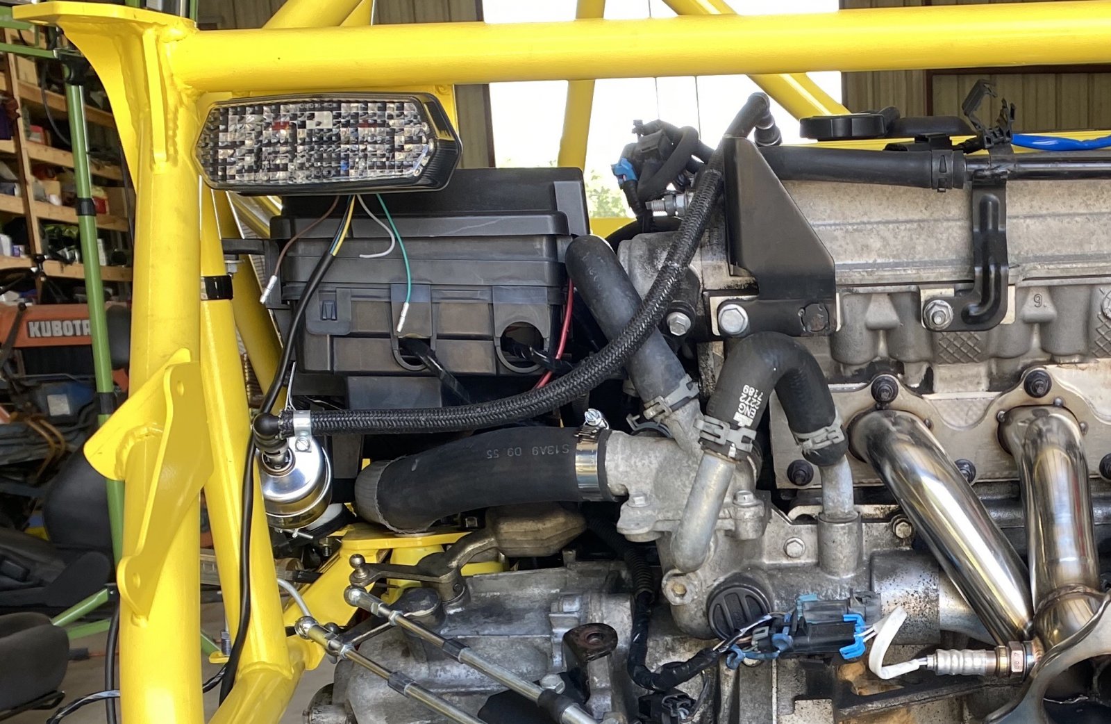

According to the info on this fuel filter, everything is 3/8" except for the return line connection at the filter, which is 5/16". That jives with my recollection; when I went to an external regulator I ended up with one fitting I couldn't reuse, and I think it was that one because it was smaller.

I don’t know. I reused the fittings from the stock fuel lines. Warm up the hard plastic hose enough so you can pull the fittings off the end. You can use a razor to cut the line, just make sure to don’t damage the fitting.
DF did provide a couple of fittings. I used 1 on the exit side of the filter.
