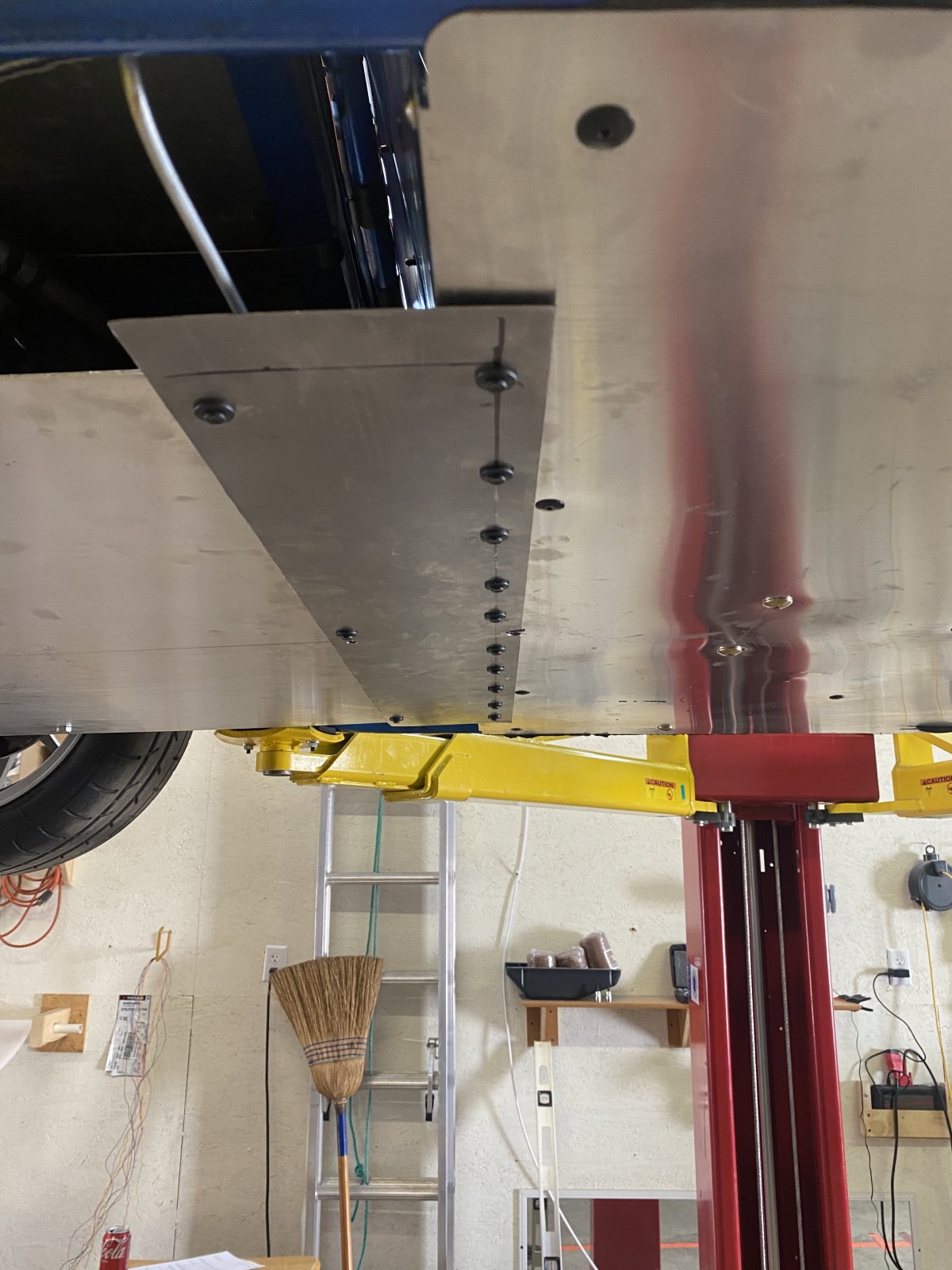

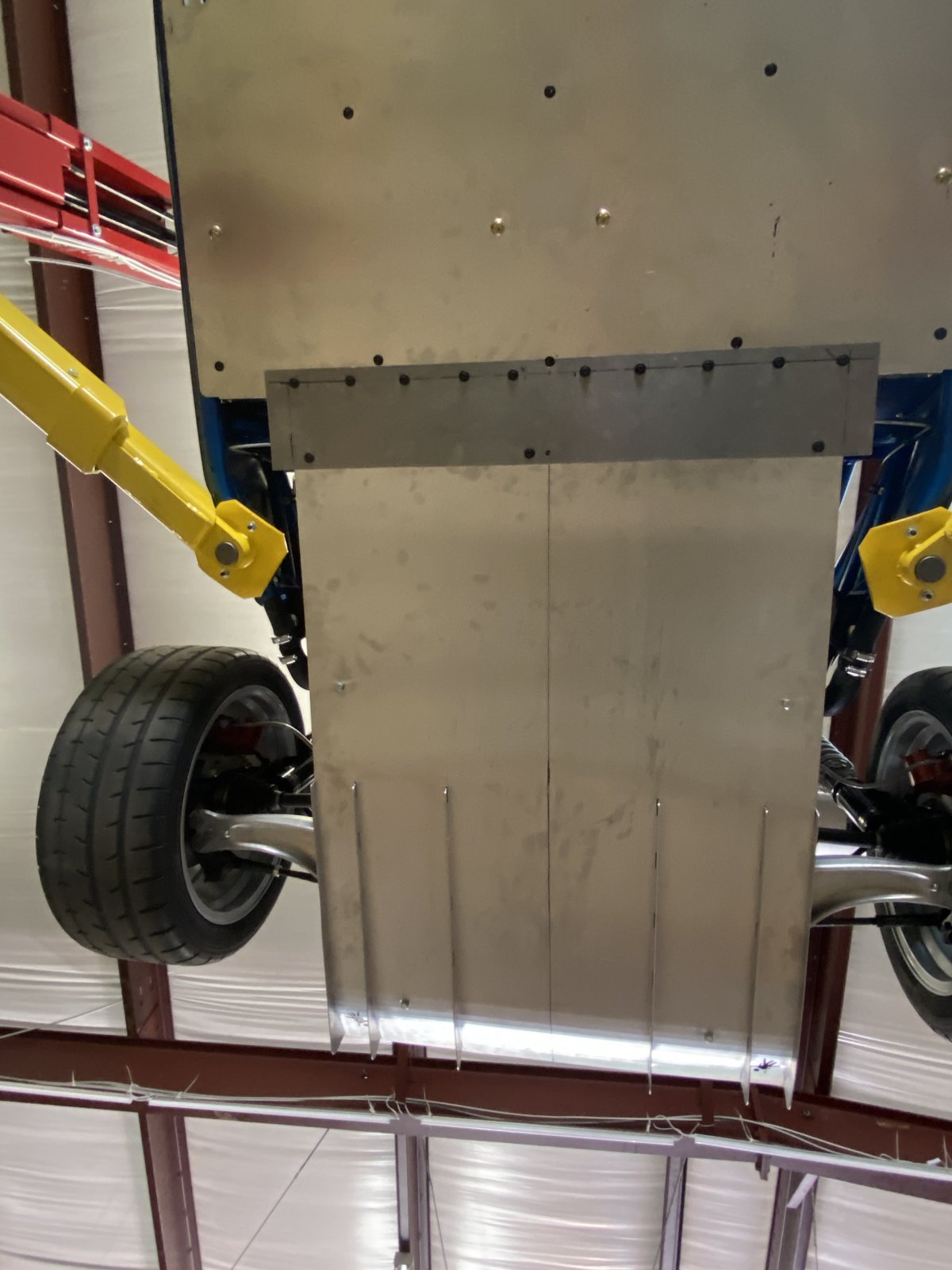

Got my Nine Lives Diffuser on today. Mounted it a little differently from others. Bought a thin steel plate from lowes and cut it 6 x 36. Used push pull pins to hold it in place and tucked the leading edge of the diffuser under it. The diffuser weighs 12.8 pounds plus the thin plate, push pull pins and other mounting hardware.
Hope it will decrease the air from the engine going into the cockpit.
