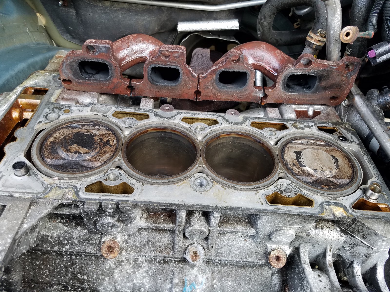

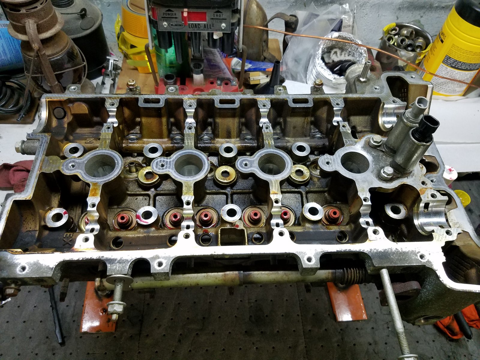

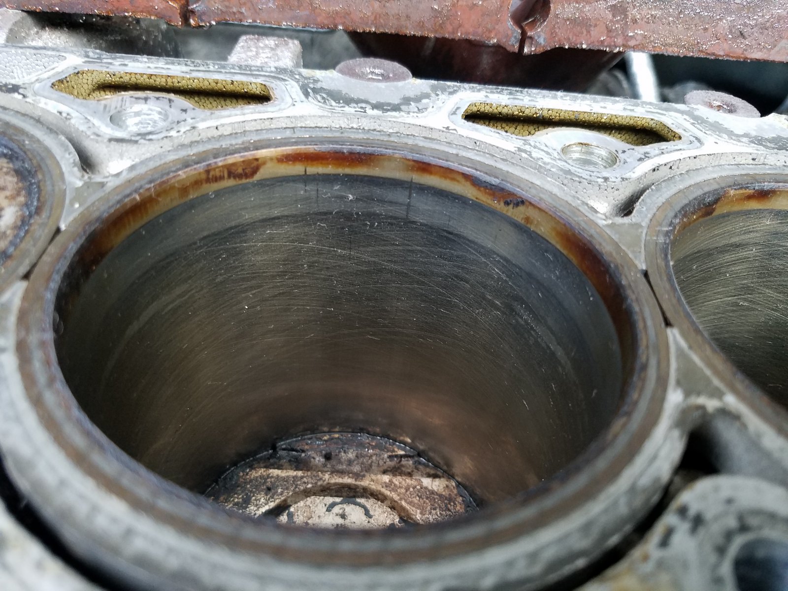

Call me crazy. Don"t worry you wont be the first one. I bought a 2009 LT XFE 5 speed with 187,000 miles on it for less than $500. My thoughts are not on mileage but how it was maintained. The car I have jumped a timing chain and some bent valves nothing that I am afraid of( been turning wrenches for 30 + years) The seller showed me his maintenance records. He drove about 100 miles a day round trip. 90 of that was highway miles ( very little clutch wear) Changed oil every 3000 miles about every 6 weeks with a synthetic oil. I pulled the head off and was very surprised the cross hatch was still visible in the cylinder walls (see pics). There was very little carbon ring at the top or the bore ( not what I expected). The valves have the amount of carbon that I would expect on a 50,000 mile car. I shopped around for parts and right now I have about $850 total in this car. By the time I sell some of the parts off I am hoping to break even. It is a given that here in PA you are going to put rotors and some other small parts on because of salt , salt brine and calcium chloride that we use o the roads in the winter. And I will have some Engine block clean up to do. I guess my point is auction cars your taking a gamble even with low mileage. Buying off a individual you should get some history of the car. . I think you could buy a 70k mile car with a power train way worse than mine. Yes it will get a stainless header, The exhaust manifold has a hairline crack in it.
