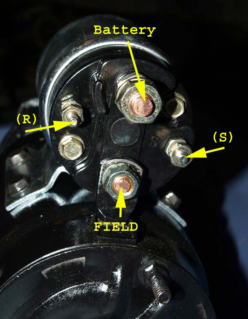

I have these two ground wires that are near the starter
Should I secure them both to the ground stud of the starter
Or away from near the power connection of the starter and secure them under the bolt that mounts the Starter?
If you aren't careful, you are fixing to set your car on fire. The stud on the starter is not a "ground stud" That is the field wire. and is hot when the starter relay is closed.
It's hard to tell from your picture, but the connector marked F is possibly the + wire from the alternator or the + wire to the fuse box. It maybe a ground, but that looks like a red band on it. The small black wire may be a ground, but there isn't anything that would normally be grounded at that location from the wiring directions.
Jareth
I’m glad I asked I thought the raw twisted thick wire was welded to the case of the starter, which made me think it was a ground.
it is scary to think of the electronics I would have blown ?
I think the plate that wire is touching is probably actually a piece of rubber painted the same color. If that is metal, it may take a little more thought about what is going on. Below is an older style GM starter but it works the same. The "S" and "R" are built into the small plug that connects to the relay.
