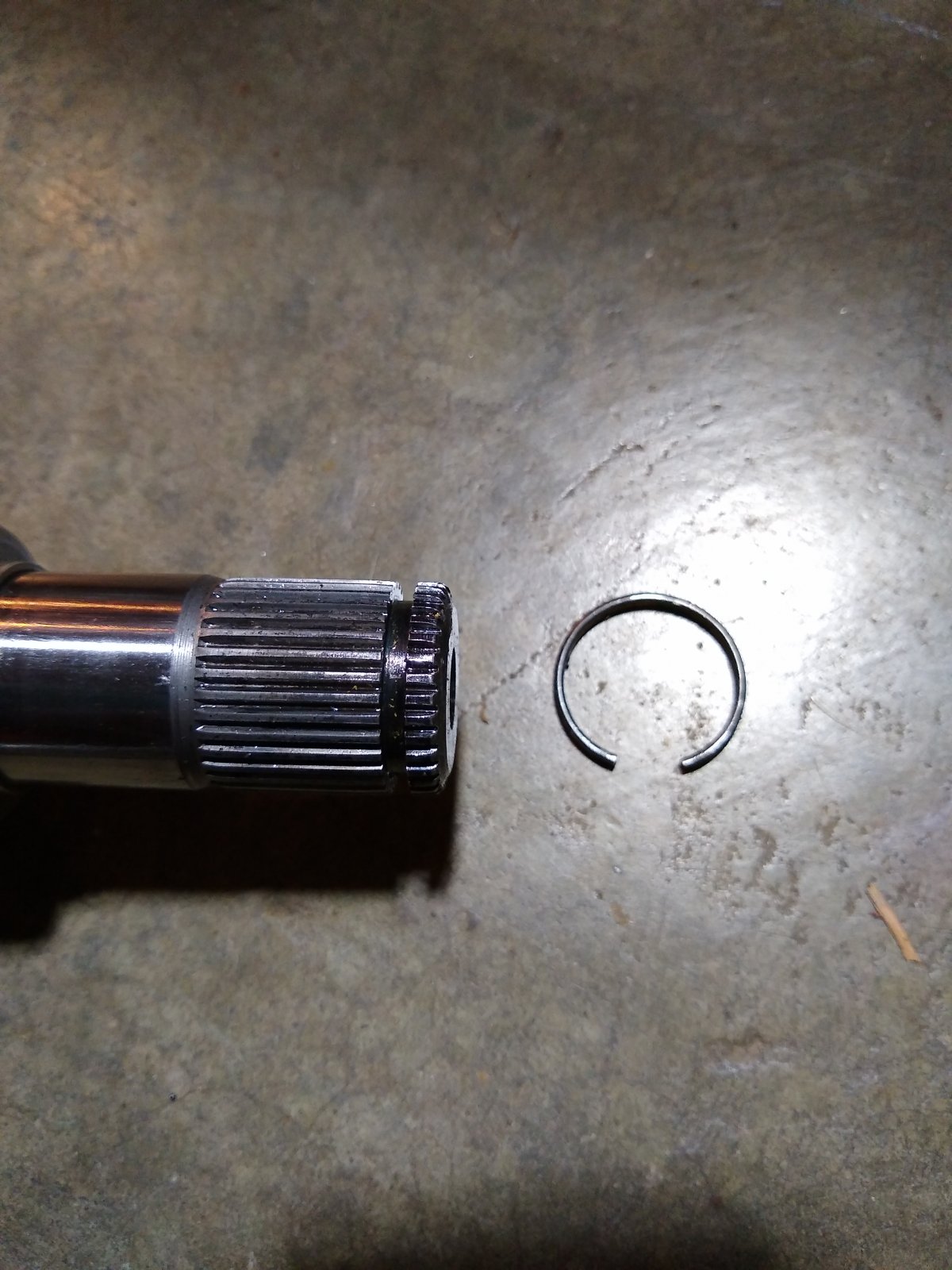

I could not get the right drive axle to go all the way in so I pulled it, and the small clip has enough slop in it to block it from going in. If I install the axle without the clip it goes in like it should. The clip looks broken to me. Do I need the clip? Do I need to have a new one installed?
I have no problem taking it off and on. It seems like it's stretched oversize and it is floppy when installed so that it blocks the splines. When it is not installed the axle goes in all the way.
I had trouble getting mine to pop in, too. Like Russell said, just lube 'er up and pop 'er in hard. If your rear end is up on jack stands though, I strongly recommend having someone with you to brace the Goblin from the other side so you don't knock your stands over.
Yes they block the splines, that it's job. That keeps the axle from coming out on you. Which could be a very bad thing while you are driving.
As the other said, grease it up and slam it in. To NOT try to use a hammer on it. Just one swift hard shove and it should go right in.
L
I heard to make it easier... make sure the gap in the clip is down when shoving it in. so the top of the clip rests on the axle and the gap is off the axle if that makes sense.

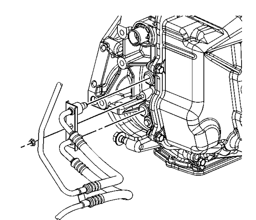

Apparently, I don't have the axles all the way in, and I can't get them to budge. The problem is the engine is cranking but doesn't start (a different thread I am working through). When I cranked the engine I got a huge transmission fluid spill and did not see if it was from the axles or a bad seal. I will be taking the car to a transmission shop since I know less than nothing about automatic transmissions and the donor was in a junkyard for about 10 years and I want the transmission to be right. My Catch 22 is do I need the engine running to get the transmission fixed or do I need to fix the transmission before I start the engine?
Did the spill come from the transmission lines that go to the transmission cooler? I'm not sure about the Cobalt automatics, but there should be two lines from the transmission that go to a cooler. By chance is one or both of them open?
You don't want to start the engine and pump the transmission dry.
I have not seen any connections either on the transmission or the radiator, so I am thinking the car does not need them. However if the transmission has those connections I would at least need to put a loop there. Where on the transmission would they be?
Found them, and that is the area of the leak. I would guess there is no problem with installing a loop there, since no provision was made by DFG and since the car is so light. Thanks.
Did you keep the lines from the donor? The mating lines have a dedicated fitting/clamp that connects to the transmission - unless you are good at fabricating something up? You may need to go to the local boneyard to find one of these.
Those lines get looped; it was covered in either the assembly instructions thread here or in the older build guide videos. Alternatively, you can run them through an aftermarket cooler depending on your vehicle use case.
