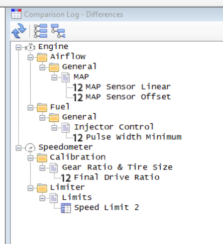

Your tune file has a few changes from the stock 2008 LNF.
Did they change the MAP sensor & injectors? There is also a 3.33X multiplier on the speedometer, and higher speed limiters.

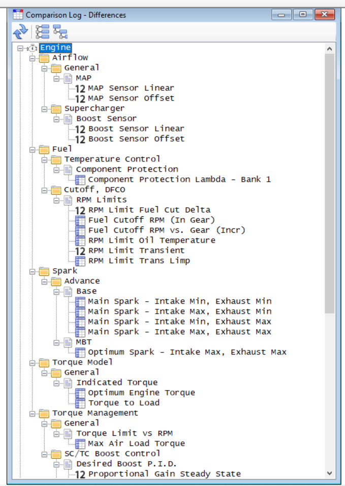

Looking on the HP Tuners repository, the stock tune files look the same as the Cobalt LNF as they do for the Regal LHU.
The e39 can handle flex fuel. This article says the two tunes should be way different, but that was back in 2011, so it might be wrong.
