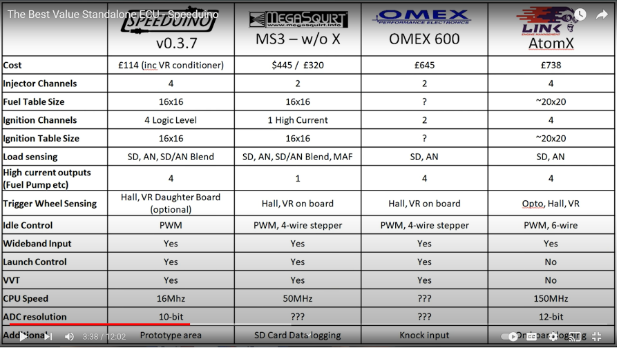

The more I learn about this, the more questions I have. How many injector channels do I need? I was thinking you need one for each cylinder, but the MegaSquirt only has 2, and can run a V8 engine.
I plan on running a turbo, but really would like a Flex Fuel sensor, and be able to run various mixtures of ethanol/gas.
I worry that an arduino doesn't have enought CPU and RAM to be full featured ECU, but it might work better as a break-out box that reads a flex fuel ethanol sensor, and modifies the injector PWM signal.

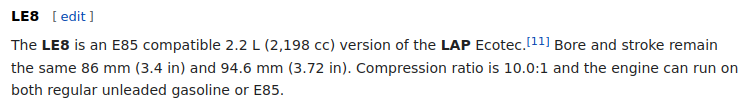

Is there any chance some of these might be a "drop in replacement" minus the E85 sensor (if they have even one, as you stated @Gtstorey)
LAP -> LE8
34091
LNF/LDK->LHU
34092
LE5 -> LE9
34093
It can't be that easy, but it would be a really cool way to be able to get flex fuel capability without an aftermarket ECU.
You would have to check the pinouts for the ecm to see if they can be made to work. And can they communicate with the Cobalt BCM. There are a lot of post on the HP Tuners forums about mixing various modules in the LS engine world and how difficult it can be to get everything to work together. And that is with platforms that a lot of tuners have tried. Using an ECM from those you listed could probably be made to work but very doubtful that it would be drop in. The easiest path would probably be to start with one of those cars as a donor and modify the Harnesses and use the BCM and ECM like is done from the Cobalt. It might be possible to use just the ECM and wiring harness, but you would have to figure out the theft deterrent portion if it comes from the BCM. And check the sensors such as crank and cam position read the same. Etc, Etc, Etc.
