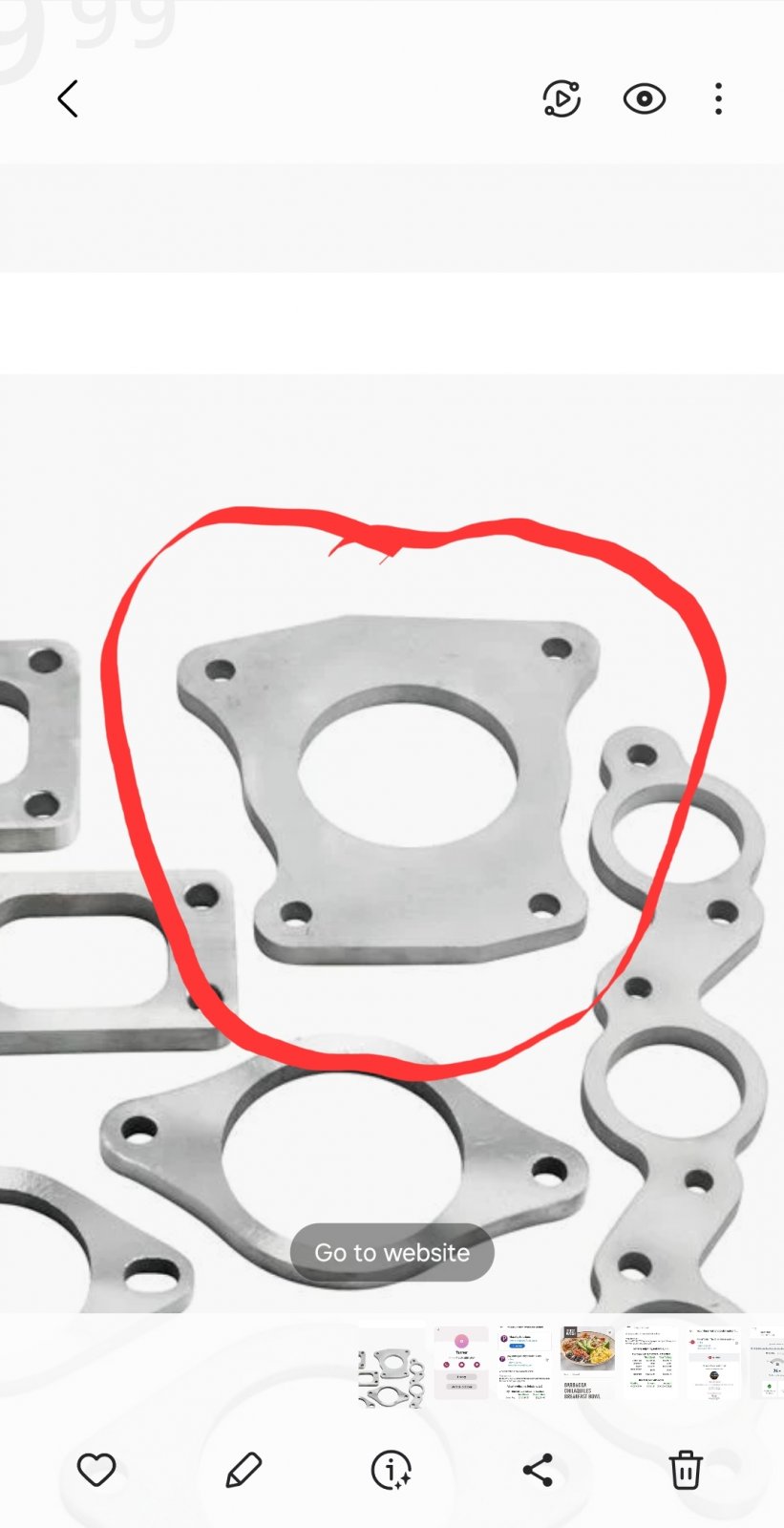

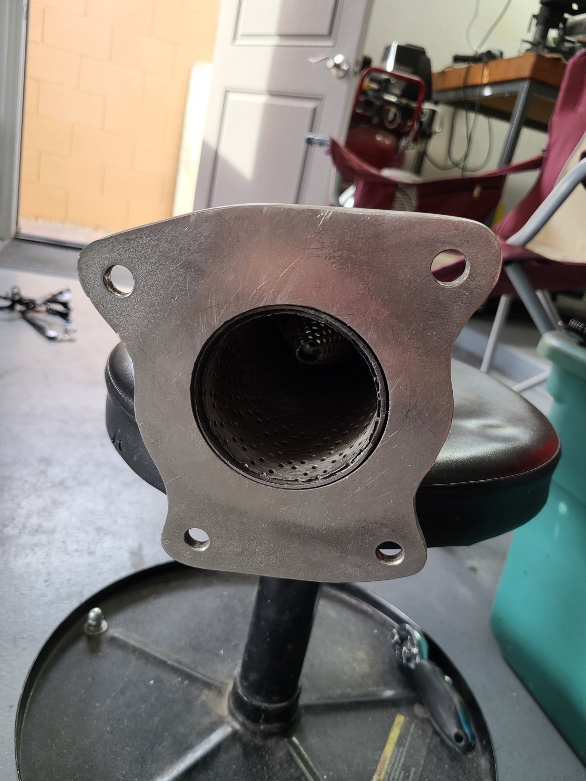

Hey guys, can anyone give me a description to search for this flange? I found the pic on zzp but no description?

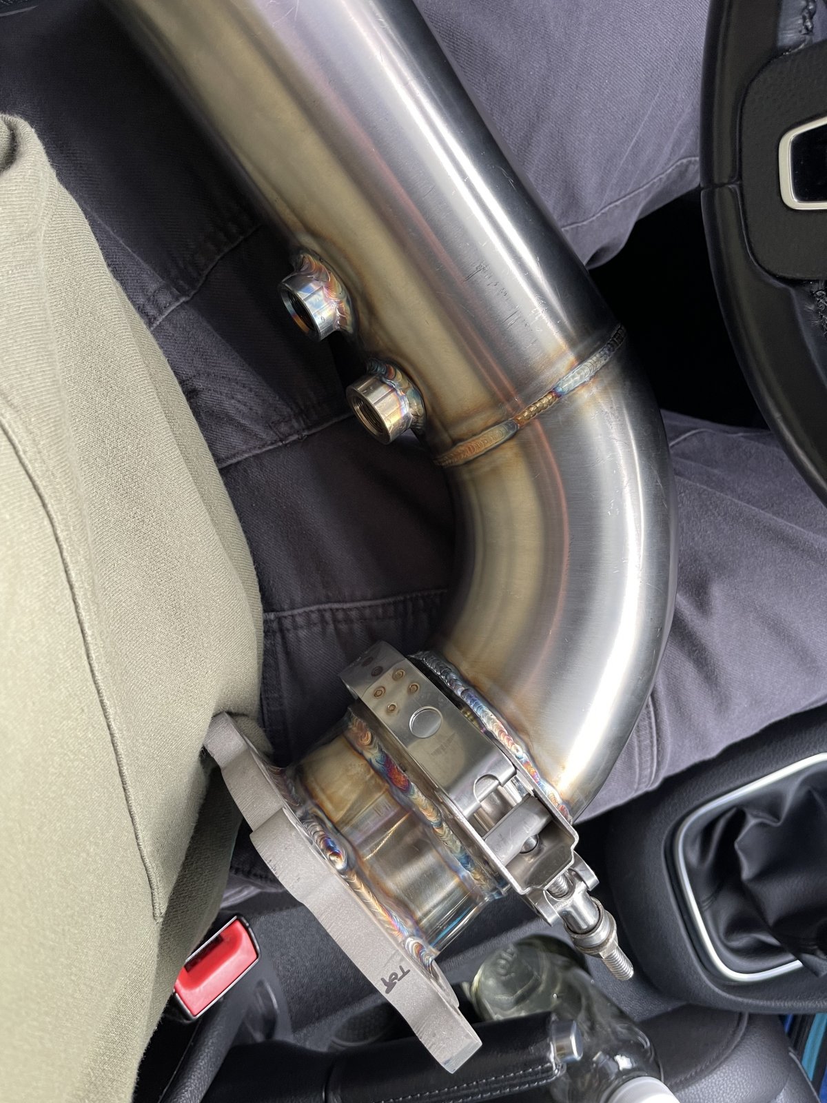

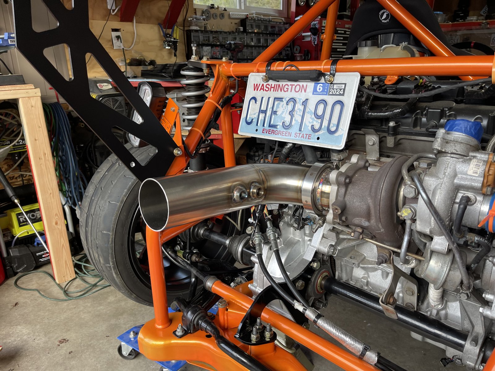

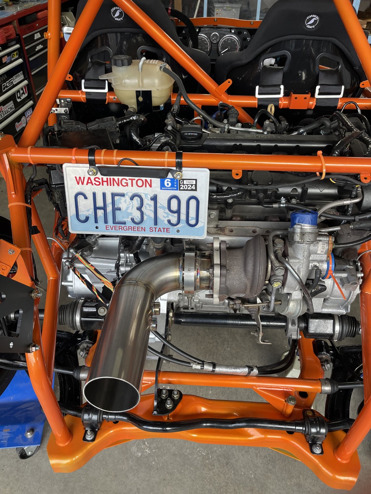

I made my own flange from 1/4 inch stainless plate - 6X8 bought off ebay for about $12. But I also have the 3 inch hole saw and drill press to make accurate holes - and patience to fabricate from stainless steel, it's tough stuff. :oops:
Edit, this is the finished flange installed on my exhaust.
C

I'd like to see your setup. I'll need to do something similar soon.

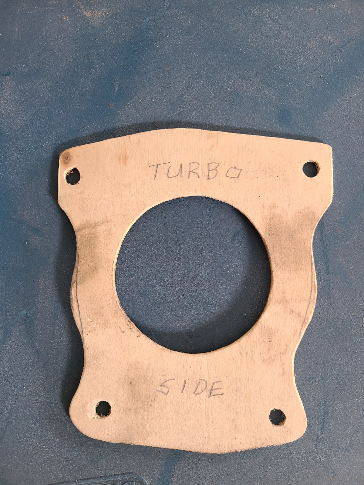

They offer a precut gasket for it, I just cut my own and used copper spray gasket on both sides of it as well
I have it mounted already just don’t have a picture of it, the pictures in post are of it just on there loose. Mounted now I have it slightly angled down to allow any moisture to drain out
This looks awesome! I plan on doing this in the next few weeks. Can I ask how the sound level is? Too loud? just right?
Maybe slip one of these in the end of the pipe to see if it takes the raw edge off the exhaust note? Could be clamped in temporarily to hear if it makes any difference?
