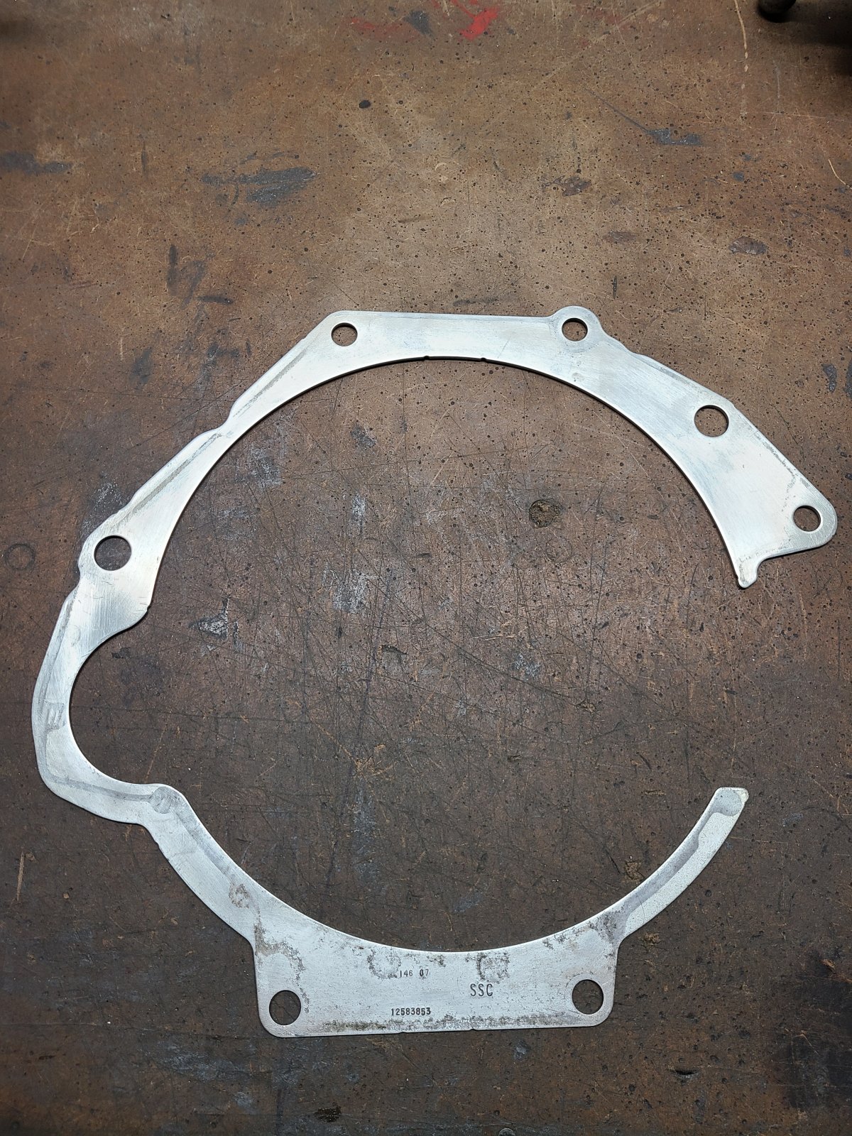

There's still an unanswered question for the F40 installation. The transmission to engine spacer ring:
Does it need to be installed with the F40 transmission?
I have searched for an answer everywhere for more than 2 years and nothing on the web provides a definitive answer. It's obviously used to set the TOB spacing clearance for the factory clutch components - very simple for car assembly line work. But I cannot determine if it (or similar) was used to assemble any of the factory installed F40s, like Saab or Buick Regal GS.
I know there have been at least 3 F40 installs completed - was the spacer used for your installation?
It is reportedly required on most F35 and probably F23 installs. Guess I will have to resort to checking the TOB clearance with the spacer and without at some point to make the determination.
comegetjoe
I measured my air gap without accounting for the spacer. If I am to use the spacer for measuring air gap, I need to redo some maths.
If I have to use the spacer, the dowel pins only show a smidge for alignment beyond the spacer.
What moves or changes if we dont use it?
That's the question, if the spacer is needed or not. If the air gap you measured is within specs without the spacer, then I have to believe you are set up correctly - for the Spec clutch.
I believe the F23 does not use the spacer, otherwise I would think those spacers would be everywhere!, and they're not. DS and everyone else interested, I'll be looking in my J/Y fun days! I'll check the automatics as well, I doubt they use it, but every source helps!
The spacer is 0.110 inch, so it will likely not cause any issues with the starter gear engagement. The starter gear is wider than the ring gear on the flywheel, so a minor shift on the engagement face should not be a problem.
Should be fairly simple to make on if you get desperate. Sheet of aluminum and a jigsaw.
You could probably do it in 2-3 pieces to make it a little cheaper.

From a cobalt ss group on fb, they say the spacer is for the regal trans... maybe the saab bellhousing is just a slightly different length?
In the junk today. I lost the Sunbird with the F23 w/ ??4cyl motor and it had the spacer? Will document more if I can find it! I have seen a few pre 05 F23 that I can see have a different clutch line connection.
