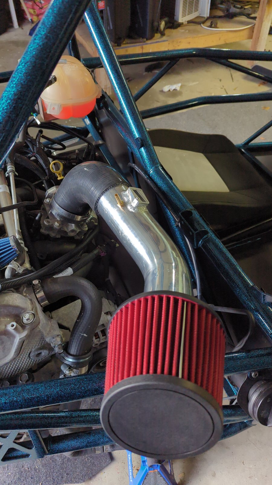

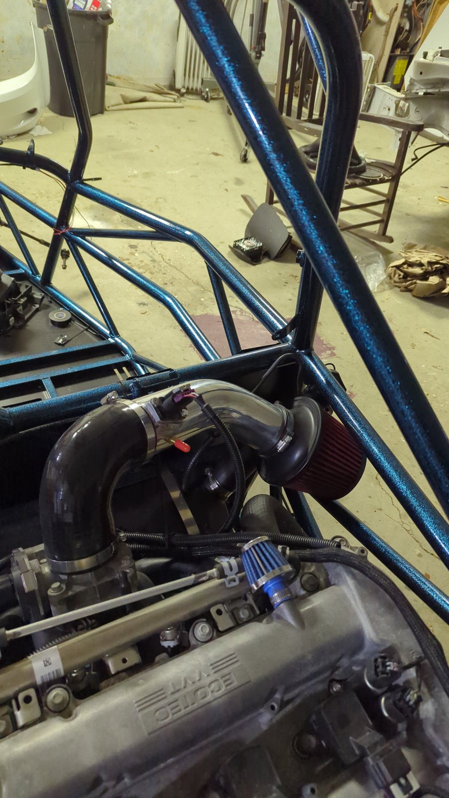

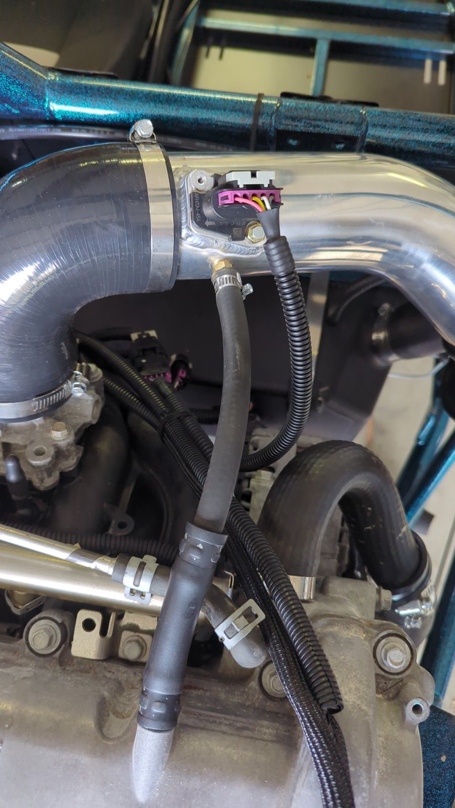

Got some of stage 2 in the mail today. Is there a proper way to orientate the intake? And where does the brass fitting next to the maf go to?
I put an open filter on it. I'm not sure if I have the hose necessary. After some fandangling I got it to this position here:Air filter out of the direct airstream, but still where it can get cooler air. The buffering in the airstream can mess with the MAF. The brass fitting is connected to the valve cover port - should be one open (or did you put an open filter on that port - I see one in the pic).

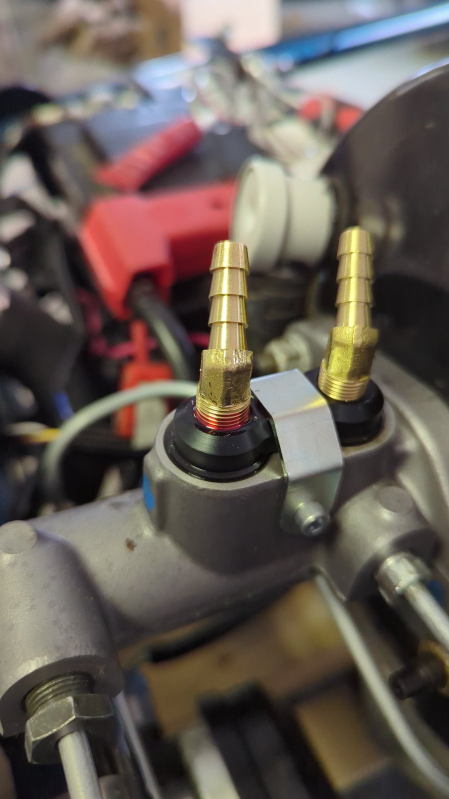

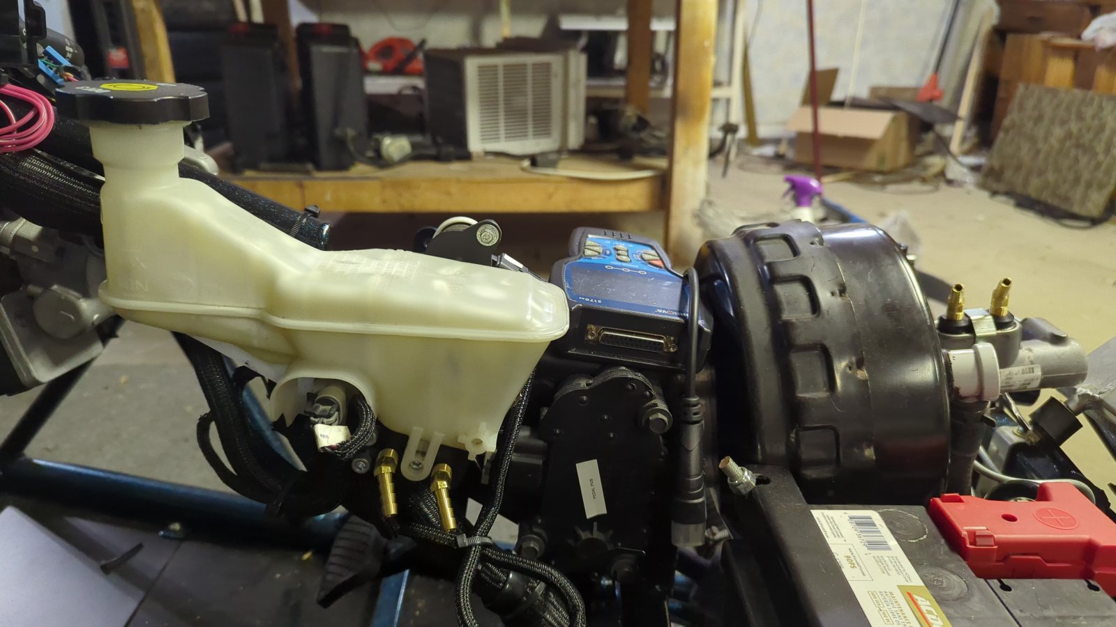

I didn't, I used a wrench to tighten the fittings down. But since you mentioned it I might go and fix thatDid you use red Loctite on the brake MC fittings?

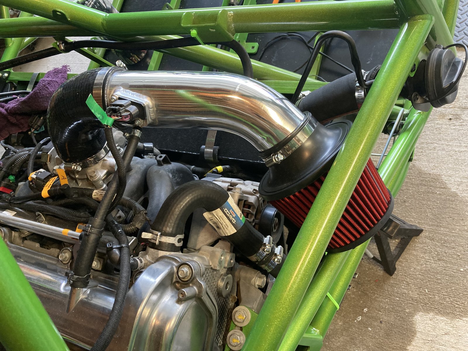

Thanks for the advice! The filter is on correctly and I made a adaption seen here:As for the air filter routing, here is how it worked best for me. Make sure that the filter is at the end of the aluminum pipe. if the filter is installed too far into the pipe, it also messes up the sensor.
For the PCV hose, I got some 3/8" hose and inserted into a small length of the original breather hose to make the adaptation.
For the brakes, I would make sure you install some sealant as the brake fluid will slowly weep past. I didn't and have tied a rag around the fittings as I didn't want to break anything apart as brake bleeding afterwards can be difficult. I also changed the MC fittings to 90 degree elbows to have the hoses lay a bit flatter so they won't hold any air bubbles. I also removed the reservoir during the filling and raised it up to the high point to reduce trapped air.

As for the brake reservoir I'm now using red Loctite, keeping the original fittings but will be raising the tank high up when it comes for brake bleeding

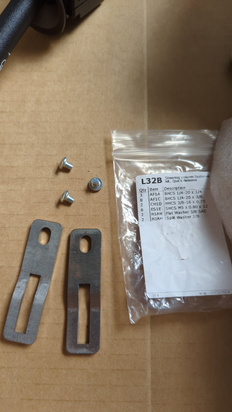

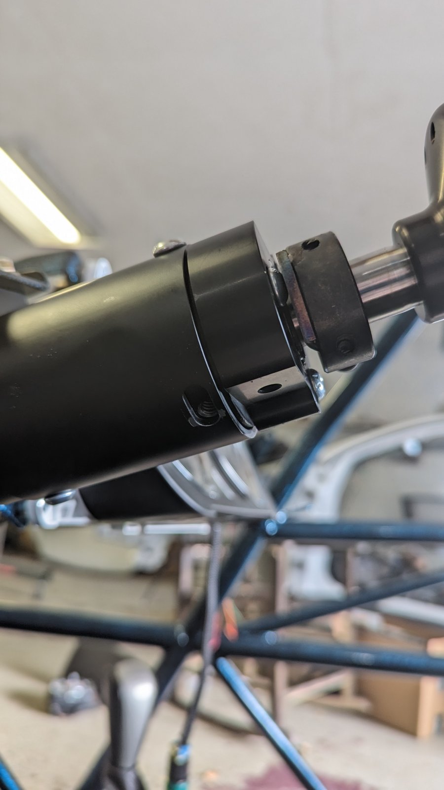

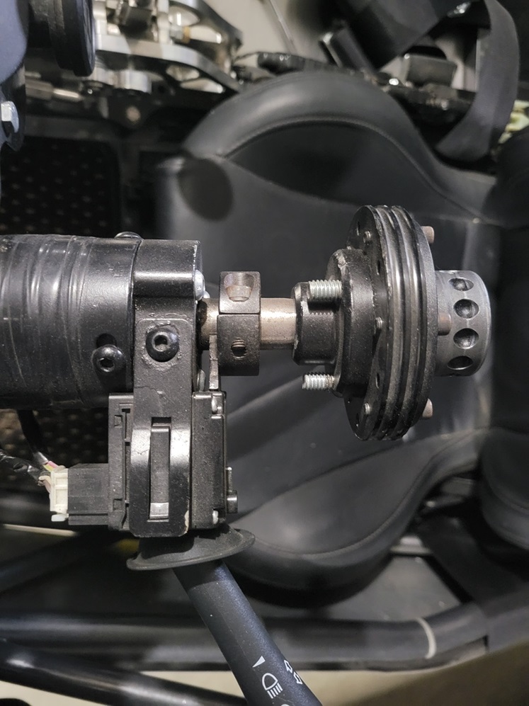

The screws shown are actually too small of a thread size, so I'm confused.That hardware holds your turn signal switch.
Also, you're going to need to put some space between the turn signal deactivator piece (for lack of a better term) and the three bolts under it.
