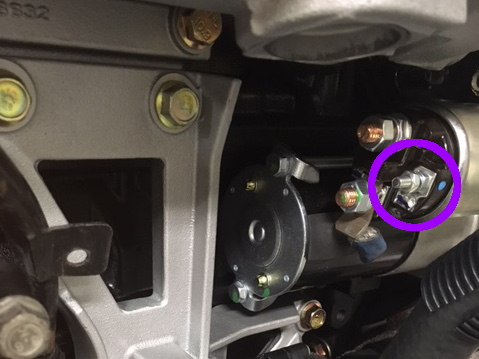

Do you the purple wire connected to the starter? Measure the voltage on this wire while trying to crank.

There are some green wires that were all connected together, they are low speed day wires, there are some of them that if missing or not connected will keep the engine from turning over.
This is where the purple wire goes. Others have not hooked it up for one reason or another.

Thanks. I think mine has a connector in place of the lug but i will check regardless. As well i will test for voltage at "Run" key position.
Only during cranking will you see a voltage on the purple wire. If not, then we will have to move back to the relay in the fuse box to see if it’s getting signal from the ECM.

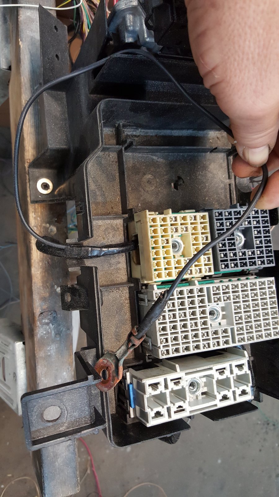

Ok, i think i misunderstood a previous grounding request at the "headlight harness".
http://dfkitcar.com/forum/index.php?threads/tonys-city-goblin-2010-ss-tc.232/page-12
Post picture from lonny, 236. Where is that wire connecting to under the white block?
ugggh. Edit - i grounded that lug under the headlight harness. Now when i turn the key i just get the security lock symbol and nothing else. Going backwards... :(

Trying to confirm this headlight harness ground. Not understanding what connects to what.
When the black wire of the headlight harness is grounded to the frame, this will provide another (different and much needed ground) to the Fusebox through the white connection block under the Fusebox. The rest of the headlight harness doesn't need to be connected to anything, only the ground lug.

Thanks chad. When you say the "black wire", is that simply the largest pinned wire in the white connection block? I tried watching video 13 again and it quickly panned away from this description and moved on to another task. Right now that largest black wire is fed into the harness with the rest of the headlight harness wires... i was planning to just splice into the largest wire a few inches outside the connection block and run a ground to the transmission. Hope that makes sense.

Thanks Lonny. When i redid the harness i did not separate any wires out from the rest of the harness as you've shown there. I just wanted to confirm where that ground lug wire connects in the white connection block. Do you have a picture of inside the connection block? or a pin number? Sorry if im being difficult. Just dont want to screw anything else up.
