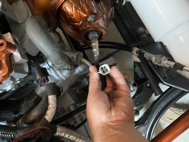

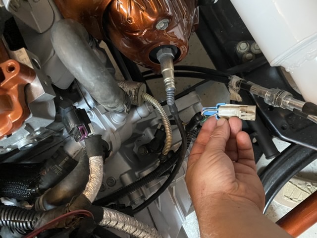

I do have this plug hanging free by the transmission and am not sure what it is for.

When I was building mine, I had a tan data wire break. It would prime the fuel pump but not crank, easiest way to check for that is to rent a code reader from an auto parts store, mine wouldn’t connect to the ECU. The plug by your transmission is for the downstream O2 sensor, as JBINTX and Rttoys stated. You may need a clutch pedal position sensor relearn, if you had to change the ECU or sensor.

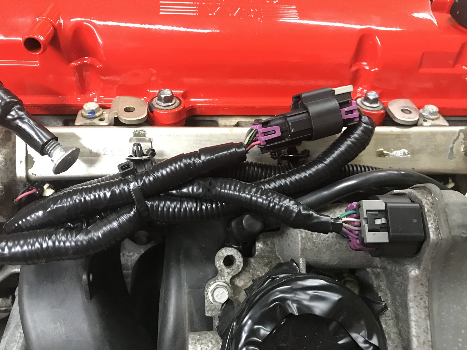

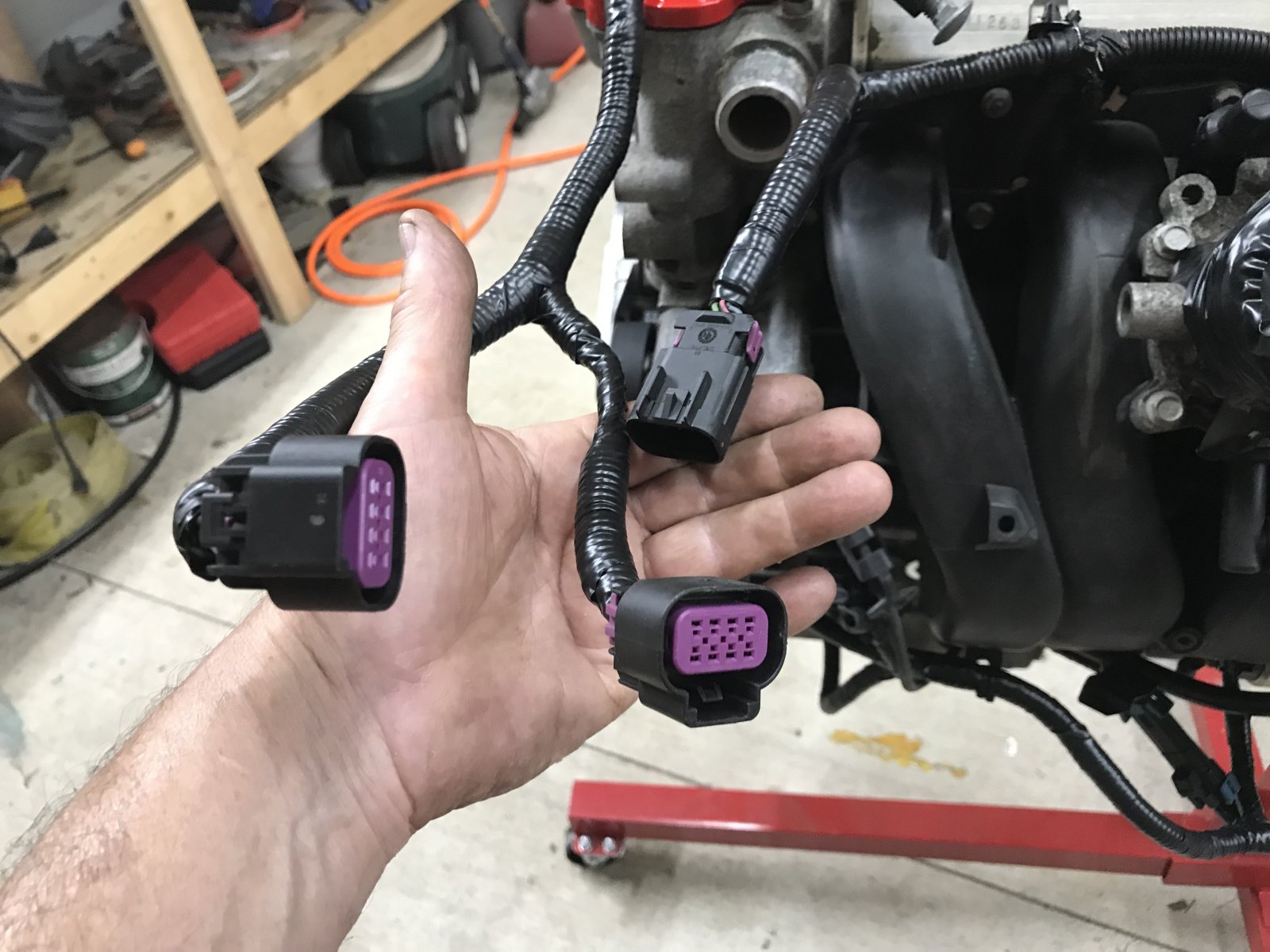

Someone allready mentioned this. These plugs are identical and easily swapped. Look at the colored wires going into one plug and out on the other side. They should match. One plug goes to the harness the other goes to the throttle body.

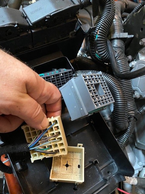

I'm getting no power to the purple wire attached to the starter. From the diagrams that runs to the BCM crank relay. I checked the crank fuse and its good. I'm not sure how to test the relay unless I just remove it and jumper the connections.
Do you have access to the wiring diagram for your 2010 Cobalt?
Can you post a pic of the connector that comes out of the spark plug area? I want to see that the wires on both sides of the plug match color for color. This should hold true for all connectors - the wires should match on both sides, colorwise.

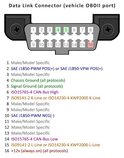

Can you check if you have power from OBDII pin 4 (ground) to pin 16 (12V+)
