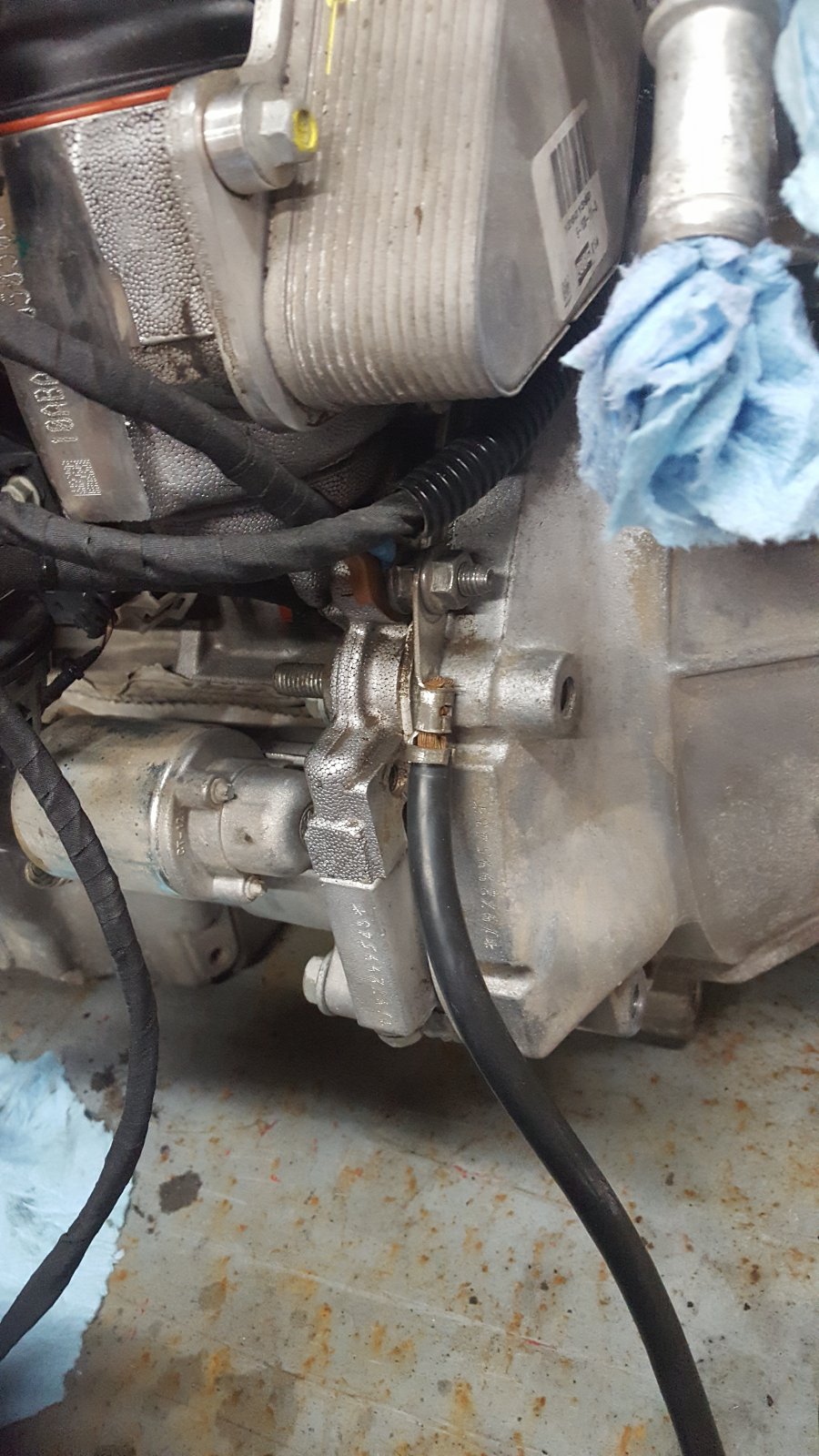

Also check the ground wire that connects to the transmission. I think this is what Sasquatch said above, I upgraded mine to a beefier wire. I ran a big wire from the trans ground to the ground bolt on the driver side rear of the car.
Stole this image from Briann1177 on here.

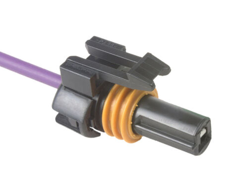

single wire connector on the starter that connects the crank relay to the starter. This is how 2008 works I believe it should be the same on both year LNF engines. Here is a picture.
connector from crank relay to starter (or similar)

I have that as well. It's not connected to the positive post as the others. It has it's own plug. I was going to unplug and reset it to see if that makes a difference as well.
