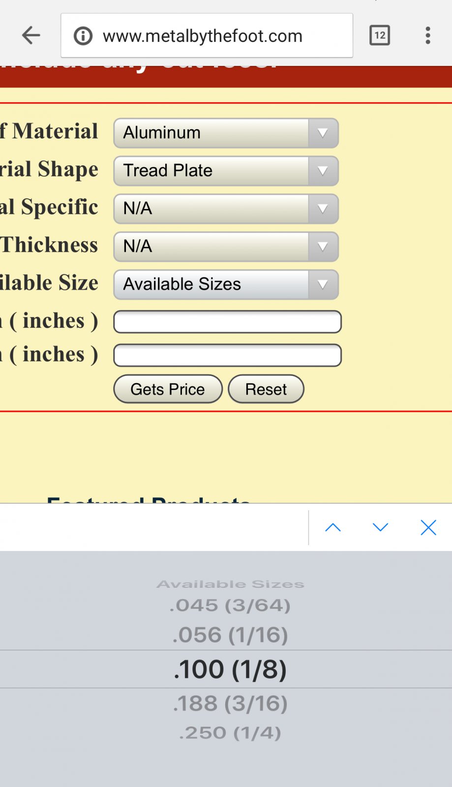

Yeah I’m going to go after this myself, a local place to me carries these sizes.
I’d really like a stiffened floor.

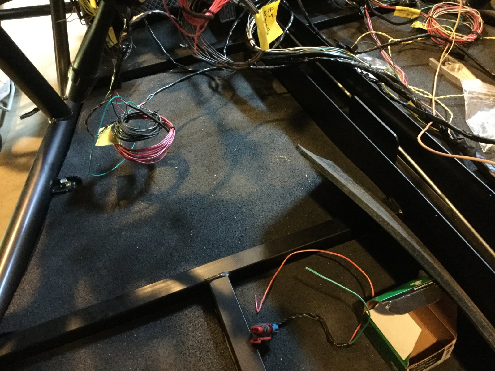

Here is a photo of Nate’s floor. The mating is actually 3/8” horse stall rubber mating (you can see a piece of scrap on the right side).

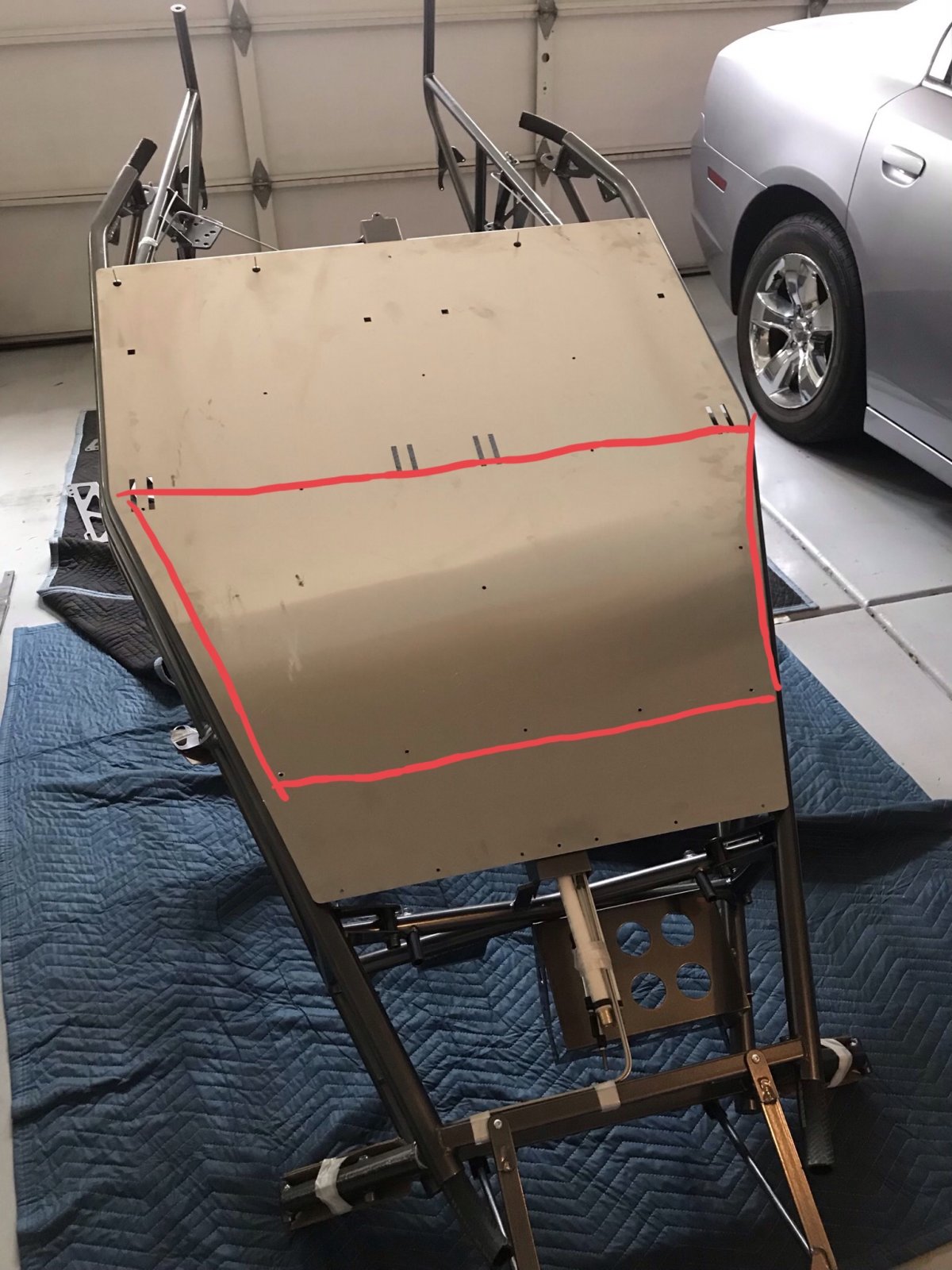

I am going to put a piece of 1/8” (or 3/16”) SS plate on the underside, and have it bolt where the floor strap would normally go, and then either rivet it or tap and bolt to to where the holes are drilled now for rivets. I think this will go a long ways in stiffening this area way up.
askiles
Andy, can you show us in a photo where you are thinking of putting in the plate?
It will just be in the section where your feet would step while climbing on. From tube to tube. I am not sure if the rivets would suffice, so I would consider just tapping the holes and putting in some button head machine screws.
