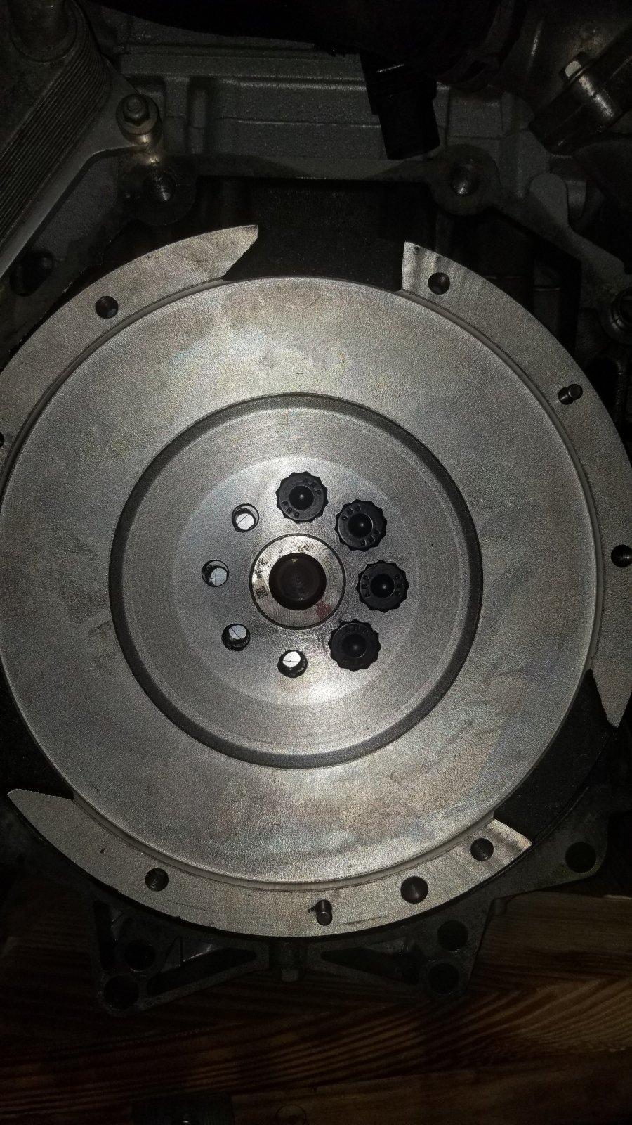

I also bought the ebay flywheel which was said to work with the LSJ and LNF. Unfortunately it's significantly lighter than the stock LNF flywheel and the bolt holes don't line up so it can't be installed. It's an LSJ specific flywheel so I'll (probably we) will have to figure out another solution.
*** EDIT - THE LSJ FLYWHEEL DOES WORK ON AN LNF, I'M JUST AN IDIOT ***
try every combination of flywheel bolt holes to crank holes, I could only get the one on my lsj to line up one way. I thought it was mis-drilled at first.
Ross, be careful grinding. If you put too much heat into the bolt head it will loose temper and become weak. I seen this happen before - using Dodge flywheel bolts on a Ford 351 Cleveland, ground the heads down for clearance and broke them all on the first race at the track. Not pretty.
On some flywheels, one bot hole is drilled offset to assure the flywheel goes on the crank the same way every time. This is for balancing purposes.
When you balance your rotating assembly, you first spin up your crank and get it balanced. Then you bolt on the flywheel and balance it.
When you reinstall your flywheel after balancing your engine, you should always reposition it the way you had it when you balanced it.
I wasn't aware that Ecotec engines had an offset flywheel bolt. So you may have another problem.
