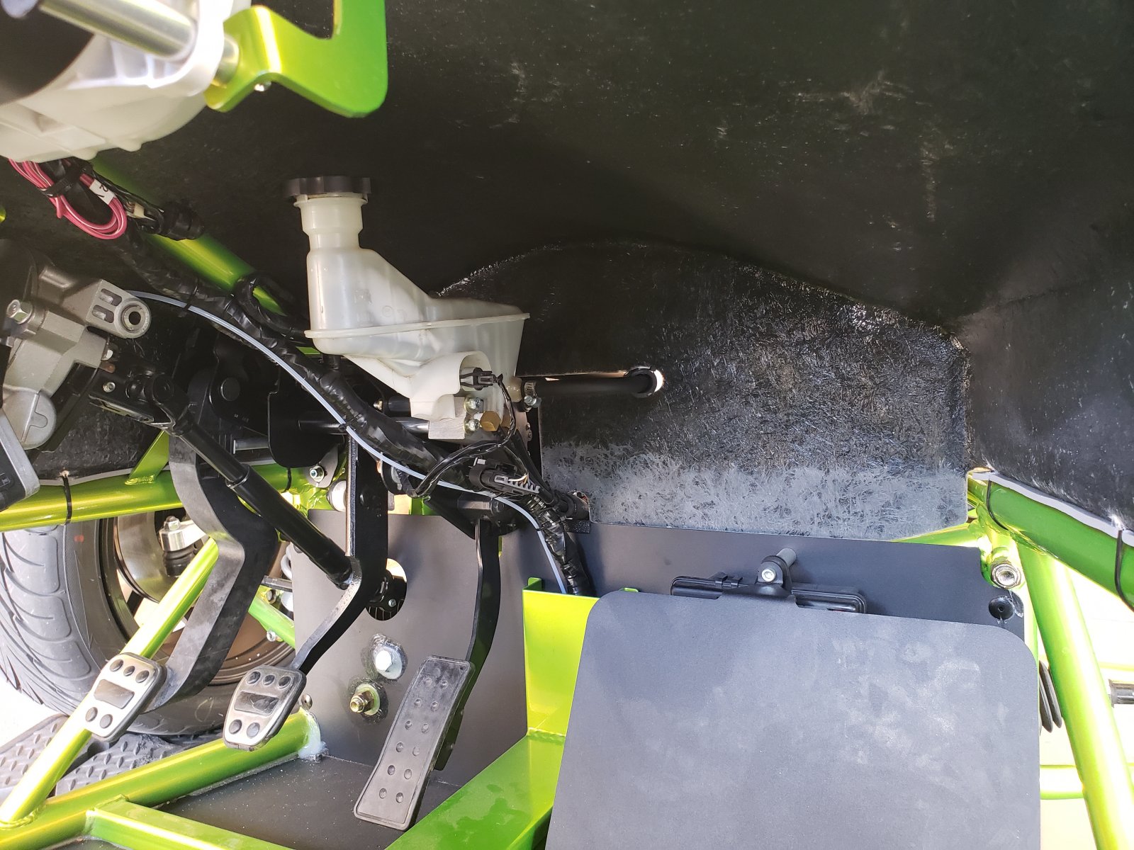

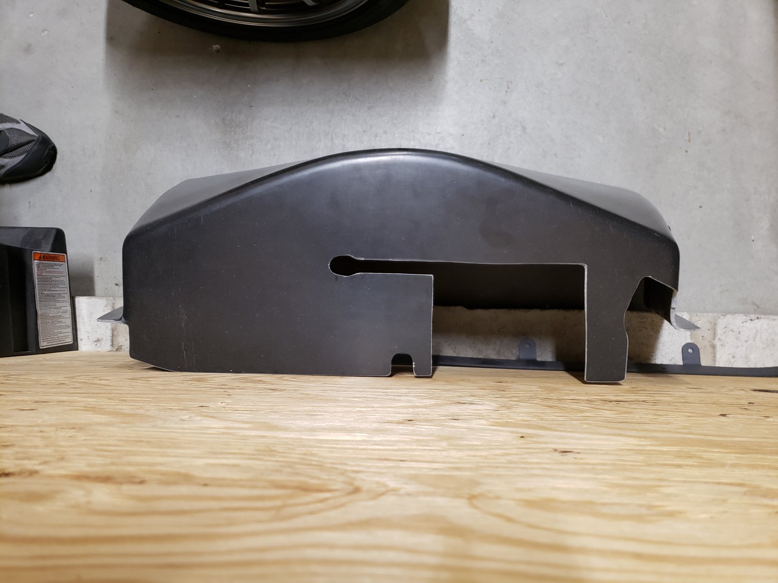

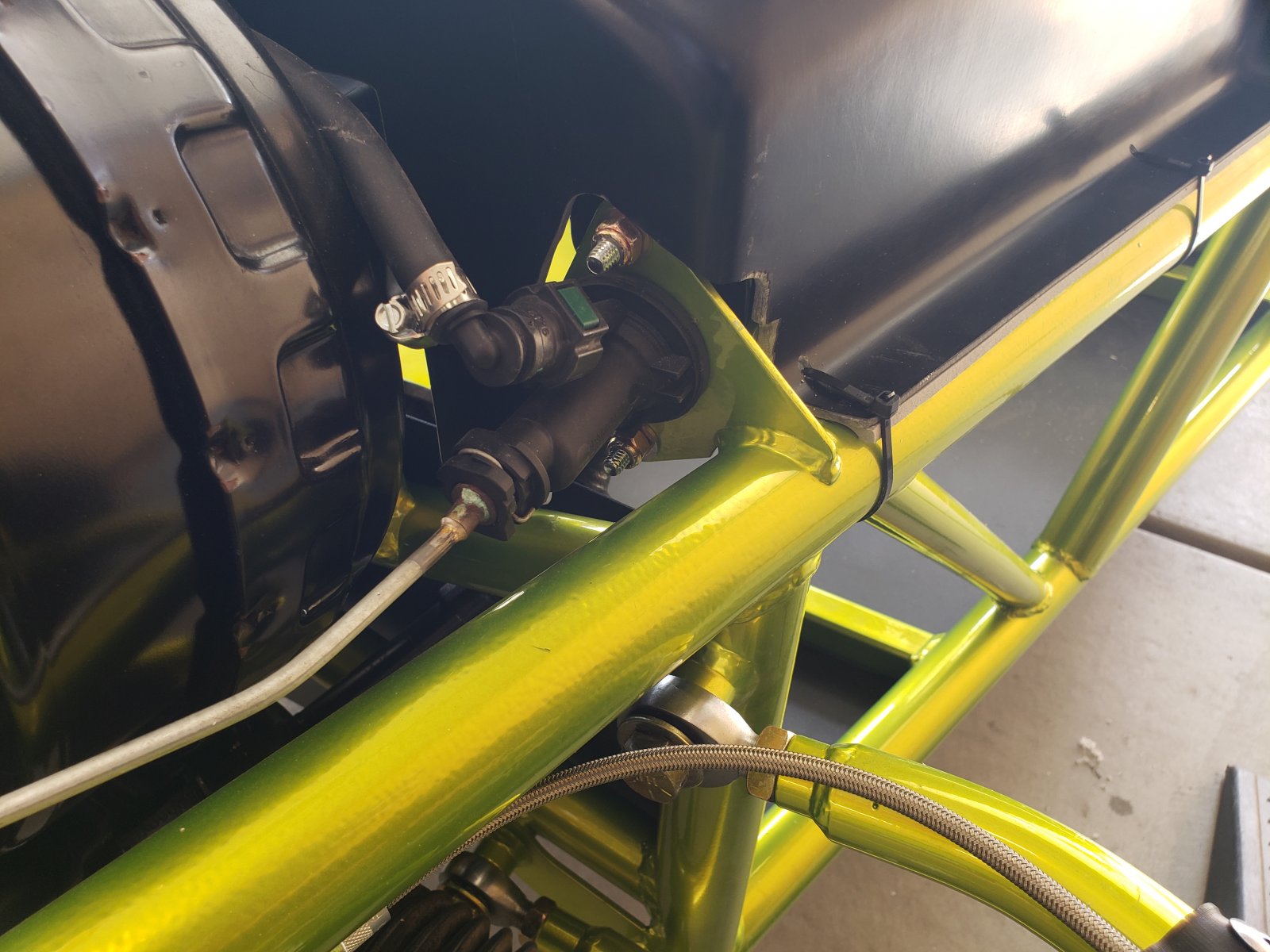

This cover fits on the underside of the hood to block off hot air coming from the radiator. It's a clam shell that meets up with the front firewall, forcing the hot radiator air out the sides and bottom. And man, does it work! I drove my car on a hot sunny day before installing the cover and my legs were hotter in the shade of the hood than my upper body in direct sunlight. Now, with the cover installed, it is way more comfortable. Here is how I installed mine. First off, the cover is made for an automatic goblin, so a little cutting is required to fit around the clutch stuff and the hose from the brake reservoir. This is how I trimmed mine.

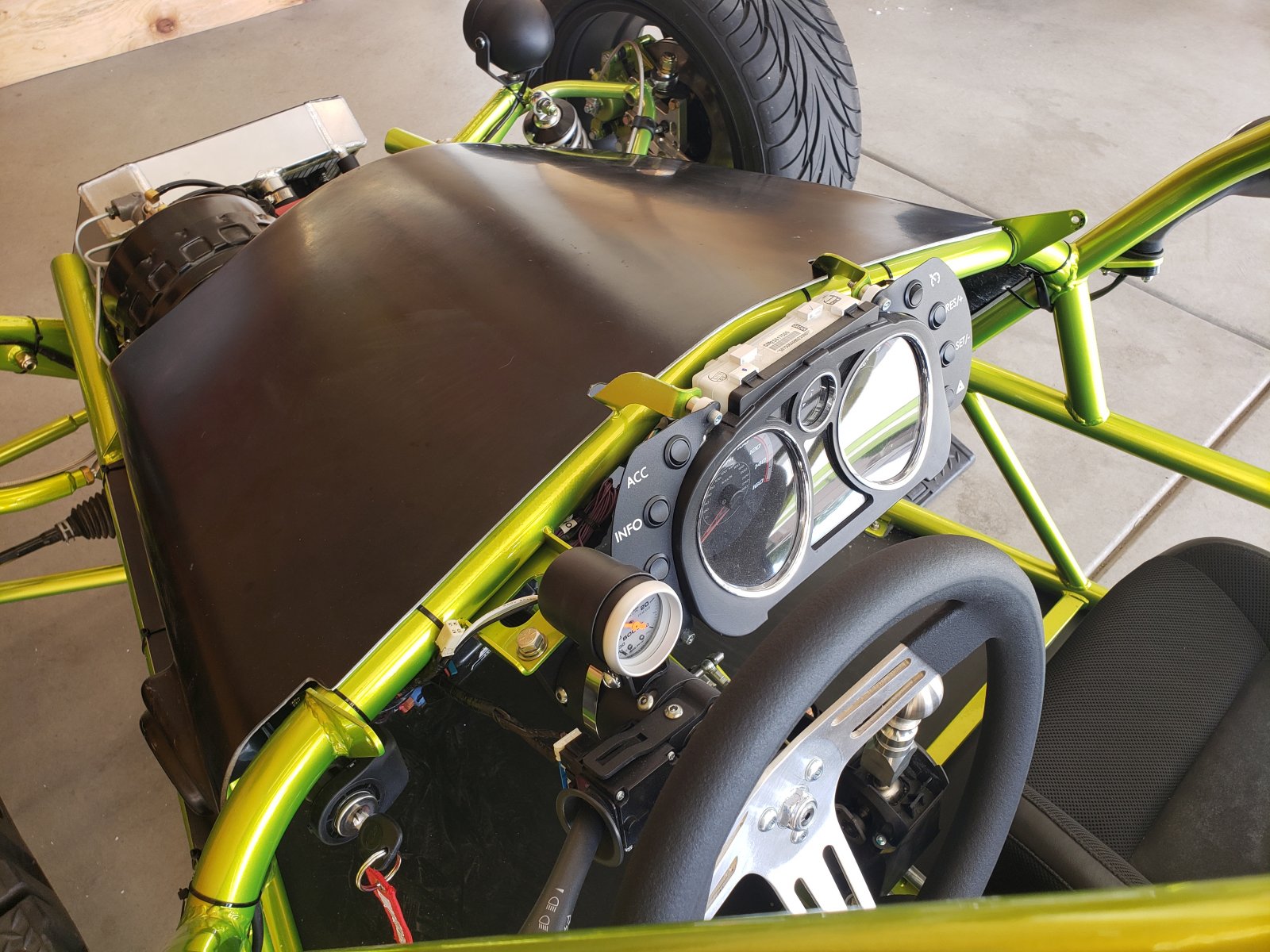

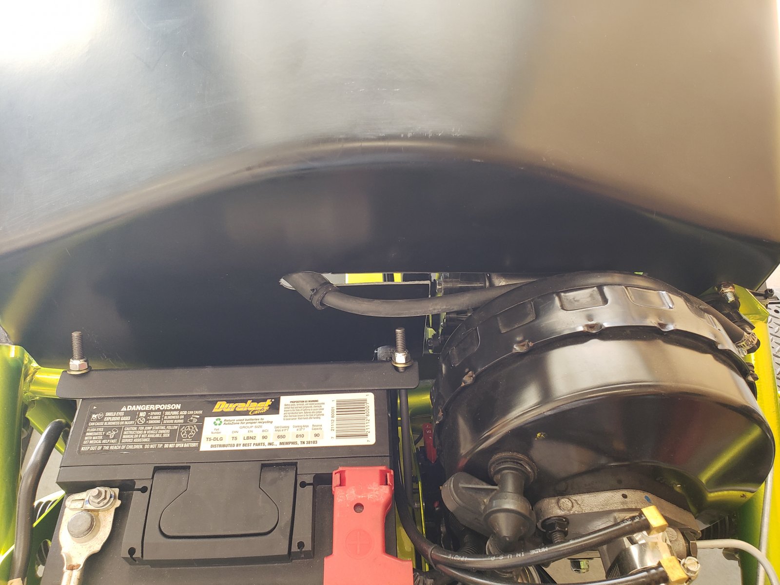

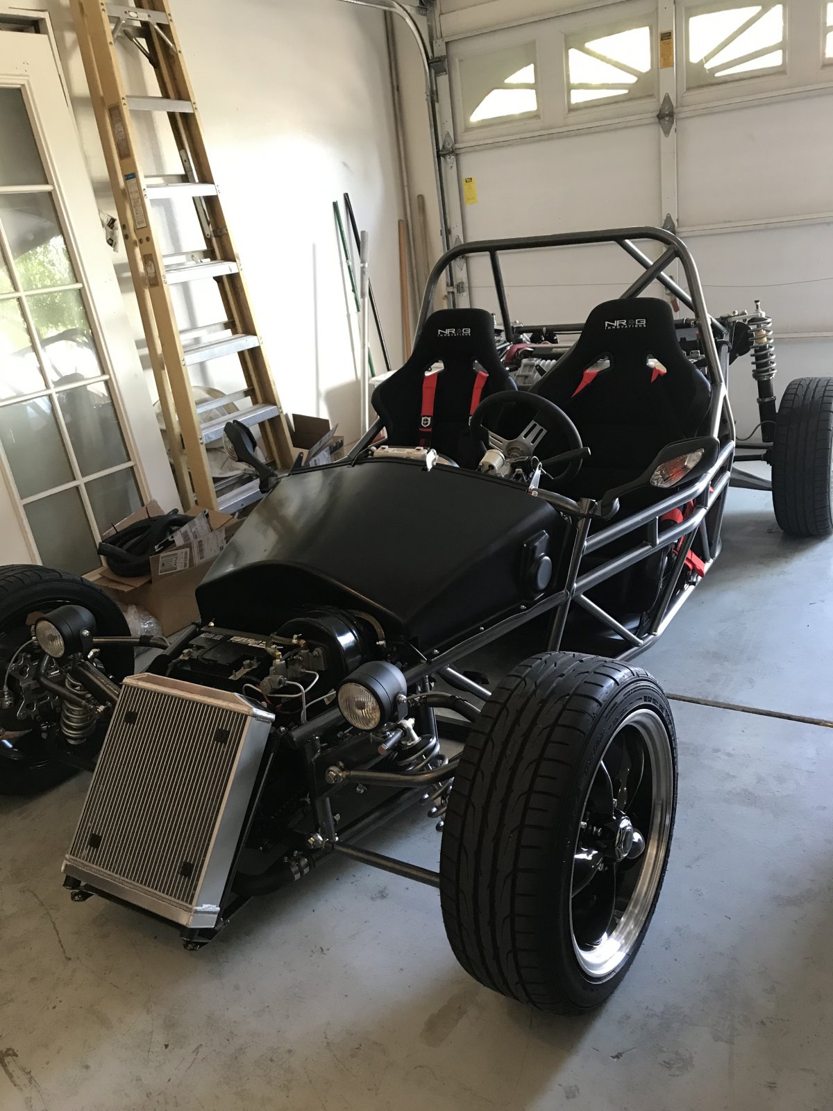

These are shots of it installed.

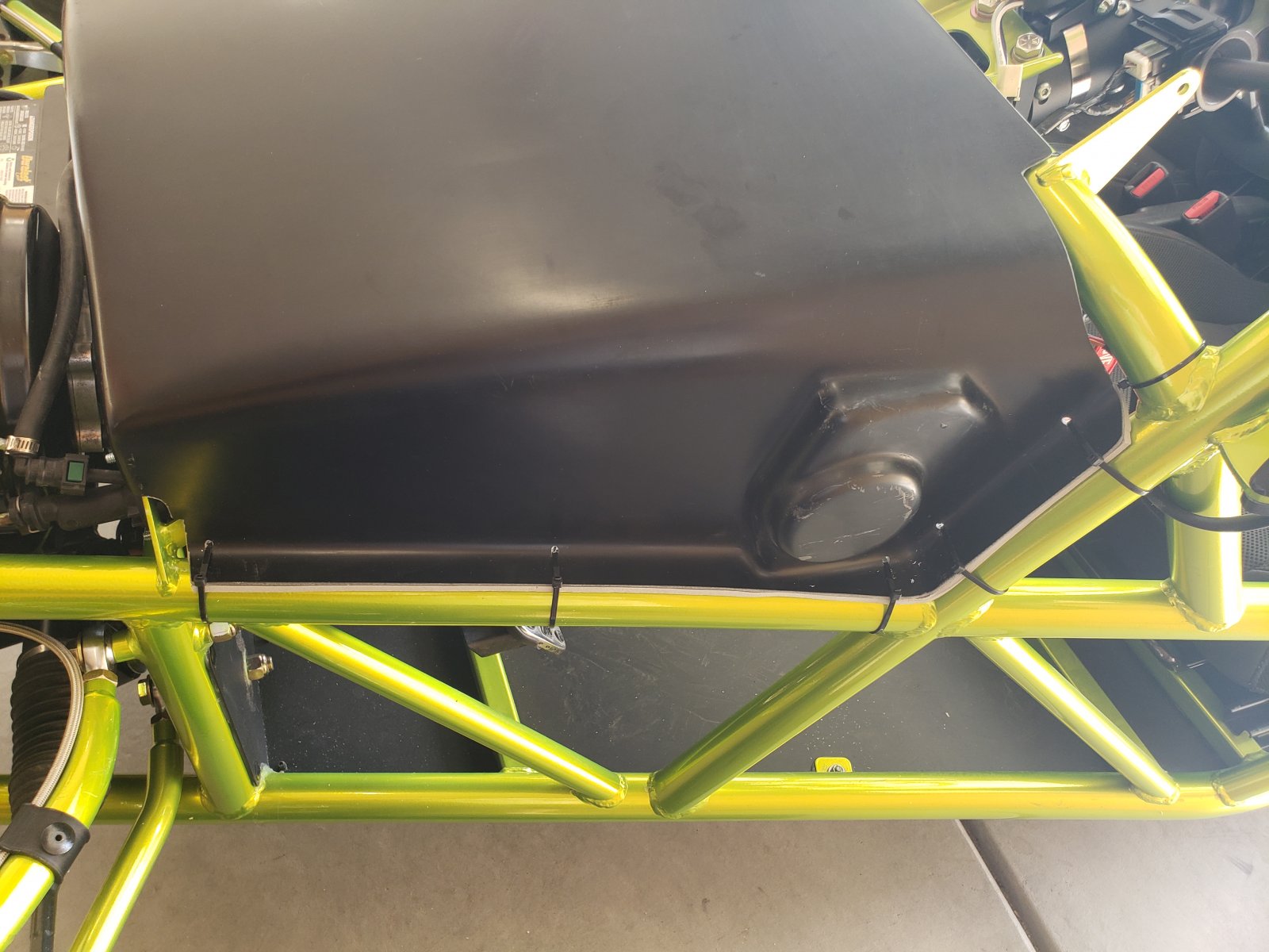

I used foam tape purchased at lowes called camper seal.
I did this so I could remove the cover later for maintenence, but keep it from rubbing through the powdercoat. I held it on with zip ties for easy removal. The kit comes with self taping screws to go into the upper frame rails, but I thought zip ties were more convenient. I think I will add a little black duct tape to cover any areas that still allow the hot air to flow through. Overall, well worth the money for more comfort.

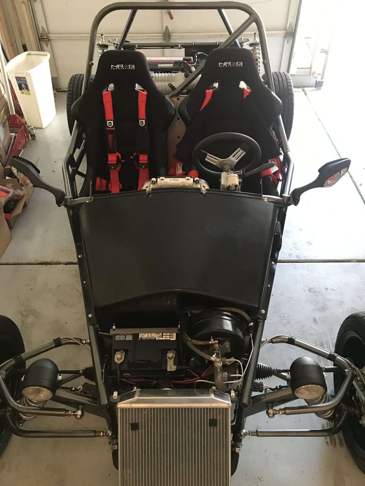

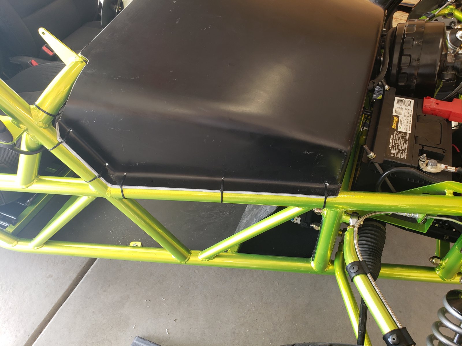

Installed my footwell cover today. Lots of cutting and fitting. Not the greatest fit in the world, but it is not seen and it serves its purpose.

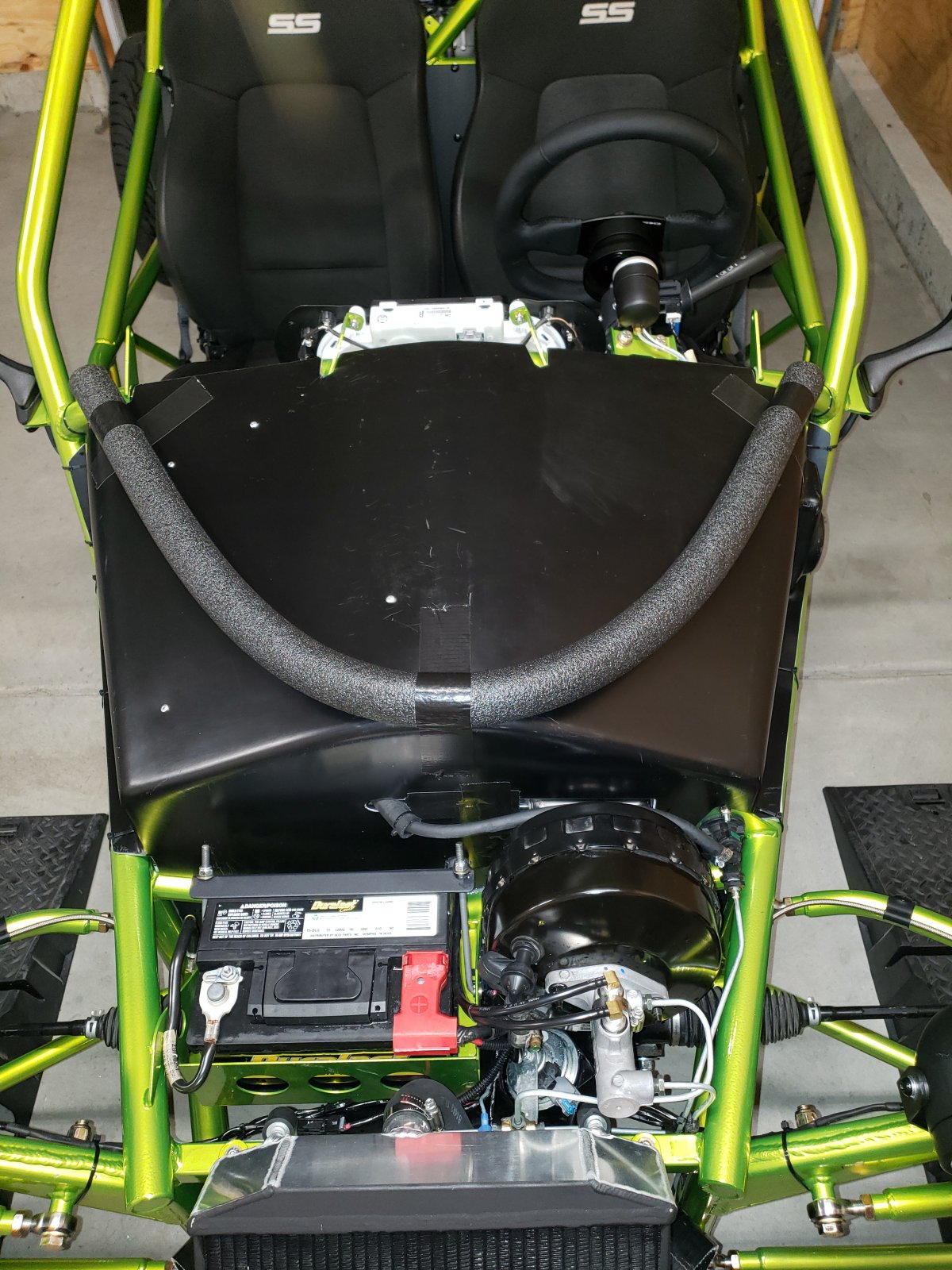

I made one minor change to this installation. I found that while my legs were no longer hot with the footwell cover installed, the hot air was then redirected over the footwell cover and discharged at chest level. It was like having vents in a normal dash. So what I did, was to run to lowes and get some foam insulation for copper piping. I taped one tube to the top of the footwell cover in a V formation. The tube gets squeezed flat when installing the hood. All the hot are now gets diverted to the side and discharged by the mirrors. Very cheap fix.

Smart! Makes total sense. That hot air had to go somewhere.
