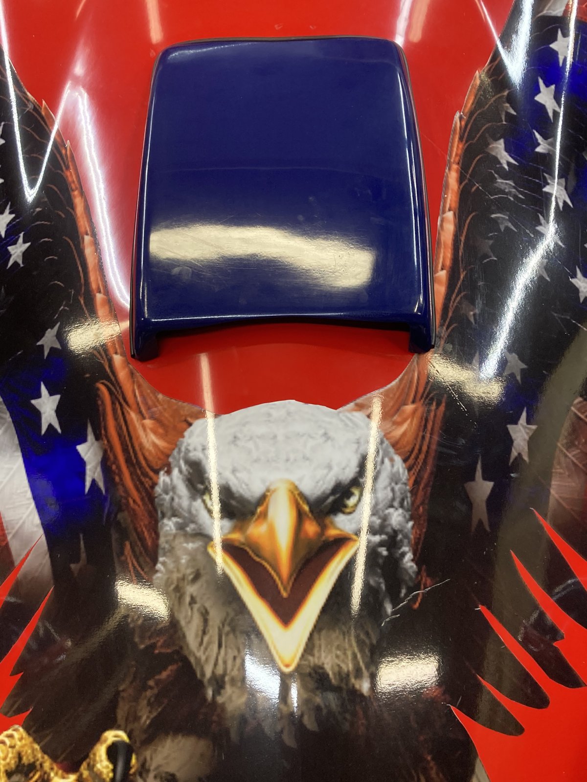

First step in ducting outside air into the footwell.

I got the vent ducted to the footwell area and drove it this weekend. I'm not sure that the results are worth the effort. On one hand, there doesn't seem to be a lot of positive flow into the footwell. On the other, I think it did change it from being a negative pressure area that sucked in hot air from the radiator. We'll see what it does when temps climb.
My hood vent is probably a little small and the air flow must shoot over it. The duct is only 4" diameter and probably needs to be bigger. After I see how it works in summer heat, I may try to make a larger & taller custom scoop and larger duct.

I did drive mine last week on a warmer day, and I think mine through the hood is doing more than I initially thought. Still doesn't have any real positive airflow, but definitely didn't feel the warm stagnate air that is usually there.
