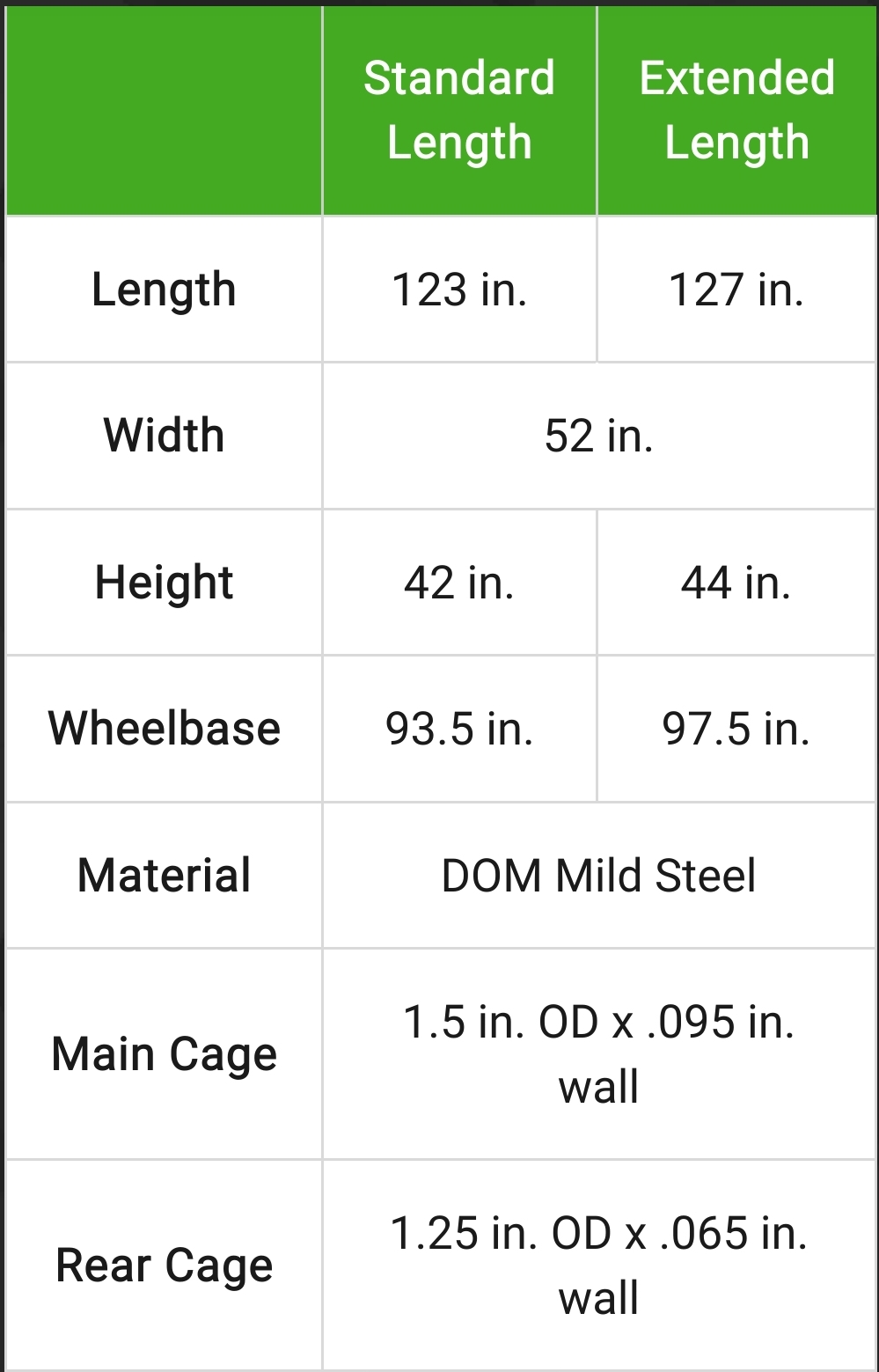

Anyway, I wanted to see what other frame modifications are being done, either for functional or aesthetic reasons. Anyone know what diameter/thickness tube is used for these frames? Standard CREW, or DOM?

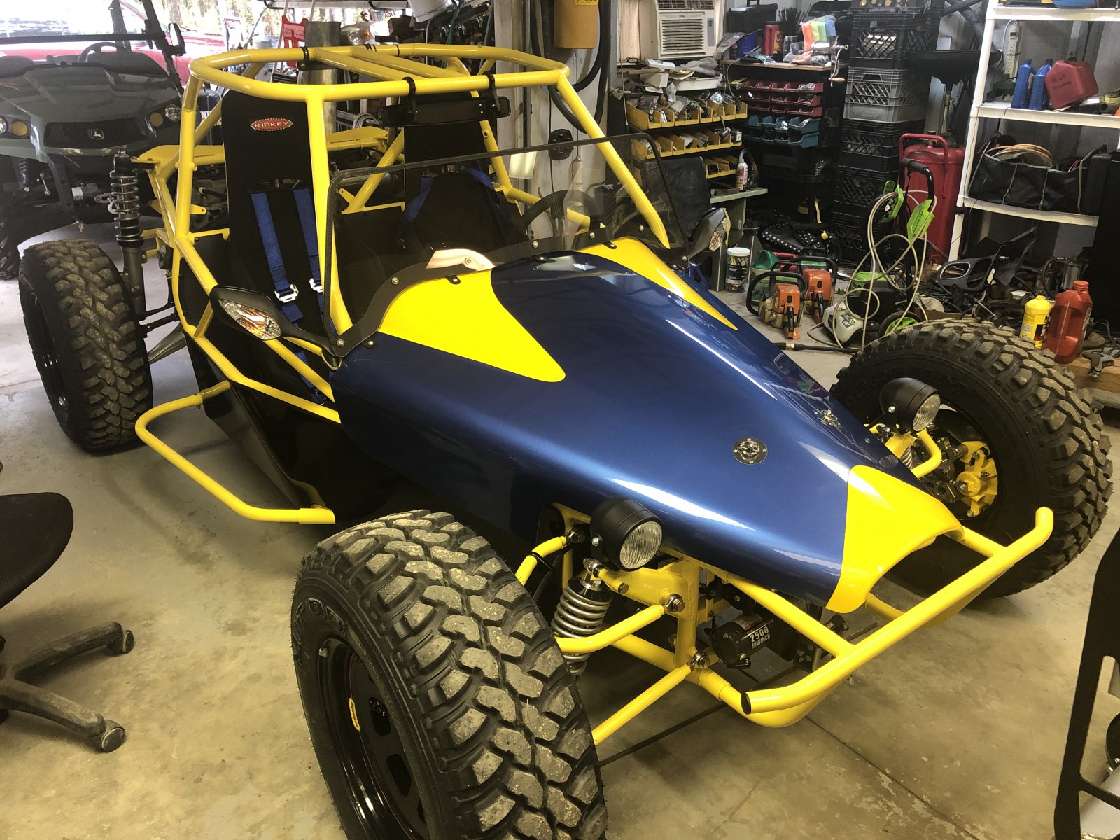

Lastly, coatings. I know most people are having their frame powder coated. My only concern with doing that is I wont be able to touch up the coating if I have to grind away to weld a tab/bracket here or there. So, I'm thinking about automotive paint instead. My FIL has a makeshift paint booth, big compressor, HVLP guns, and car painting experience, so I can do my initial frame modifications, hang, and paint. And any changes later will be easy to touch up. At least that's my thinking. Any feedback on paint vs powder coating?
The main frame is 1.5" DOM tubing, then the minor tubes are 1.25" DOM.
I also painted my frame because I wanted to be able to weld on it in the future. I just did simple Rustoleum white, and I end up doing paint repair about once a year, as it gets rock chips, seat belt chips, and normal wear and tear.

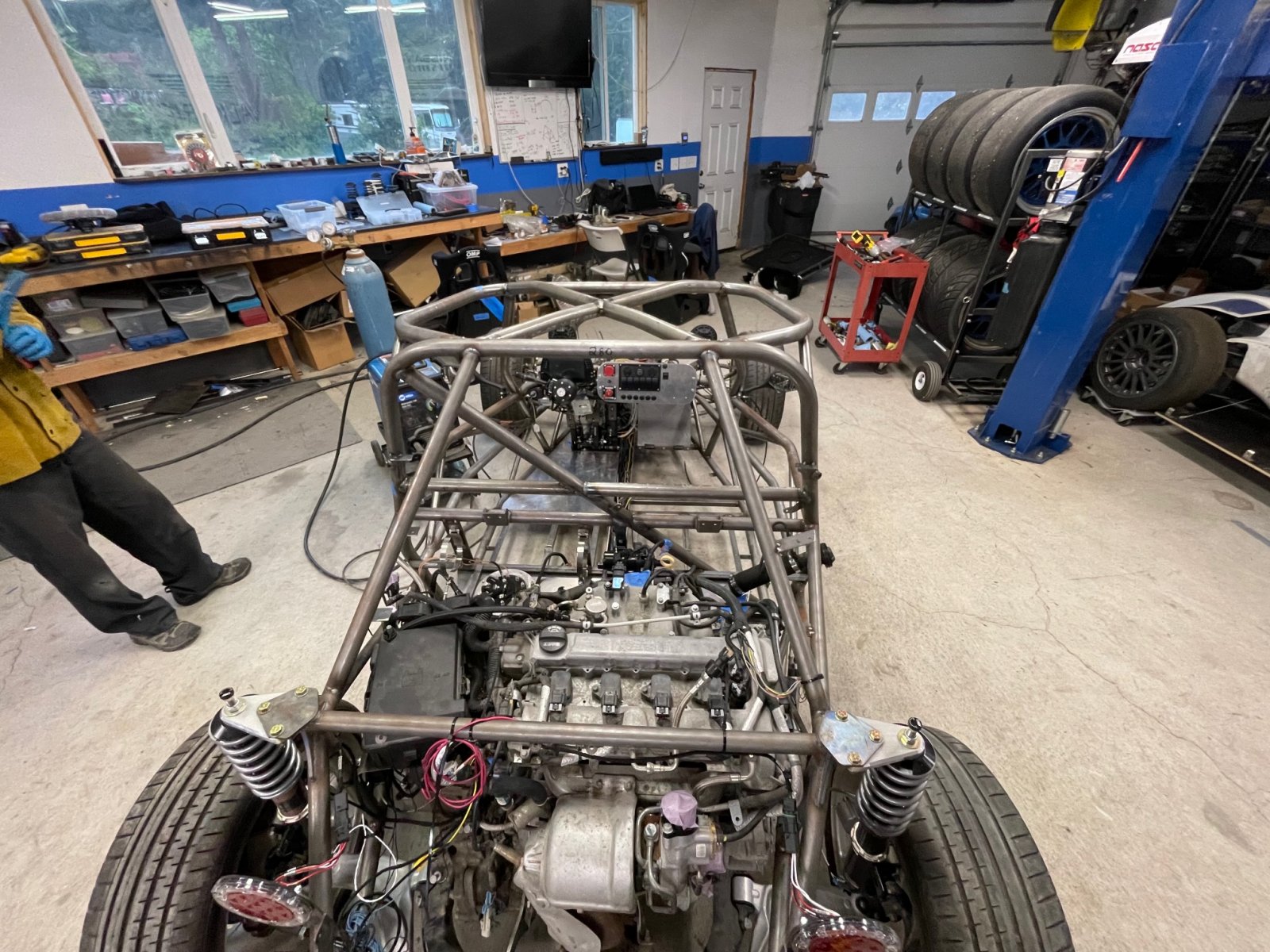

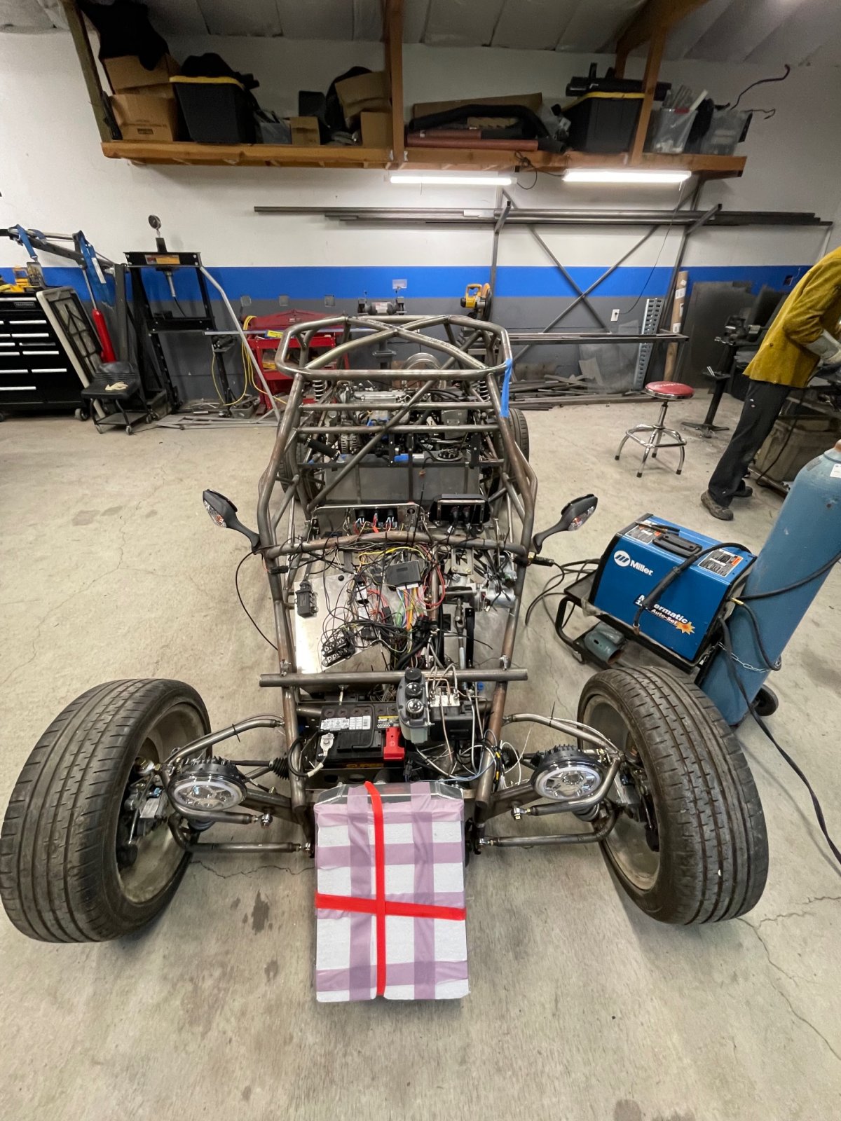

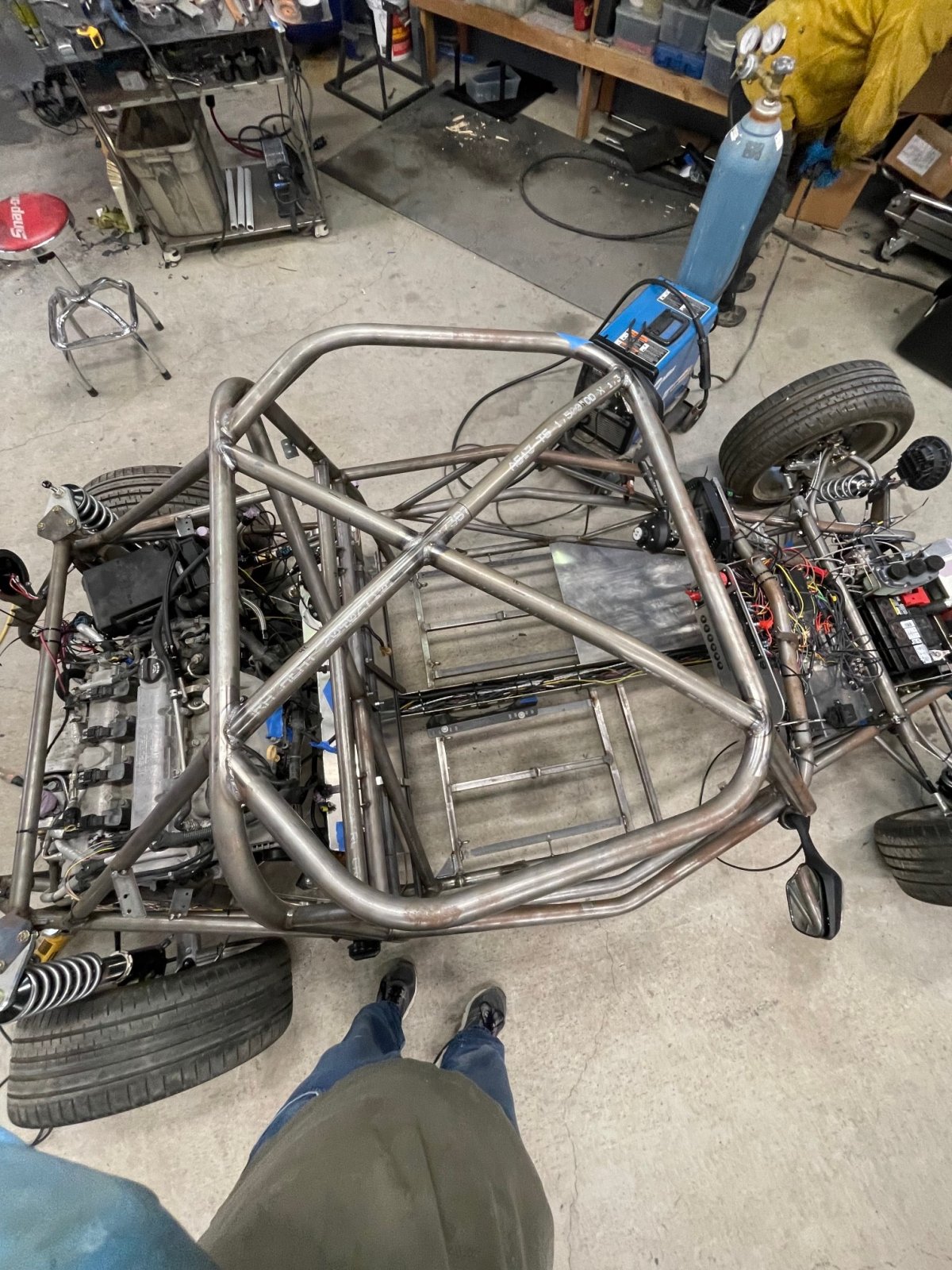

Here is the X Brace.
