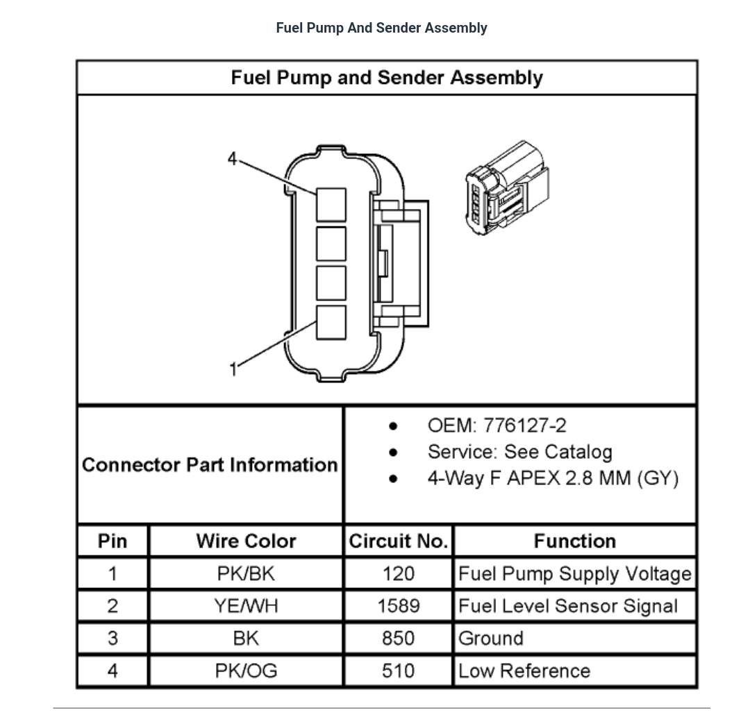

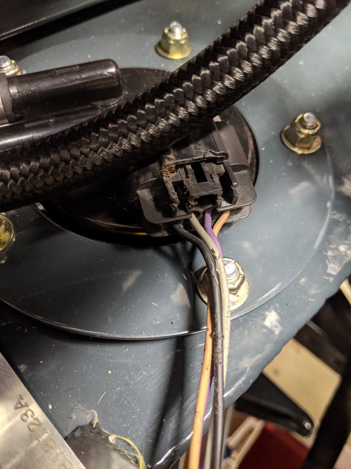

Does anyone have any insight as to why the wires I have going to the fuel pump assembly aren't even close to what the diagram says they should be? I'm trying to find the pump power to use as a relay activation for the surge tank pump.
