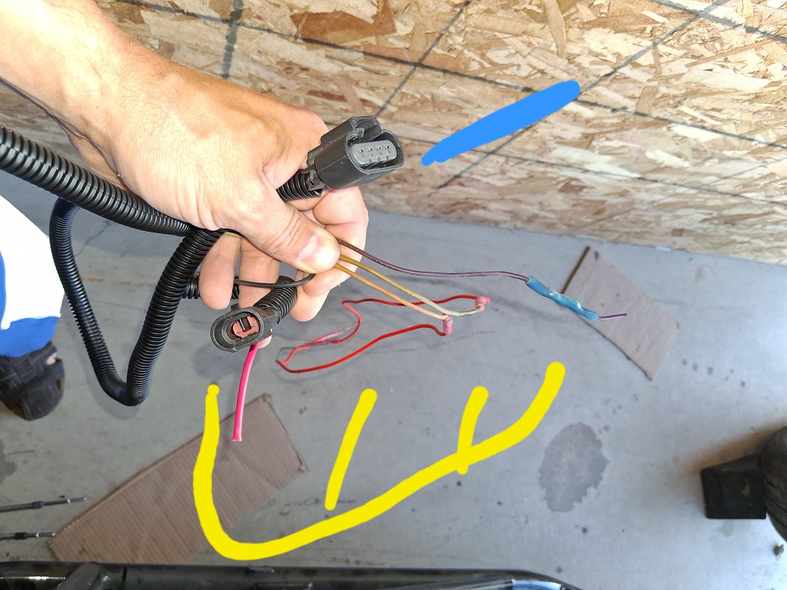

I have 3 red wires, 1 purple wire, and one plug coming from the fuel pump Help, where to make the connections to? Thanks

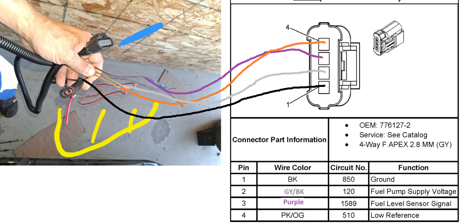

Here is the stock wiring diagram, and connector pinout.

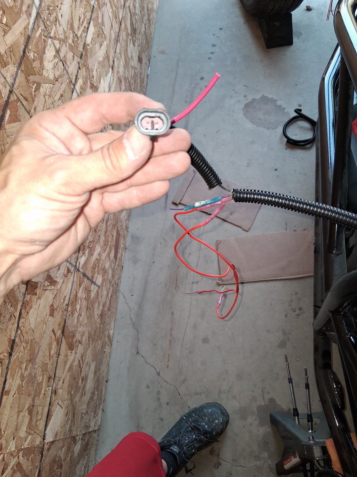

Here's a picture of the whole wire harness. The blue marked end is coming from the fuel pump. There is purple, Grey, orange loose wires unsure where they connect to. And a plug wire with a single black wire connected to it a red short loose wire?
DF modified your 05 wiring harness to have the 06 fuel pump connector... Did you cut that off while attempting to use your 05 fuel pump, and now don't know how to restore the harness to the way DF had it?

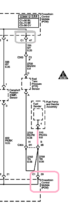

Here is your fuel pump sender electrical diagram.
It shows the Pink/Orange wire from PCM connector C1, pin 29. (Low Reference)
and it shows the Grey wire from PCM C1 pin 47, that would connect to the Purple wire on an 06 fuel pump. (Fuel level Sensor Signal)
It shows the Pink/Orange wire from PCM connector C!, pin 29. (Low Reference)

Judging from your last picture, the connector is in your hand, with the wires hanging out of it.

Could you follow the wires on yours? I have the end that plugs into the fuel pump, not sure where the other end goes to. Could you trace/follow the wires that go from fuel pump and snap a picture where the they're going to? I'd appreciate it

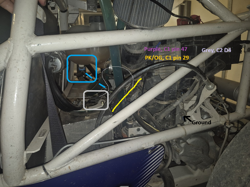

My fuel pump wires start at the grey square, go a few inches where the blue connector (radiator overflow bottle full) joins in.
Most goblins don't have the radiator overflow switch, but mine does.
Then those wires follow the thin grey line, and join in with a big harness (shown in yellow).
From the wiring diagrams (I checked, 05 and 06 Cobalts are the same pins) I know that the Purple and the Pink/Orange wires ends up on the PCM, which is that aluminum block on the side of the fuse box. I also know that the Grey power wire comes from the rear fusebox, and the ground is probably the ground lug below it. I didn't unwrap my harness to actually trace the wires... and according to the wiring diagrams, the wires do change color by the time they get to the PCM and fusebox... but you could use an electrical meter, and check the fuel pump wires do connect to their end destinations, and not have to unwrap the harness.
