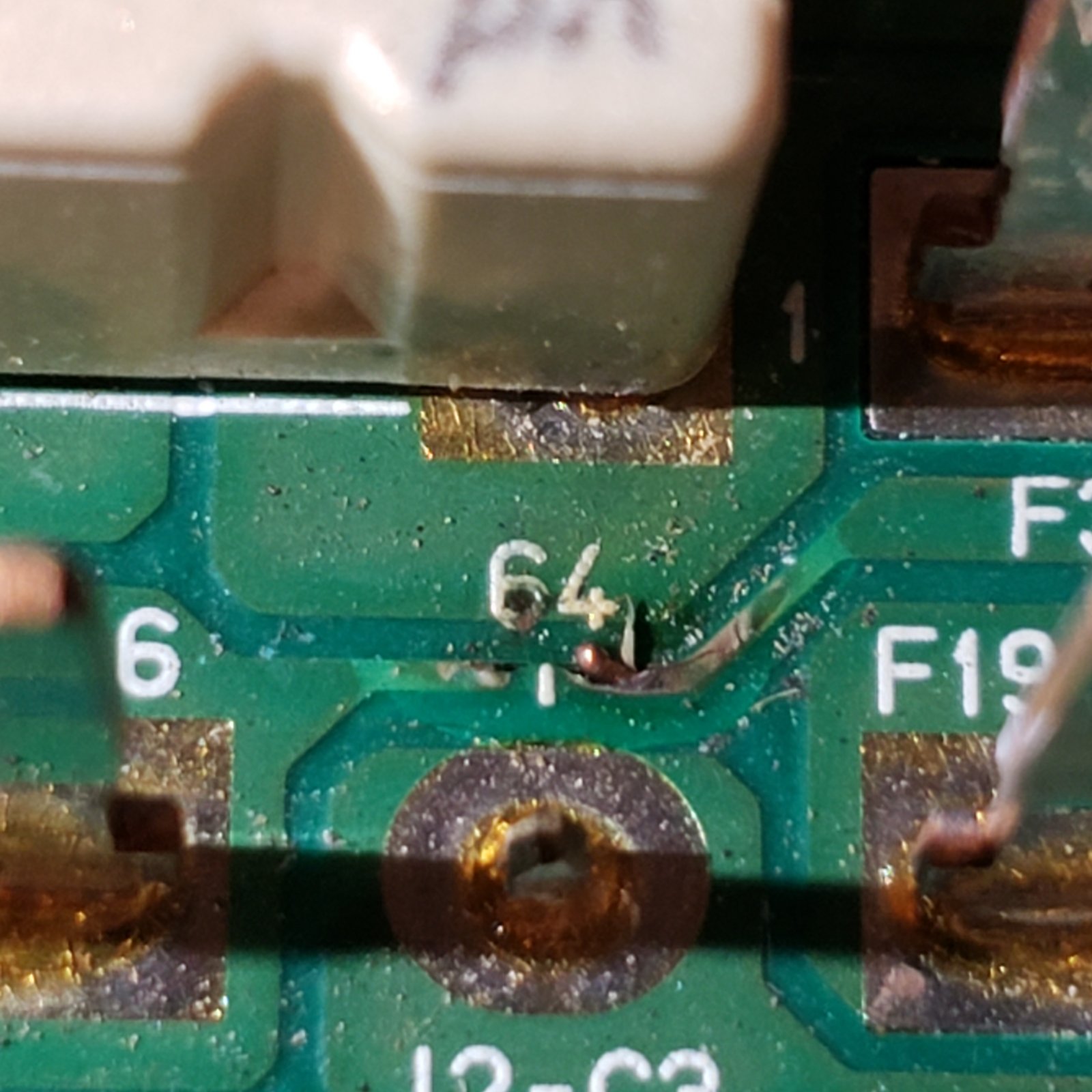

Below is the burnt trace, I ran a jumper from R12-86 6 to R1-86 6

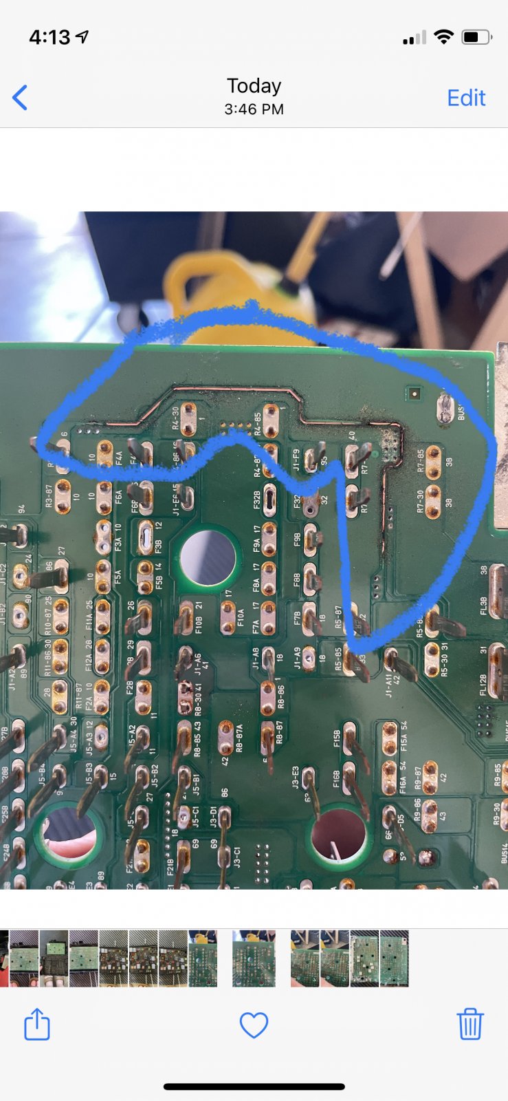

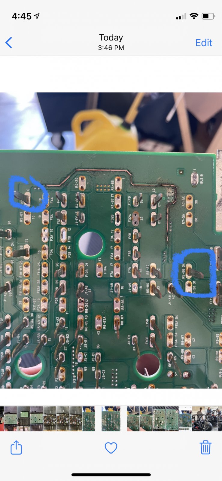

Do you mean from this port to this port? And then solder? I am clueless when it comes to these things.
Its hard to tell but it looks like you have it correct. The key is to follow the burned up circuit trace and replace with with a wire (leave the insulation on the wire). Solder the wire to the pins that are connected to the burned up circuit trace.
Be sure to inspect the circuit board for any other burned up traces. You are this far into it, you might as well look for others. Mine was burned up in a small area, about a mm long.
