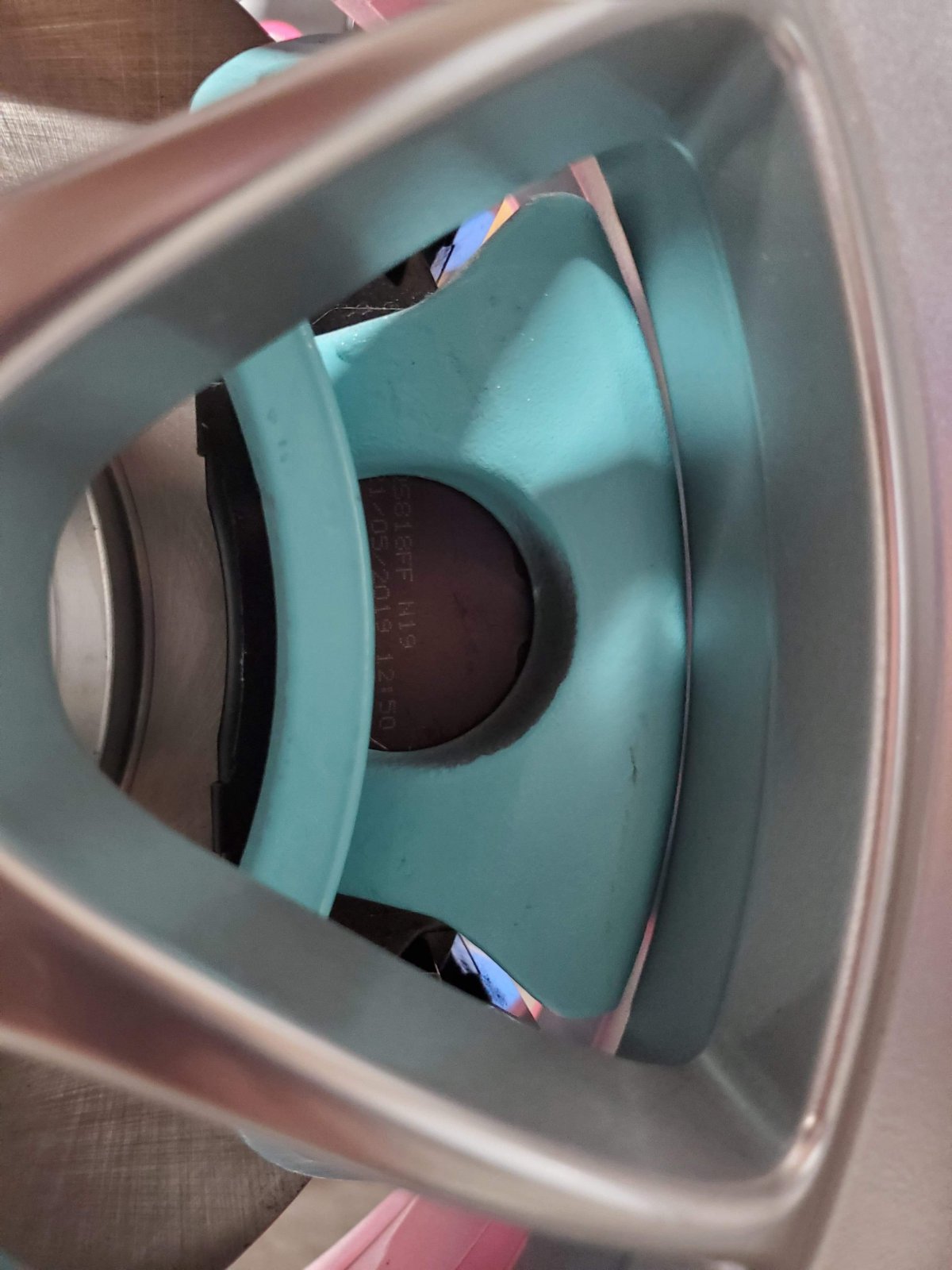

This is going to sound backwards to some people, but in the quest of clearing the brakes with 15" RPF1s, Adam turned me onto the fact that the 10" base model brakes fit on the front uprights with slight modification to the front hubs.
I was using cheap 4x100 x 1" spacers and was looking to get rid of them for weight savings, and because lug-centric spacers are ratchet. Also, I had about 0.020" clearance even with them:

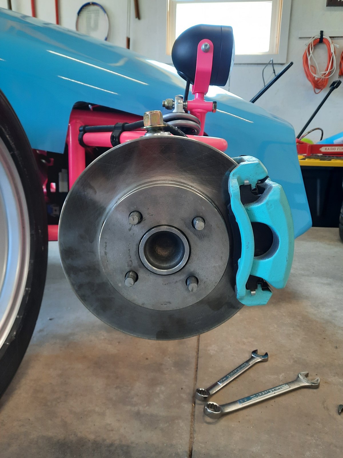

I emailed Adam asking if they'd make custom uprights to move the caliper in, but he ended up pointing out what I should have noticed. The only difference between the 10" (4 lug) and 11" (5 lug) brakes is the bracket and the rotor.
I test fit yesterday, and the OD of the hub is too big. I turned it down to about 5.200" today and it fits great:

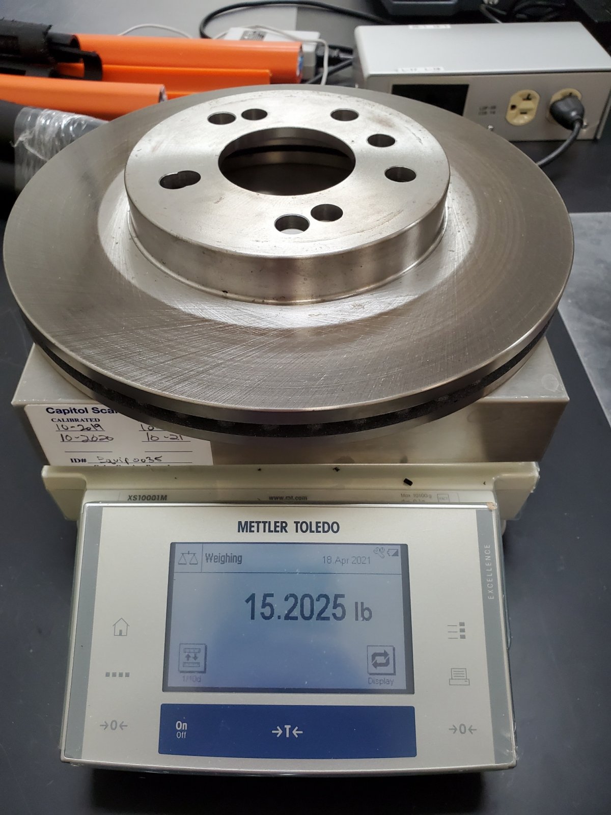

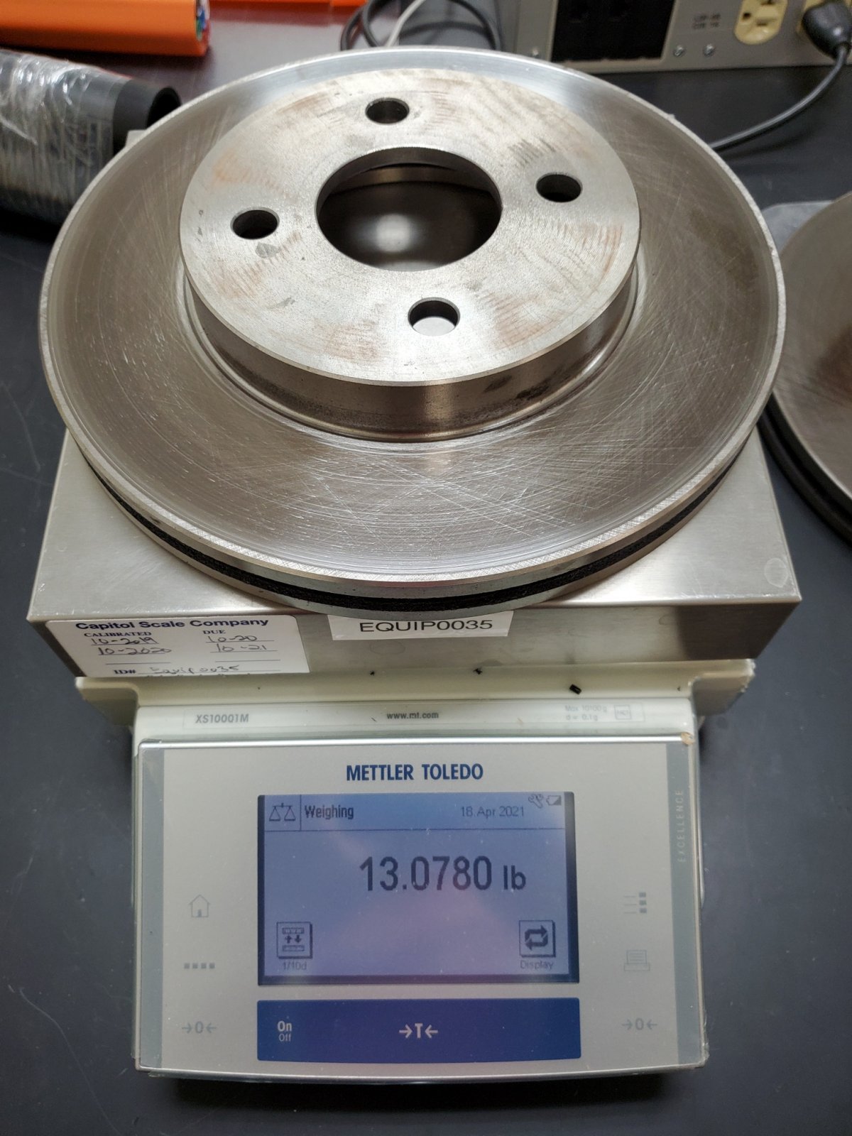

4. Remove 2# of spacer and about 2# of rotor weight from rotating assembly.
Needed supplies to convert from 11" brakes are two caliper brackets from a 4 lug car and two 4×100 rotors. Turn down front hubs to fit inside 4 lug rotors (you measure.) If you pound out one wheel stud, a 3 jaw chuck in a lathe will grab it.

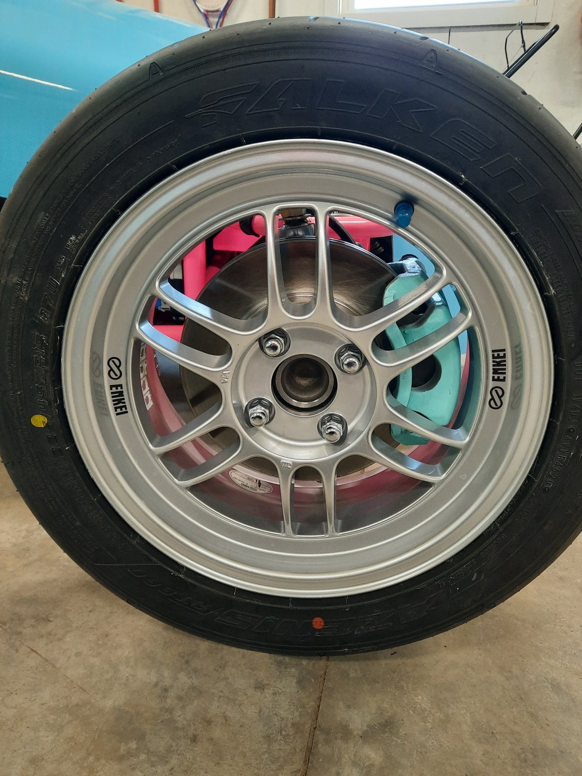

Reading this over and comparing to similar build setups, I'm left with a few questions. It seems like some builders already accomplished this with just just some caliper clearancing. Was the clearance issue you saw with the wheel face or just the wheel hoop? What is your wheel spec for width and offset? I'm looking to run the same sort of set up if I can. Im also hoping to avoid buying wheels that plain dont fit if i can help it.
D
I did have the option to grind calipers down as I know at least one other person has done with these wheels, but it seemed like quite a bit as I was measuring. I chose the cheap spacer option to get by until I could machine the calipers correctly or find a better solution.
The wheel "hoop" is the only clearance issue; it is exceptionally deep on the RPF1 compared to many wheels. Mine are the 15X7 with 35mm offset. The Sparco FF-1 fits just fine in 15X8, lots of 15" wheels fit.

I also got an ebrake setup from another local Goblin owner, so I'll probably install that later in summer. I have to clearance the calipers a bit to give some flexing room, but it seems to fit under the RPF-1 wheels.
