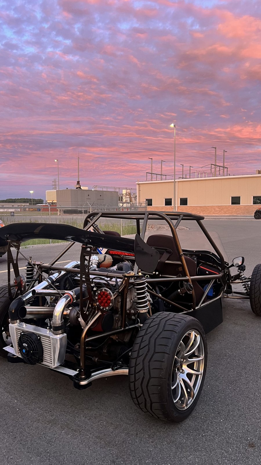

Tuning has been going good. All low rpm tuning right now, but today should be the last iteration. I should be able to get into boost on the next drive! The car is driving great but my only concern is the short dump off the turbo is causing the exhaust fumes to come back into the cab. I don't mind smelling like exhaust but I know the wife will. That is something I will have to look into later down the road.

With the windshield on, the air behind the goblin comes forward. Some have added a “back glass” to stop the air from coming forward……..which makes the air in the cab a bit stagnant. It’s never ending. :D
I used my old windscreen as a back glass when I cut a new front unit. It works.

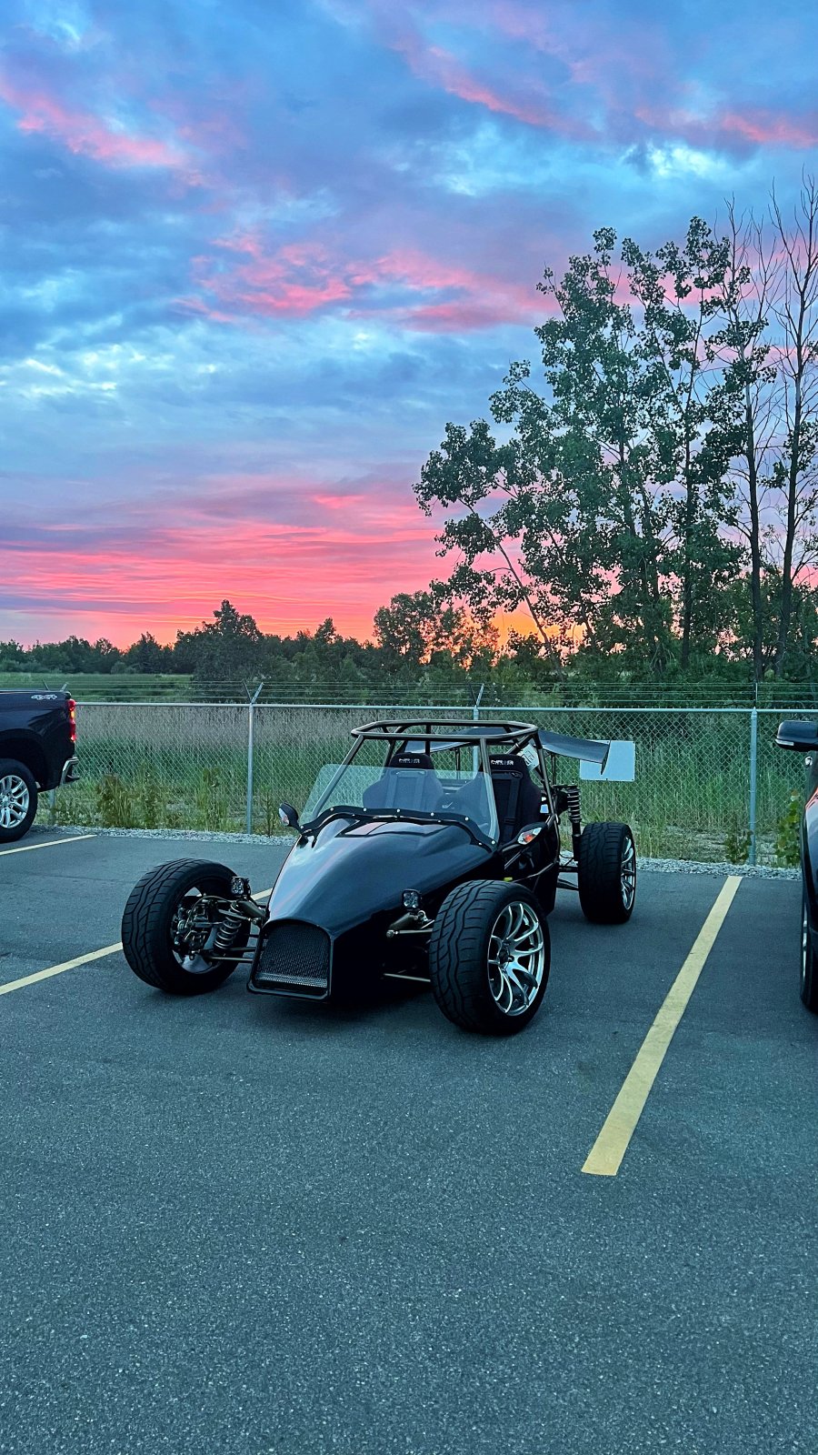

Drove into work again and had another awesome sunrise. I just took the goblin home though since it looked like rain and I noticed that the battery light was on, and it seemed to have a high idle that wasn't there this morning when I came into work. Something I'll have to look at this weekend.
