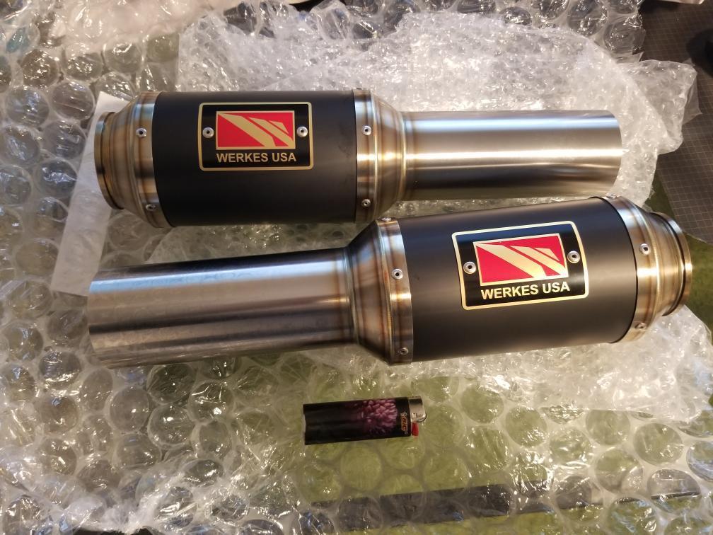

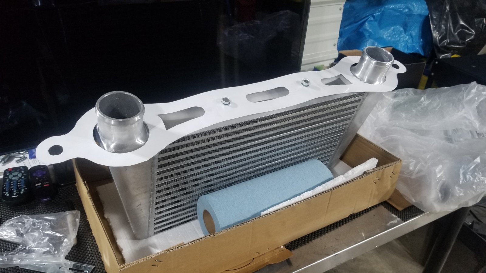

I will be using a brand new K04 turbo with a top mount intercooler set-up and a very special custom exhaust setup - motorcycle inspired. Aiming for around 350 RWHP.

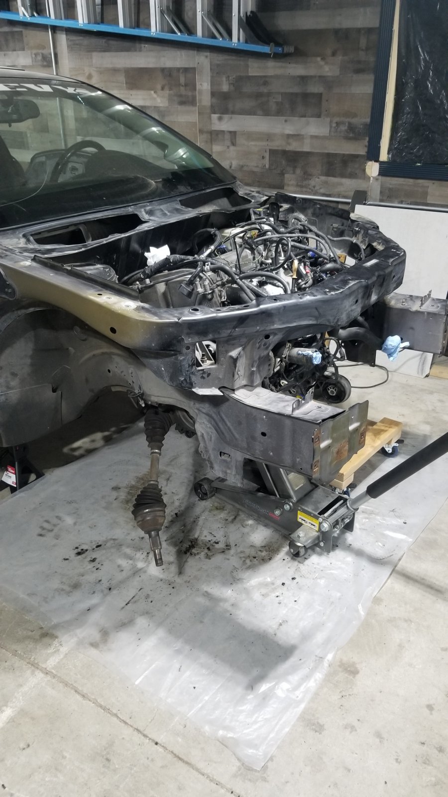

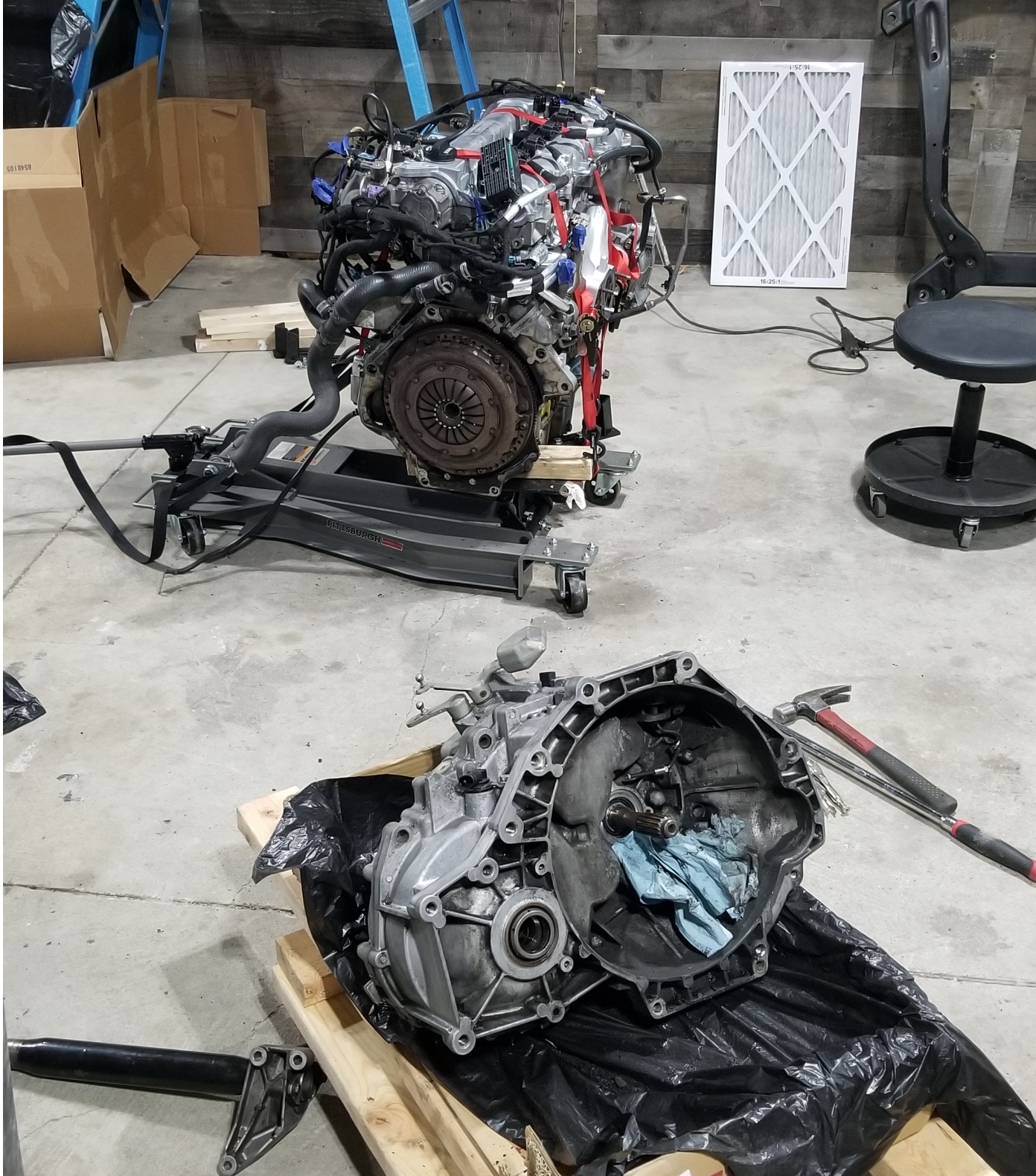

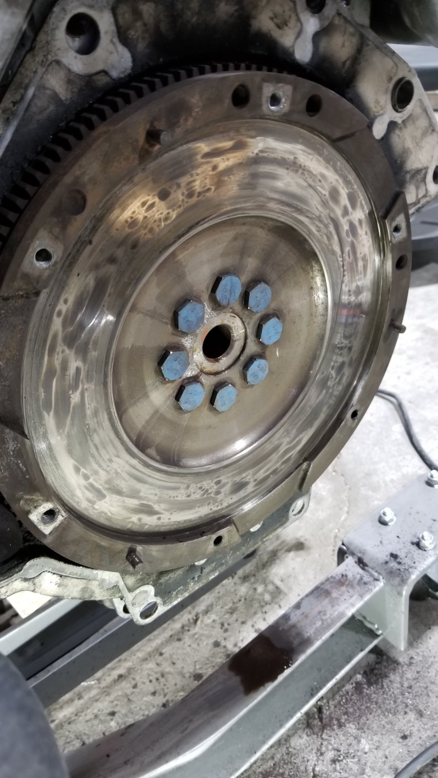

Day 1 picked up donor locally, the car ran but the clutch was bad. once I got the trans off I could see that the clutch springs broke off and jammed up inside. The flywheel is toast!
28797
End of Day 2 - electric impact wrench was sweet. I am doing this entire project with the motor on this 1 ton transmission jack. A 2x4 under the trans works great, its very stable, I will add jack stands under the trans once its back on.
28798

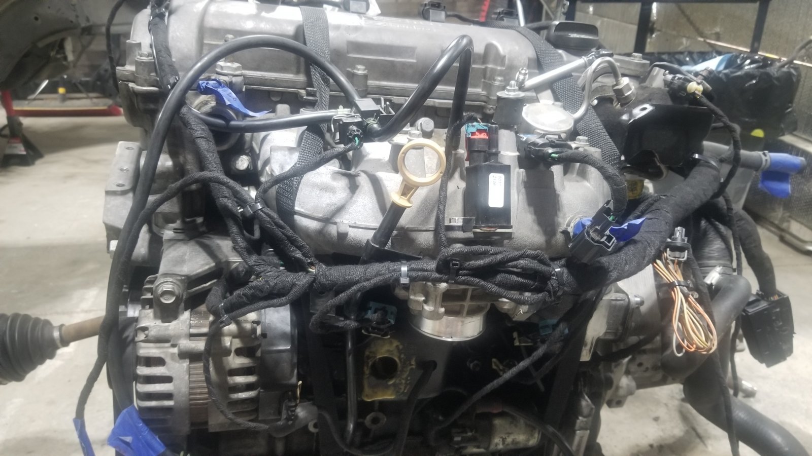

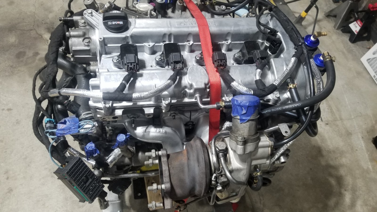

Cleaned up engine harness
28800
Finished all of the new engine heat shields, I have a nice turbo blanket for the hot side.
