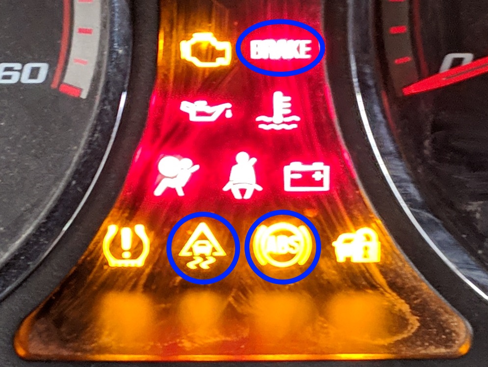

Builders that use a ABS equipped donor (JL9 build code), removing the ABS module will cause the ABS, Traction and Brake lights to come on. This is to indicate that there are issues with these systems. The concern is that the brake light should warn of low brake fluid (safety concern) and when the parking brake is active (assuming you plan on keeping the parking brake).

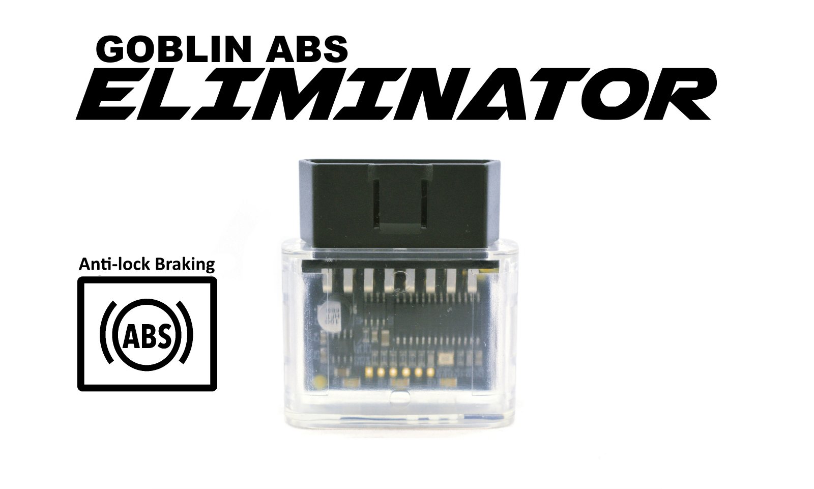

The previous "ABS Emulator" design needed to stay plugged in to the diagnostic port long term to emulate the missing ABS module. NEW DESIGN - enter the "ABS Eliminator".
11030
This new version, though programming, will turn off Anti-Lock Braking, Traction Control and Vehicle Dynamic systems in the BCM. As a result, the ABS and Traction control lights will no longer illuminate and you will no longer receive the "SERVICE TRACTION", "SERVICE ESC" and "ESC OFF" messages from the digital information center.
Simply plug the eliminator in long enough for it to make the programming changes and then remove - takes less than 20 seconds. These will be locked to the first BCM that they are plugged into and will not work on another BCM once locked.
Brad, so the module gets plugged in, it changes the BCM programming, and then it gets unplugged after the BCM is changed. So does that mean the module is now no longer useable on the car again? Or that it cannot be used on any other car/BCM? The module does not need to remain plugged into the ODB port?
The programmer can be used on your BCM multiple times, it can not be used on another BCM. It does not remain plugged in.
