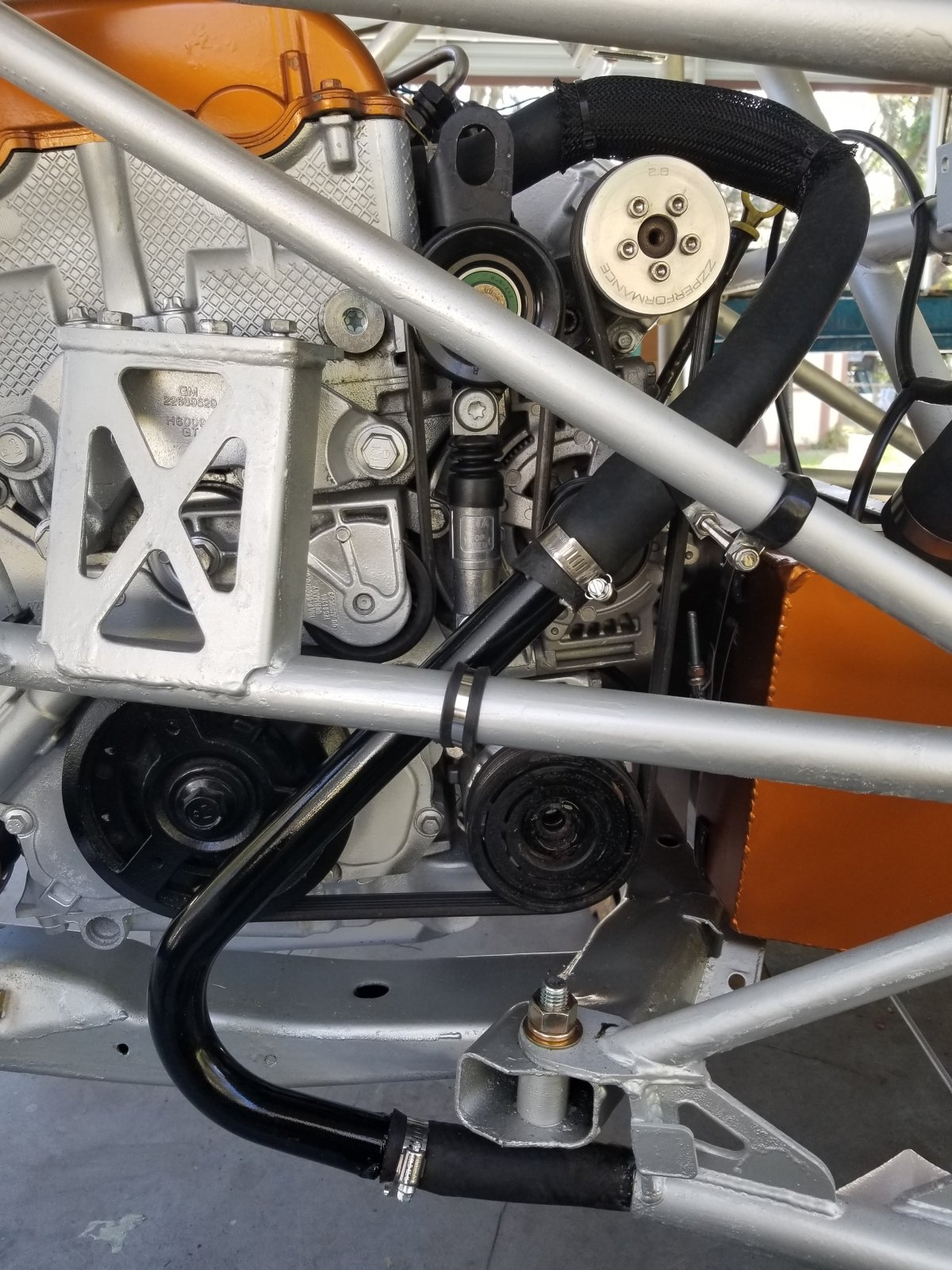

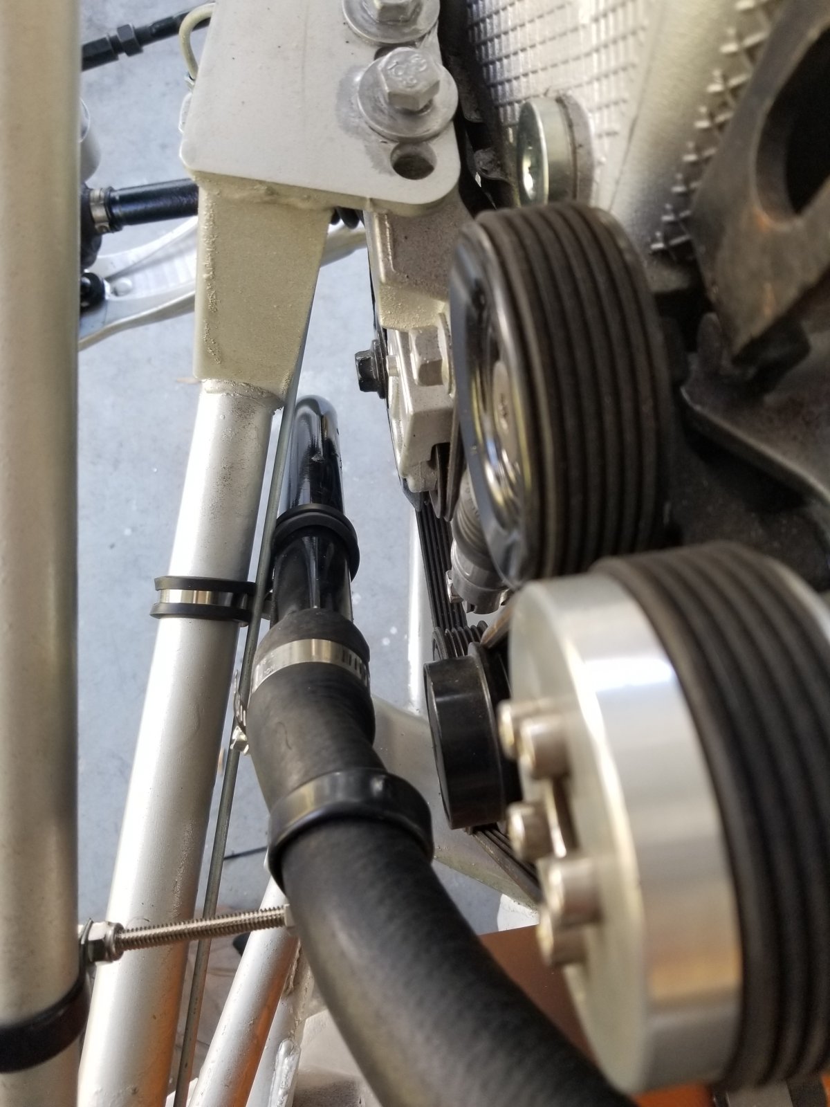

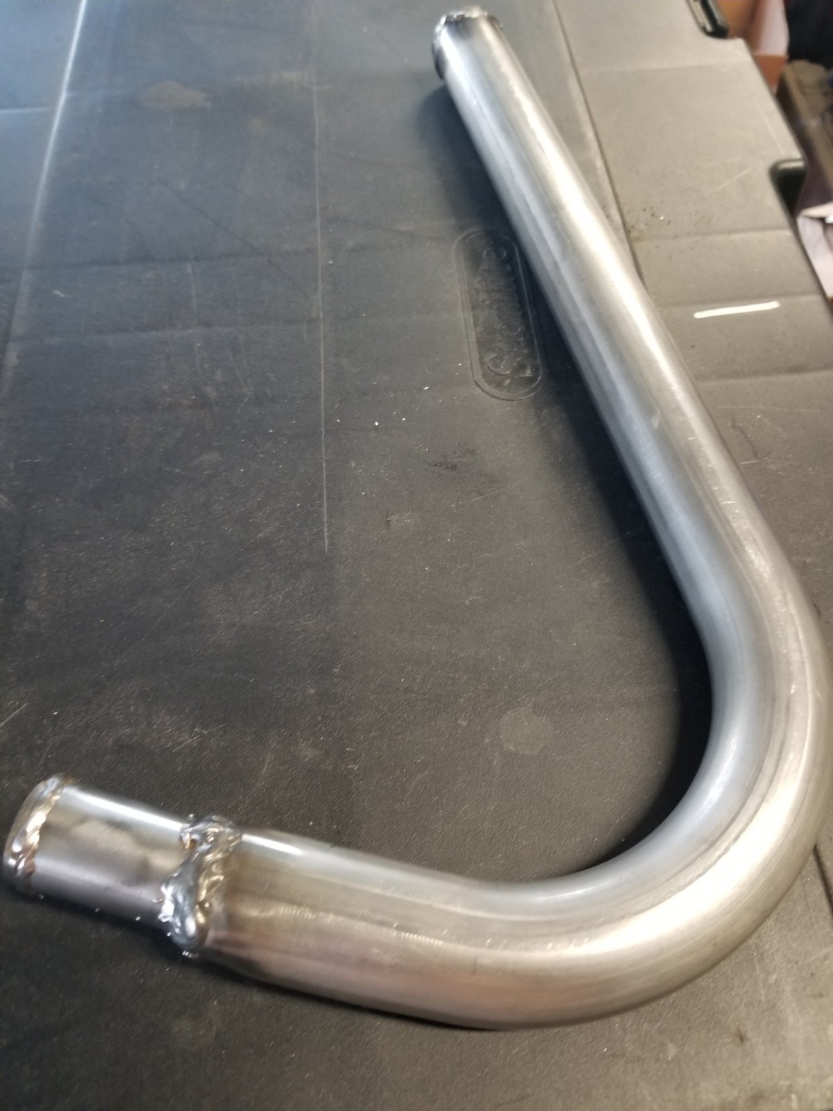

As suggested by others, I got a 1 1/4 inch J bend to build the right side cooling hose on my SS/SJ (supercharged). The challenge is to make it fit on the pulled through the frame hose, whose inner diameter is about 1 inch. I ordered some 1 inch tube. Got a 4' piece. Cut off 4 inches and welded it into the curved end. I also ran welding beads on the connection ends, to keep the hose from slipping off. It worked well. Its supported in two places to keep it away from pulleys.

Looks like a solid setup. I'd like to do mine like this and something similar with the heater hoses that get looped. I don't like the sharpness of the bend currently using the old heater hose.
