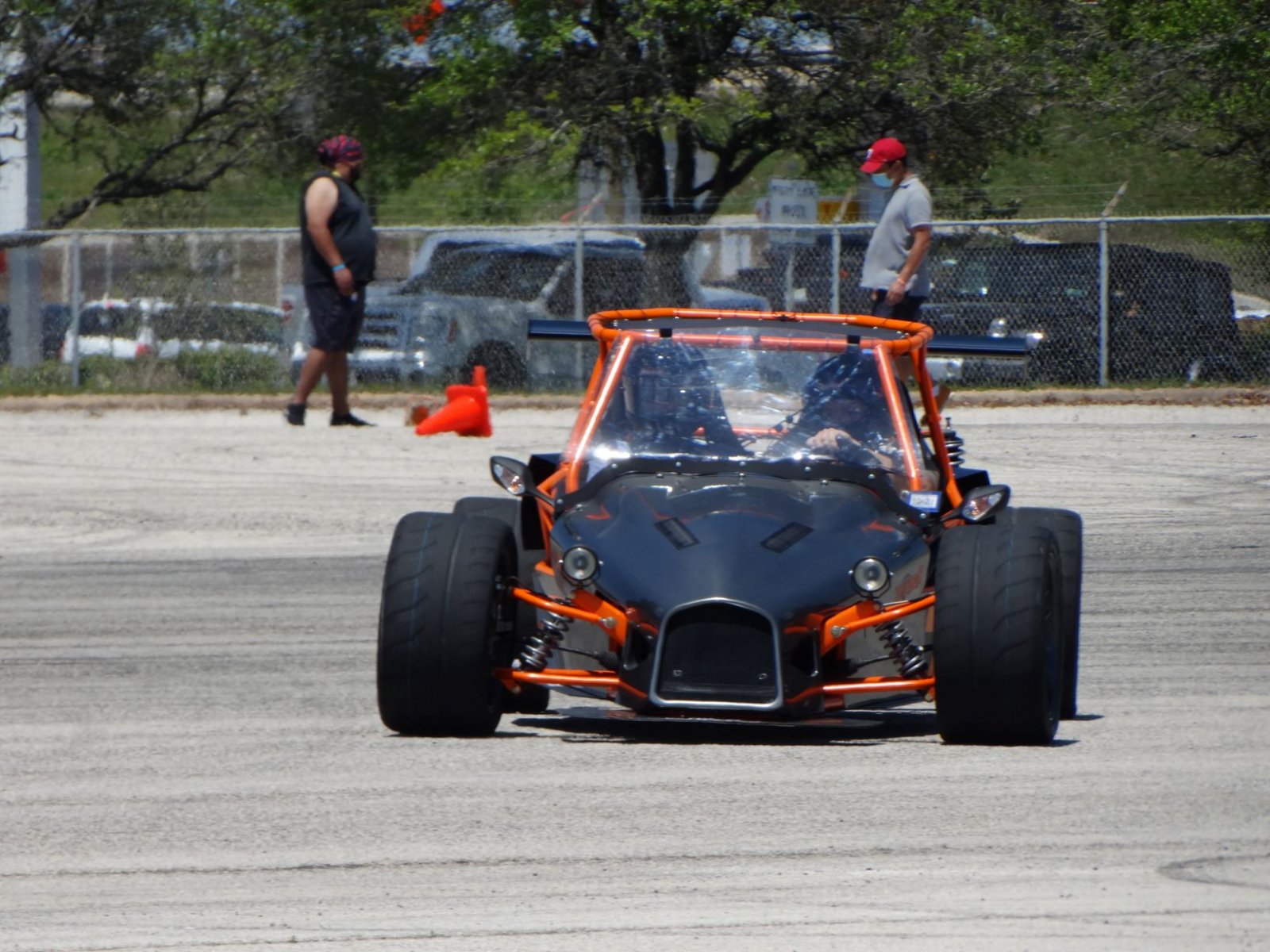

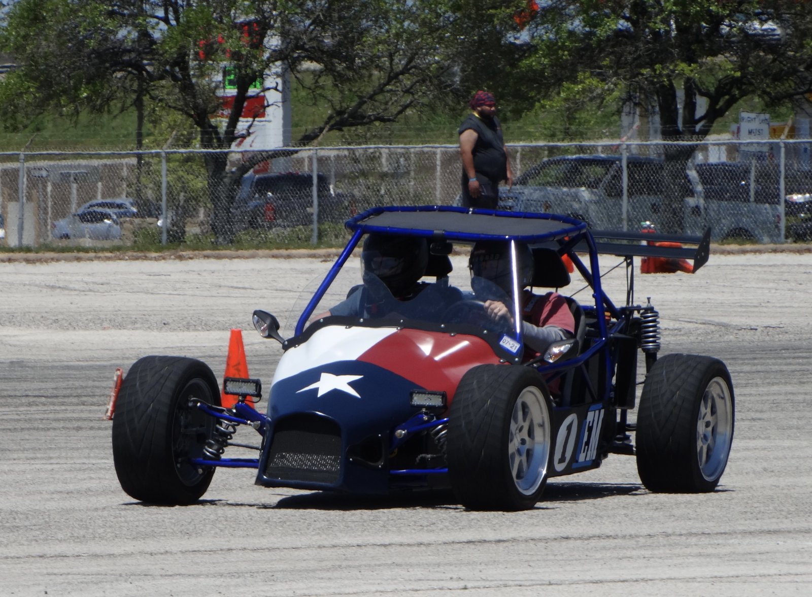

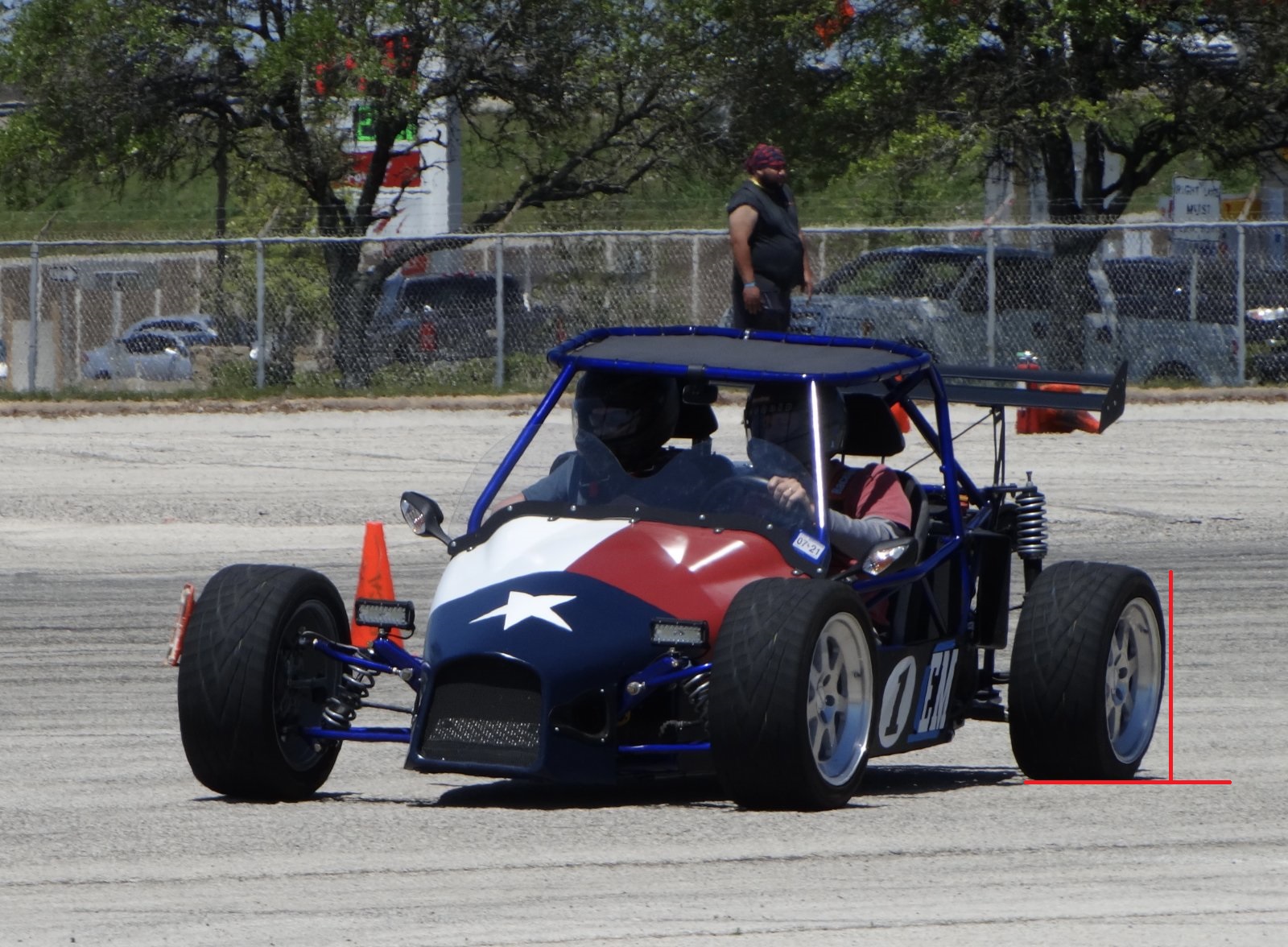

It looks like your rear outside tire is only planting the outside edge.
You may be able to give up a little straight line forward bite for more rear grip through turns and better drive-off by adding a couple of degrees of negative camber.
It may also be beneficial to add a degree of negative to the front too.
Fozda
You could also add a base model front sway bar to the rear. I added one to mine and it helped control the body roll immensely!

It was an awesome and @Lonny, I think you are correct. I was looking at my tires and the outside shoulders are all scrubbed much more than anything else. The shoulders on the R888r's are rounded or slipped down and you can tell that I was going through the turns on them only. I'm going with some extra camber on the rear next time around and taking some off of the front. I was much more controllable this time around but still very tail happy.

Rasing the rear until the lower control arms are angled down and a little toe in on the front tires helped keep me from losing the rear. As soon as that lower control arm goes from parallel to the ground starting upwards you are losing camber.
SACTX
I raised my rear end 1 3/4" at the frame, ~8" to 9 3/4". I went from 1 degree upward on the tie rod to about 3 degrees down with 1/8" toe on the rear and .7% camber. Before, I would instantly loose the rear end if I applied ANY throttle while turning.

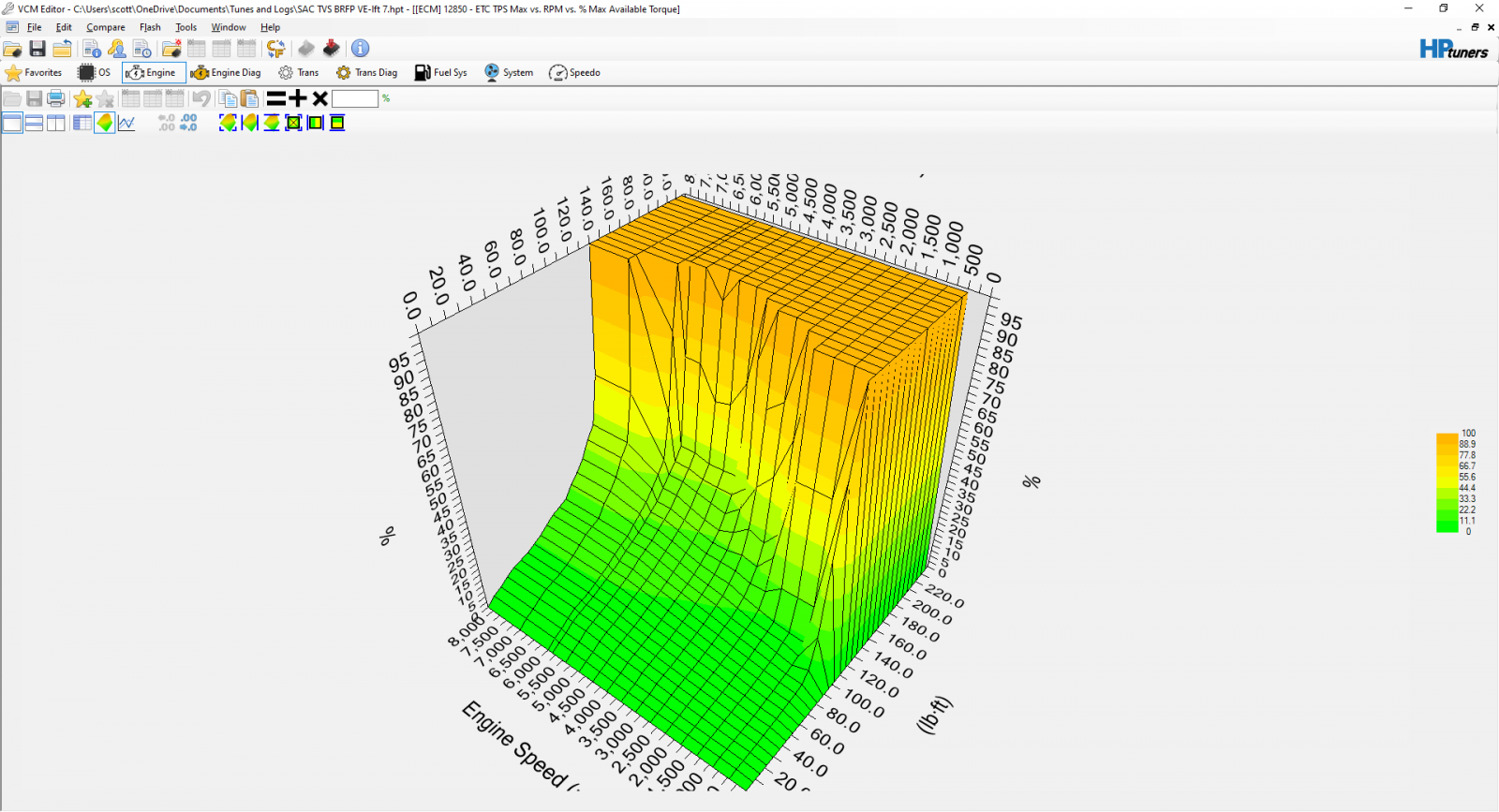

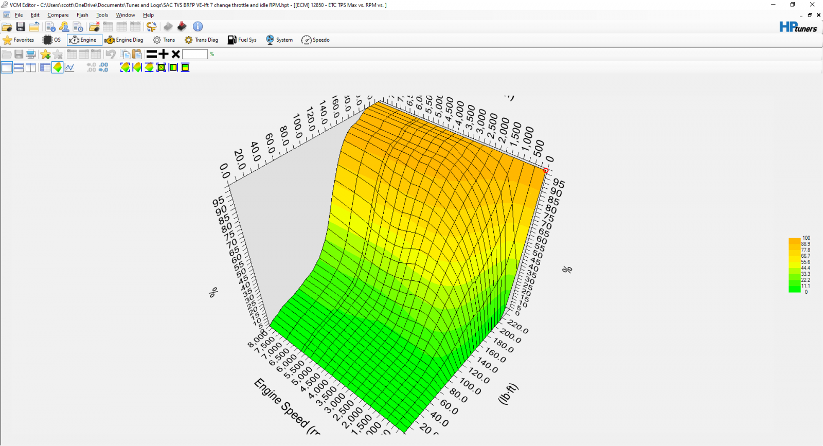

I've also been working on the ETC TPM/RPM/% MAX TORQUE table to bring the throttle input down to a point where it was more usable. Remember before I was saying that I was getting too much throttle at any amount of input. This is what my current table looks like. I still need to bring down the mid level throttle input and level it out a little. It's still pretty abrupt on the uptake.
22748
Stock Table
22750
This time I was able to modulate the throttle in the corners and control the rear end a lot better than before. I'm still very rear-end happy, but It's much more controllable.
I saw that too!
I appreciate the info from you and Fozda. I had been running 14 psi in the rear. Warmer weather, more aggressive driving, or another 200 lbs in rider may have rolled it a little further than in the past. I was inspecting the few scuffs on the side wall and confirmed the picture.
More psi is the easy change.
Will keep making other changes though!! :)
Stock Table

They really did stick well. I did start to skid on my last few runs, but it was controllable, like a drift. I think some of that was from whatever shifted in the rear though. Still need to check my rear alignment and see what moved.
