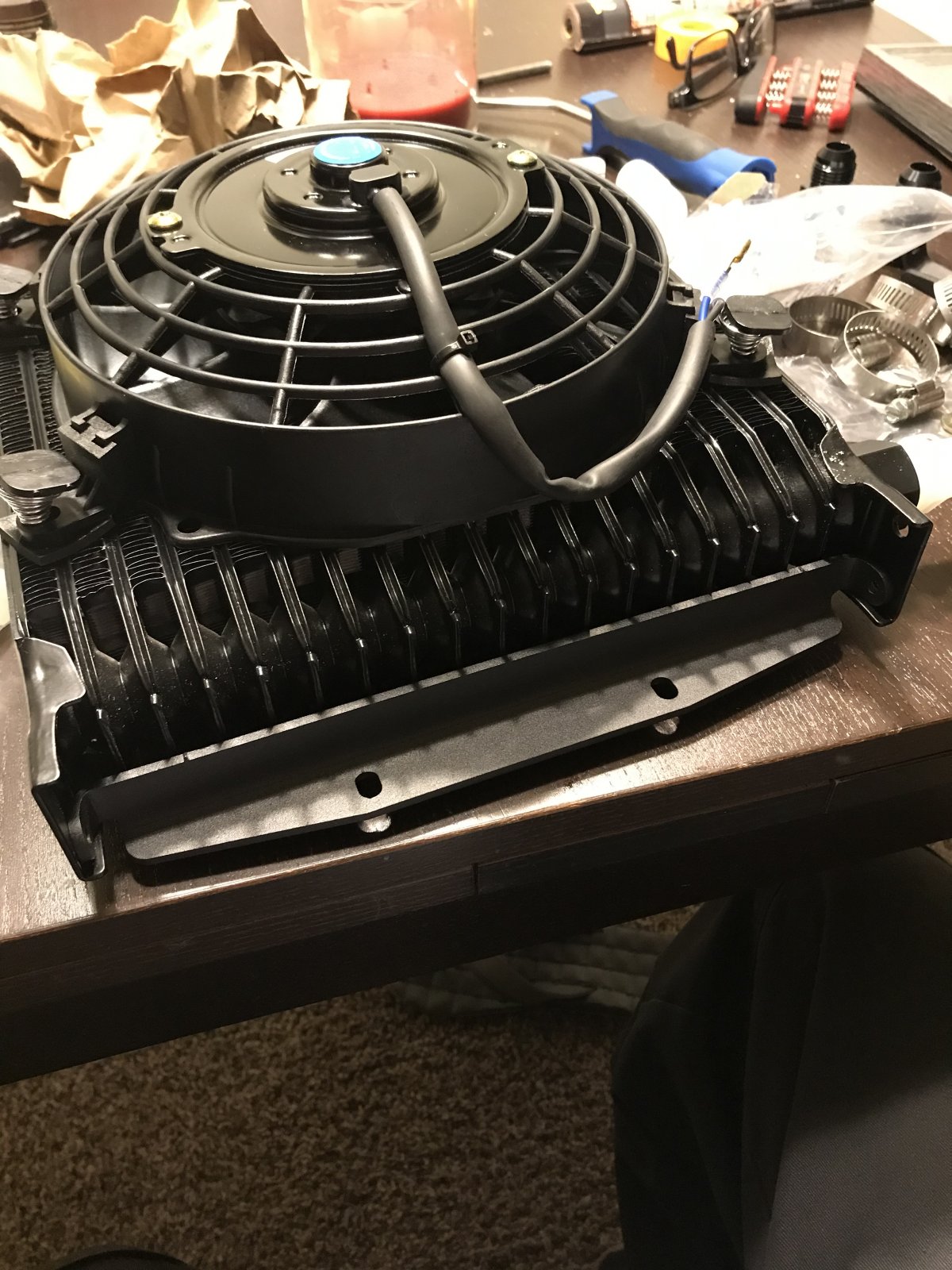

I tried searching the entire site for photos or instructions how to mount the heat exchanger in the front of the car but can’t find anything
The mounts have 2 holes on each side but I only see 1 thread in the frame on each side to screw into.
Wondering if anyone can take a few photos or send me a instructions link would be a massive help
Thank u

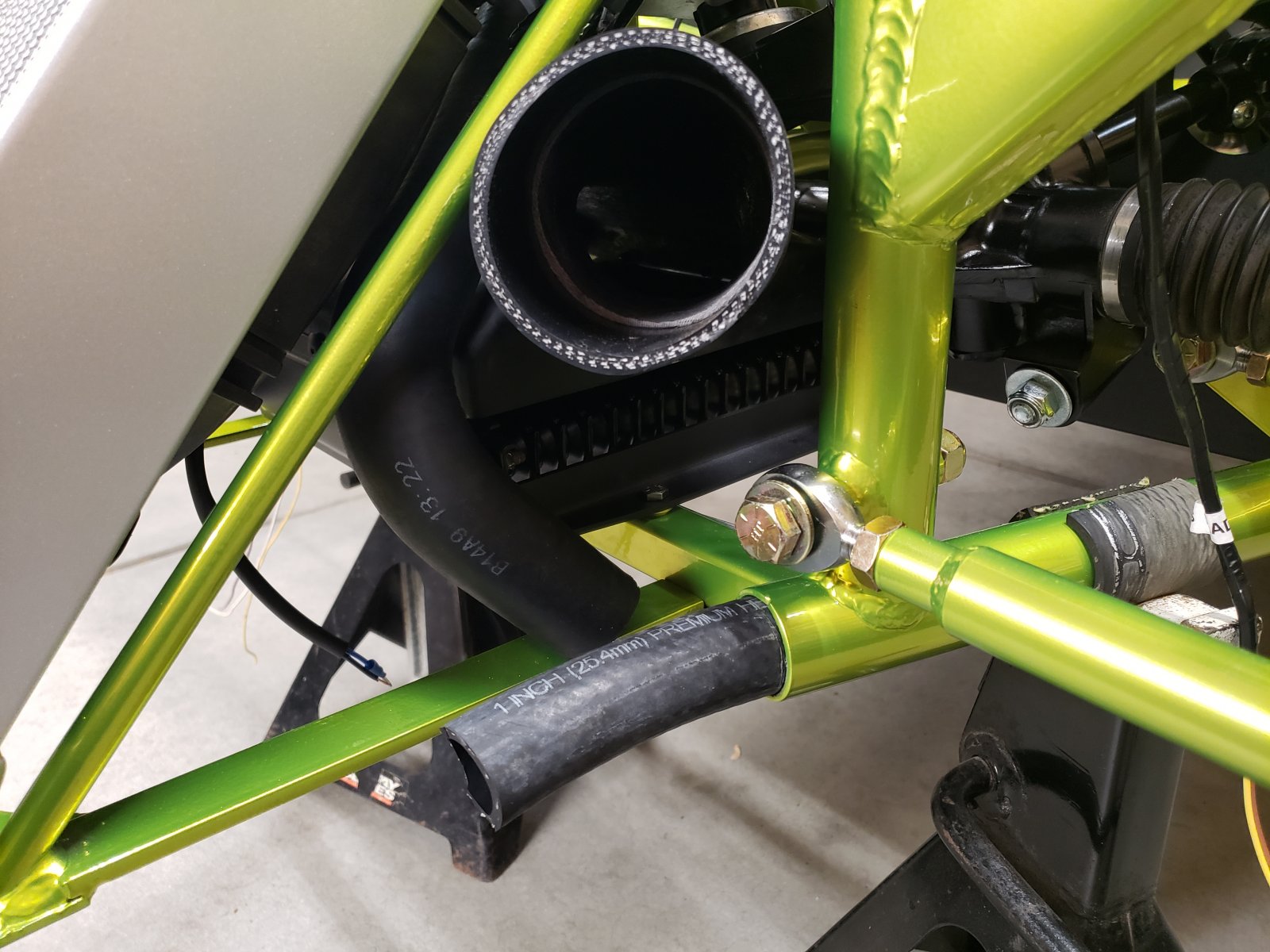

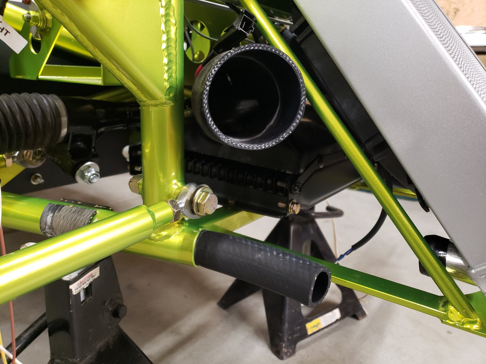

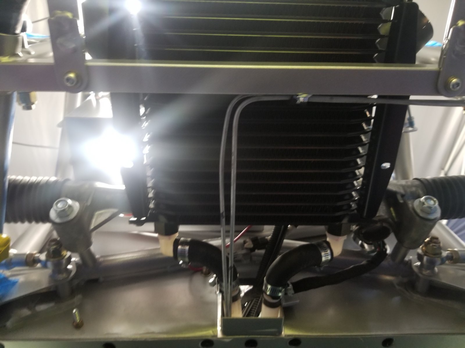

These are the best pictures I've got. I have the NACA duct setup instead of the fan. The heat exchanger brackets are attached to the frame through the front holes. The back of the heat exchanger is kinda supported by the plumbing going into the tunnel.

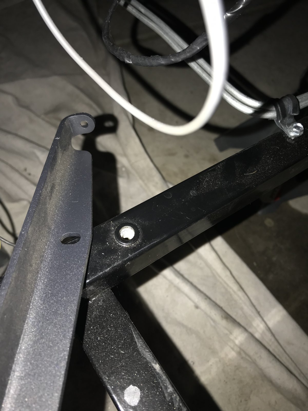

Thank u
Just use one set of holes, bolt it to the threaded insert you show in the pic. Offset it to the rear of the car. Make sure to put the 90's towards the rear.
