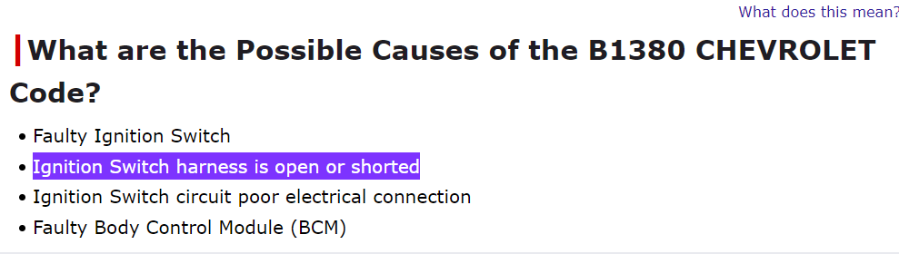

The only somewhat relevant ones seem to be `B2645` and `B1380`. I forget, do we retain the ambient light sensor? I feel like we do somewhere.
`B1380` shows this:
35306
Might be that I shorted something in the ignition harness? I didn't have running light when I finished the car. I messed something up along the way. So I ran a new wire from one of the key on 12v sources to power the tail lights. This started happening after I left the key in all night, and I think I had my new DIY tail light prototypes on. Its possible that they pulled more current than intended and burnt up and shorted. Unlikely, but I suppose its possible. I'm going to snip that wire at the BCM and see if it stops.

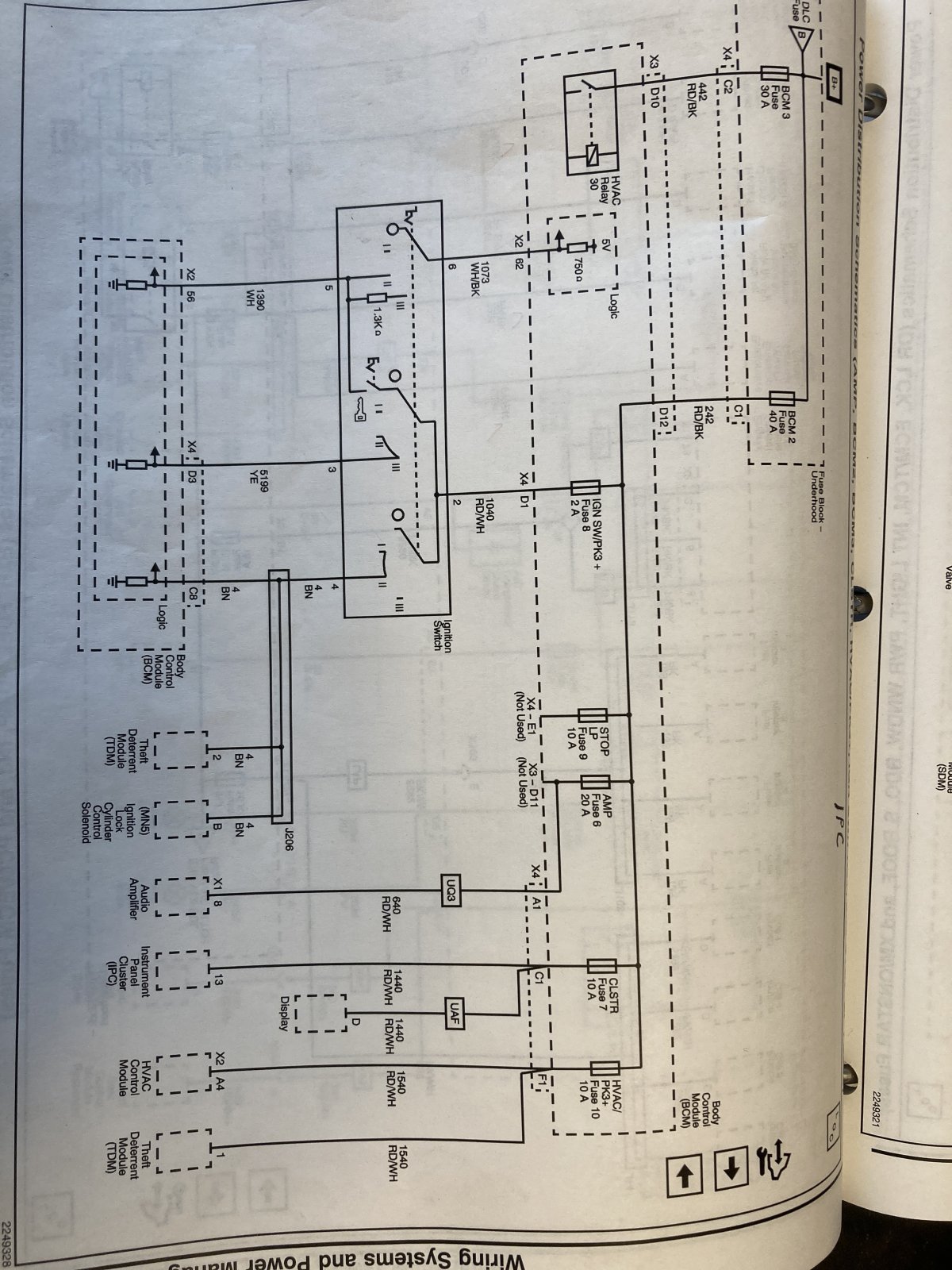

It looks like the B1380 code might be a problem. The best I can tell that is a problem with the accessories circuit off the ignition switch to the bcm. And also feeds the power to the theft deterrent module.
Check the 40a bcm2 fuse in the rear fuse box, check the 2amp fuse 8 of the bcm. If that is good, check for power at pin 4 with the switch in accessory, and then check it x4, c8 of bcm and pin 2 of the TDM. It would be better to check these with a test light than multimeter.
If you tied in your tail lights on a relay control Controlled circuit it should be ok. If it is on the control side of the relay you could have burnt something up, although more likely shot a fuse.

Had a few minutes tonight to dig into some stuff. I check continuity all the way from the taillight to the accessory pin at the BCM. Confirmed continuity. Checked to see if the pin got power, and it didn't. Checked all BCM fuses and found a small 2A one popped. Don't have small fuses on hand, so replacing that will have to wait until tomorrow.
BCM X3 B5 runs to the Trans Control Module and the ECM and not designed to carry a load. I don’t think anything on the BCM is appropriate to carry a load directly. I’m not sure if you spliced in or if you have a manual so had a spare wire.
jirwin
Spliced it in. I'll probably switch it over to my auxiliary fuse box I added for the heat exchanger, radio, wideband, and USB charger.
BTW looked up the 2A fuse and its "IGN SW/PK3+ Fuse 2A Ignition Switch". Probably my code.
That is the fuse that I referenced so likely the the cause of your code. Don’t know if it will solve your bigger problem. But turning your lights on may back feed power to that circuit and make it work. Basically it’s hot wiring the the car.
